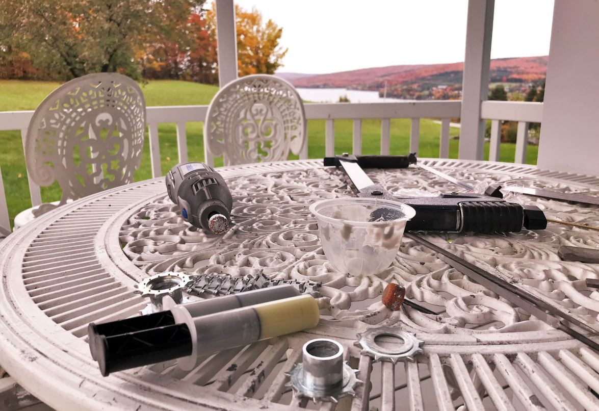

Continuing previous post.

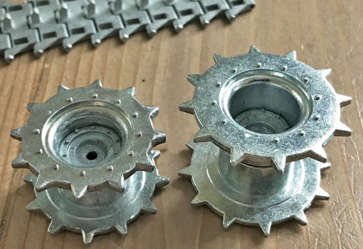

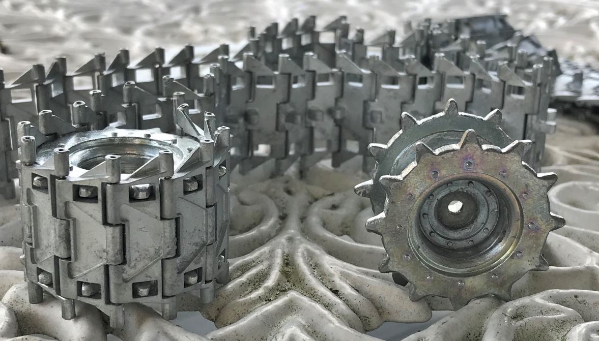

Then after the cut and finetuning, the outside teeth wheel is glued back on the shaft. You can see here the tube of Epoxy Steel. The two different gels of equal proportions need to be mixed thoroughly in a small pot for 1 minute with a stick before applying to the target area.
1/16 M41 Walker Bulldog tracks and sprockets

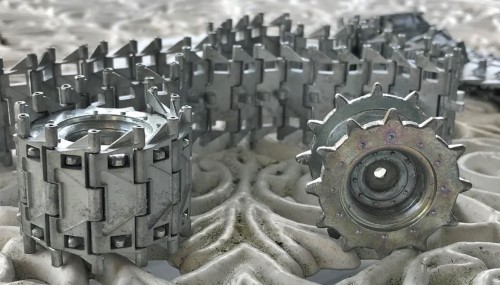

New sprocket on the left, original Mato on the right.

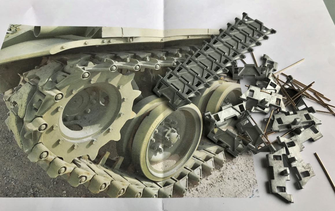

The two AFV-Model MLRS tracks can be assembled in about 15 minutes each (minus the rubber pads that should take about 1 hour each sides). They are well molded, good quality and are very smooth. Highly recommended.
The final step is to look for issues, correct, fine tune and polish the sprockets, up to a point.

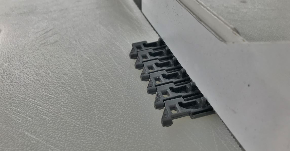

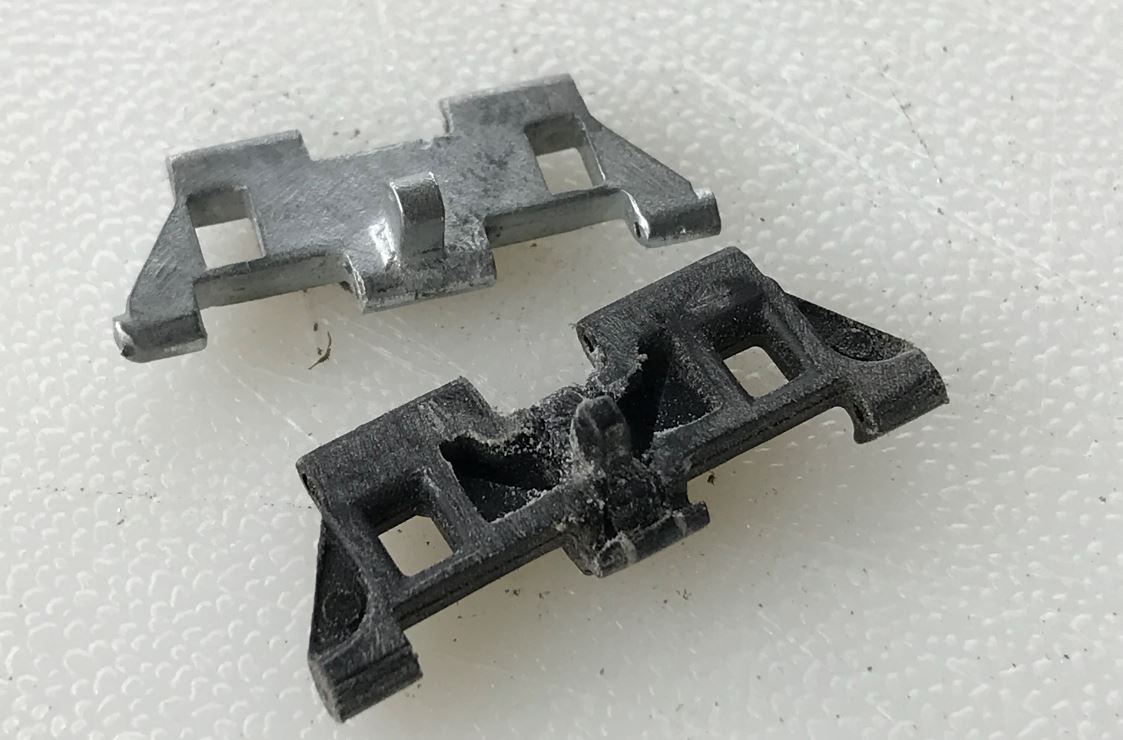

I was curious about plan B, the resizing of the Heng Long tracks... and see how it worked. I devised a cutting process using 2 metal saw blades glued together with a 2.5mm spacer in between, and with a guide that would run along the central pin of the Heng Long tracks when I cut the tracks. The idea was to cut many links at the same time to speed up the process, and to make the cut identical on all the links. I have to say that it was a failure. The plastic of the tracks is not easy to cut. And I used old blades and it is probably the reason why the cut was so ugly and uneven. I had no inclinations to improve the process myself with new blades and a better jig, so I leave it to others to figure it out if they want to do something like that in the future.

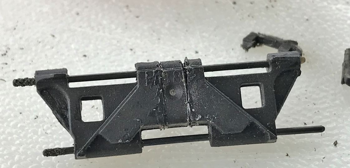

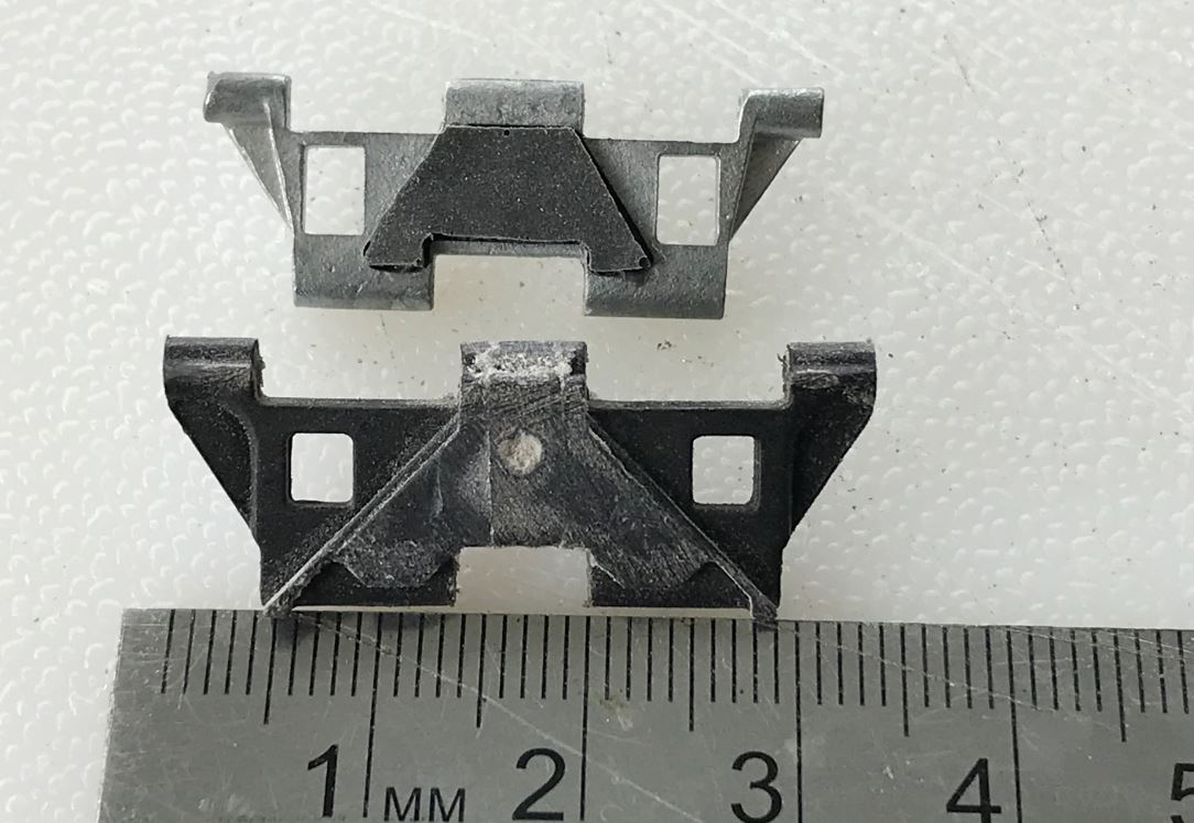

I ended up making one link by cutting the material with a hobby knife as shown. The 3 track parts are glued back together using a thick application of Superglue Gel. More superglue Gel is later applied in the gaps to form a strong and seamless joint. I do not recommend to use putty on the tracks, use superglue gel instead as a filler.
Making two links alike without some kind of standard process will be difficult. If the links are not totally identical, there will be many issues when assembling or running them. And there are usually quite a few links that should be discarded because they are not right (too short, not strait, various gaps), so I would recommend the purchase of an additional plastic set so that you can make at least 20 spares.

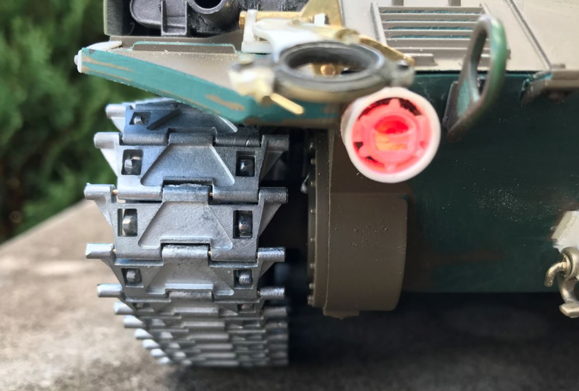

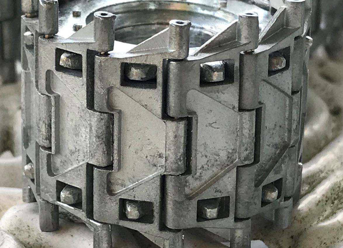

The track and superglue gel is sanded mooth with a hand file and polished a bit. I was able to make the Heng Long track 34mm wide, compared to 32mm for the AFV-Model metal tracks. 1mm was sanded from each tips for a 7mm reduction in total. It good enough. Reducing it further would have impacted the integrity of the design. The Heng Long plastic sprocket width can then be adjusted and no reduction in diameter is required. I estimate it takes 5 to 6 minutes per link, adding up to about 15 hours of track work, and some mental heath issues if you go that way. After the Marder 1A1 track reduction, I will try any alternative before doing this again, but it is doable and much cheaper financially.
You can also notice the teeth hole design on both tracks. It is more realistic on the AFV-Model tracks. The Heng Long holes are too square and that is why their sprocket teeth are so narrow.
View of reverse side for comparison. No underside pits on the AFV-Model tracks.
With the AFV-Model MLRS track set on an M41, you end up with 24 spare links, which is great.
In conclusion, I recommend going with the AFV-Model tracks. The resizing of the Mato sprockets is a 5 hour elapsed operation. If you go with my metal grinding option, make sure to do it outside, with the metal dust going away from you and in the wind, and wear eye protection. Be careful.
A Plan C could be to buy the AFV-Model MLRS sprocket for use on the M41 (not accurate), or maybe transpose the MLRS sprocket teeth on the M41 sprocket hub, but I did not investigate that potential solution.

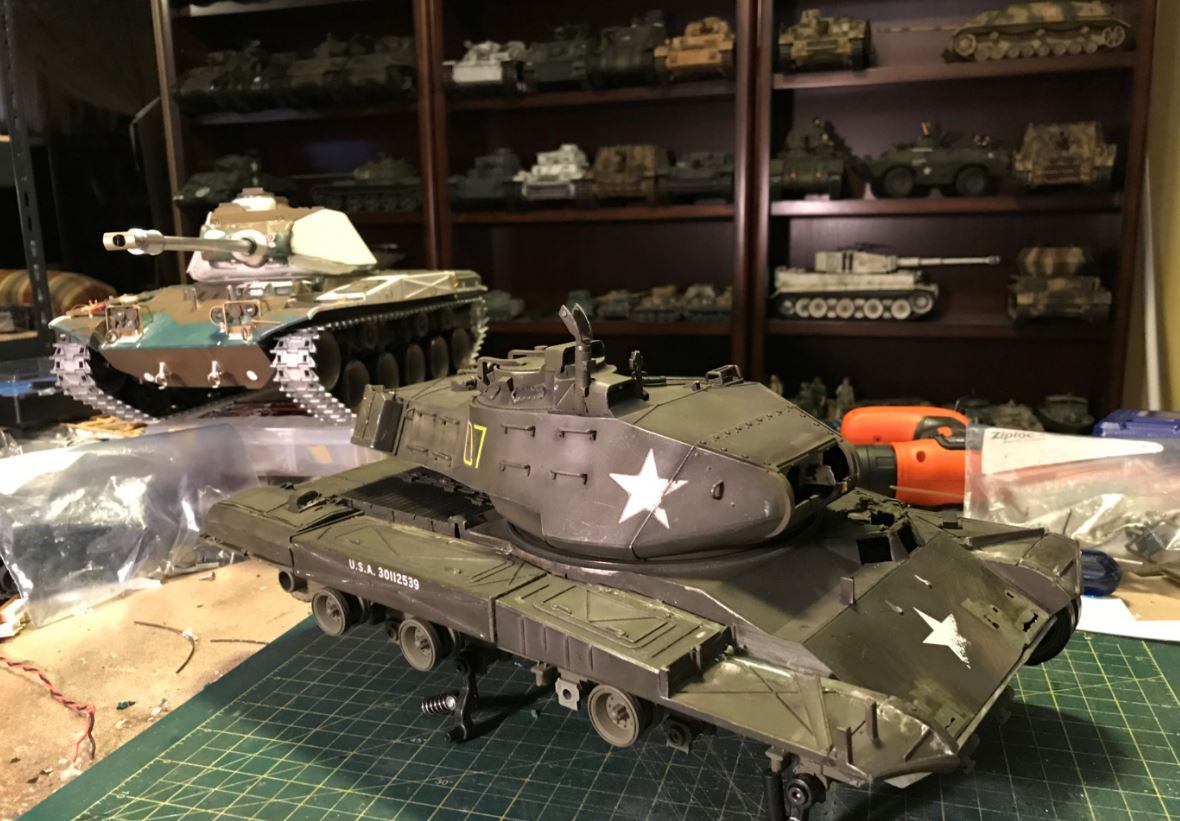

Yes, I am surprised as to how well the build has gone on every components. It has been 6 weeks since I started and the construction is almost finished.

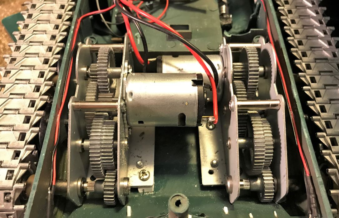

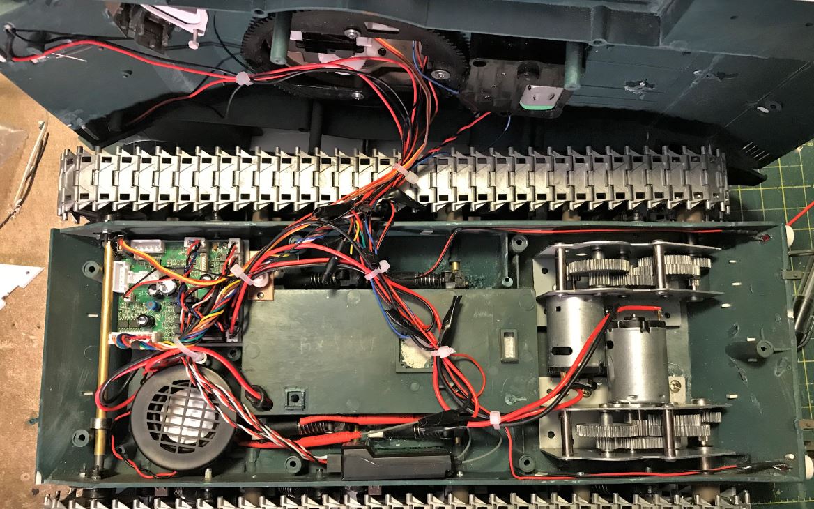

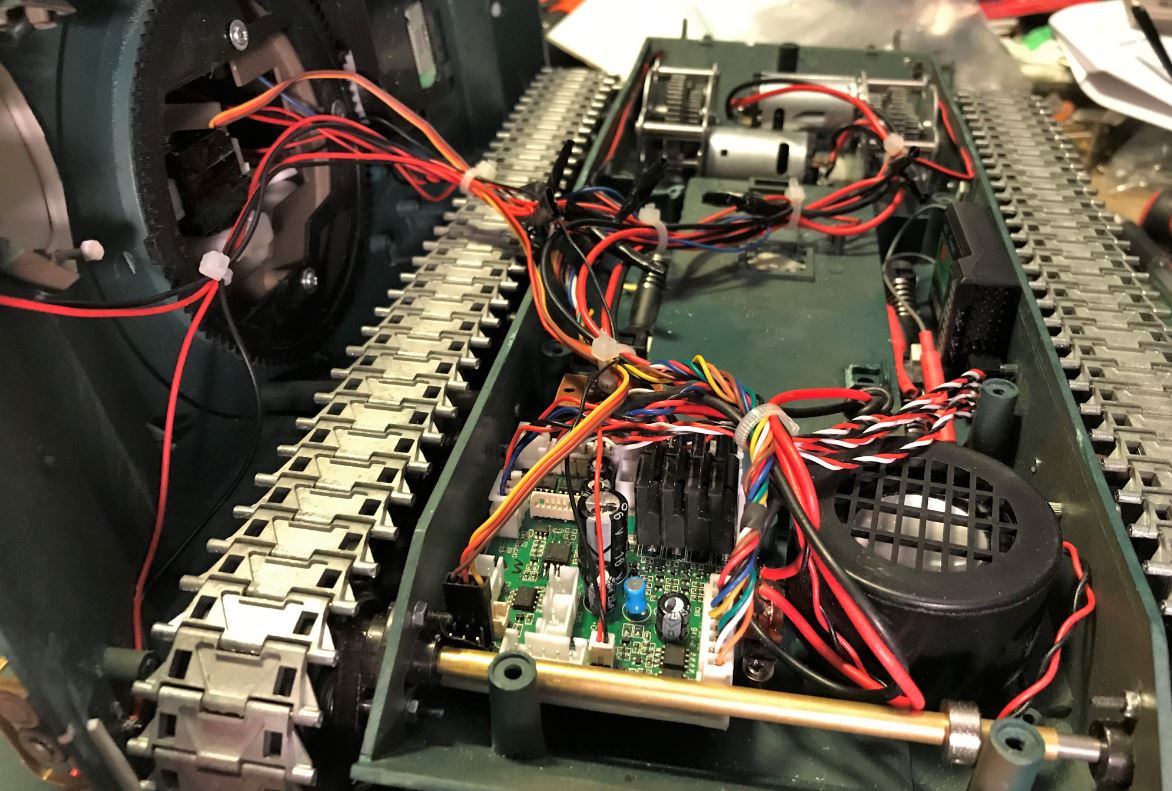

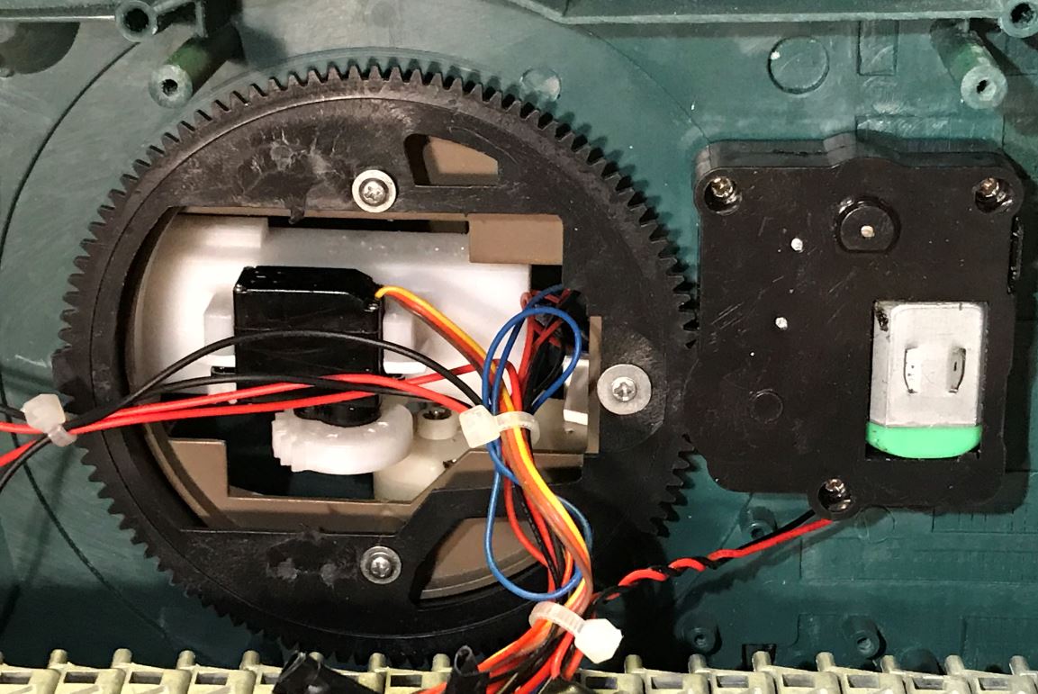

Hi, here are the electronics and gearbox
Layout of the interior with Clark TK-22 and speaker at the front, Flysky receiver on the right. No Smoker.
Take note that on a TK-22 with 10 channel Flysky remote, I connected the wires as following
FS Channel/TK-22 Channel
1 / 1
2 / 3
3 / 2
4 / 4
You can also see the recoil unit servo and the small connector for the gun flash unit at the front.
HL M41 1/16 electronics and gearbox
The standard Heng Long M41 gearbox is too high for a model with reduced height. Below is a Heng Long Jagdpanther 3869-1 gearbox that you need for such build. It is low and has the long shafts that are required for the sprockets. For 24$ with free shipping, this is the cheapest alternative. And it just falls into place with no modifications. Only two anchor holes for the left gear need to be prepared, the others are already aligned.

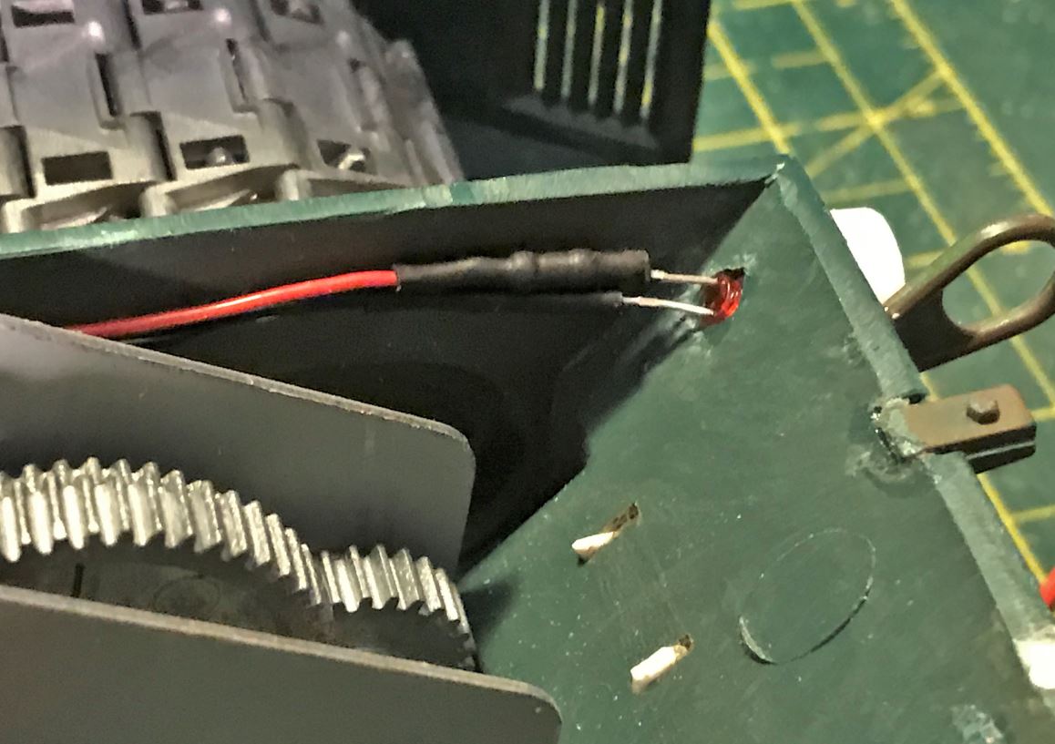

I could not figure out why the Heng Long tail lights LEDs were not working with my head lights. As soon as I connected the tail lights to wire 2 and 3 on the CN9 connector that already had the head lights connected, the head lights stopped working...Some kind of incompatibility. I therefore cut the wires for the HL tail lights and reused the 3mm red LED that came with the same commercial lights set as the head lights LEDs. I simply glued the new 3mm LED to the back of the HL 5mm LED plastic. It works, it is a bit less brilliant now, which is good anyway.

Overview of the hull interior, nothing fancy

Despite the turret rework and lengthening, it is important to keep the main screws aligned. This facilitates construction and ensures that the recoil unit correctly lowers into the hole in the middle of the ring.

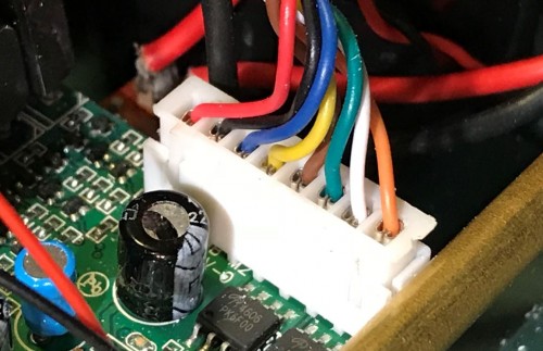

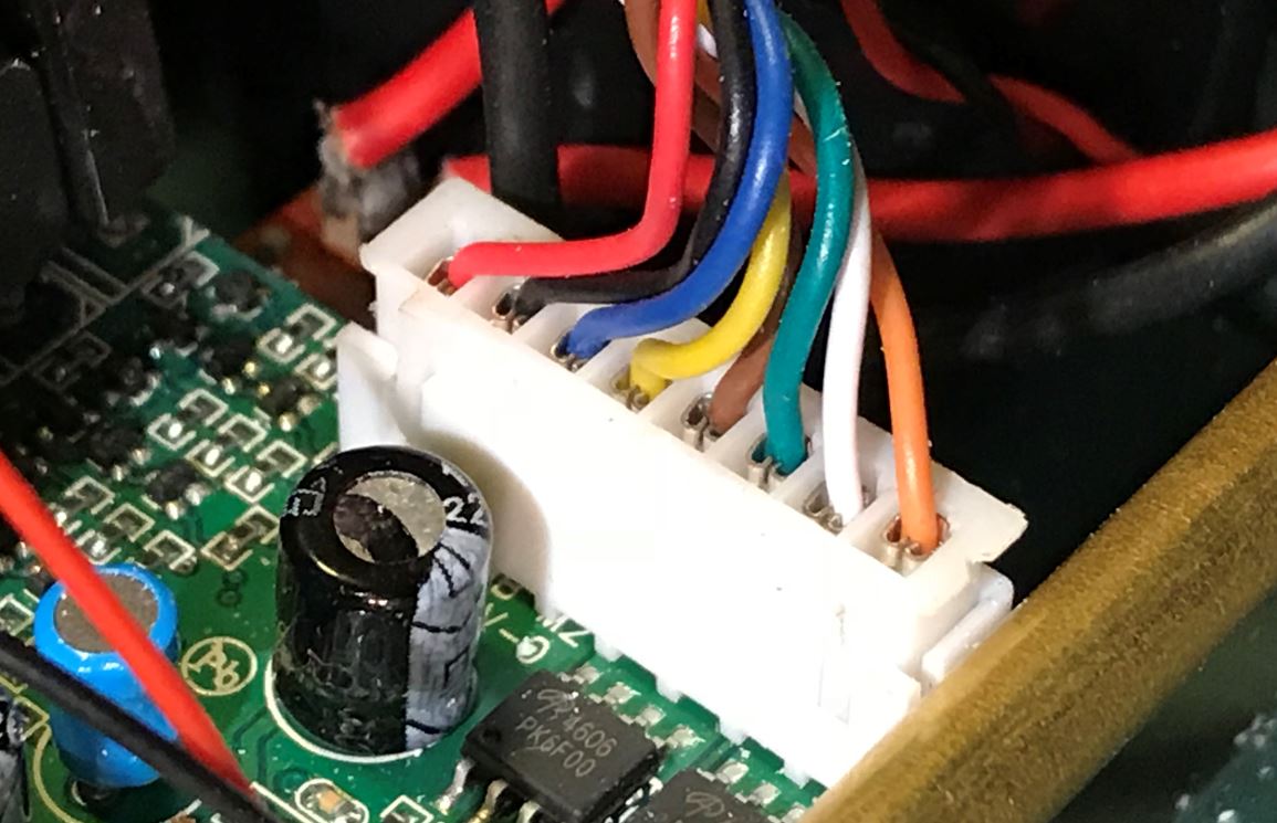

CN9 connector arrangement on the Clark TK-22.
cable 1 is coax MG -
cable 2 is head/tail lights -
cable 3 is coax MG + and head/tail lights +
cable 5 and 6 are for gun elevation
cable 7 and 8 are for turret rotation

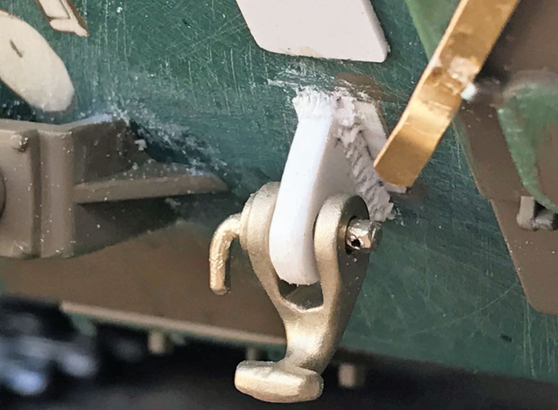

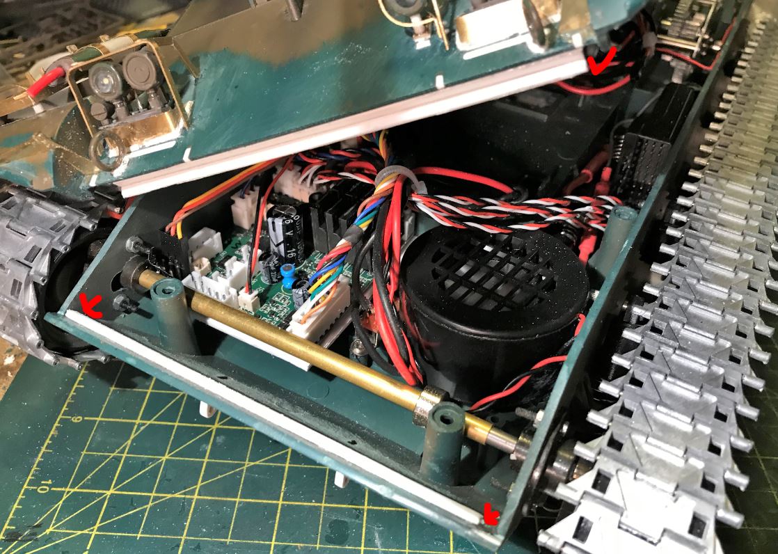

I designed a locking mechanism so that the front hull can be closed tight without having the put the 2 screws at the front. This allows the bottom front holes to be plugged and sanded smooth for a seamless front hull. The top of the hull is held solidly in place with the 4 central screws.

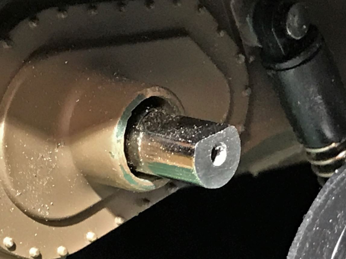

About 2mm needs to be removed from the gearbox shaft is order to align the sprocket with the roadwheel, a 10 minute job with a metal hand file.

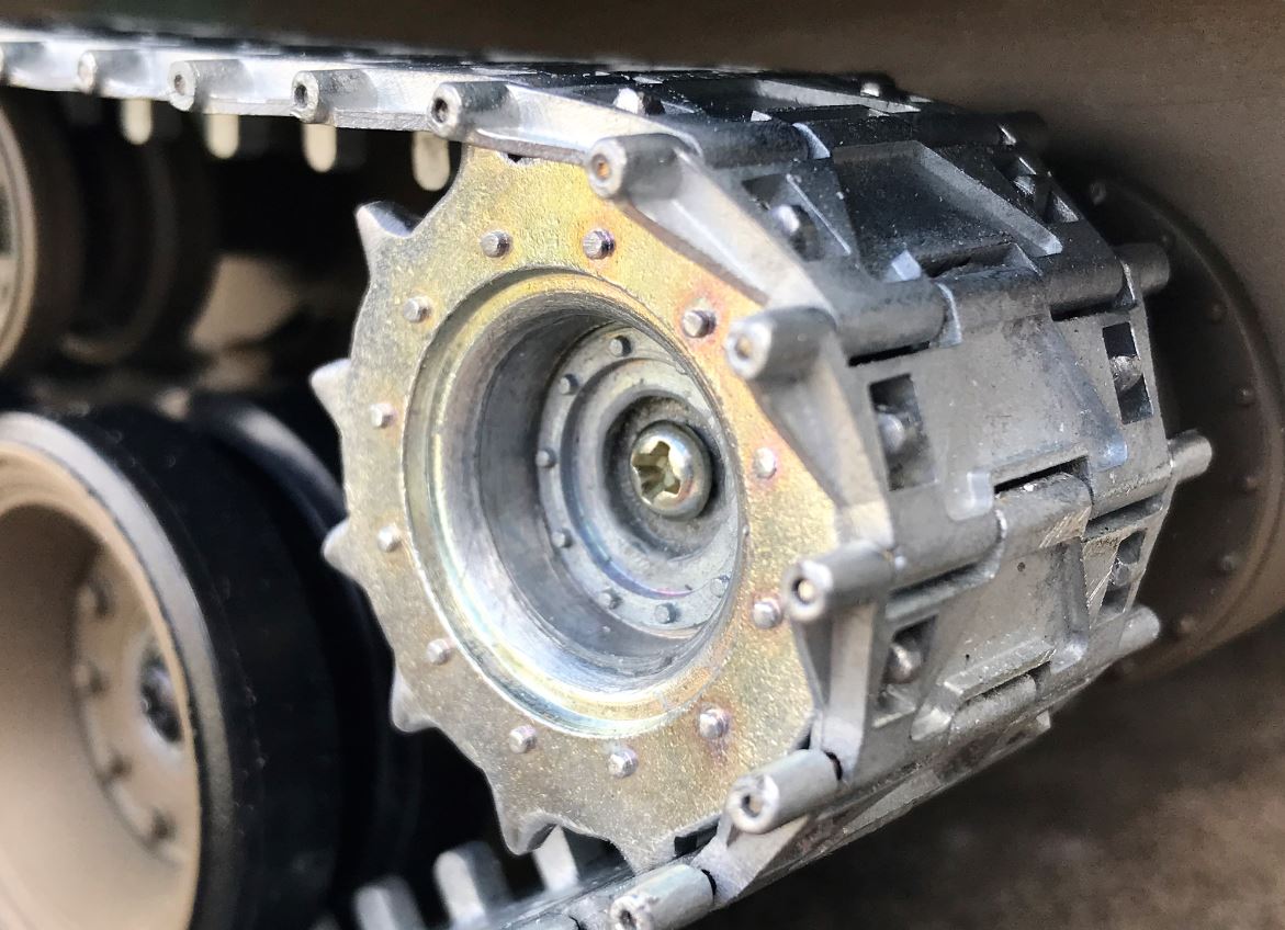

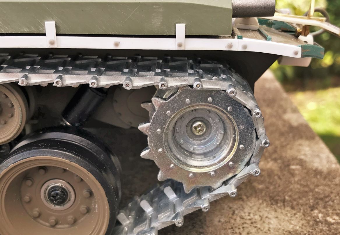

Tracks and sprockets are installed, still without the rubber pads until after painting. Everything works perfectly, I am very satisfied with the AFV-Model tracks, highly recommended. The track is tight and an Henntec adjuster is absolutely required. The Epoxy Steel job on the sprocket seems to be holding quite easily. Having closely realistic metal tracks with rubber pads for this tank is really a big improvement over any past options we had.

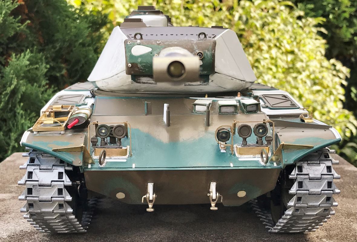

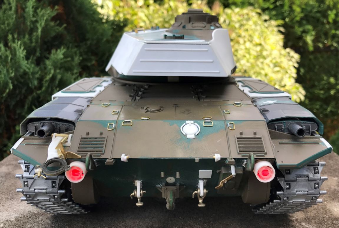

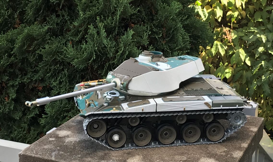

Continuing with the hull

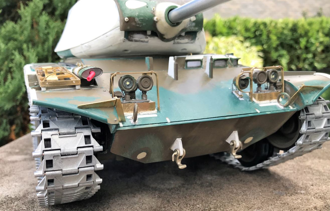

The AFV-Model/TankModellbau M26 shackles look good. There is even I small hole to put a locking bolt at the end of the pin, something I need to figure out how I will do that. They look much better than the HL part.
Heng Long 1/16 M41 walker bulldog reworked hull

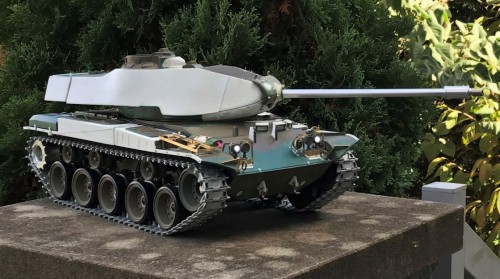

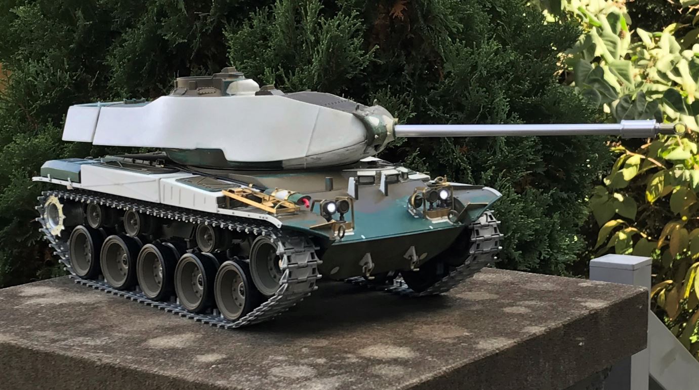

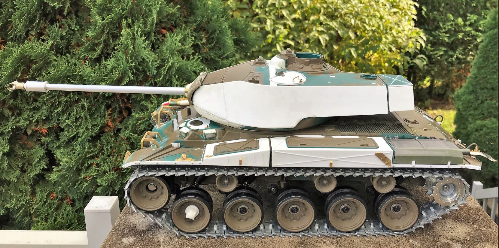

Overview of the hull with the AFV-Model tracks on. They will of course look much better painted with the rubber pads on. I determine these are the early MLRS/Bradley tracks, of the same family of tracks as those for the M41. These are not the later "Big Foot" MLRS/Bradley tracks.

The next step is to finish the turret. I will also start planning for the ARVN crew and infantry tank riders.
