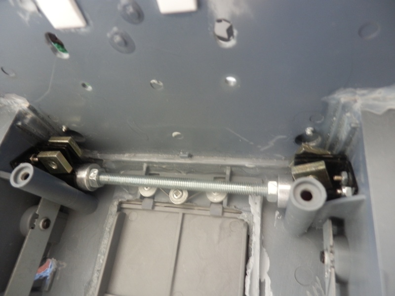

In keeping with the low cost/picked over for useful parts for other tanks theme, I spent all of $10AUD (thats about 4 cents for you guys with actual currency)to get a Mato track tensioner.
Now its nowhere near a Henntec or similar, but it is going to do the job.
Small retaining screws secure the internal bracket to the sponson walls and they will be well hidden by the tracks & dirt.
The idler mounts slide into these and a replacement brass bush & bolt holds it all together.
There is a stiffener bar that runs between them, but its only a basic way of keeping outward pressure on both set ups.

I think it would work as the ends which are the key components can be fitted independently with the stiffener made to any length.
Depending on the orientation of the black retaining brackets, you should be able to get the correct height for your idlers.
The odd threaded rod stifener could be replaced with a more suitable item if you tapped each idler mount and screwed them onto it from each side, then you would not need to rely on the black brackets to be the key stressed members so much.

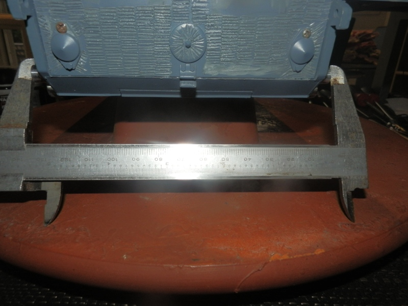

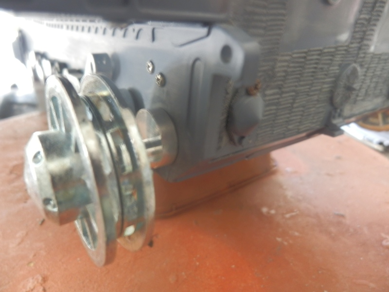

The OEM H/L Tiger idler mounts were 143mm wide, and these things fitteed as tight as I can get them are 140mm.
So all I need is a 1.5mm washer or spacer to take up the slack each side.

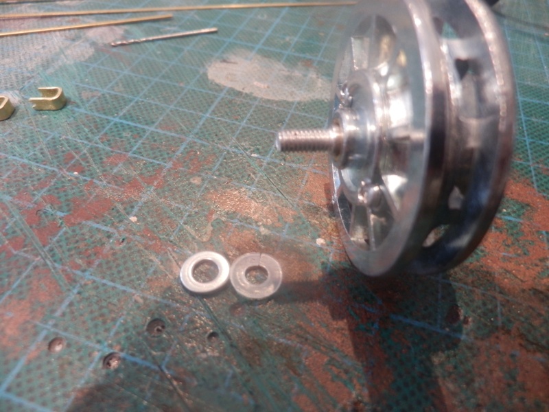

I found a couple of washers and 2 plastic washers to fit between the screw and the idler which set the things in the right place, and removed any slop in the idlers.

As requested.
The measurement across the outside of the idler mounts needs to be 143mm
Add washers and plastic shims- voila !!
shims and washer over each axle

The threaded rod is not screwed into the mounts-thats the odd thing.
The rod sits in clearance holes with the nuts being used to add outward pressure on both sides.
The black brackets are the bits that carry to load and retain the idlers in position.
Having run my white Tiger a lot with no tension system at all in it has not presented any problems, but the thing did shed the right track all the time(as all H/L Tigers do) until I took the time to shim it into correct alignment.
