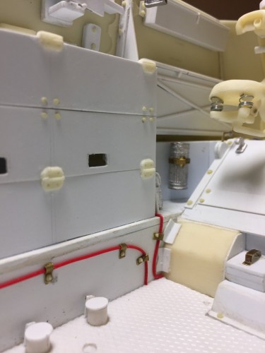

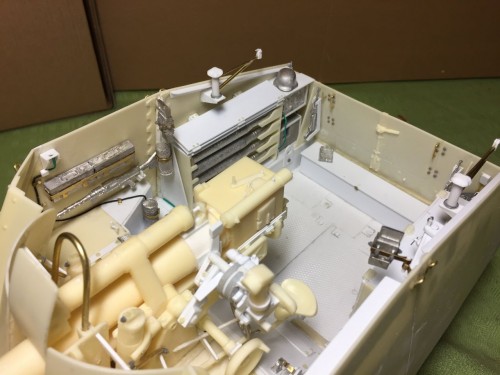

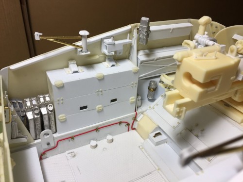

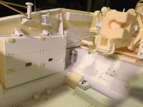

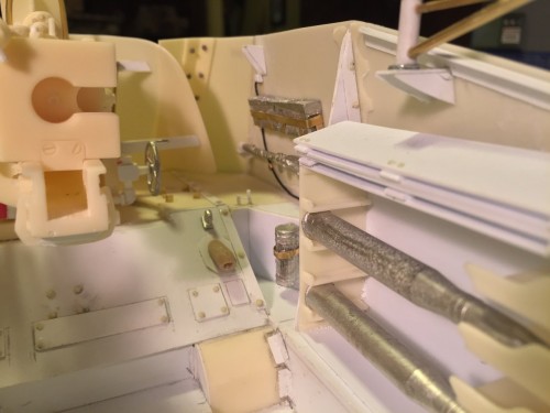

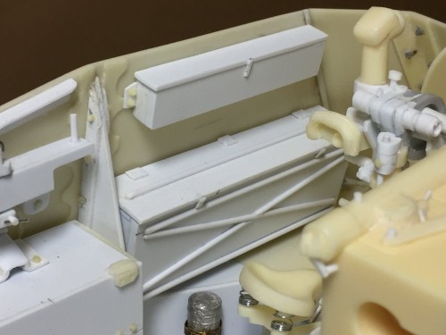

With this step, the last interior modules were built in plasticard and installed, this is the optical equipment bin on top and the tools bin below. The locking clamps are temporary as I have some photo etched on order.
Nashorn interior
Nashorn interior
Nashorn interior optical and tool bins

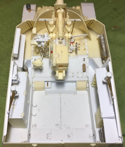

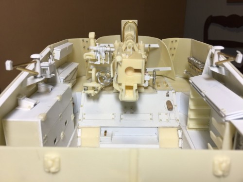

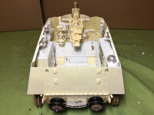

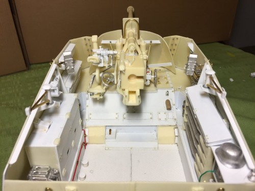

This is the overall interior now. It is mostly completed. I need to install some telecom wiring in a few places and some other miscellaneous equipments and brackets that i see on pictures. This is the fun part.
Nashorn interior
Nashorn interior
Nashorn interior
Nashorn interior

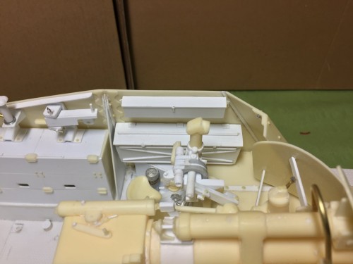

The temporary MG 34 stand I did last week was replaced by my interpretation of the pictures I saw of the stand on a Hummel. The surviving Nashorn no longer have their MG stands.

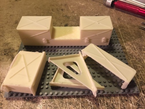

First, I wanted to show you some parts provided with the kit. I recognize some braces from the Munster Hummel. And some terribly formed bins vaguely resembling those seen on a Hummel as well. So, Juckenburg provided Hummel parts for the Nashorn, which should not be the same. I have no use for these.
Juckenburg Hummel interior parts provided with Nashorn

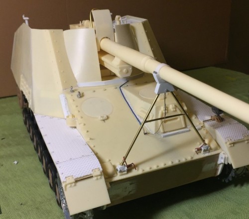

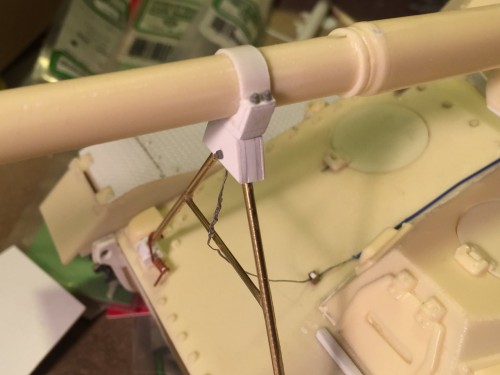

Here is the Hummel or early Hornisse barrel clamp provided with the kit. The ring fits the 150mm barrel of the Hummel. I have no use for these either.
Juckenburg Hummel barrel clamp provided with Nashorn

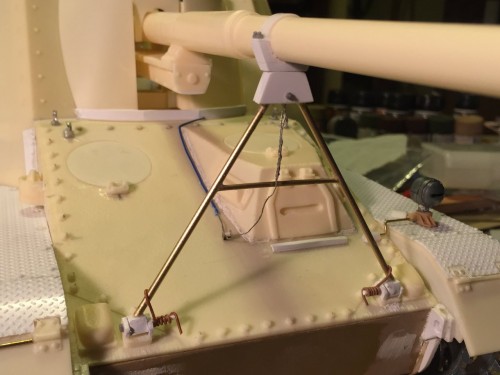

Here is the Nashorn barrel clamp as it should be on this kit, as shown on the excellent book "Panzers at Saumur, vol 3".

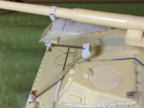

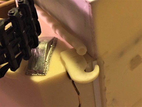

I worked hard to recreate the clamp from pictures, including the release mechanism. The Nashorn is equipped with a barrel clamp that is released from the inside of the fighting compartment. The Hummel type clamp installed on early Hornisse was requiring a crew member to come out in the open, climb the glacis and manually release the clamp while totally exposed to gun fire.
All barrel clamp parts needed to be scratch built.

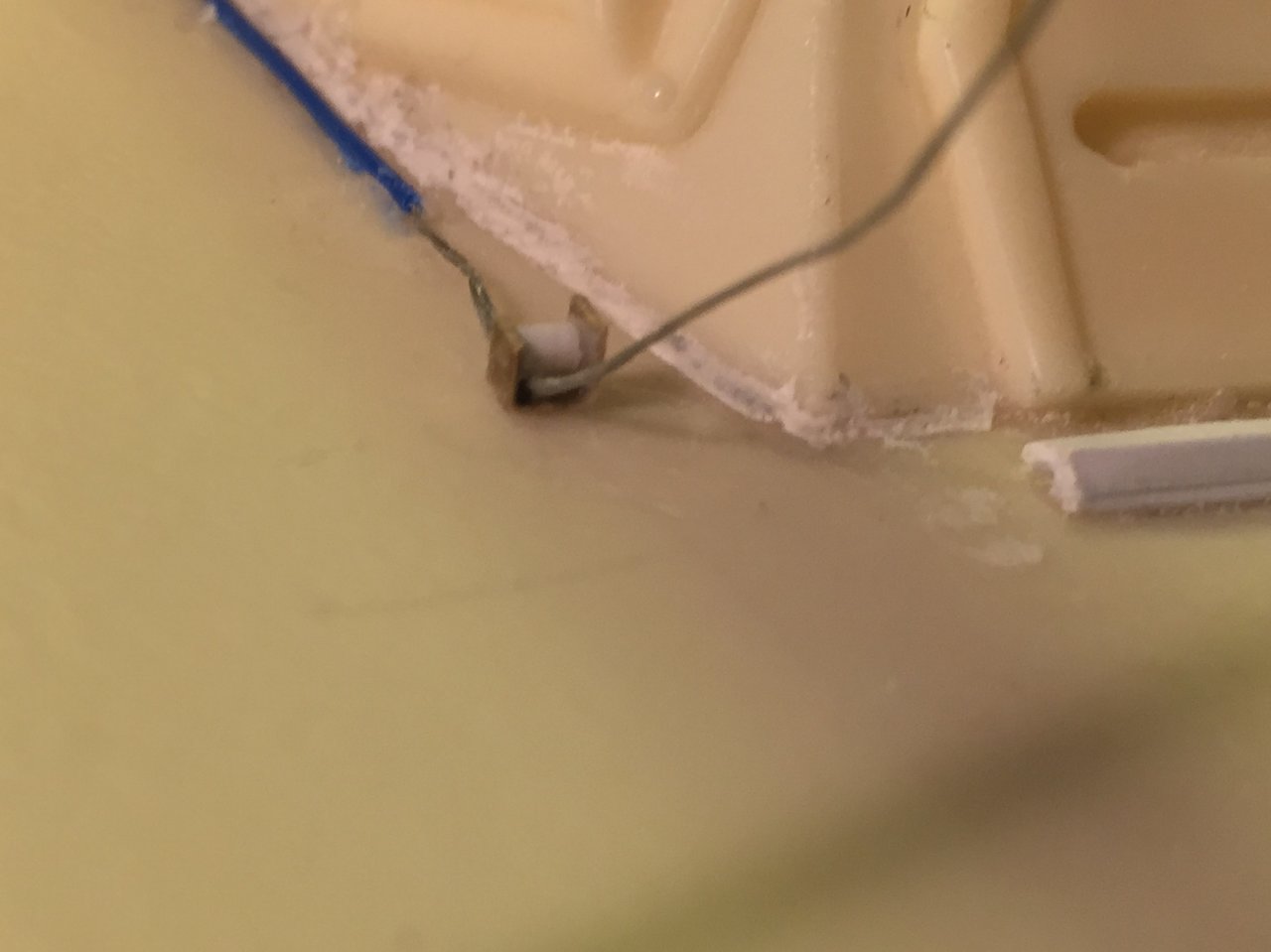

Once released, the clamp falls on the glacis and the gun is let loose. However, you can see that the kit part for the driver compartment is oversized, likely by 20%.

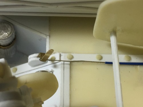

This is the simple release mechanism installed on the left of the gun inside the fighting compartment. it pulls the wire all the way to the tip of the clamp.

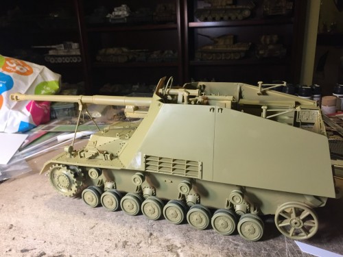

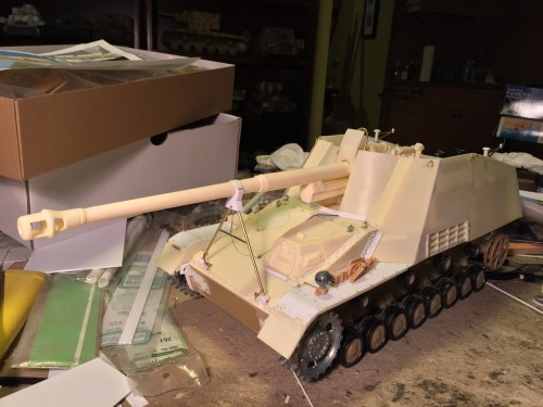

Overview of the Nashorn at this time
Nashorn
Nashorn

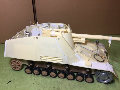

The model as it stands today.
Nashorn
Nashorn

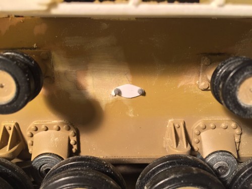

This is the "track pin replacing plate", installed at the rear on both sides. It is designed to push loose pins back in place. The parts are available on ebay for a couple of euros from a German dealer, advertised as a Ketten-Abstandshalter. Not having to scratch build something is a rare luxury.
Track pin replacing plate

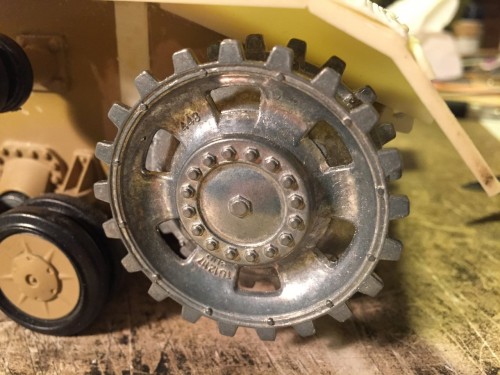

Nashorn have a Panzer III sprocket. Later Nashorns have the Ausf J version with many seen on pictures without the hub cap, which is more interesting. The Mato metal sprocket is oversized I think.
Panzer III Ausf J sprocket

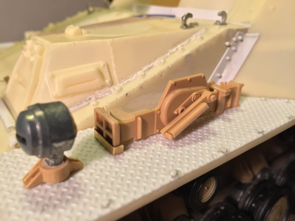

A Tamiya Pz-IV jack was installed. My parts reserve is getting depleted.
Tamiya jack
Tamiya jack
The jacking block. An actual kit part that can be used...
Jacking block
Jacking block

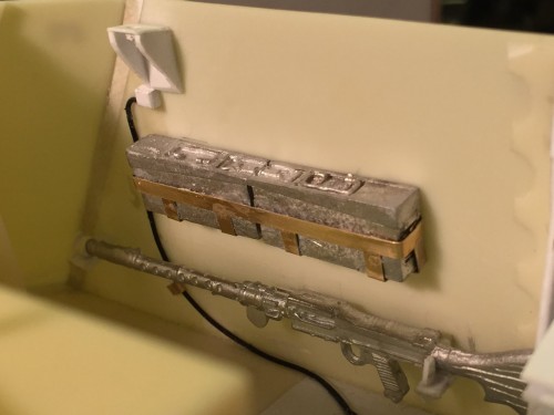

Started some of the interior radio wiring. I think it adds a lot to the look.
radio wiring and MG-34 stand

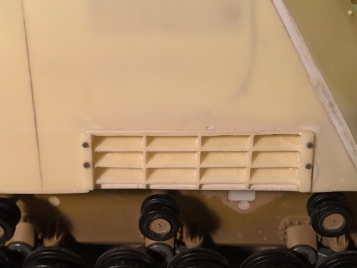

The air intake as they currently stand. I do not think I can do better than this. Sanding them just make more air bubbles come out.
Air intakes
Air intakes

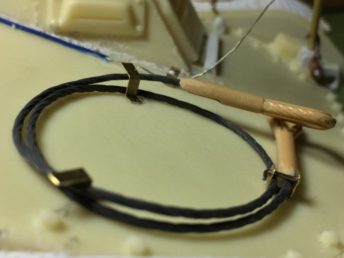

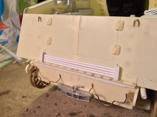

The tow cable arrangement is in place n the glacis.
Nashorn tow cable
Nashorn tow cable

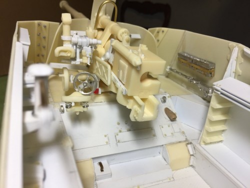

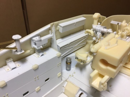

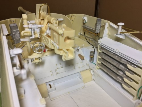

Latest interior views. The periscope were added, one on each side. Their mounting is quite fragile. Telecom wires are in place.
Nashorn interior
Nashorn interior
Nashorn interior
Nashorn interior
8 rounds will eventually fill the ammo bin on the right.
Nashorn interior
Nashorn interior
Nashorn interior
Nashorn interior
Nashorn interior
Nashorn interior
Nashorn interior
Nashorn interior

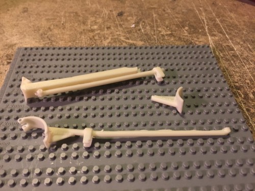

These are the gun cleaning rods. The Nashorn carries these connecting rods at the rear, and not to be confused with the longer "gun aiming posts" carried at the same location by the Hummel SP howitzer.
Gun cleaning rods
Gun cleaning rods

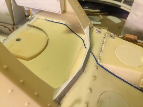

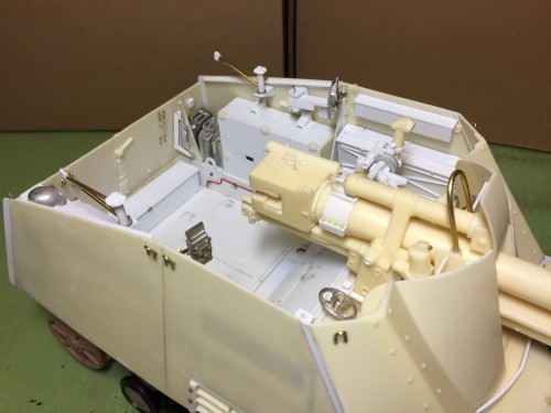

I did a better job on the armor section at the base of the gun shield, modelled on Aberdeen.
Nashorn shield armor

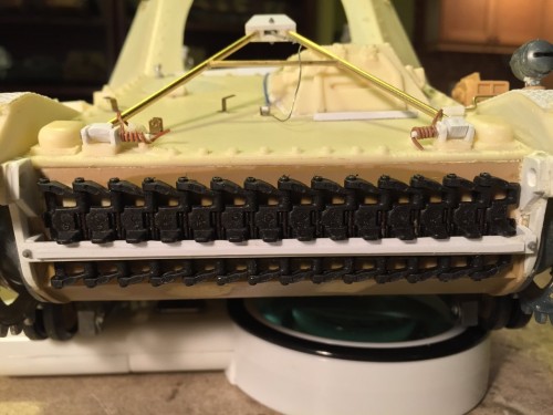

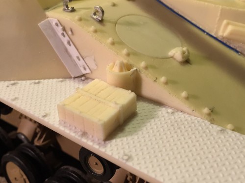

Spare tracks installed at the front, as usual.
Spare tracks holder
Spare tracks holder

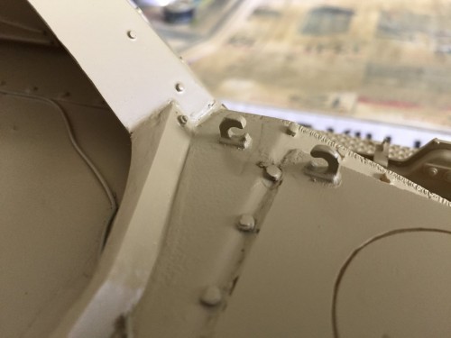

At this point, I bring the model in the sunlight and take close up pictures of everything. It is very easy to spot every little thing that needs to be corrected by zooming at these with a PC screen. As you can see in the picture below, there are residues next to some bolts and hooks. These are present all over the model. A short 20 minutes exercise of cleaning these with a small blade will greatly improve the look. But I always have to remember that this is a rough WW2 vehicle build by hand, not a shiny Ferrari, so it is actually quite realistic to leave imperfections in places.
Nashorn error correction process
