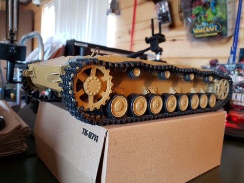

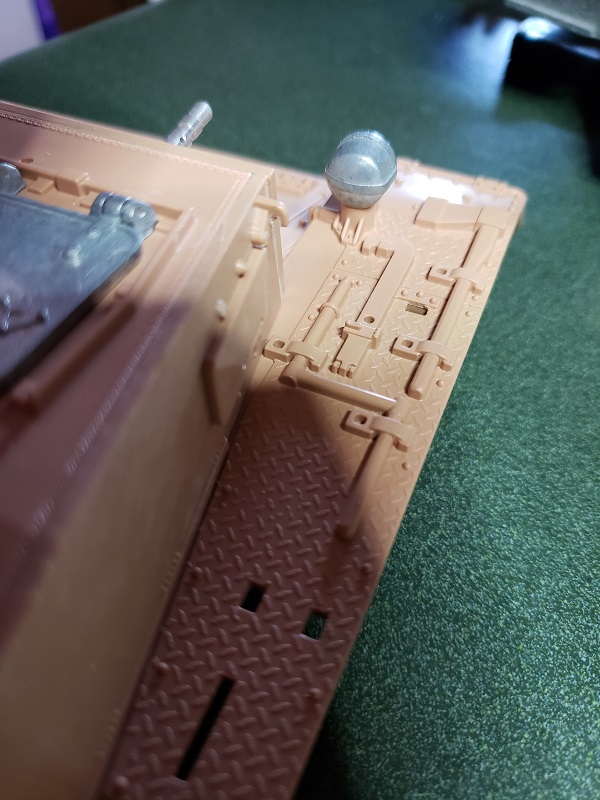

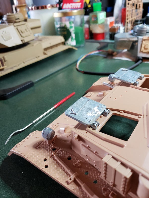

A little more work tonight on hook reformation and seeing how I can make the deck look more like an F than the J model. It is going to take some work to change out the barrel and mantlet but hopefully, not as much as the early StuG or the Pershing build....
Pics: ( Click to Enlarge )

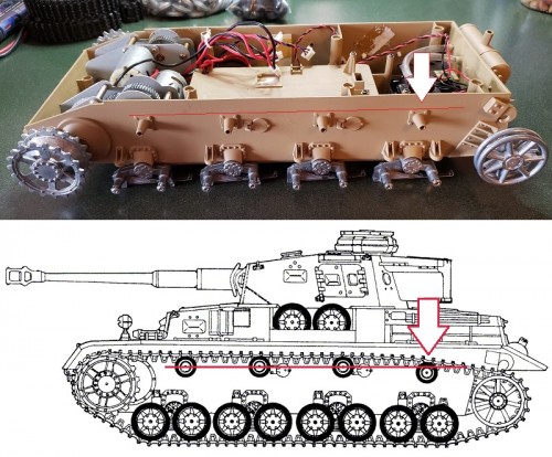

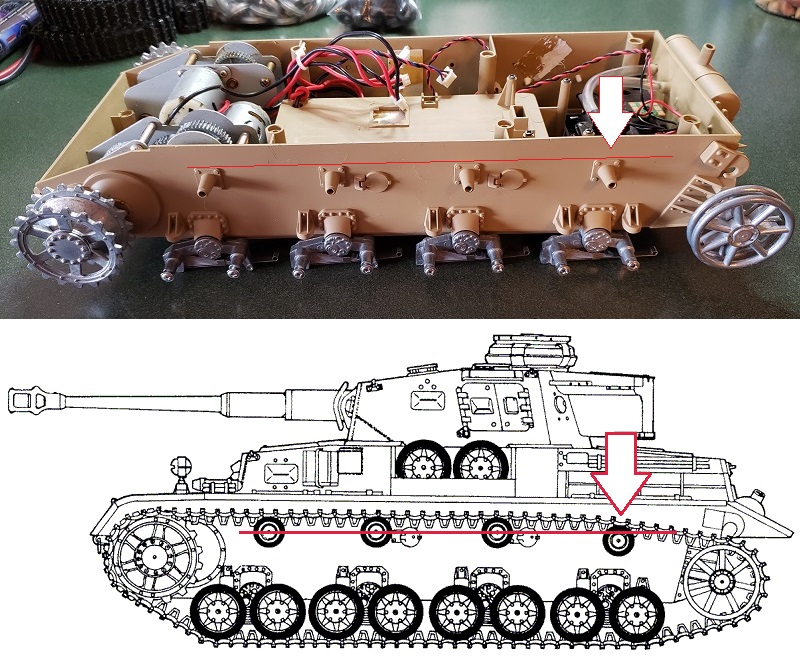

Looking good but will you do something with a notorious Heng Long error - the last roll?
- Posts: 7985
Re: 1942 DAK Panzer IV
Mornin' Oddball,
I'll be giving no negative waves today. ;o) I looked at the last roller and while it was dropped a 'little bit' during the initial hull casting, you are right in noting that it has a way to go to be completely accurate. This is a case of where I would rather have the sheer strength of the contact point of the roller mount intact instead of the completely correct appearance. I am already dealing with this nonsense on my Stuart build ( not enough sheer attachment strength available at the rear return roller ) I run my tanks here with the tracks on the slack side to avoid binding from the numerous stones and rocks of the back 'rough' That will help with appearances I think.

I am with you here Painless,
The conversion on the original Plastic Heng Long Hull was not too challenging as long as you use "R" clips instead of "C" clips to retain the rollers axles,
The Taigen Metal hull requires a little more work but having viewed still and video of PZ4s in the field the amazing amount of slack in the tracks when on the "run" should have them falling off in no time and yet they stay in place on the rollers and because they are so slack telling the difference between four in line rollers and three and a dropped roller is not at all easy.
(I am of course using metal tracks)
If your building a shelf queen then yes do get it right but a working model needs to have certain compromises or it will not be a working model for long.
Either way your build is as ever most impressive.
- Posts: 7985
Good Morning, my Friend,
This lower is a HL plastic hull but it is so old that the return roller pins are just push ins, no clips to retain them... The walls are thin enough that removing the post mount for the rear roller and repositioning it would not give a lot of 'meat' for the attachment point even with epoxy. Best to let this sleeping dog lay. ( I am using all metal running gear and tracks so there is that as well ) Thanks for looking in. It is a treat to hear from the Panzer Meister. ;o)
