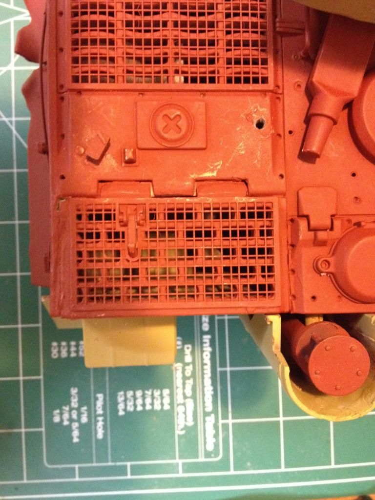

HERMAN BIX wrote:You nailed the air cleaner bodies now mate- top job.
Bummer about the engine deck hinges after that effort and achievement to cut them out like you did.
Was it a lack of options for them, or just didnt feel right ?
The hinges were too obvious, I couldn't find a way to hide them and still make them work properly, I tried scratch building styrene hinges , they worked but were too weak after several times opening they fell apart :-<
It's cool though was a learning experience :)
Hey Mark... I used some tin plate from the bottom of a can... Check my L70 build... I just got some pictures of my gun support made from the tin... great stuff pretty pliable and strong...Now that I can post photos again...I can draw you up a diagram of how you can make some hinges and PM it to you ;)

ALPHA wrote:
That would be great Alpha. Maybe I will have another go at it :think:

Markocaster wrote:
ALPHA wrote:
Markocaster wrote: The hinges were too obvious, I couldn't find a way to hide them and still make them work properly, I tried scratch building styrene hinges , they worked but were too weak after several times opening they fell apart :-<
On it...you got examples of the hinges you want to make? are they the ones on the engine covers?

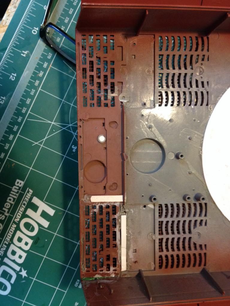

ALPHA wrote:
Markocaster wrote:
ALPHA wrote: Hey Mark... I used some tin plate from the bottom of a can... Check my L70 build... I just got some pictures of my gun support made from the tin... great stuff pretty pliable and strong...Now that I can post photos again...I can draw you up a diagram of how you can make some hinges and PM it to you ;)
Yes sir. It's the engine covers. Here are a couple of pics.
Was thinking if I built a styrene "frame" under the cover first that may help?
