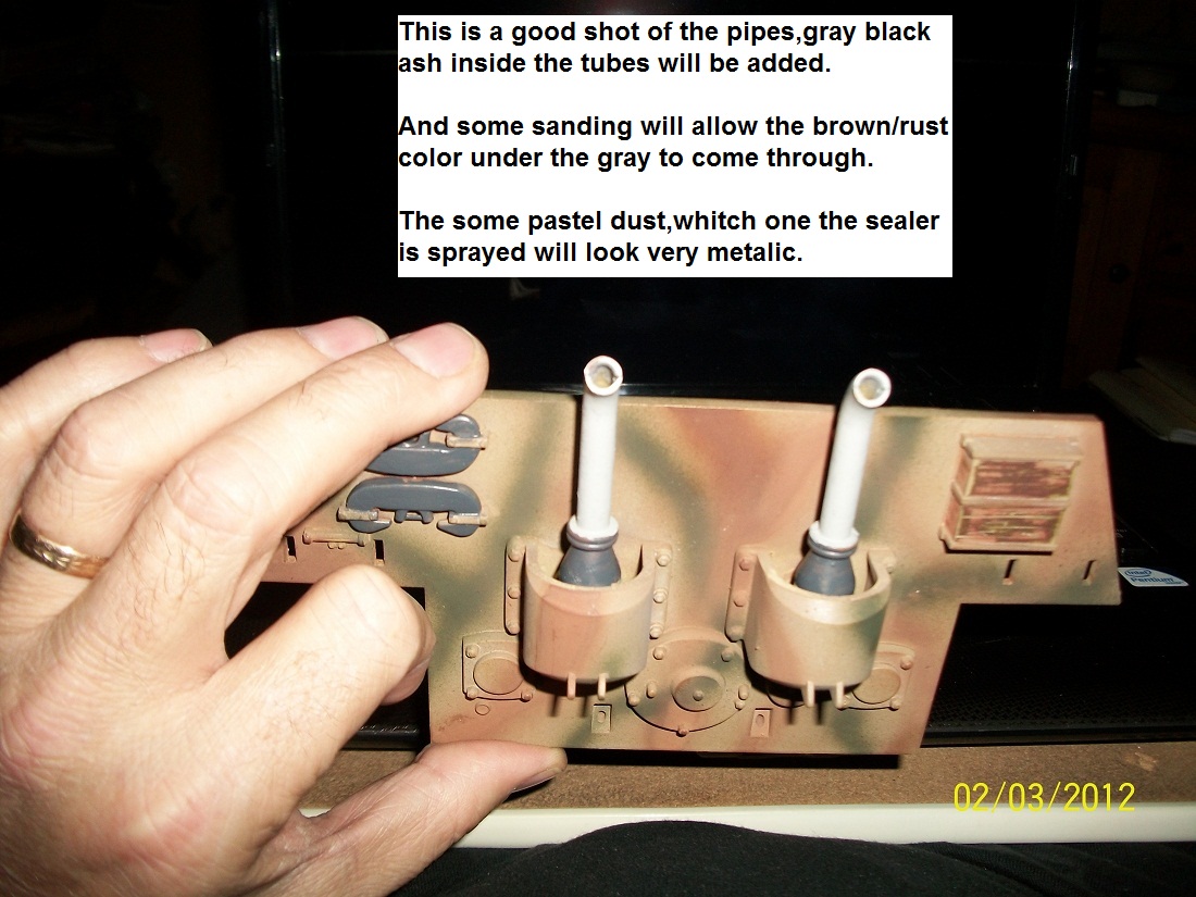

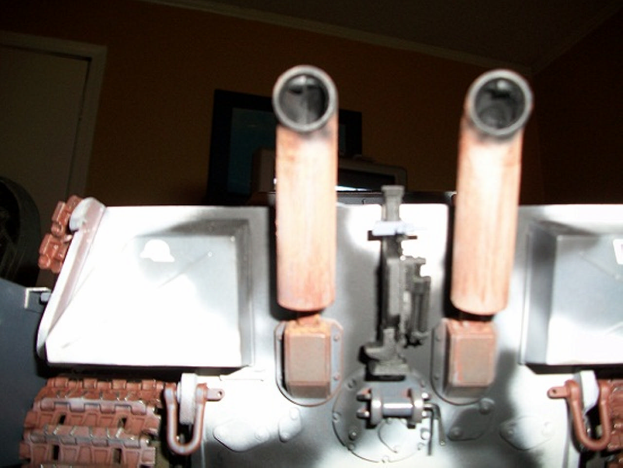

Once that is done I will spray the last coat of KLEAR/MATTE and start the reassembly process,adding the gun and some other detailed parts,I also have started the detailing of the rear plate and in these picture the gray on the exhaust pipes is a flat Gull enamel Gray,it will be soft when I sand it and start applying the Pastel dusts to give it the heated metal look of my earlier builds.
This time I AM doing things a little different so we shall see? Considering a blue light,as well.

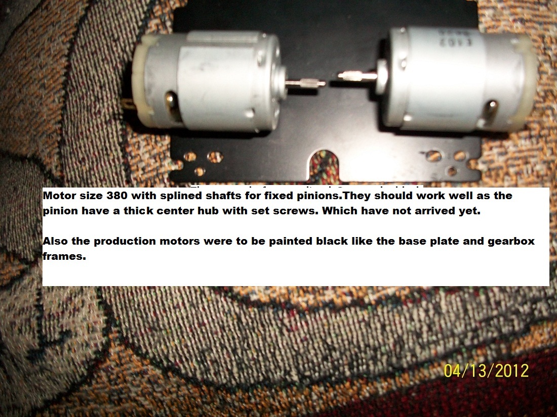

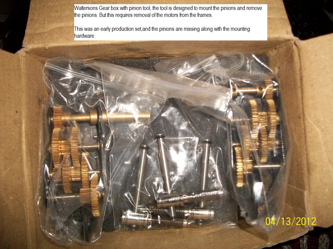

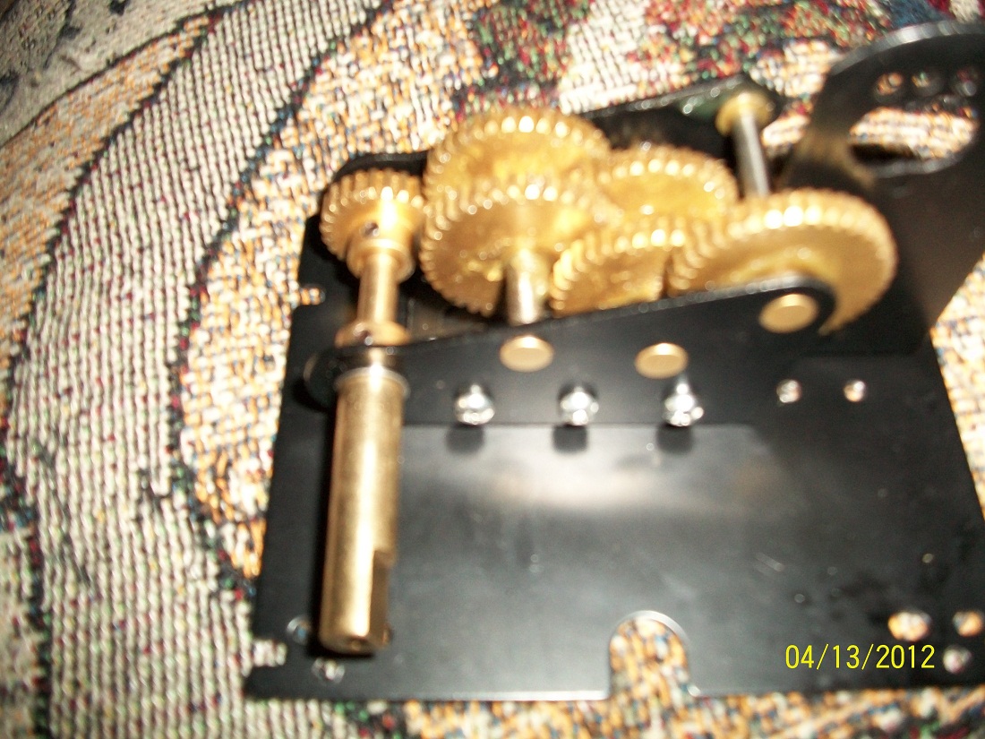

I have been waiting for the new Waltersons Gear Box with interchangeable pinions and the splined shaft motors now for months. The gearbox arrived about a month back but minus the pinions or the hardware to mount the new plate to the hull,or the motors to the frames.
It has been a headache,bigtime. So for now and to make some progress I have reinstalled the original gearboxes,and built the tank up to the point of installing the electronics and the gun system.
Here are a few resent photos of this long term project,as for the Waltersons Gear box they seem well built,and the splined motor shafts will certainly prevent any pinion slippage but without the pinions their impossible to use.

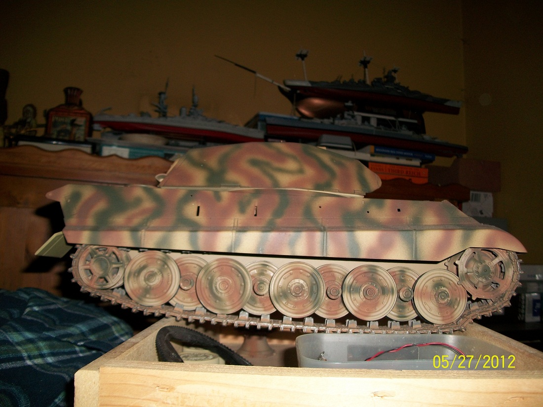

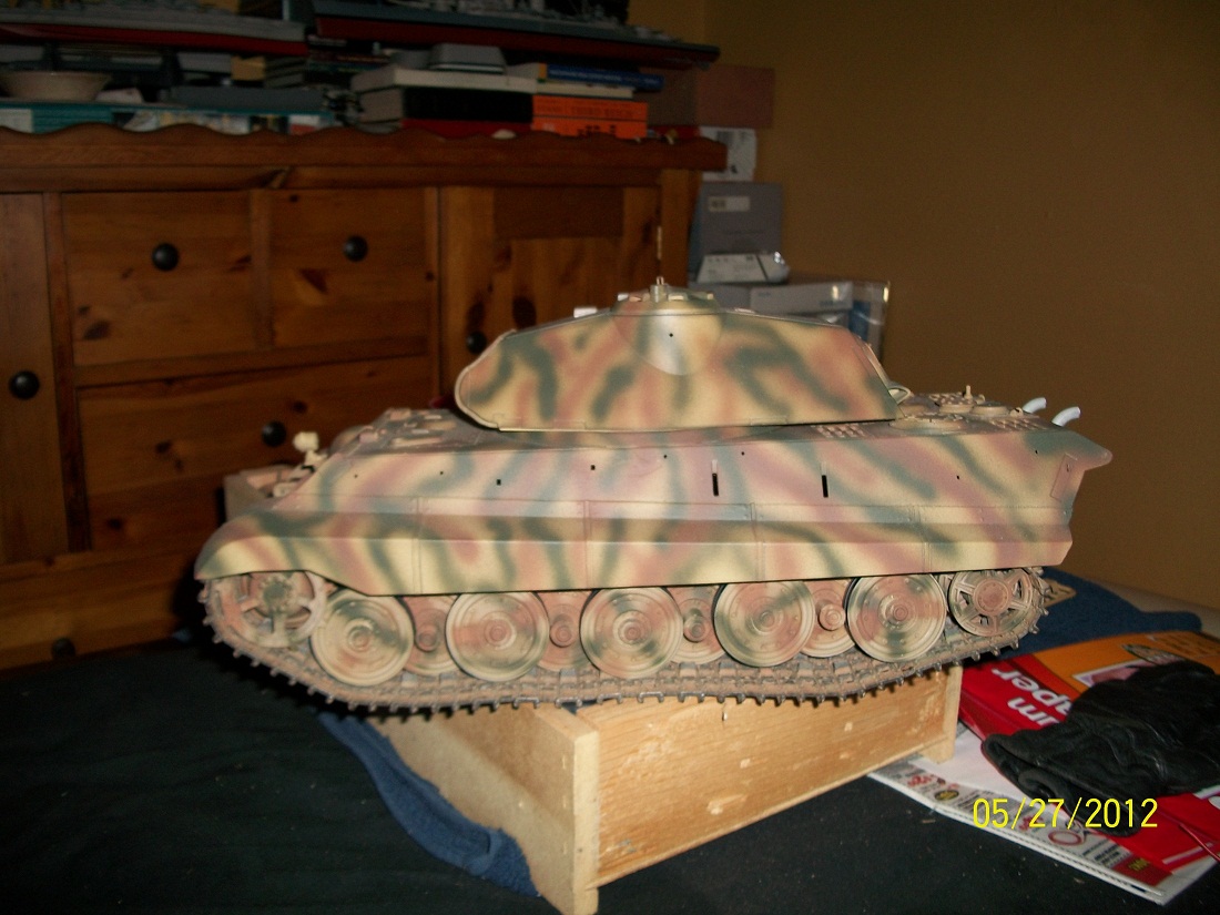

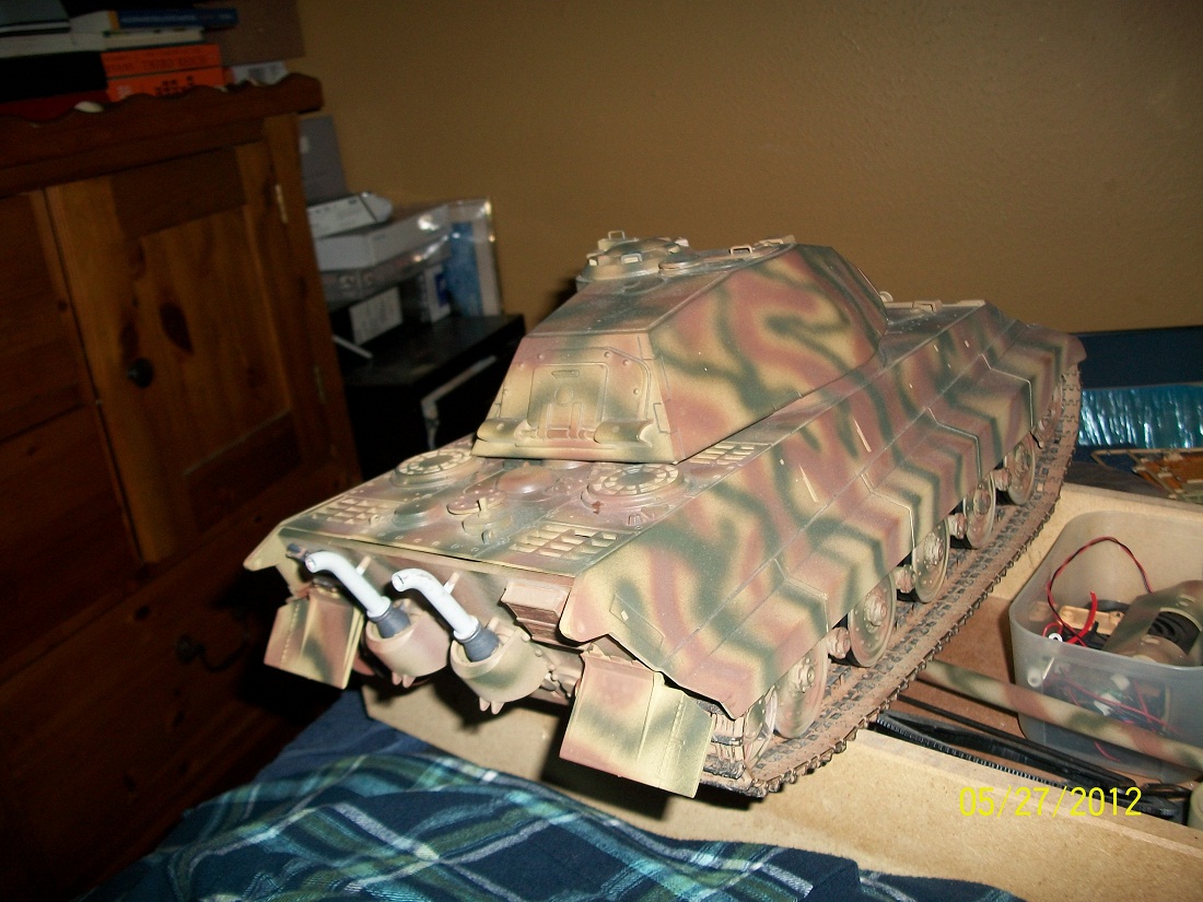

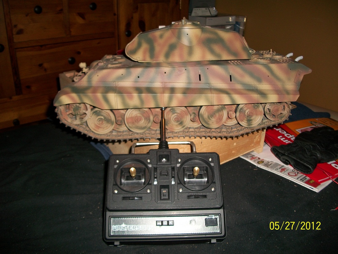

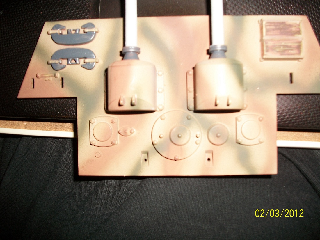

This has been a very long build,but the paintwork has been done to the best possible level,the internal and external parts being primed,the lower hull is primed and painted base XF60m.The track guards are painted top and bottom,the wheels are each painted and primered on the back side.
Well here are a few shots,the wheels and the overall paintwork is uniformed,and I am sure this is going to be a fine looking Porsche when completed with the Decals and Hull equipment installed.The Tracks are weathered as well.

looks like the Walterson gear box is still using brass shafts. Are they a better quality than the Mato series II gears?

Fantastic camo scheme, I am very envious!
