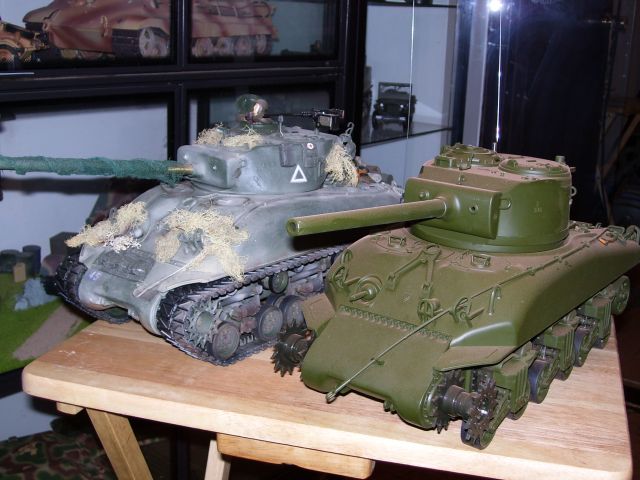

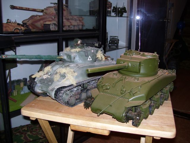

Looks like there is no way that it will fit a tammy hull..........
please keep us posted mate , and we are very grateful too you for all this info.

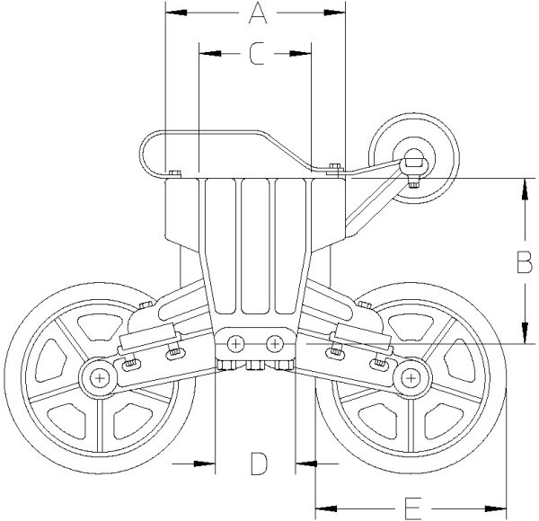

Here's the actual specs for the VVSS bogie.
Actual Size To 1/16 Scale Mato Mart Difference Percentage
A 19 1.188 1.25 -0.063 95%
B 17.5 1.094 1.125 -0.031 97%
C 11.75 0.734 0.750 -0.016 98%
D 8.375 0.524 0.594 -0.070 88%
E 20 1.250 1.313 -0.063 95%
Wheel to Wheel Spacing 33 2.063 2.156 -0.094 96%
Roller Wheel Diameter 9 0.563 0.563 0.000 100%
Sorry for the numbers getting all scrunched up, looks good when you write and edit!
When you figure in the slight variations from all the foundries that made the Sherman one will notice detail and size differences between the factories, especially at the bottom of the Suspension Bracket where the gudgeons are.
