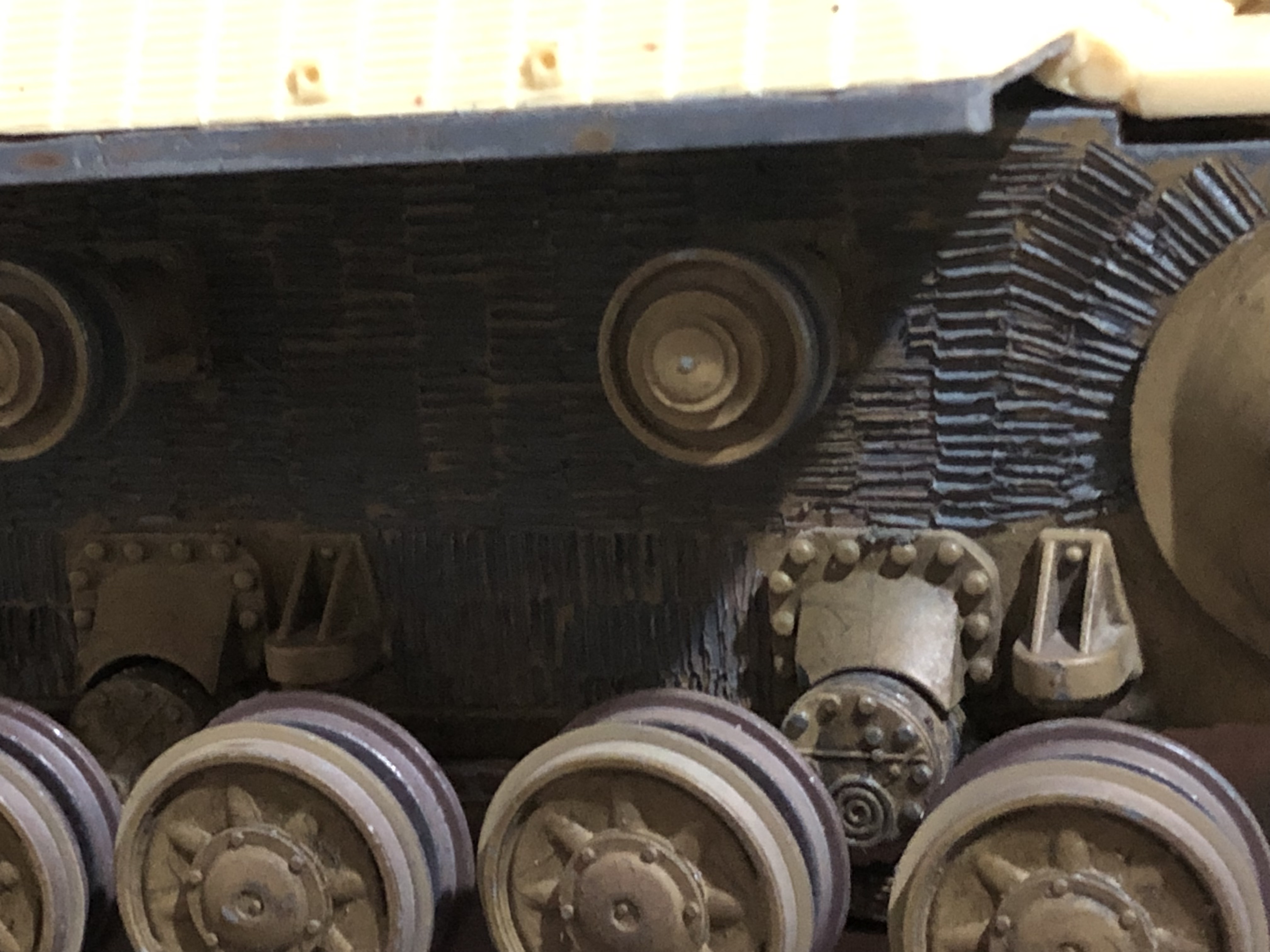

Speaking of poor decision making !

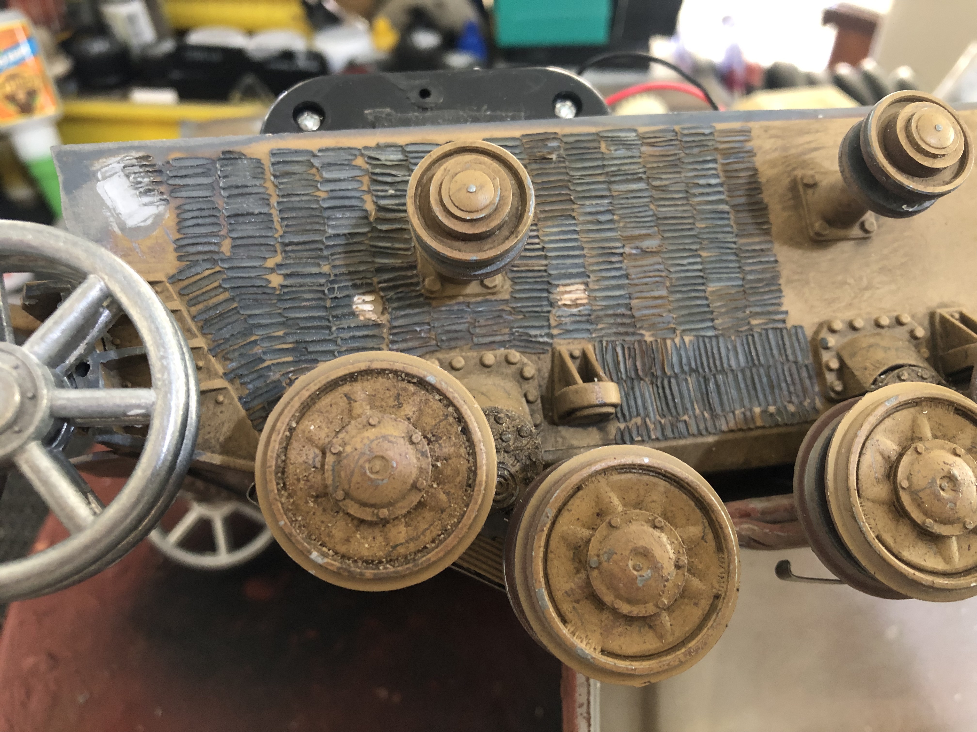

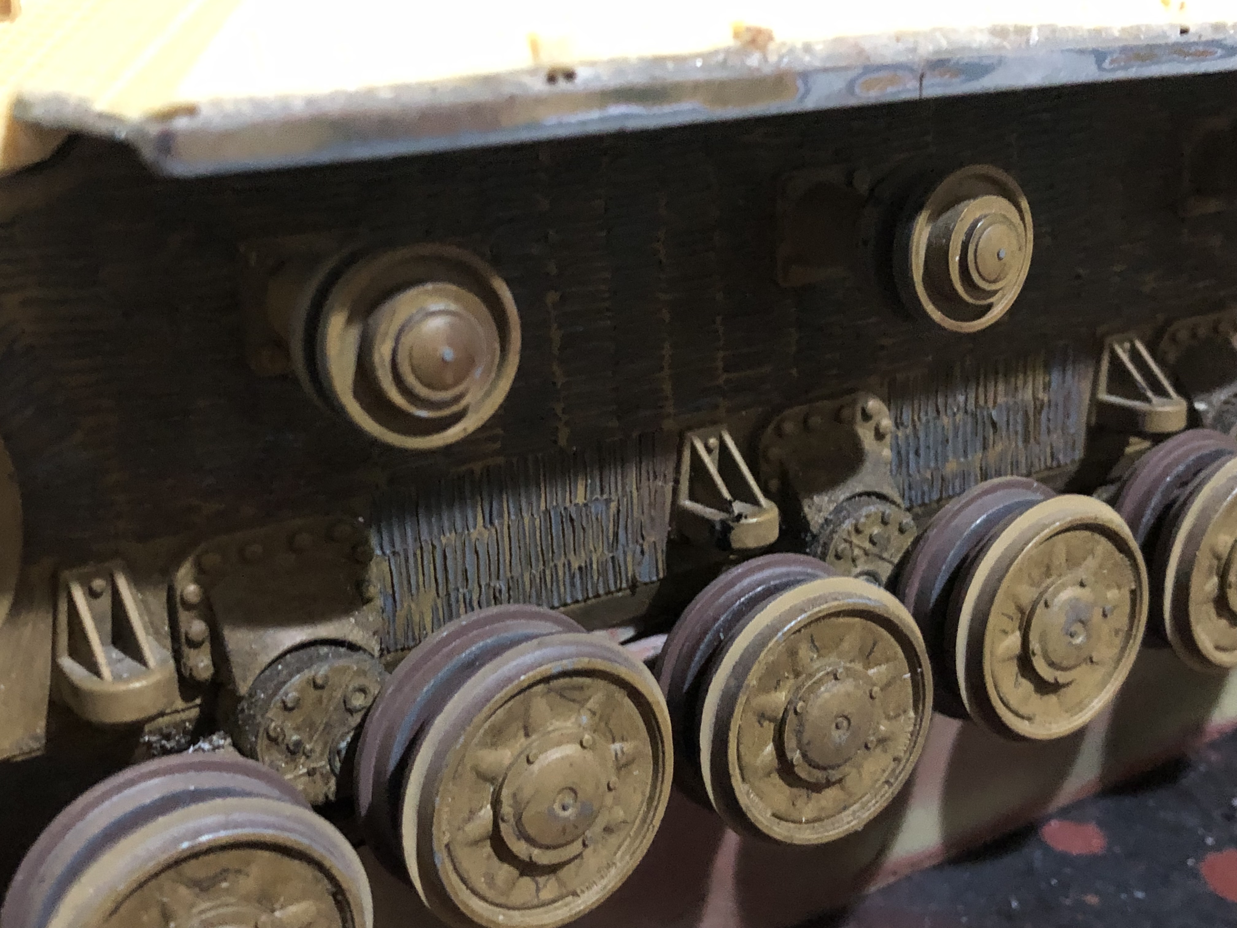

As this version I will call a Mid has Zimmerit in the Casemate it needs it on the lower hull too.
No Atak here so it out with the hot screwdriver again .
Not that it’s going to be very prominent but it’s there!

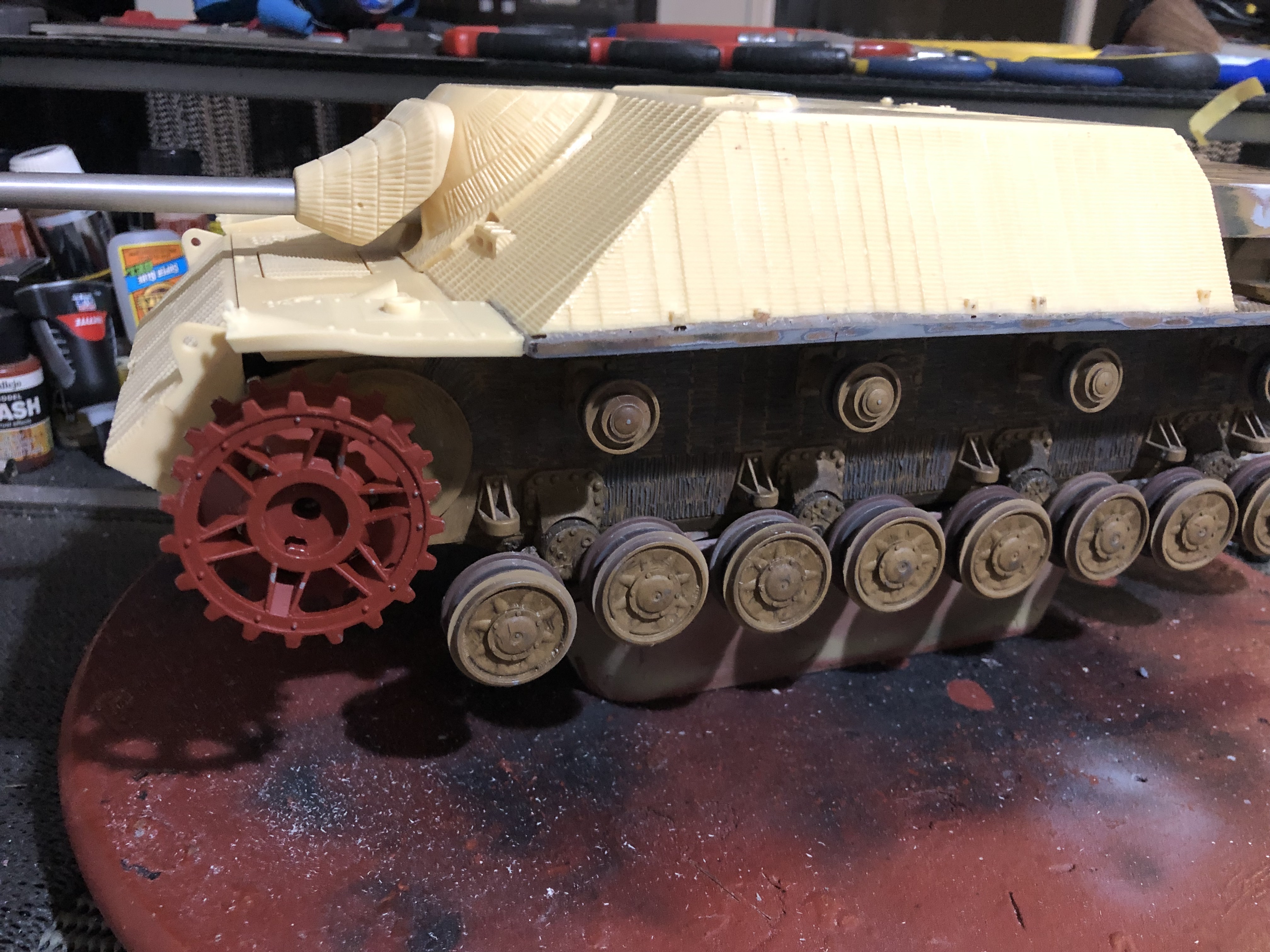

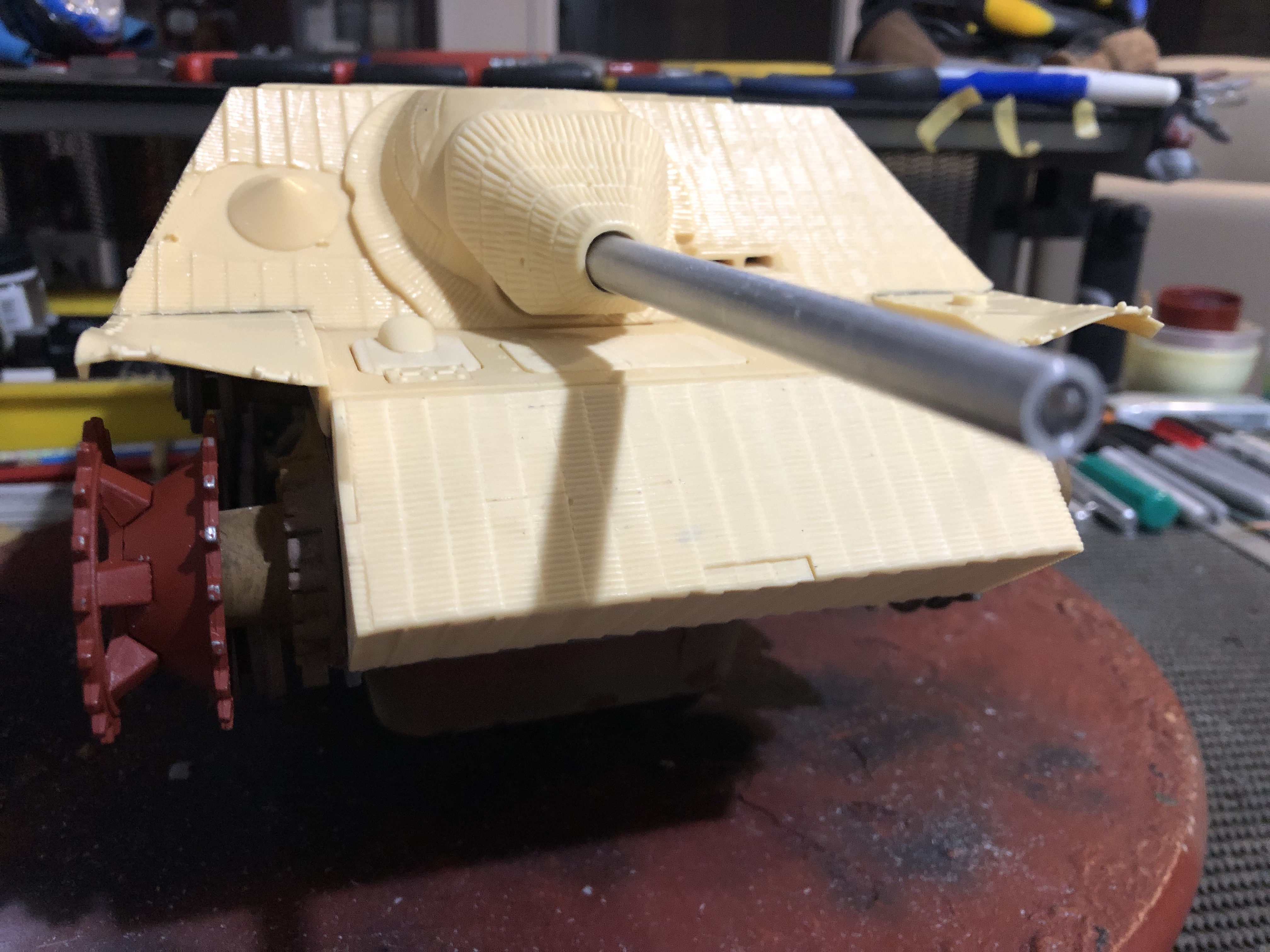

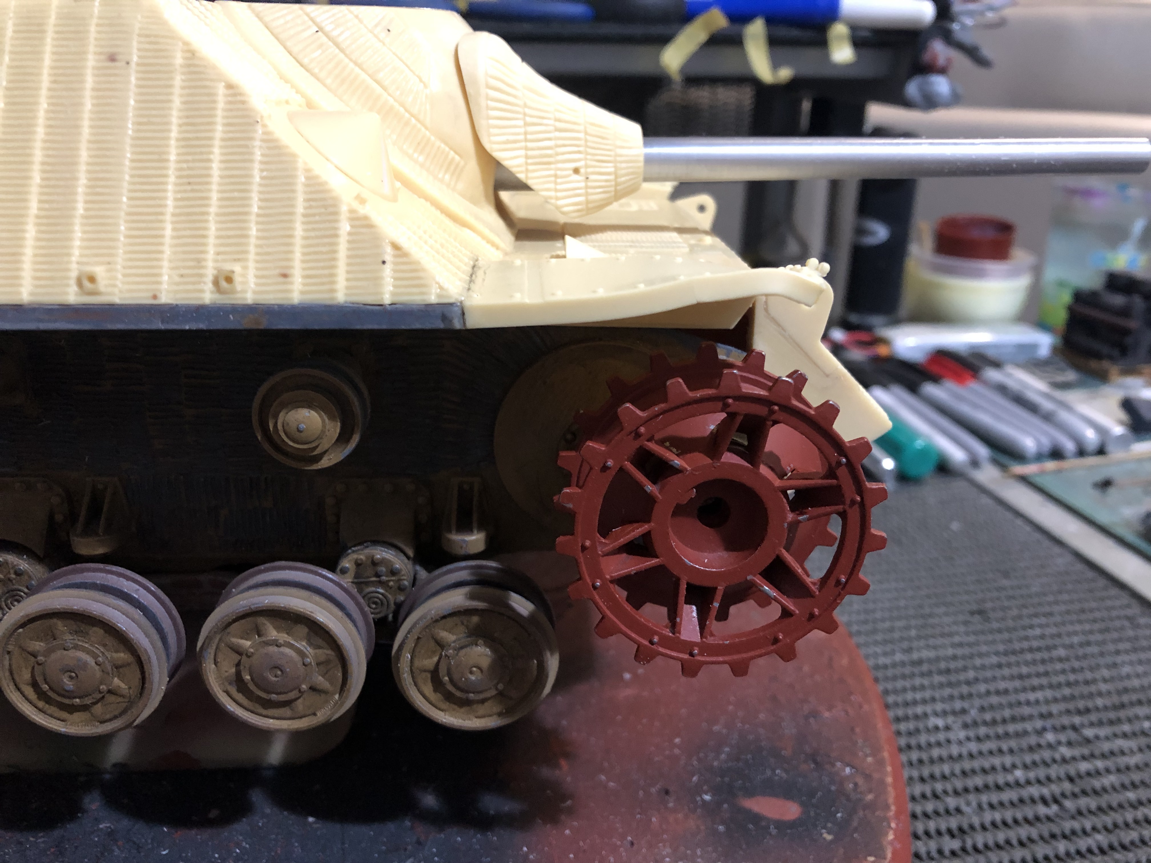

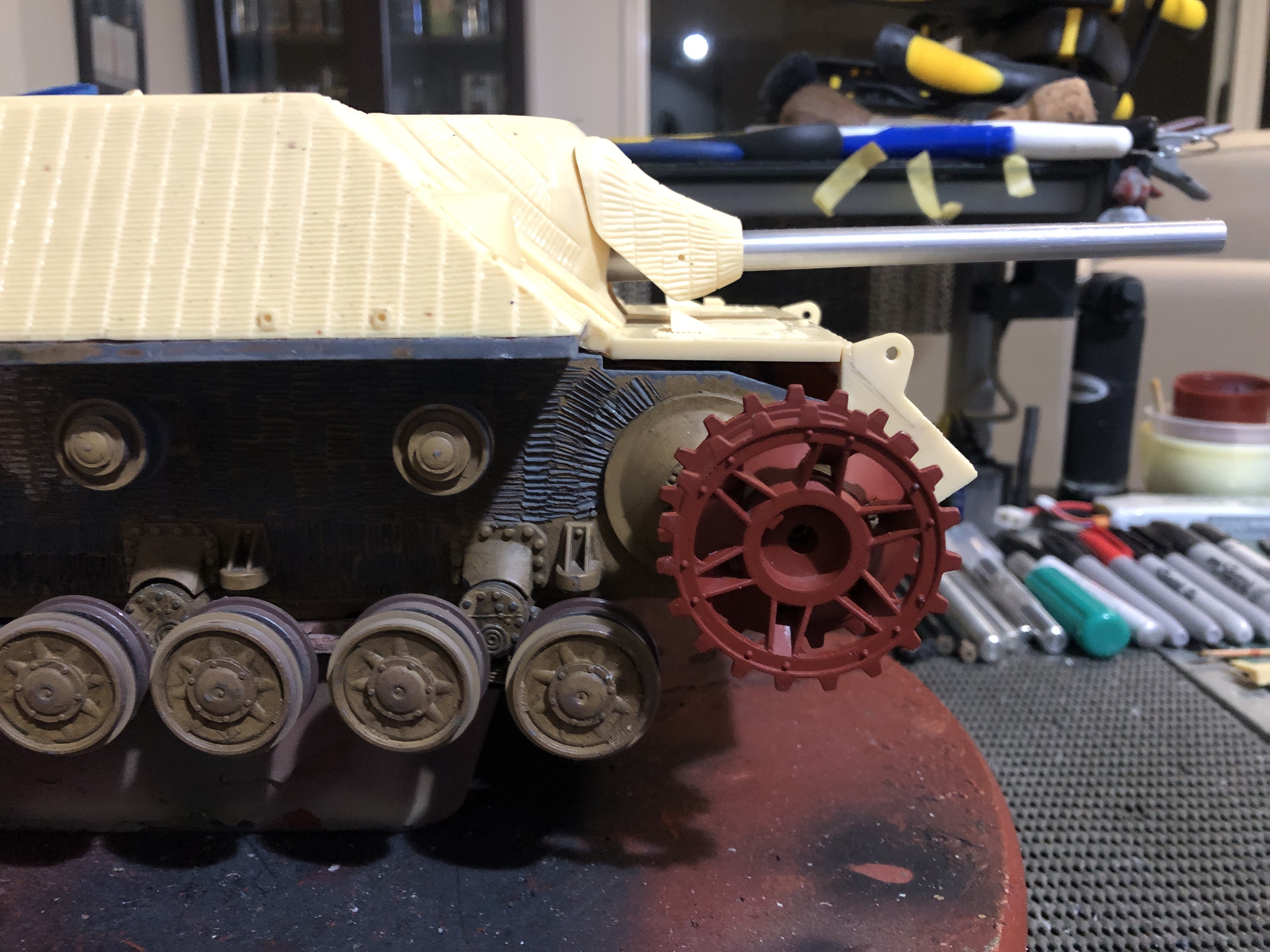

Going against my rough instinct the front guards are on.
Carefully sliced the very front sections off and dressed to be thin looking.
I also filed the hinges to remove the bits that would have been affected by the damage.
Held in boiling water for long enough to soften the resin then distressed with pliers gently.
I’m starting to love this thing !

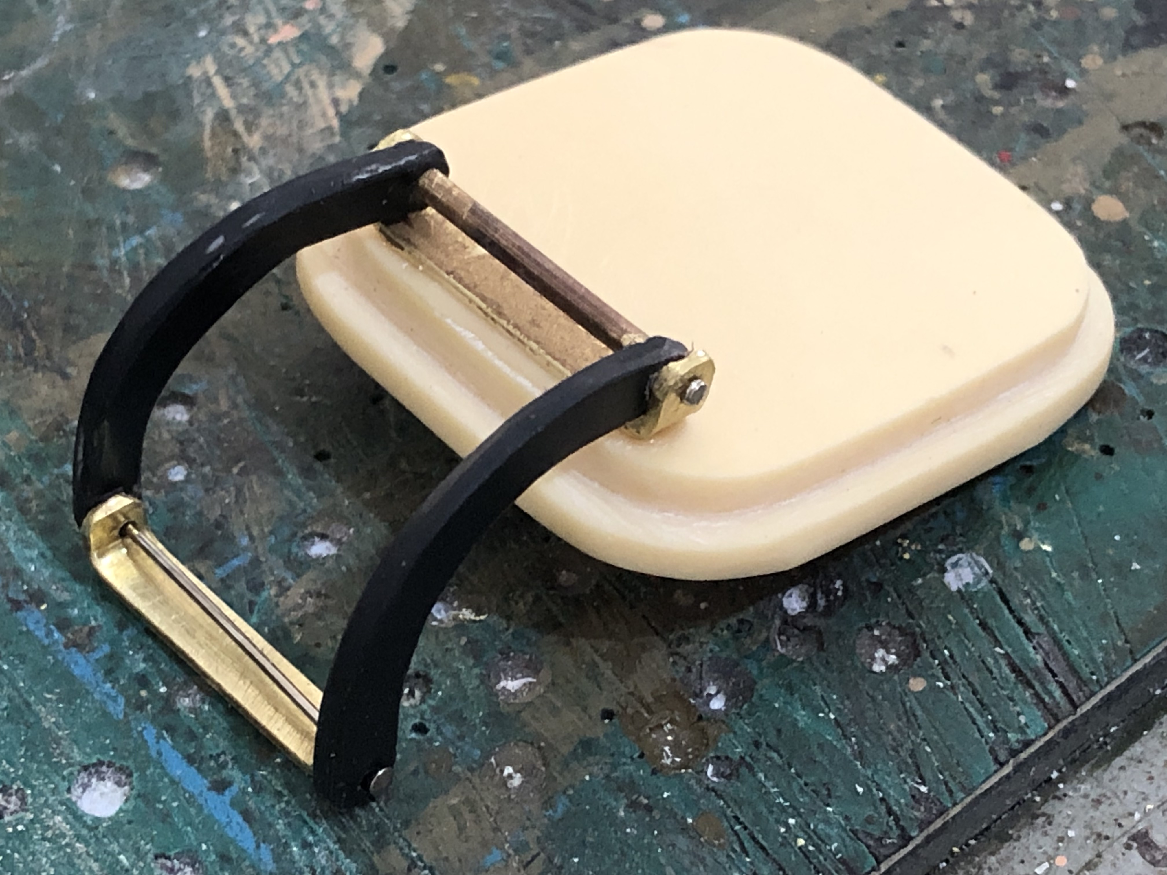

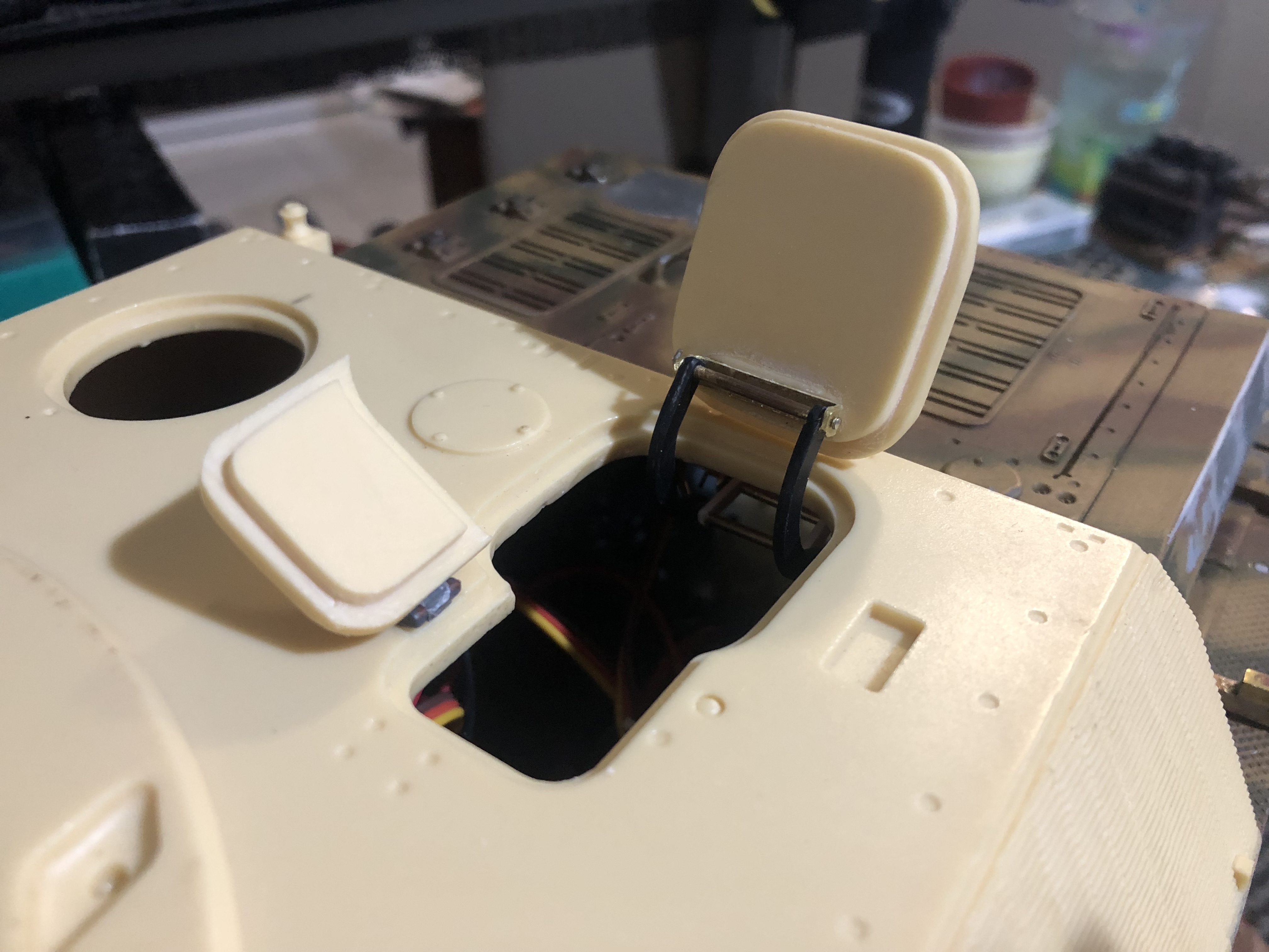

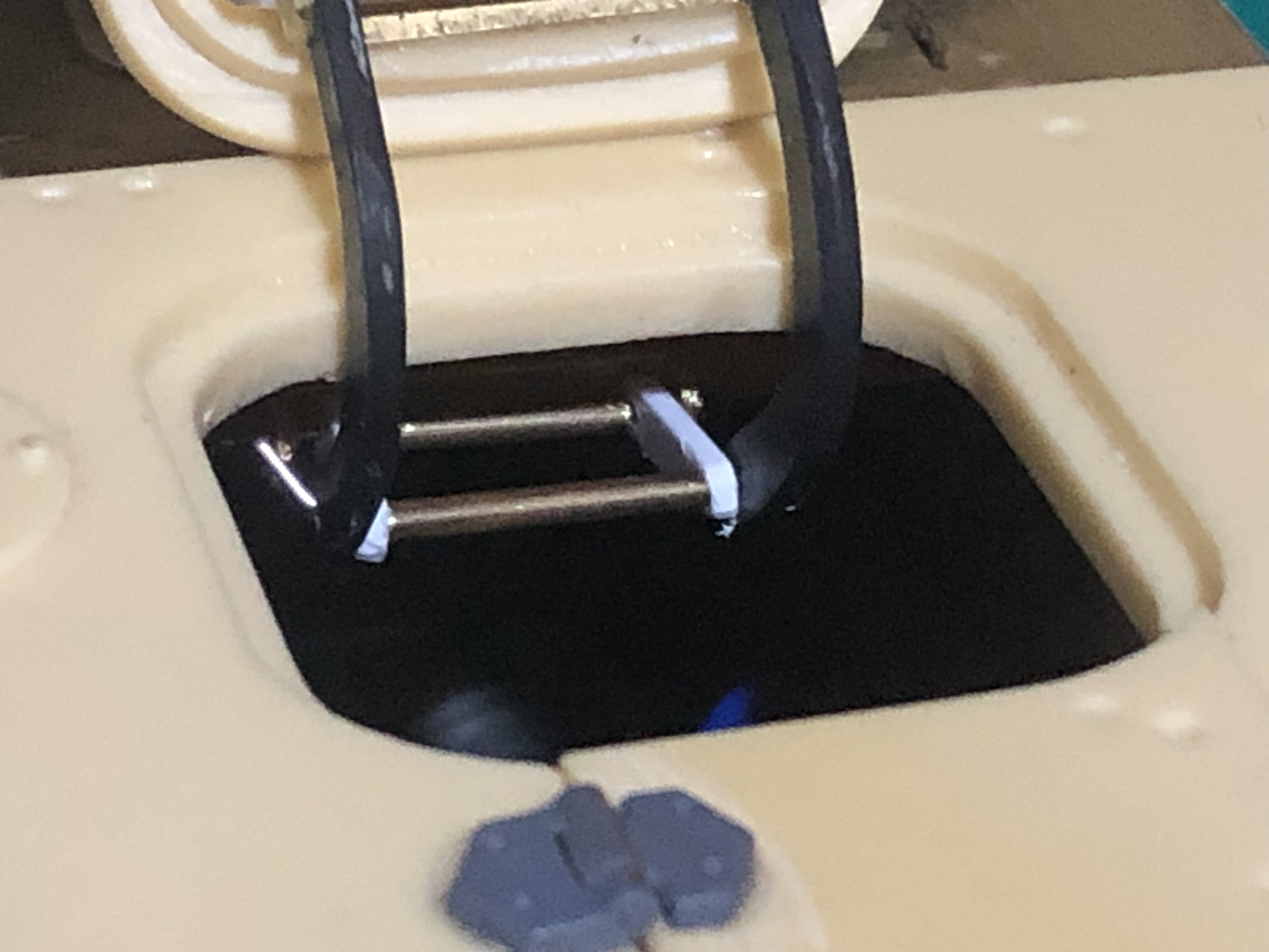

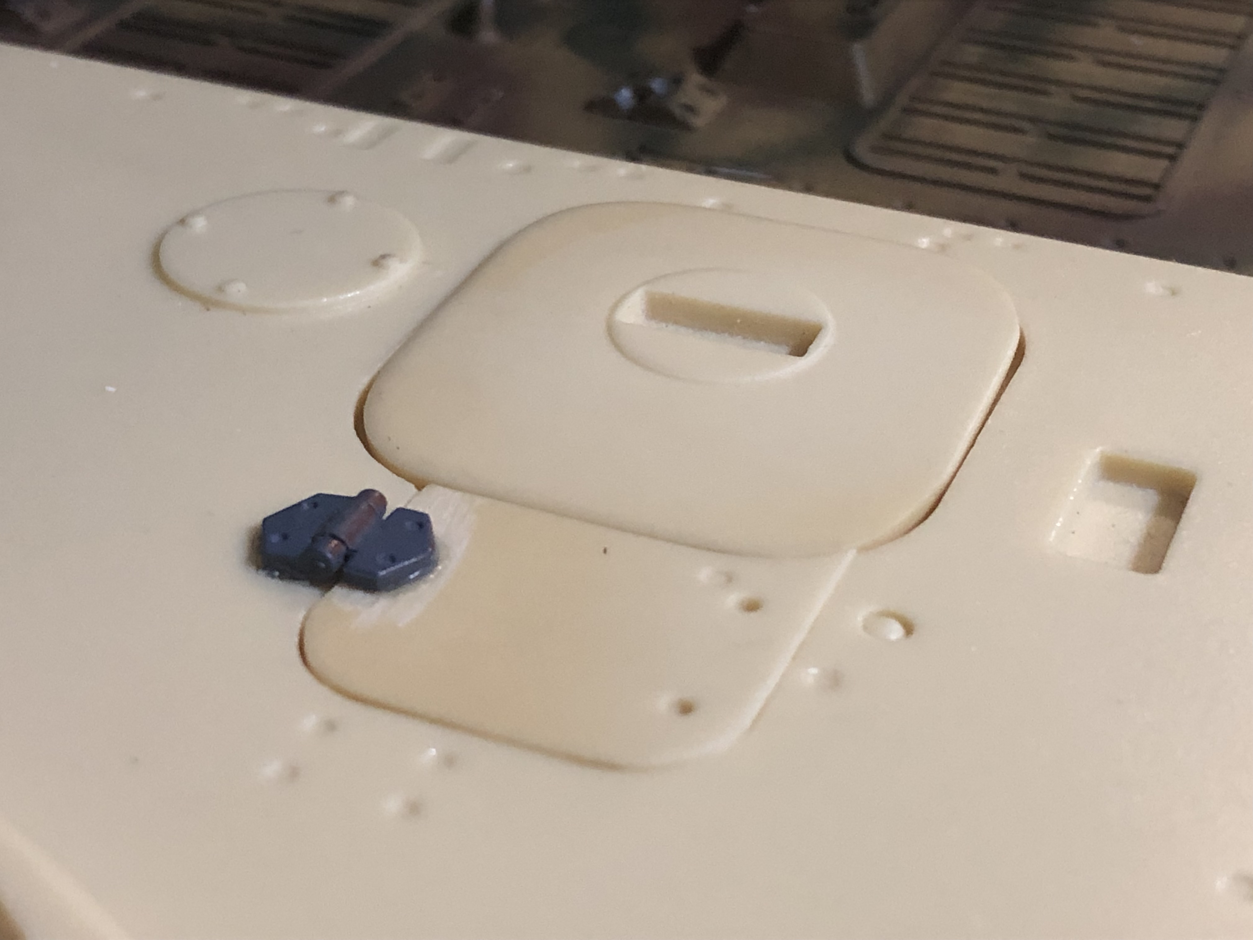

Today has been hatch hinge day
All of it.
Getting the right look, and the right arc of travel, and the right level of compression when the hatch is closed did my head in..............
No wonder I drink(heavily)
When open, the main hatch is a bit loose, but I can sort that. Plus its going to have an as yet unidentified figure in it so he can also help hold it in place while in motion.
Still to add periscope and handle to them but the function is good.
Next up is the round hatch hinge.
All of it.
