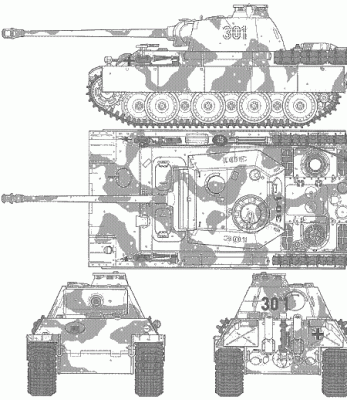

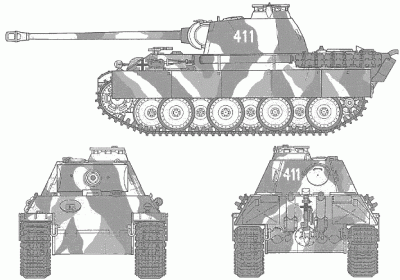

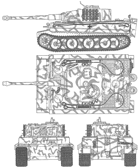

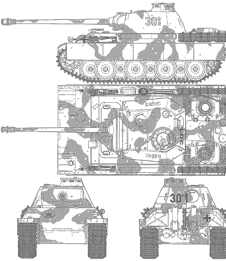

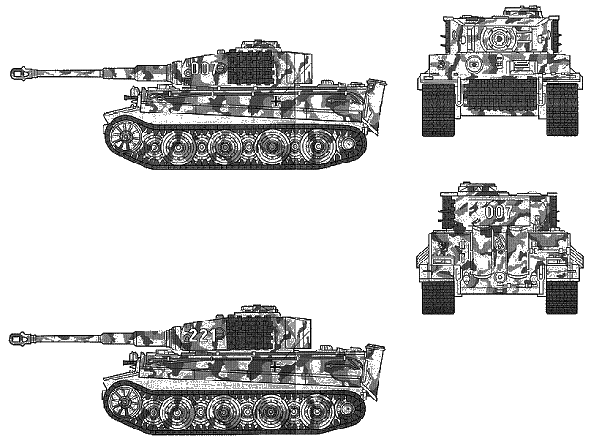

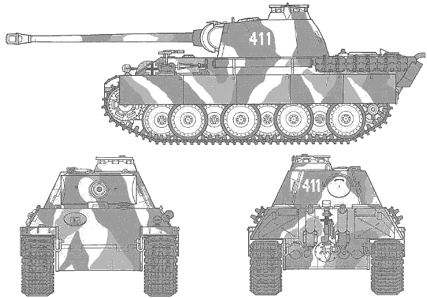

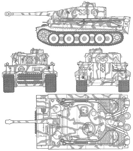

This mite be a little late to post,but it shows some generic camo patterns that may be helpful.Just as a template,when I started trying to randomly paint in the different shades of gray and then outline in white I realized I needed a reference that random just did not work for me,and this helps,so maybe it will help other's.SAX

There are some nice patterns there. Have you any in colour ? Do you plan to copy one of these for your Tiger ?
