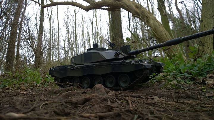

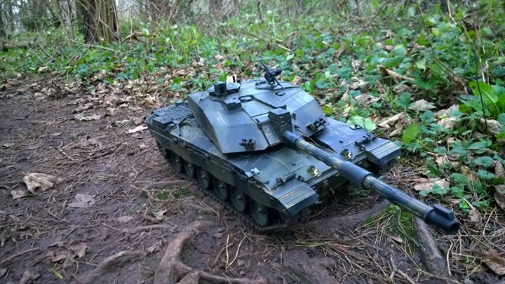

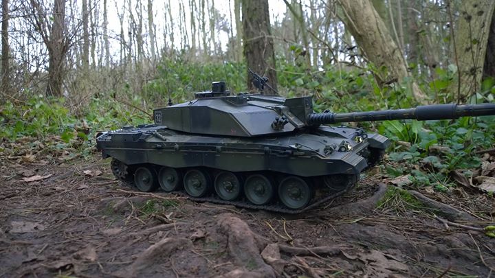

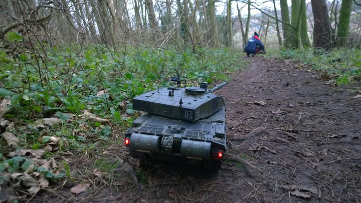

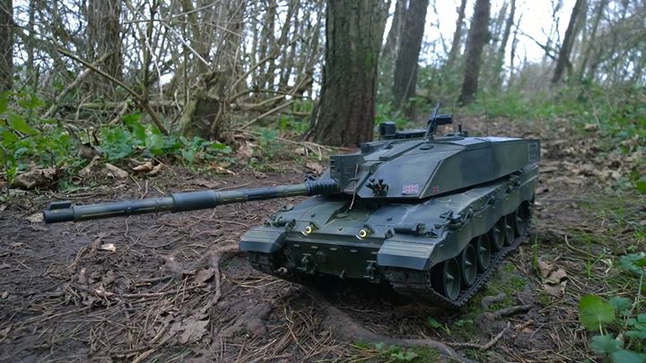

Yet run yesterday out and about!
She ran very well only a couple of minor problems
1: As was happening in my Leo the track is overriding the sprocket in rough terrain / turns due to the soft suspension and the weight of the extra mods so will have to either clock the springs or order some stiffer ones to remedy this.
2: The volume is asbo loud! So need some easy to adjust this externally, so I will either have to mount the volume pots so I can get at them some how when buttoned up or remotely, if I go for the later and for 2x rctanksaustralia vipers I will need a new RX as I only have 6 channels currently and will need 8.
Other than these minor problems she ran great was just lacking abit of speed so may add 3:1 gearboxes when I get chance although I do like the low down torque and creep.
Finally on a lucky not I have a flashing beacon on route ( cheers tankbear aka Ian!) so will get this fitted soon! Hope all you guys had a great Christmas/ new year and look forward to all you up coming builds!
