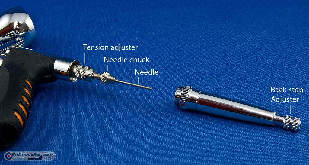

Sorry Jake you are correct...just looked up and found a blow up of the mech
so yeah the trigger does control the needle...the back knurled pieces are the adjustment for the trigger pull ;)

411 on the Trigger airbrush
the Head assy ..is very much like Badger and the Chinese copies
keep an eye on part no3
this part is easily distorted ...make sure you keep it clean...best way is to slide the needle in and out then blow air through it
it's the one thing I don't care for with my Badger...already replaced that part twice ....the needles are also something to be careful with...on these the tips are very fine...so bend easily ....once the tip is bent....you pretty much have to replace it ...though I have repaired mine a few times... it doesn't provide the same pattern of spray...and distorts part no 3 8O
