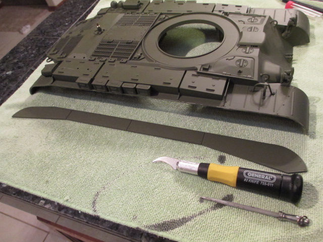

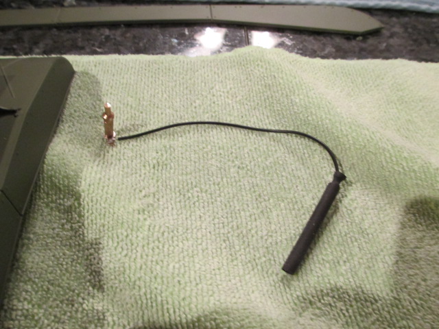

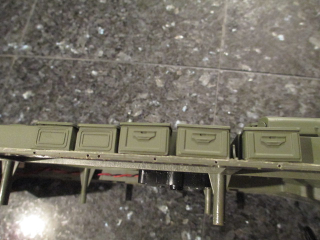

No worries, Alpha ;o) and speaking of some of that work. Nothing in the post today so I took up scribing knife and did one of the least looked forward to bits of detailing that I had in mind. After I removed the sand shields, I sanded the edge of the fenders smooth and using the shields as a template, marked and drilled the bolt holes that removal of those pieces would have left. With a few minutes left over in the evening, I pulled the old HL antenna stub and cut the plastic flat in anticipation of the arrival of Woz's 3D printed tank and radiator caps. Pics:
Removed the HL antenna stub and wiring.  These come in handy if you need a good ground wire at times so I try to save them.

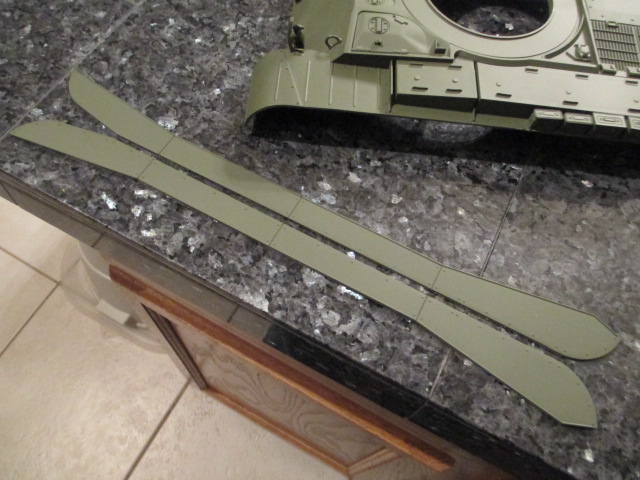

Left over sand shields for a future Sherman build

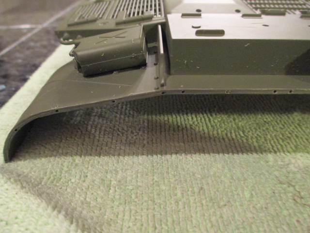

Closeup of the drilled attachment holes for the shields.
Extra care is needed to avoid slicing up the ammo cans if they are meant to be used as detail bits.

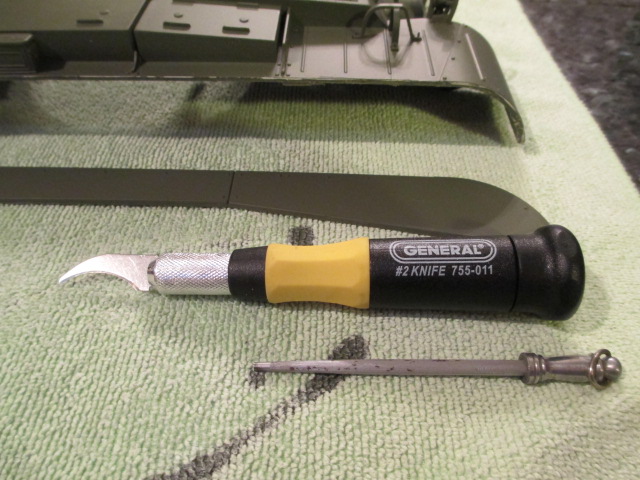

A close up of the tool and sharpener used to keep the blade edged.
Sore fingers but no cuts just a lot of repetitive motion to cleanly remove the track shields

I can tell you love the challenge Painless.... if I were cutting those skirts...the last tool I would grab is a knife :haha: ....Dremel or xacto saw ;)
Have to admit...that's some Eye boggling work 8O ....the bolt holes are a nice touch :thumbup:

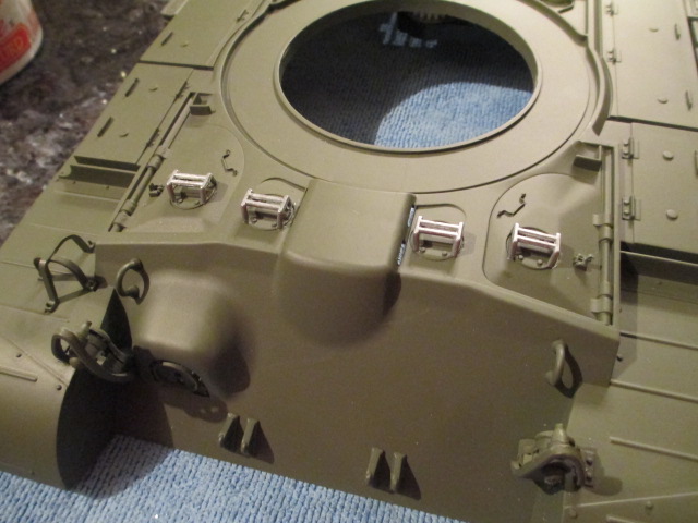

Mato periscope guards

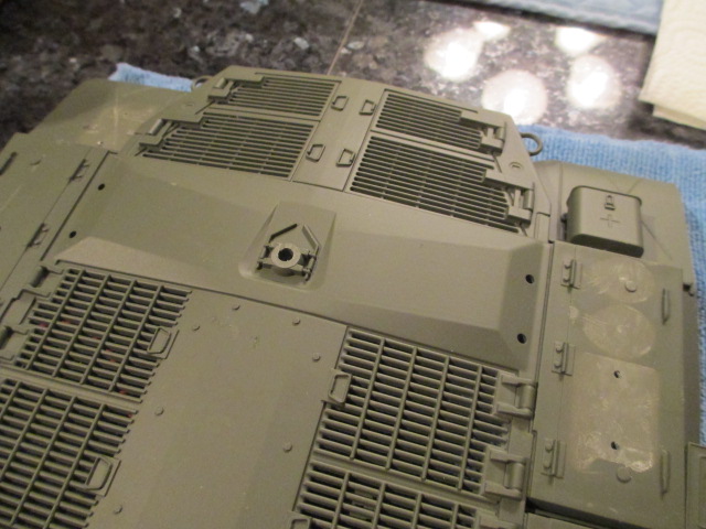

Glued on helmets and gas cans removed via drilling out the mounting posts with the Yankee drill.
