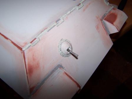

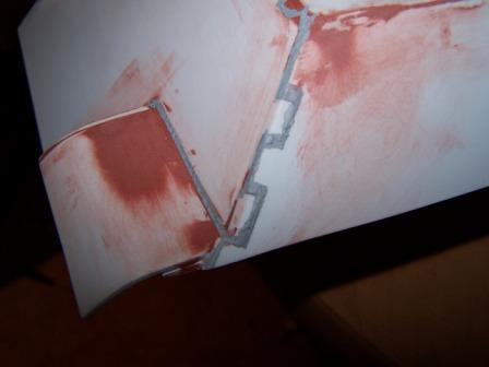

this was a test spot with Tape laid down and them Tamiya Putty put on. Stuff is not good for welds. Too thin and it air drys very quickly. I can see the weld line but there is no texture when you feel and would get lost behind paint, even airbrushed. I can't get any milliput which bytes cuz that stuff rolled into a thin round tube is excellent for welds.
I'll go buy some 1/4 round etc and copy your welds Saxondog. I looked at your post and that is the look I want.

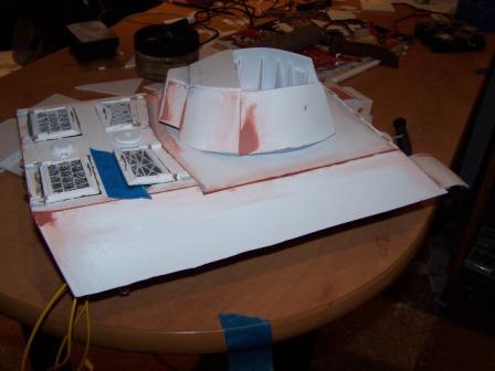

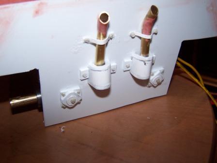

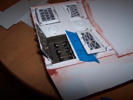

Here is the last few days of work. not much but I am making progress. I think I can show off the entire shape now, it is getting closer to what I want it too be. Comments on the welds please, I am not sure if they look right.
I am very happy on how my fuse box turned out, 2 5A and it will be a 7.5A system fuse, that should protect my boards and motors no problem.

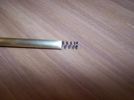

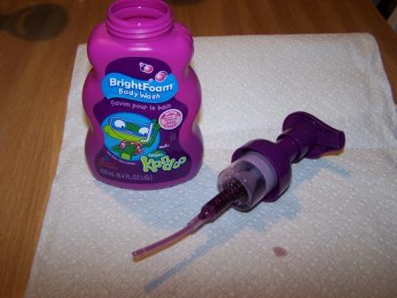

I have found one of the critical parts to my build in the wierdest way. My 7 yr old daughter knows what I am looking for for the suspension I want to put on this beast. To her it is a spring. See the top pic as provided earlier in this post by Mustclime.
See I am thinking to make this suspension you take a spring put it in a tube and braze or solder the ends closed. Put a plunger with a gear on it and basicly the suspension is done. When the gear turns it moves the plunger and compresses the spring, BUT where to get a spring right size and strength.
My daughter goes to take a bath tonight, While there she starts screaming for me. I run up thinking something is wrong. She lifts up her bottle of body wash that has a pump on it. ( she uses empty bottles to wash her barbies hair etc lol)
Shows me the pump with a spring in it, I cut the spring out and holy cow for younger ears on here.
The spring is stainless steel and the perfect size to fit in a 8mm round brass tube, not only that but it has the needed softness and strength, compresses the first 1/2" very easily but becomes very tough after that.
Thanks to her I believe I am just a day away or so from making a working model of Mann's Paper Panzer suspension.
