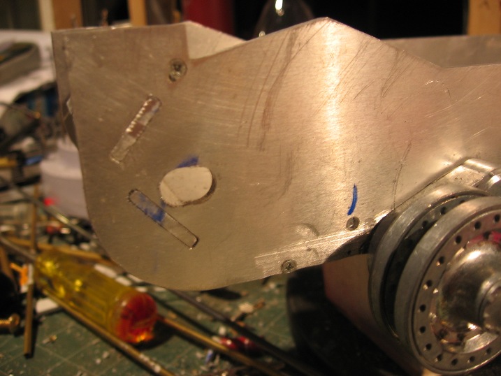

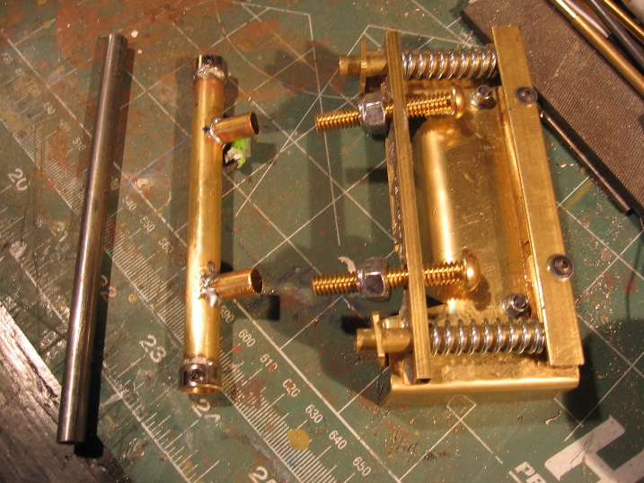

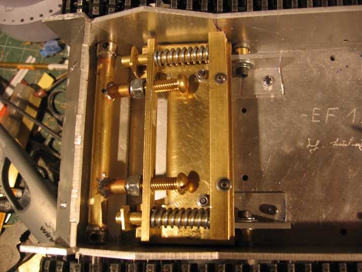

Finally, some time to work on the Elefant. Tracks were too loose with stock setting, and removing one link was way too tight, so I needed an adjuster mechanism. Of course, it could not be a simple system, but one that had to take some slack as well as take some compression.
So with about 4 hours engineering and fabricating I came up with this system. Uses two 10 lb springs (which you canot compress with your hands), some brass sheet, 2x1/4 brass screws (trimmed) and some lock nuts. The screw adjusters are at an angle so easy to adjust with big screw driver and wrench. then the whole block the adjuster screws mount to also moves back under compression. Had to lengthen hull holes 3.5mm forwards. Also built brass carrier for front axle with set screws. had to trimm axle so that stubs only project from hull 10mm on each side.
takes some force to compress the system, but it does work well. this will definately absorb some of the forces and ease some stress on the gearboxes.
One thing to improve the gearboxes is bigger higher torque motors mounted at right angles to the originals, but I can;t find nice bevel gears to work.
cheers
cheers

I though you said you had few tools? Damn skippy for a screw driver and some pliers.
Re: 1/16 Elefant Ludwig/Asiatam
Sax..it's just pretty cause it's made of brass...but all the edges are rough cut with hacksaw and hammered in a a shop vise, and dremmeled smooth.
I do have a MAPP gas tank with mini torch so brazing/soldering is easy....
nice job with the idler
regards, cliff
regards, cliff
hello
realy nice mechanismen
but a porsche don t need this, a porsche do only need these.
my english is to bade to explain how it works but im sure you can imagine.
cu christian
cu christian
Thanks Guys!
Chris, I see the nice track guides you have...but after reviewing about 100 photos, I can see that the track only really touches the middle wheel group when set for normal tension. After a hull fire or tensioned from drive wheels, track is in other positions(too high, too low). when complete, hull weight will loosen stock track too much, so therefore the tensioner.
This model is my attempt at best job so I try to make all corrections.
examples:
examples:
moin
ah, now i understand your problem.
you use the system to get the track in perfeckt position.
cu christian
cu christian
