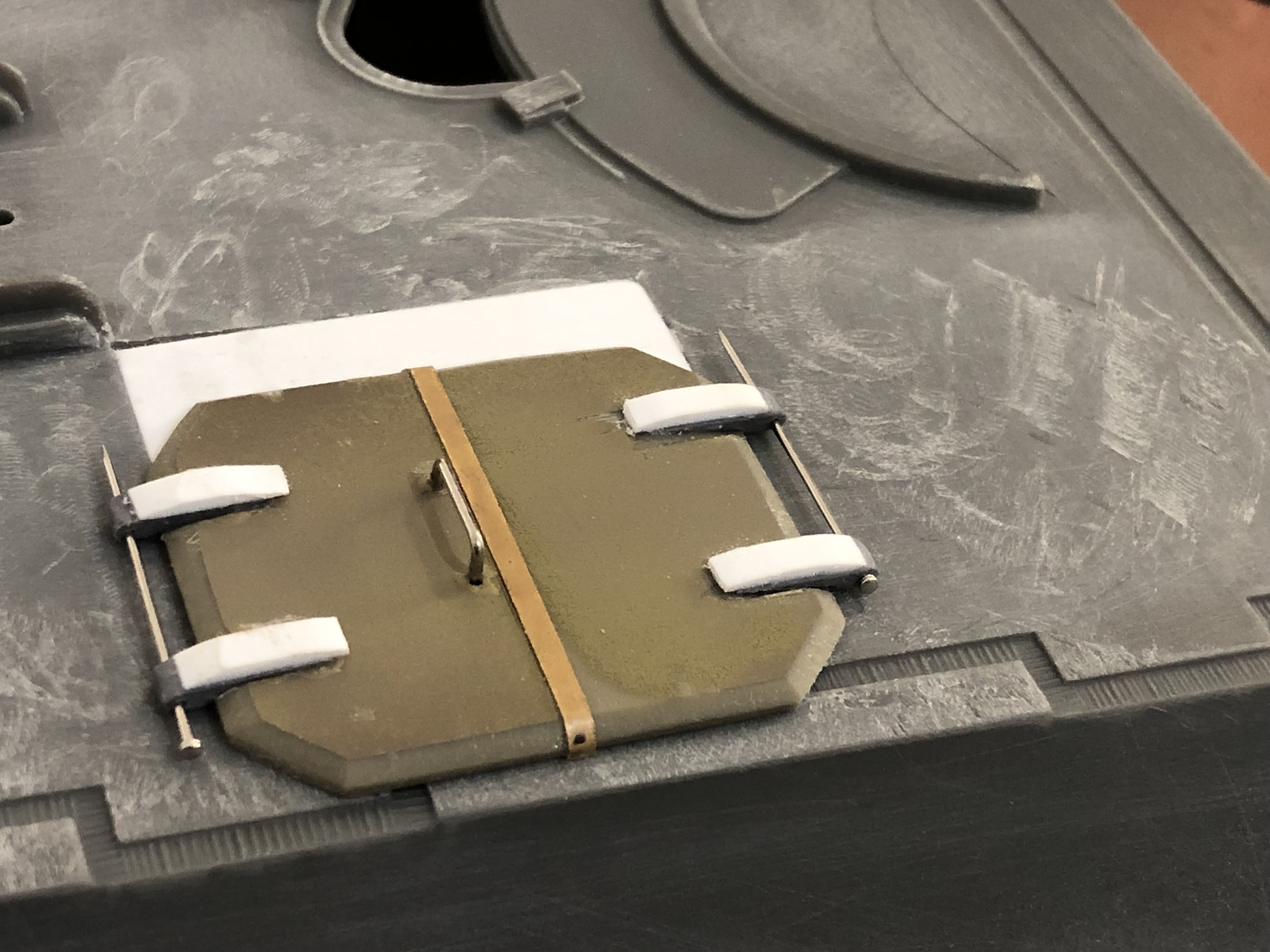

Still to add weld beads around the hinge straps, but you get the idea.
The mounts which attach these to the roof are next.

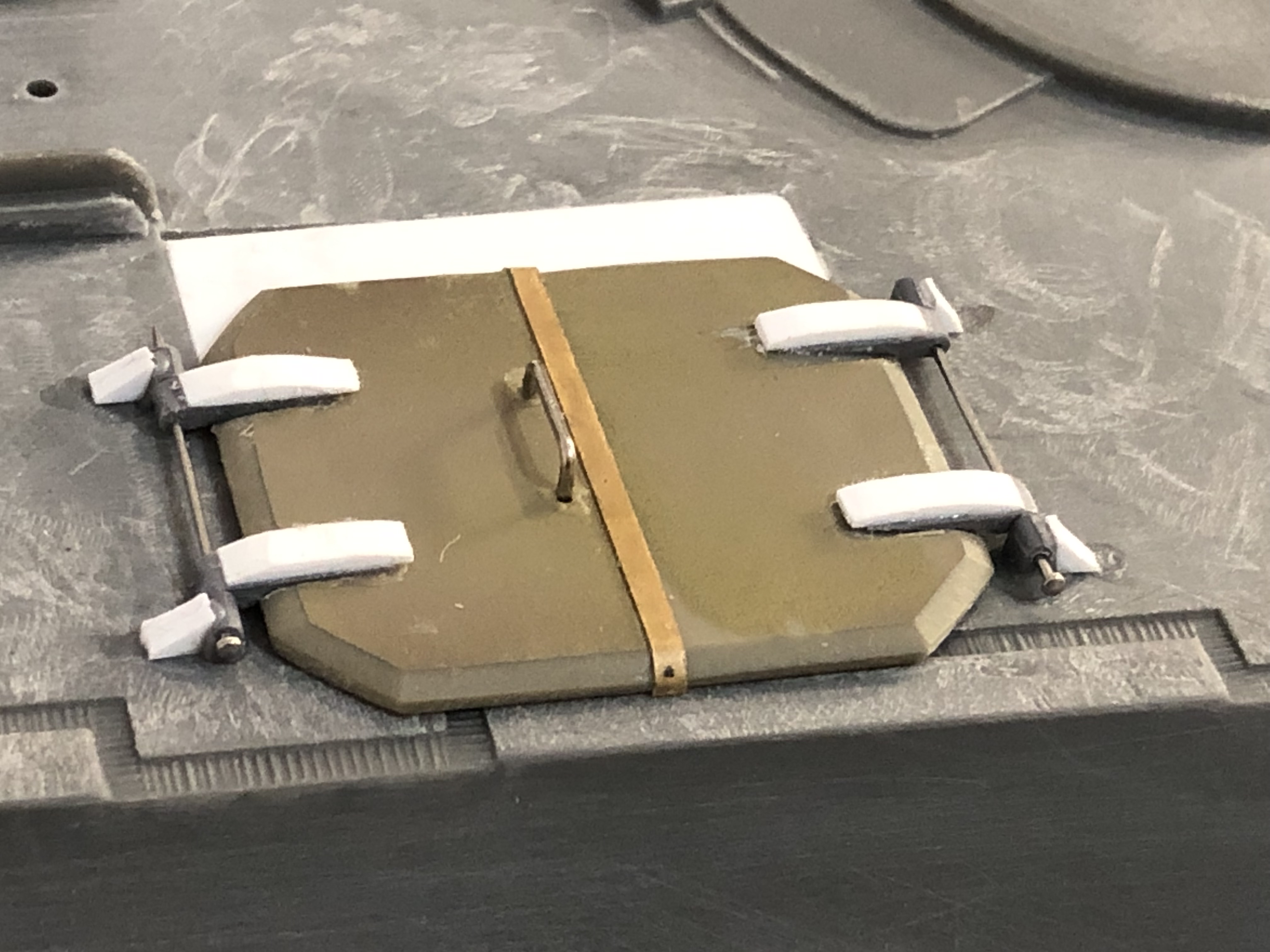

And the last fixtures to set the hatches in place.
Small wedges of styrene to reinforce the pivots.
Weld beads all round& that will be near enough for this kid.

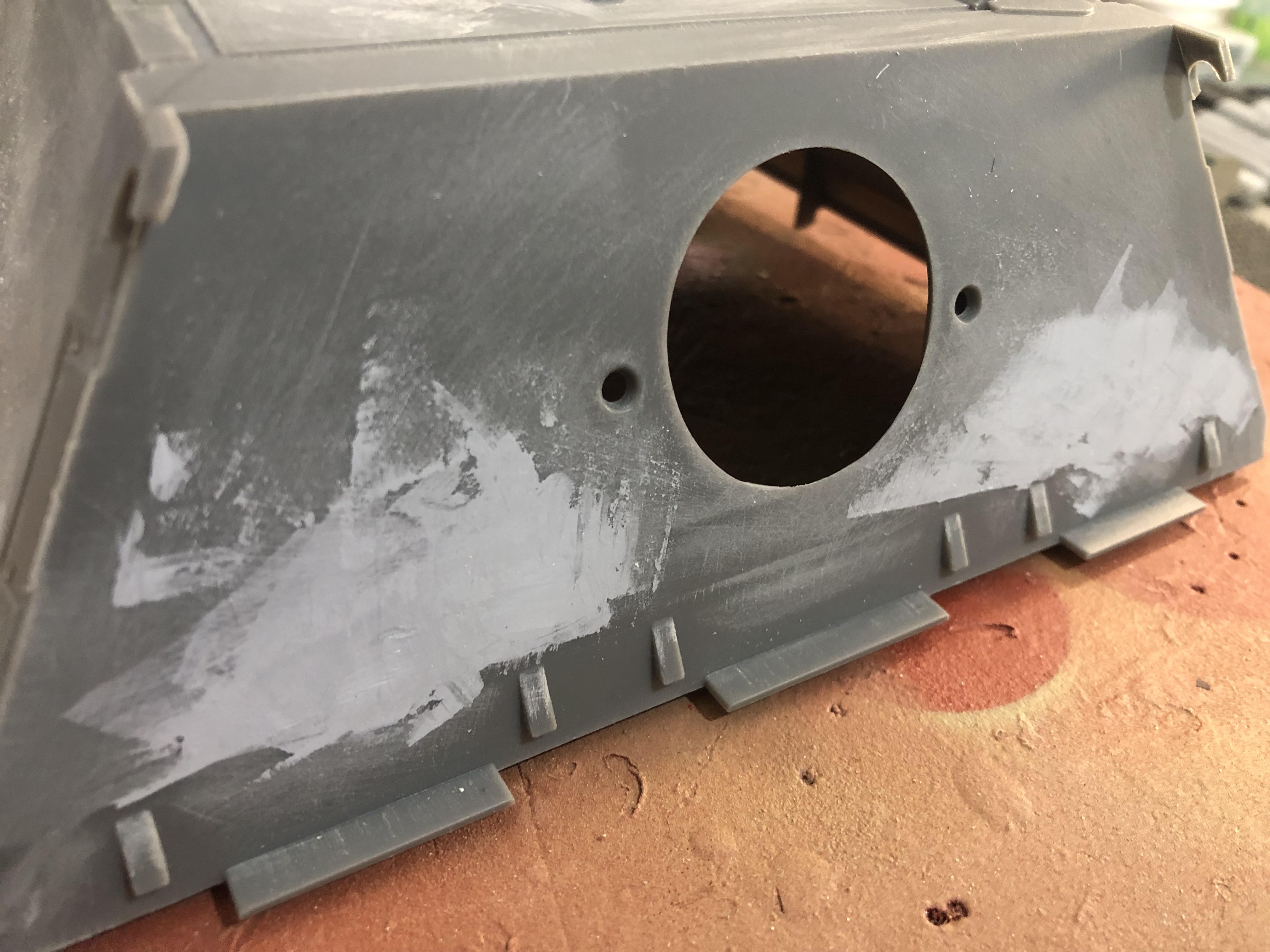

I also removed the later(Elefant) rain channels on the front casemate armour.
More sanding & then to the proper fun bits.

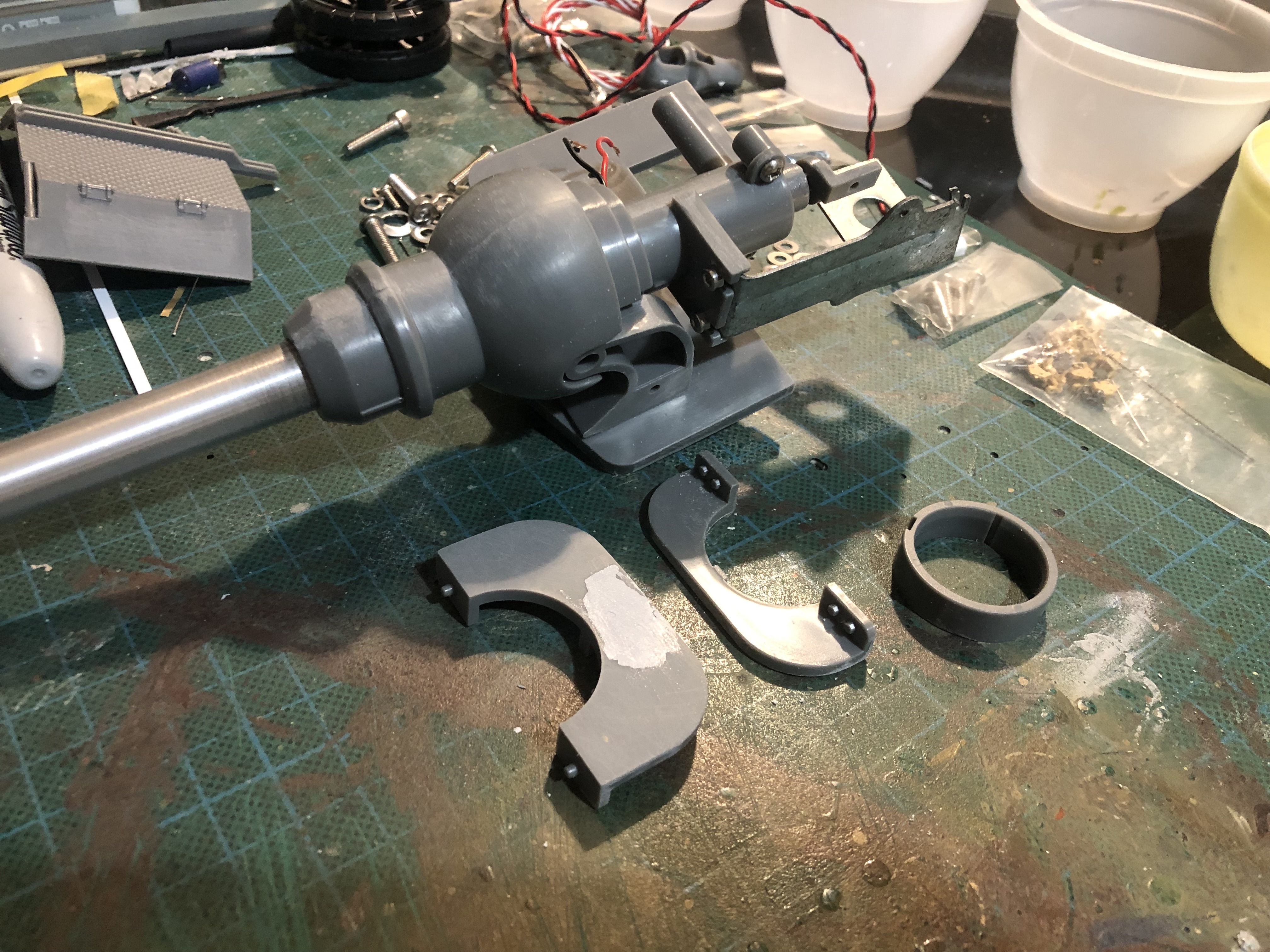

While I wait for the excitement fairy to sprinkle some sanding motivation dust on me, on with the gun assembly.
This bit is going together well.
Still need to set up servos but at least space won’t be an issue.
The mantlet plate so recognisable on an Elefant has to be mounted backwards on a Ferdinand which is actually the correct way out of the factory.
The mounting bolts outward from the Casemate is a field mod that was adopted officially to make removing it easier.

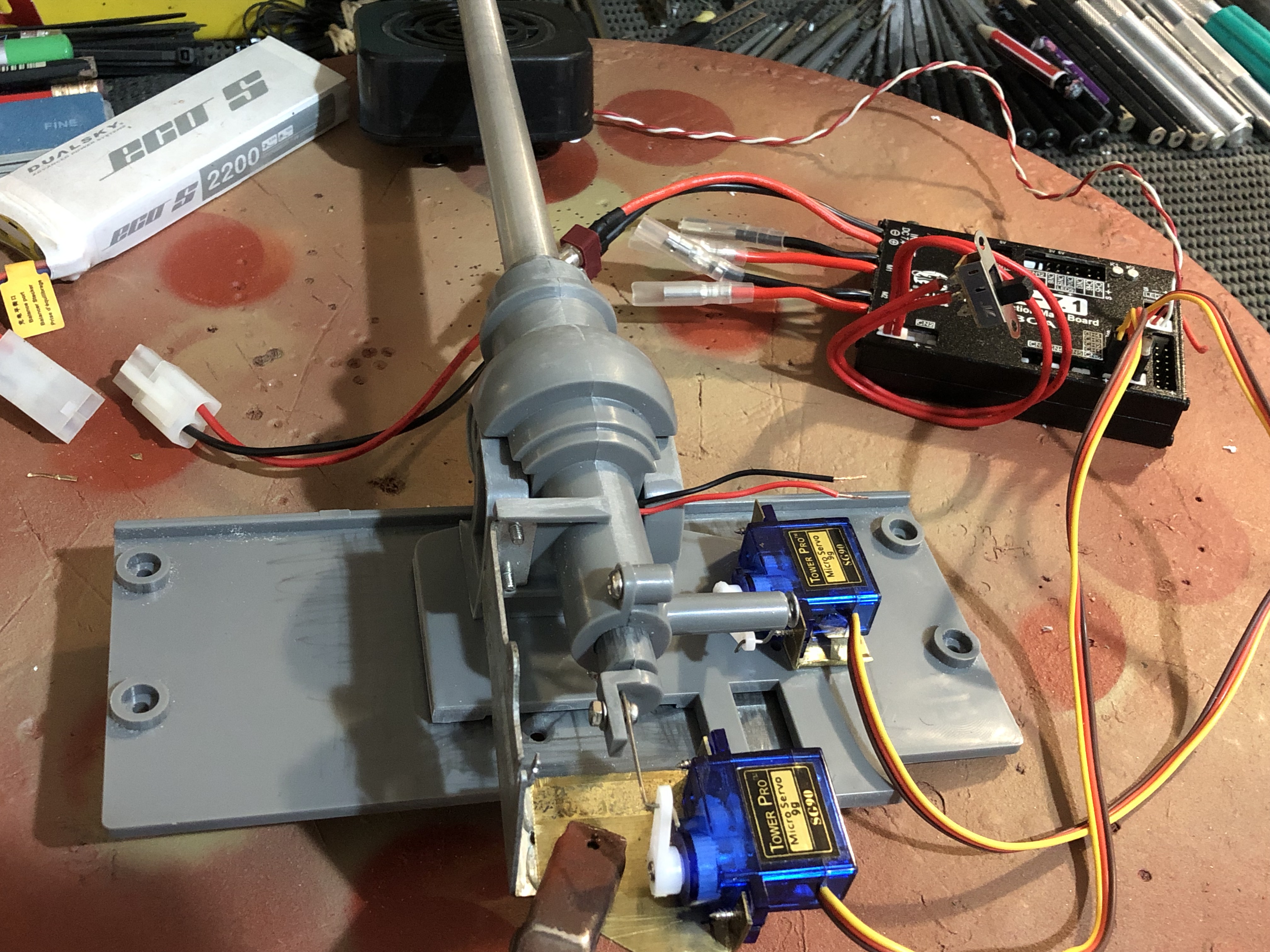

And now we have elevation and recoil working.
Handy having the ability to change servo direction on the 7.1 .
With the misguided faith in the 3rd servo being available, I now have to conjure up a slew mechanism.

Are you using a version 7.0 transmitter on the 7.1 MFU ?

Stormbringer wrote: ↑Wed Sep 03, 2025 8:46 pm Are you using a version 7.0 transmitter on the 7.1 MFU ?
Yes Sir.
I have many tanks on few transmitters but that idea has backfired this time !

Might be daft idea but
you could maybe get a 7.1 transmitter ?
but it is an added cost tho

Great idea, but those are not available here easily.Stormbringer wrote: ↑Wed Sep 03, 2025 11:26 pm Might be daft idea but
For the hassle V's gain I can find another way to slew the gun
