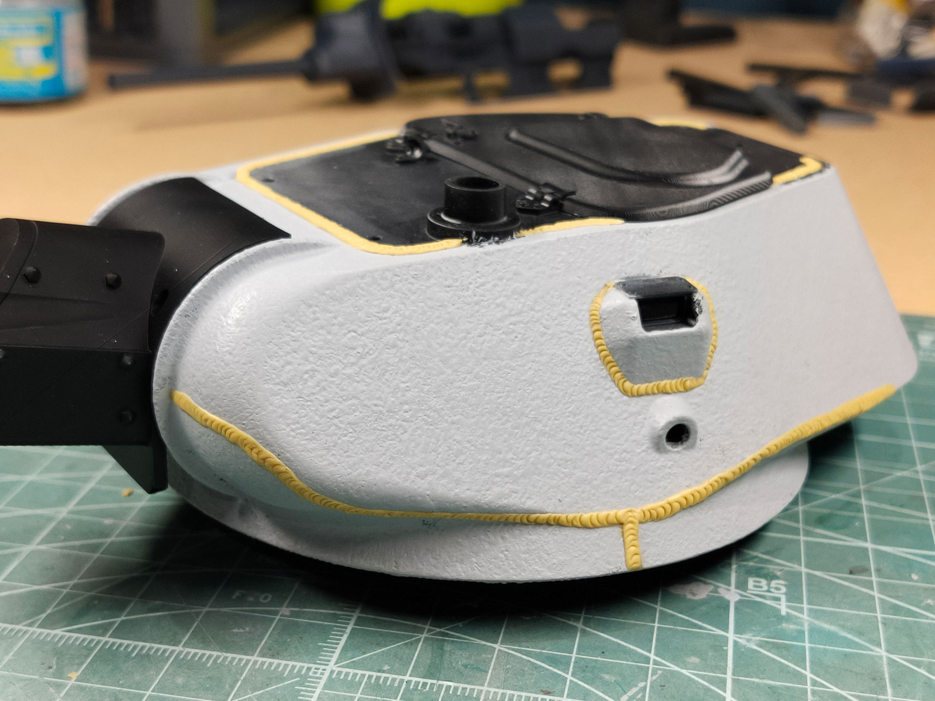

I managed to grab some time during the week to see what a print looks like with some texture, to get a better feel for what the final product should be like. As suggested by Herman, I used a 50/50 blend of Mr Surfacer 500 and Tamiya basic putty for the cast texture, and I think it works better than either product on its own. It was my first real attempt at weld beads using Tamiya quick-type epoxy putty and they (predictably) didn't turn out well; the channels I'd modelled as guides were too shallow and narrow, and the noodles I rolled were too thick. I've adjusted the drawings accordingly. That's the thing with R&D, I make these mistakes so you don't have to! :haha:
Still, much easier to judge than a flat-coloured raw print! No sanding or filling necessary, either. I might have to set up my airbrush compressor and give it a coat of primer to see how it all holds up.
Since these earlier turrets have the huge top hatch that allows you to see a lot of the insides, I'm adding some additional details like the hatch lifting spring and vision blocks.
I'll see how they turn out in the next test print.

The texture and weld beads came out great. I am going to give it a try as well.
Eric
