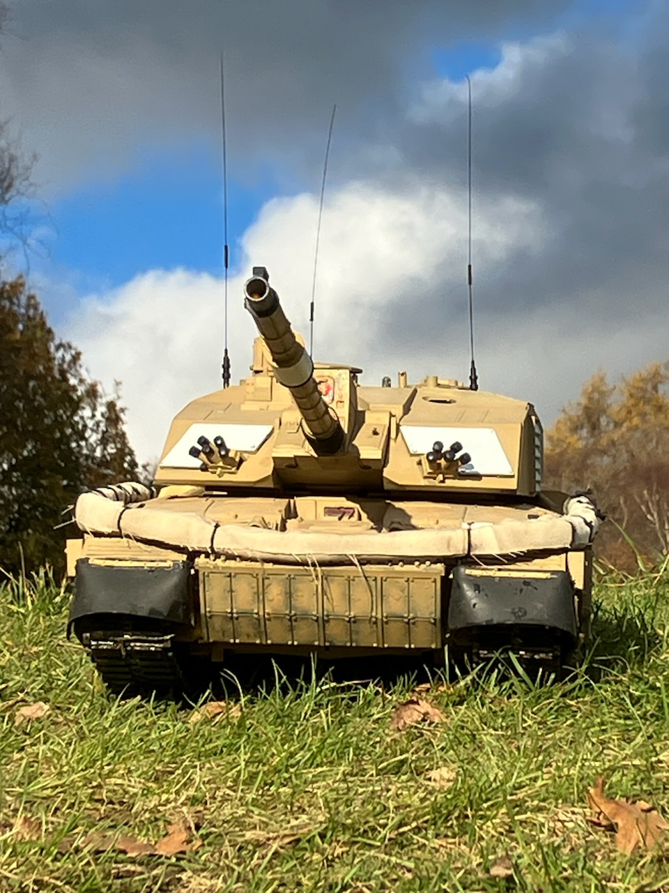

Posts: 6066
Re: Challenger 2. Operation Telic.
Meter Rat: Skimming back over this build, I noticed two matters about which I could use information:
1) The long tarp over the front of the tank interests me as I eventually have to make one for the M26 (actually T26 because so early) Pershing.
2) Tamnavulin: hmm... Once the Oban my sweetheart brought back is gone...
