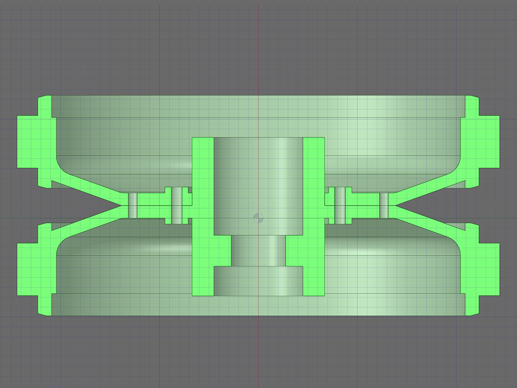

I can try an get a pic or two and some spacing info after work tonight. The track/wheel/idler spacing on all of my Taigens has been adjusted (adding washers or removing material) to make the track path straight. I base the alignment off of the spacing off the drive sprocket since it is the hardest thing to adjust on the T-34 Taigen lower.

So I took some pics of the mounting on the Taigen chassis. First up is showing the alignment with the rear sprocket. I had to use three M3 washers to space the Trumpeter wheel so that the center channel is lined up as well as possible. The three M3 washers measured 2mm on my calipers. The amount of washers can actually vary because the tolerance on the metal suspension arms are different. Some of them need two M3 washers (~1.35mm) to make everything line up and some need three (~2mm). Personally I don't mind using washers for spacers, but some don't like doing that.
The inner hub on the Trumpeter wheel is 7mm as shown below. The hub is through bored to 9mm to accept the 3x9x5mm flanged bearing I showed earlier in the thread. So for that bearing it has a 3mm inner diameter for the wheel shaft, 9mm diameter hole that the bearing fits in (the flange is about 10.5mm in diameter), and the bearing is 5mm high including the flange. The flange is about 1mm high so 4mm of the bearing height is seated in the hub.
So the inner bore is still 9mm all the way to the outside and the inner diameter of the hub where the hub cap fits is 11.5mm
