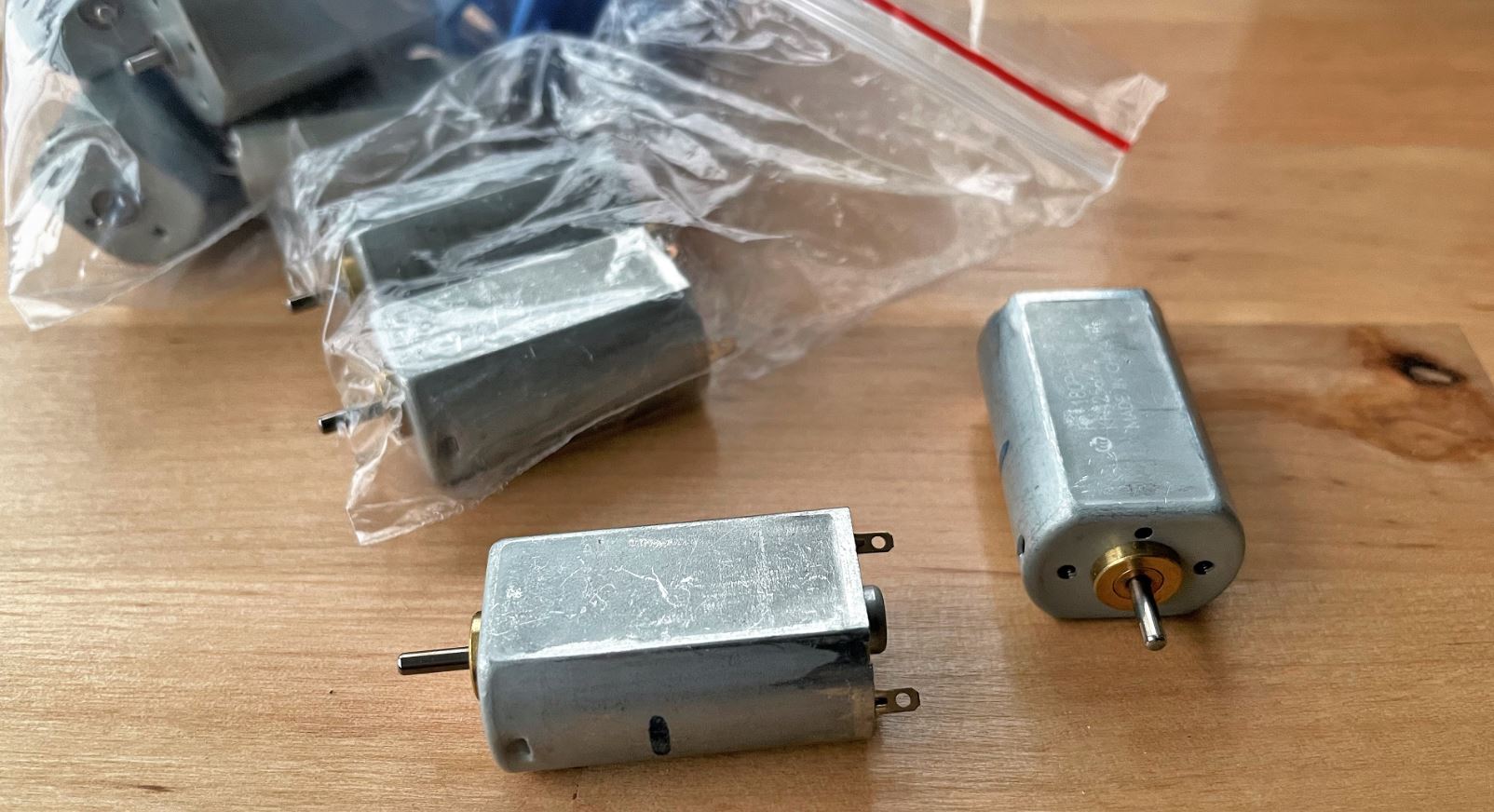

Th next one i will do with Arduino or Tamiya gearbox will use 180 motors. The 180 have the same diameter size and shape as the 130, only longer, and should be easy to adapt to the gearbox. Got a bunch of them ready, different RPM to experiment, cheap.

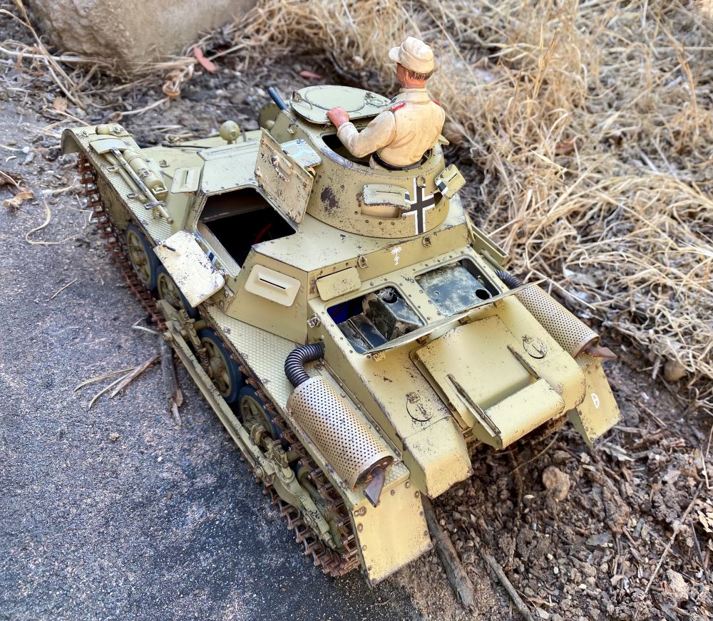

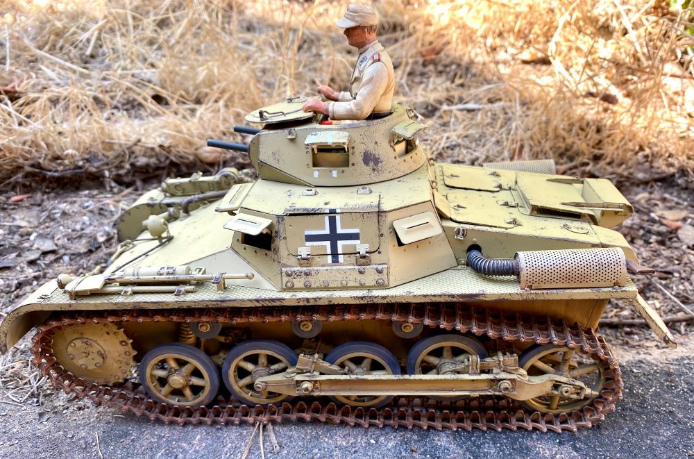

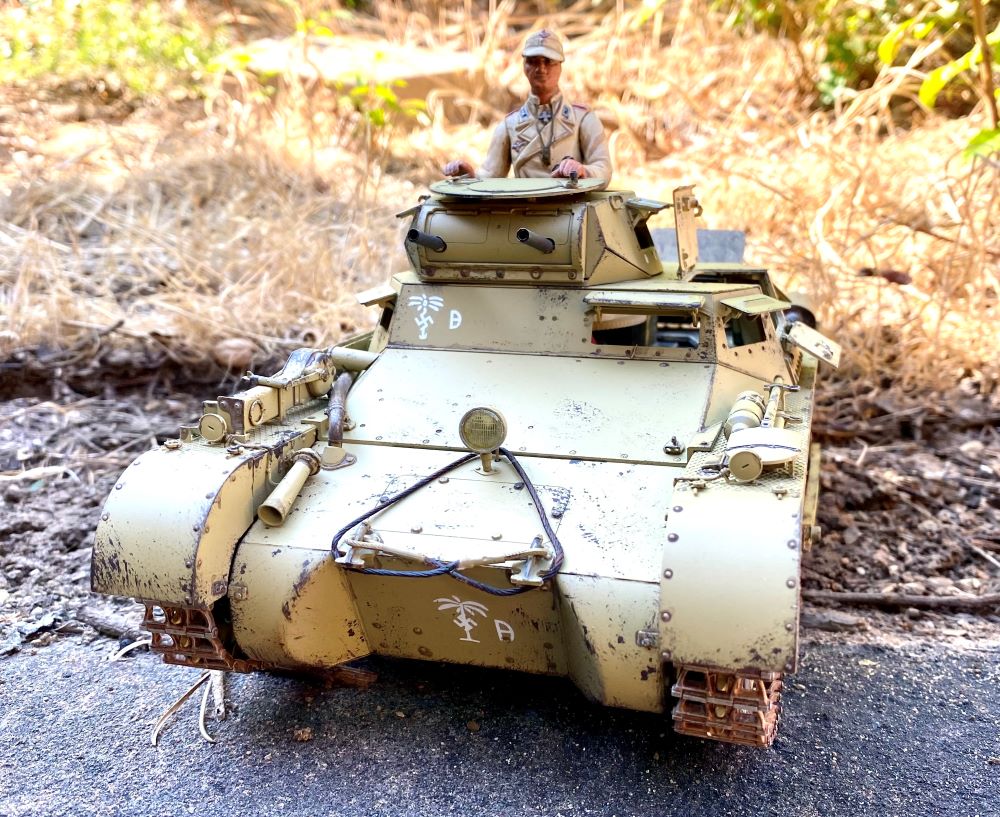

Hey thanks! I used Tamiya's spray "Dark Yellow". Some AK streaking grime to highlight details, and some Vallejo German Black Brown to do chipping with a sponge. AK German Interior Ivory for the hatches and insides. I was slightly lazy. I was going to overspray with a lighter greyish yellow pigment to depict fading in the sun, but it might have toned down the underlying detail too much. I might do some light rust streaks later, but I'm think there's less rusting in the desert than say, a rainy, temperate climate! I live in the southwwest USA, and I take my cues from the dry climate I see here.
