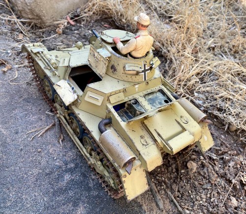

Your Panzer looks great! What color did you use?
SoCalBobS
Posts: 150
Joined: Tue Jan 19, 2021 1:47 am
Re: RC 1/16 Panzerkampfwagen Pz.Kpfw. I Ausf B - Build
Post by SoCalBobS »
Kaczor wrote:Your Panzer looks great! What color did you use?
Hey thanks! I used Tamiya's spray "Dark Yellow". Some AK streaking grime to highlight details, and some Vallejo German Black Brown to do chipping with a sponge. AK German Interior Ivory for the hatches and insides. I was slightly lazy. I was going to overspray with a lighter greyish yellow pigment to depict fading in the sun, but it might have toned down the underlying detail too much. I might do some light rust streaks later, but I'm think there's less rusting in the desert than say, a rainy, temperate climate! I live in the southwwest USA, and I take my cues from the dry climate I see here.

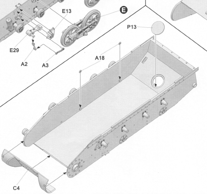

This is a goldmine for my newly arrived panzer I :clap: . I have read the entire thread but I don't know how to prevent the suspension unit from coming out.
In the static model, the A18 piece would do that function:
Best regards.
Edumardo wrote: Thu Mar 07, 2024 1:52 pm Hi,
Best regards.
The metal shafts are solidly attached to the hull, suspension units are inserted and the girder beams are glued to the tip of the metal shafts.
