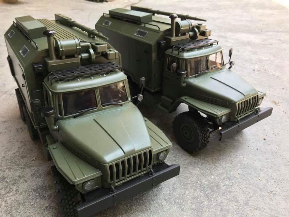

I thought I'd finished my first one but just bought off Bangood an updated 370 motor/2 speed gearbox with gear change servo to fit the WPL US truck - so should fit the Zil. The Zil has a 6 channel receiver fitted so should work a treat.
If anyone who has a HL/WPL/JJRC 6x6 is still operating it with the supplied electronics (stop/go/full left/right) and would like a short tutorial to get it to full proportional standards with sound for the price of a round of coffee and cakes in that well know high street coffee shop....just ask!
