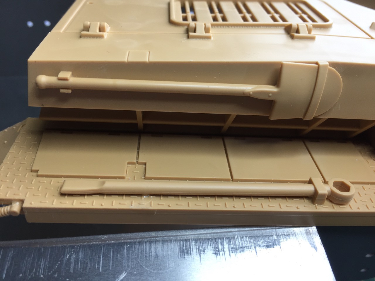

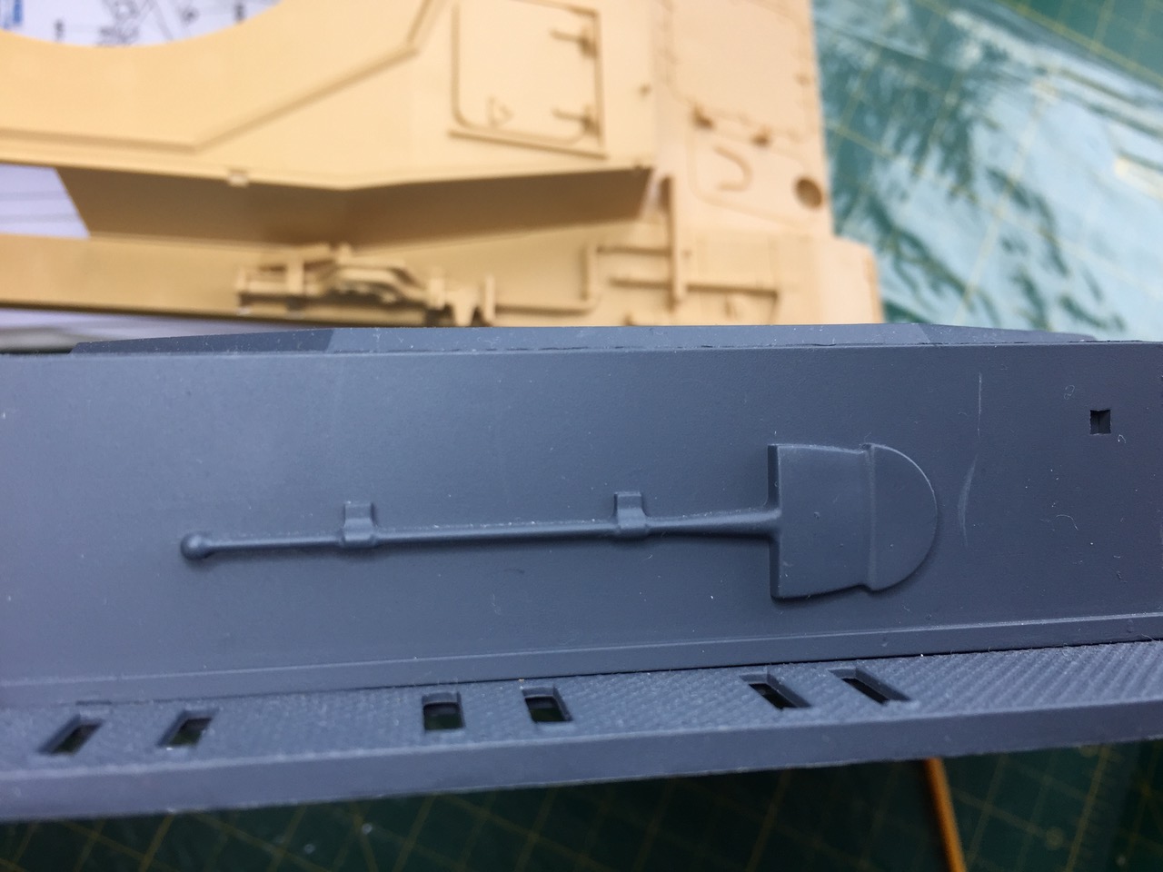

Returning to the theme of a projected Pz IV build. You can pay four to six times more to buy a Tamiya full-option Pz IV kit (in the UK, anyway.. :'( ).,,but do you get four times the detail? Have a look at these:
Tamiya Shovel
Tamiya Shovel
and Taigen/HLs embossed (embedded) version:
Taigen /Heng long shovel
Ok, well, yes they are from different versions: Tamiya's is a PV IV ausf. J, and Taigen the Ausf. F2; but the difference is clear...

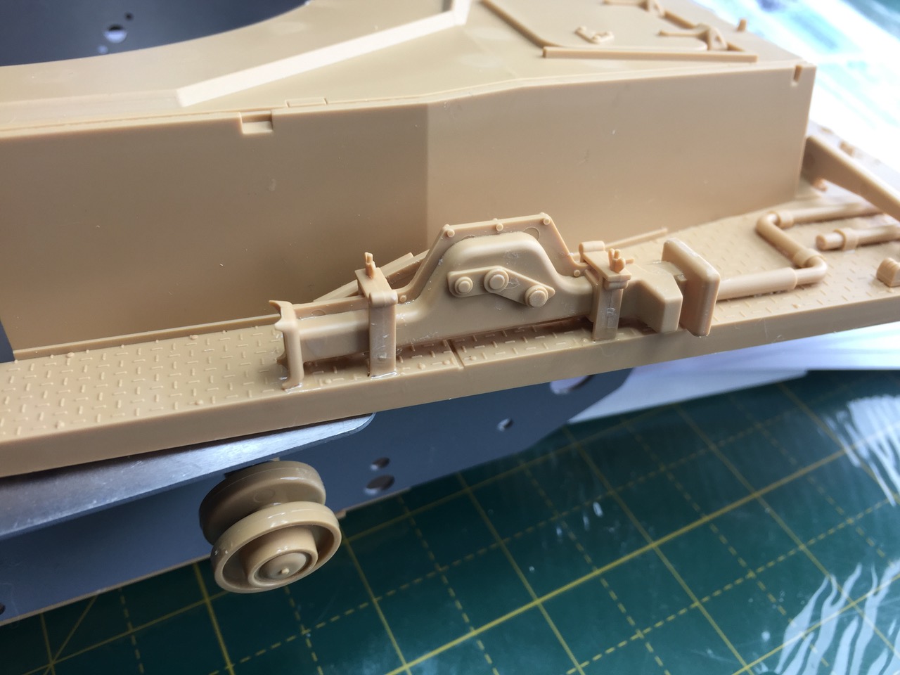

Then compare the jacks and jack mounts:
Tamiya jack and mounts
Taigen Ausf F2 jack and jack mounts
The detailing is far more subtle on the Tamiya version, and the retaining brackets also have butterfly nuts. They're absent on the simpler Taigen/HL offering.
Of course, the detail might not be that important if you just want a battler. In any event, it's always possible to buy the simpler Taigen model and use bespoke third party accessories and parts from the likes of Schumo and Aber (
https://www.axels-modellbau-shop.de/kat ... panzer-iv/ )
The embedded tools can be sanded away, and replaced by more authentic looking parts; but that's where the costs (in time and money) begin to mount. Then it's possible to reach the point where the Tamiya might have been justified in the first instance. Then again, many contributors love the challenge of enhancing their tanks, as well as their skills :) That's what modelling's about, after all. Others just want a fine, and accurate, looking model that can also handle itself in a tank on tank set to :lolno: This is where the Tamiya holds the high ground and- for now- the market.
Incidentally, regarding the Tamiya jack mounting brackets, the first will only fit one way; the second either way. Since I wasn't especially bothered with lining up the butterflies, I chose a mixed orientation.. :think: Then again, I'm only a semi- rivet counter

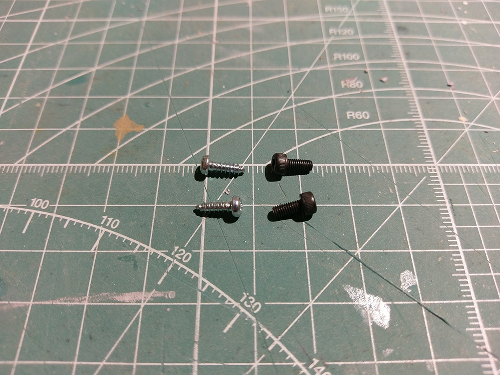

I had a dig through some boxes and came across these, Roy:
M2.6 x 6 mm cap heads, 2.6 x 8 mm and 2.6 x 10 mm self-tappers. If you're unable to source anything closer to home, you're more than welcome to some. How many do you need?

A generous offer, Ram :thumbup: Sites such as this one, when Googled, appear to have what I want, but upon closer investigation it emerges that the M2.6mm range of fastenings has to be 'sourced globally'. It would appear that the M2.6 size is rarely used in the UK.
https://www.trfastenings.com/products/c ... 005525-103
I would need 18 of the M2.6mm X 6mm. That's 'MC3' in Tamiya Pz IV-speak.They're essential to the suspension system. I recall the nightmare I had fitting the Taigen suspension setup to the Asiatam metal hull. All the provided fittings, and I mean all were either too tight, or too slack. :thumbdown:
M2.5mm doesn't cut it, as even with a drop of thread-lock, these screws make for a sloppy fit. I don't want bits falling off into the grass on the Hybrid's maiden clank :lolno:
If you have eighteen, let me know the postage from Oz, and I can defray the cost through Paypal...assuming you use Paypal. If not, we can work something out :thumbup:

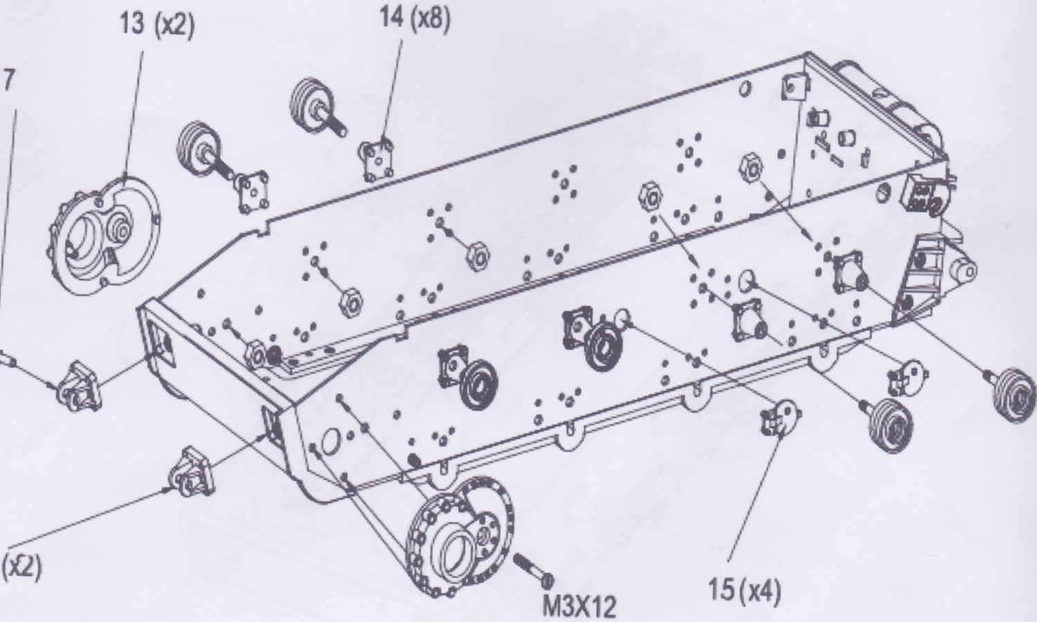

Taigen/HL/Asiatam seem to have copied much of Tamiya's drive train set up, but with a few significant differences.
Here's the Asiatam setup for the return rollers. This is from the manual that comes with their Pz IV metal chassis kit. (Still available from: https://www.asiatam.de/product_info.php ... rn0nqihg82 and Tankzone. Tankzone's reputation has improved a lot of late, according to some members. Having never used them, I can't say. Once, however, they had a bad name here. :problem: )
Asiatam return roller arrangement

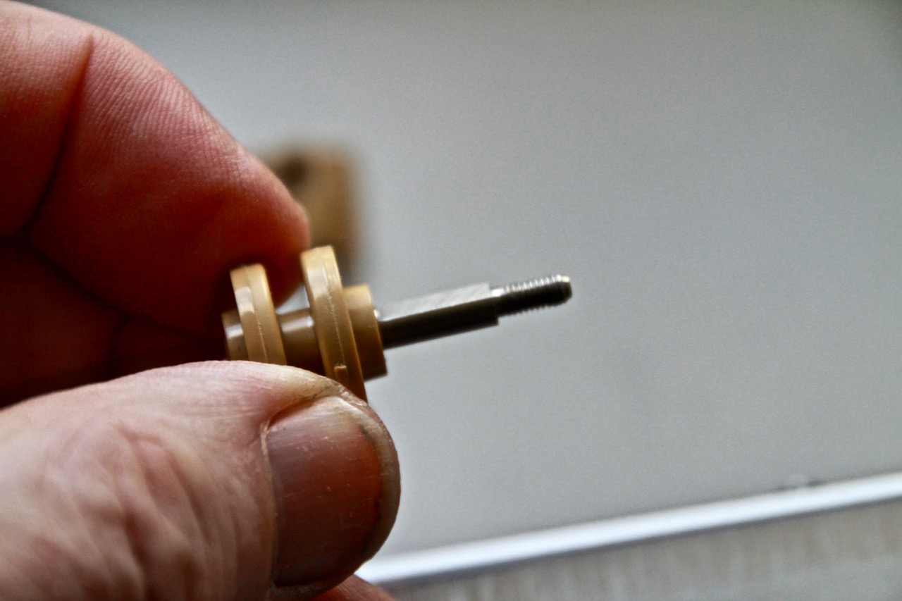

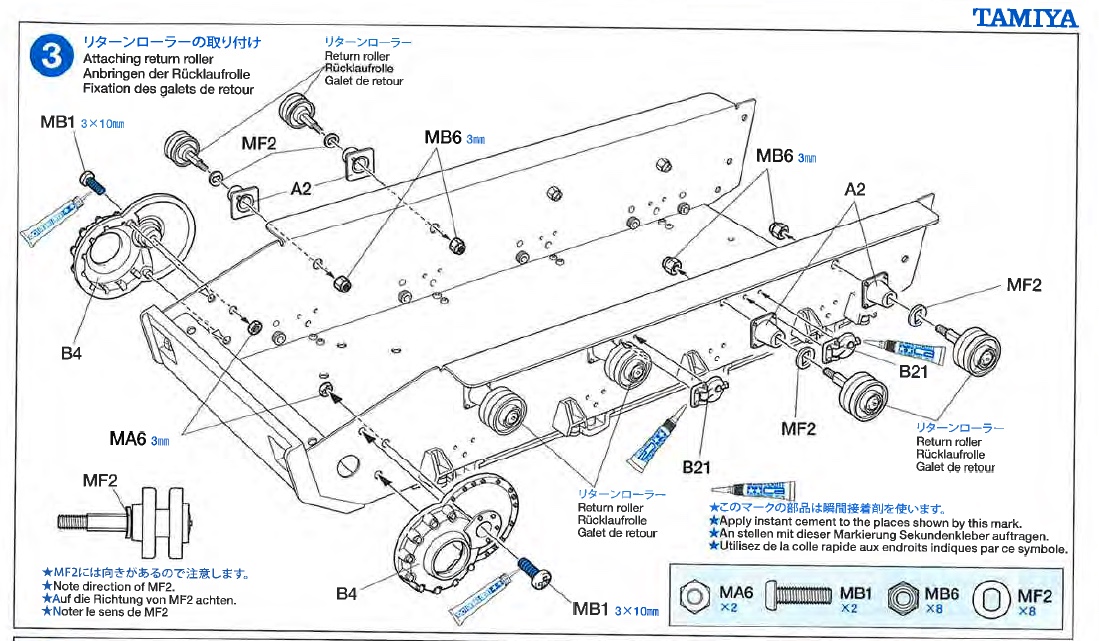

Here's the Tamiya setup:
Tamiya return roller arrangement.

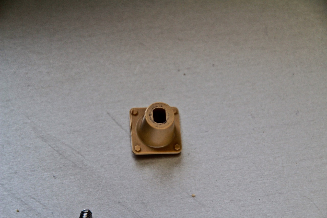

Tamiya rollers have a flat on the pivot shaft, that engages with a flat in the Return Roller Housing (there's also a matching dished washed designed to to fit the 'D" profile of the shaft. :thumbup: )
Tamiya Return roller shaft with 'D' profile
This, together with a nyloc, nut helps to keep the shaft locked in place whilst allowing the roller to turn freely. It's a pretty precise fitting.
Tamiya Return Roller housing 'D' shape
The Asiatam/ Taigen setup..though outwardly similar, is a nightmare to fit and works very badly.
The shaft is round, and the only concession to locking in place is a barely noticeable shoulder at the end of the locking thread. In the kit suppled to me by Asiatam, ordinary hex nuts were supplied to lock the unit in to the chassis side.
The shaft is a sloppy fit in the poorly cast white metal wheels, and when you tighten the nut up to reduce the sideways play, the whole assembly is inclined to spin. 8O having taken the trouble to copy Tamiya's hull and drive train, they should
have gone all the way and copied their 'D' shaft locking system too. It works. The Asaitam/HL/Taigen knockoffs are poor imitations....for now. :shh:

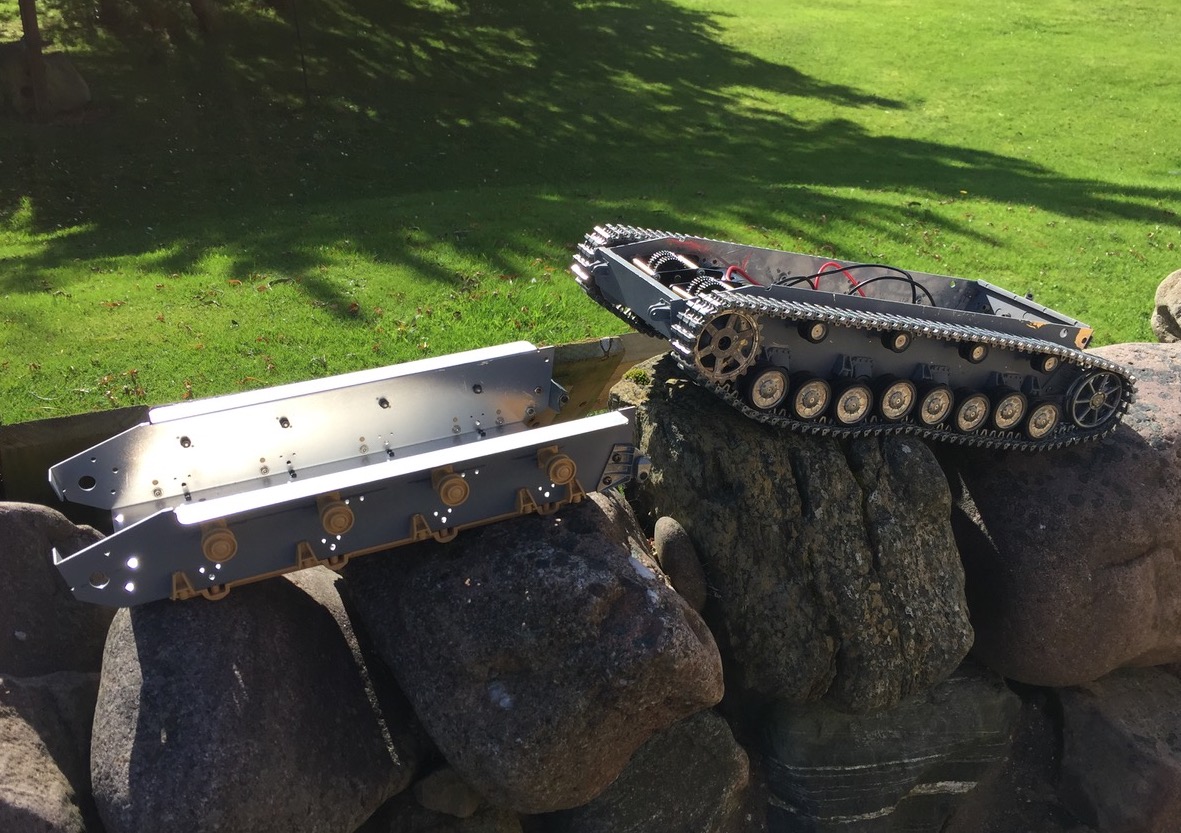

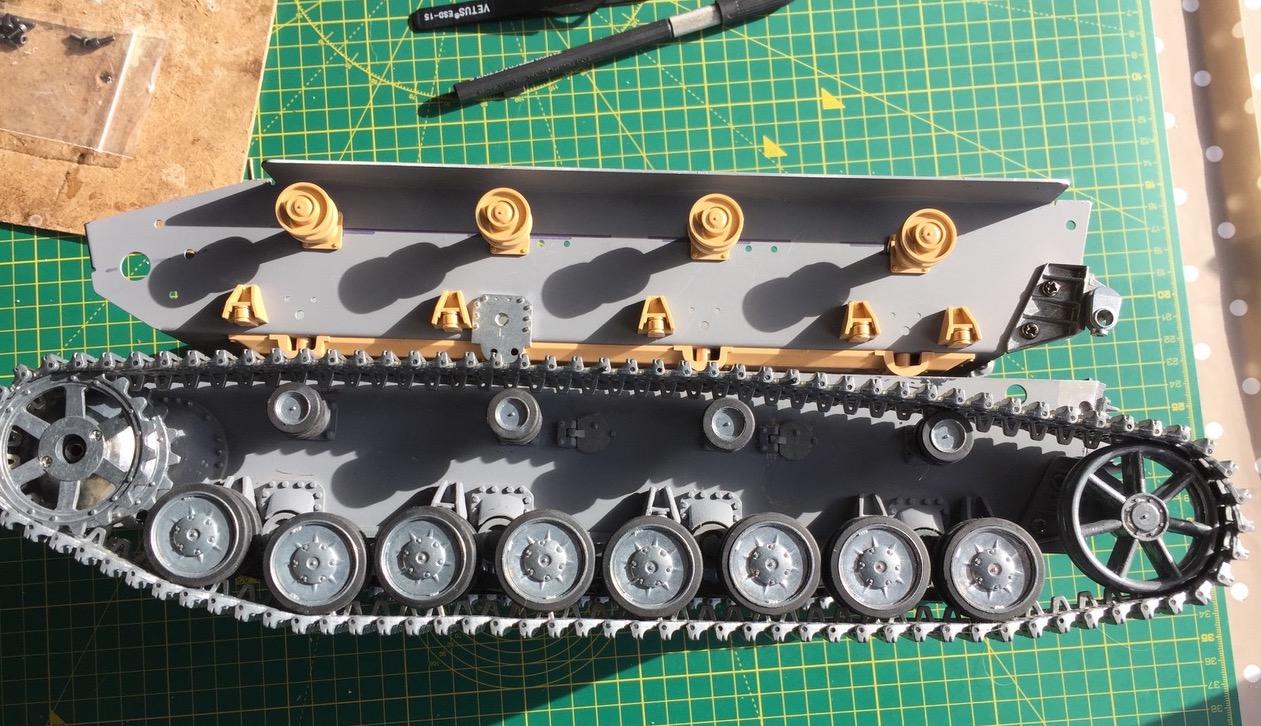

A quick hull comparison:
The Tamiya hull (L) is made from 1mm aluminium alloy, where the Asiatam is of a beefier 1.5mm grade. Taigen have now released a cast version of the lower hull that noted for its solidity, at 2mm thick. 8O
Pz iV metal hulls compared
New Taigen Pz IV metal hull
New Taigen Pz IV metal hull.jpeg (76.99 KiB) Viewed 7403 times
As many will attest, working on plastic is a lot easier than modifying metal, and so it's important that the metal lower hull should be as accurate as possible at the outset. The Tamiya hull ticks all the right boxes; the Asiatam looks the part,
and also addresses the irritating rear return roller issue, along with the Tamiya. But I had to saw almost 1cm off the back of the Asiatam hull to make it line up with, and fit, all available upper hulls, including those by Tamiya, HL and Taigen.. >:<
The new lower hull looks as if it could actually stop a bullet; but, frustratingly, has the same detailing flaws at it's plastic predecessors.
Tamiya and Asiatam hulls
It has taken me many, many hours of frustration, cursing, and improvisation to get the Asiatam hull to the point where- with a battery, an MFU, a smoker, and an upper hull- it should run ok. For a trial run, it only needs an MFU, battery and TX.
The Tamiya hull is a work in progress, but a joy to work on so far. Everything fits as it should. :thumbup: STOP PRESS:
