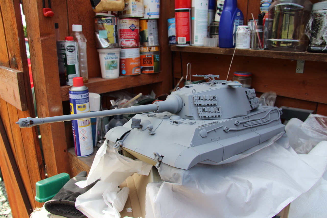

Turret now locked in to the upper hull, and resting on three white plastic roller bearings (nice :thumbup: ). Time for a little primer.
Priming the turret and upper hull

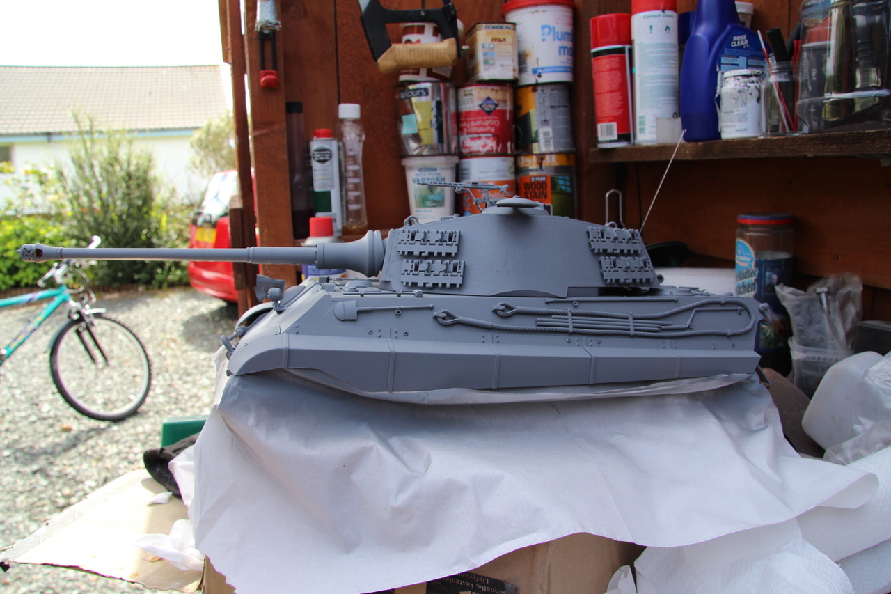

and again-
Humbrol grey primer on KT upper sections

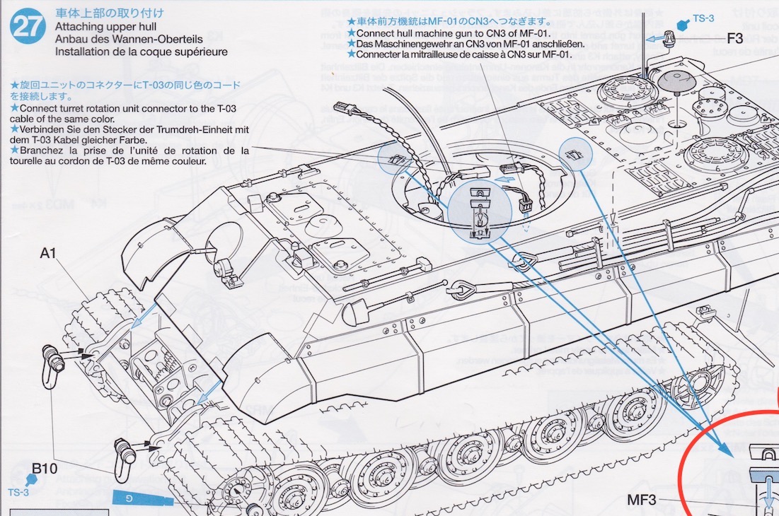

One feature I like, and I'm assuming it's common in one form or another to all Tamiya Full-Option tanks, is the use of roller bearings to reduce the rolling resistance of the turret, and keep it level :thumbup:
I've highlighted it in the illustration:
Tamiya KT  3 Turret roller bearings
That's one area where Tamiya still surpasses the competition :thumbup:

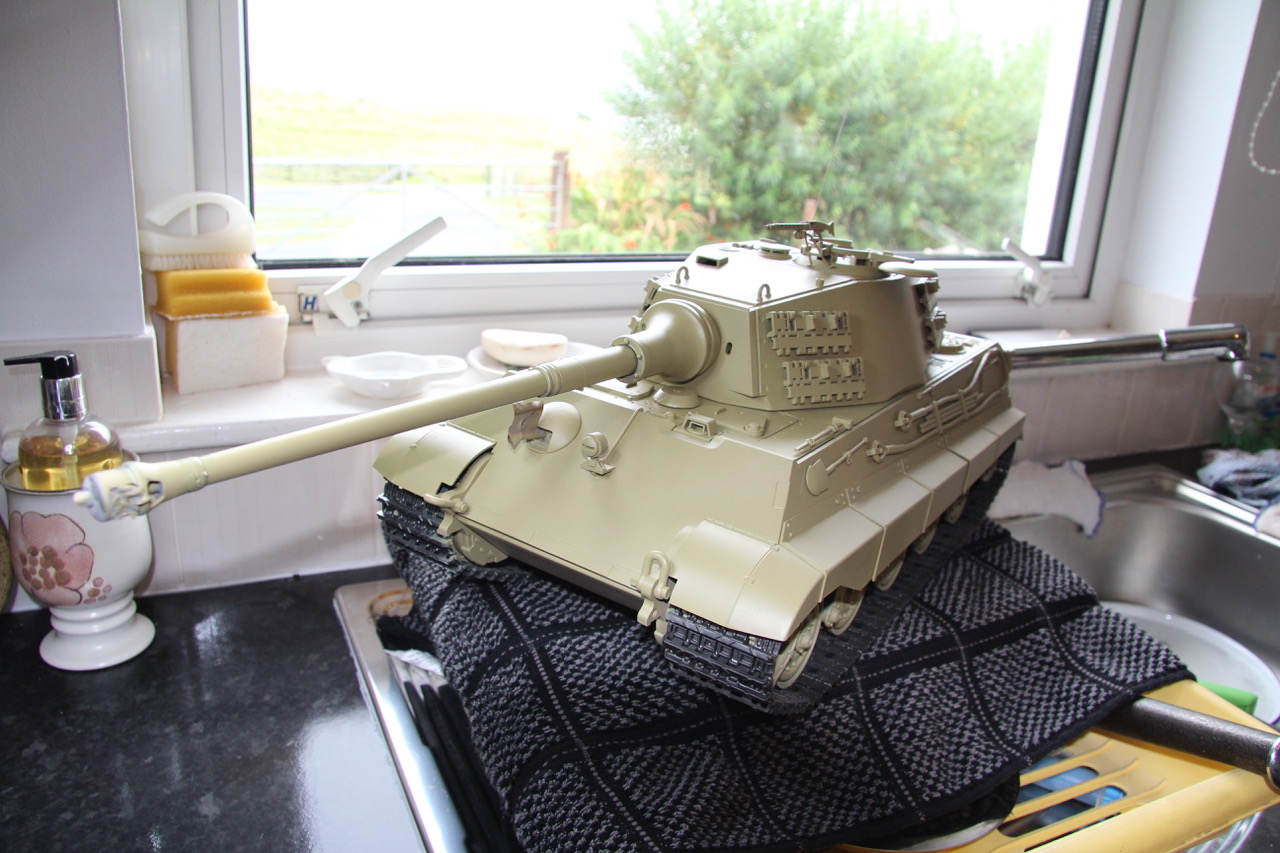

A wee bit of late afternoon Sun, and I've managed a couple of coats of Tamiya Dunkelgelb (dark yellow) on the Tank. Instead of adding a few darker underlying patches (tones) along the seams and bolts and welds, prior to overpainting (my usual technique), I intend to add stripes and weathering later. I will also handpaint the accessories and Turret track spares.
Three packs of Tamiya drybrush Weathering Master have just turned up in the post. Keeping to my brief of completing the project with tamiya-based materials (rattle cans, metal primers, Cement etc.), I thought i'd give their weathering materials a try too. I did a trial comparison between Vallejo Red brown and tamiya's Red Brown and found a real mismatch. The vallejo was far redder-pigmentwise- than the Tamiya type, and so I'm sticking to Tamiya exclusively. One problem, though, is that the XF series of colours desn't appear to lend itself to brushing. I'll have to work on that. :think: I may have to use my Vallejo model air Panzer colours, as they brush on quite well.
