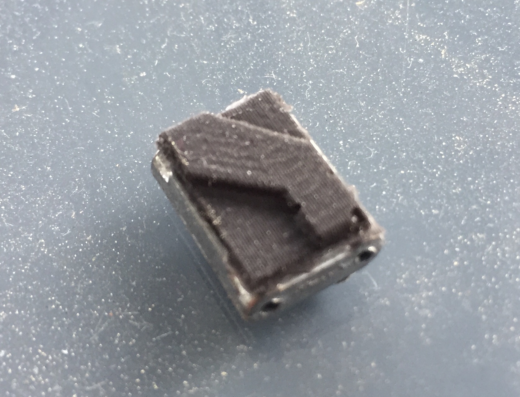

Hi Barry,
one pic of the chevron style rubber pad
The set includes only the outside rubber pads for both tracks and will be 100€ without shipping.
Like the original pads they have to be stuck in and additionaly have to be glued.
are you still interested? Send me a PM for further Information.
Freddy
Freddy

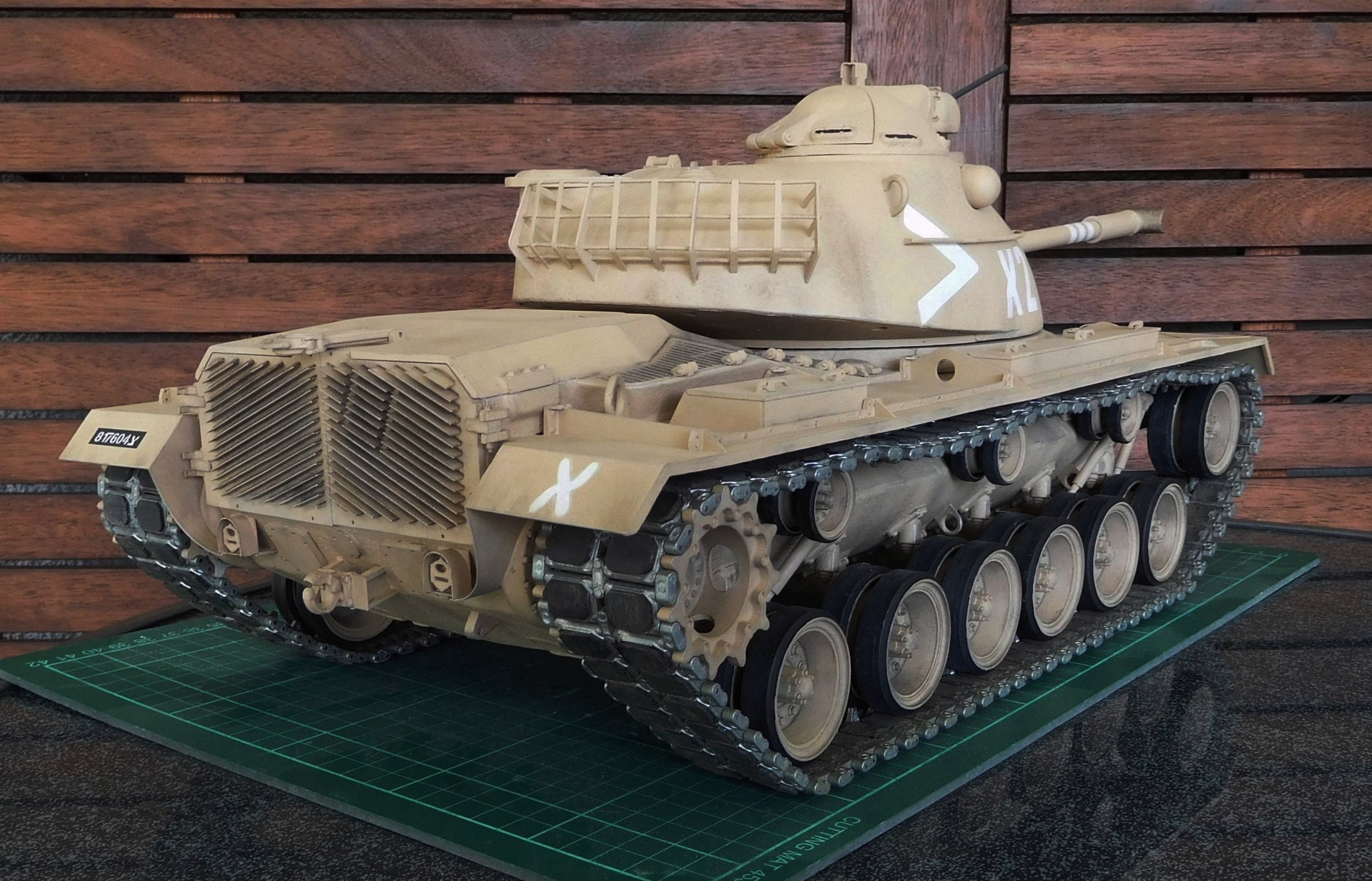

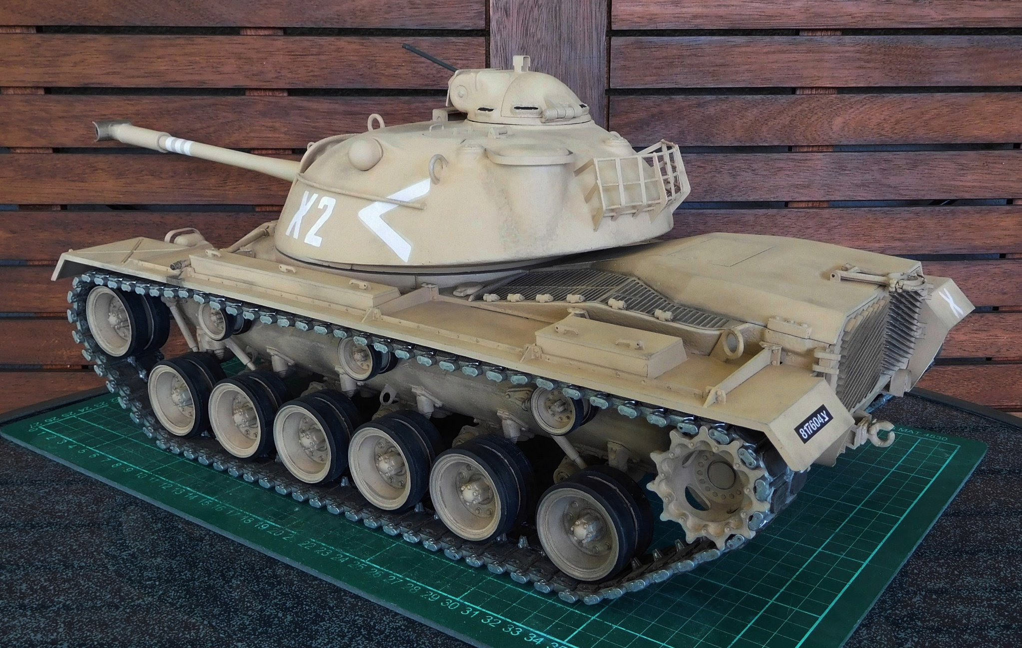

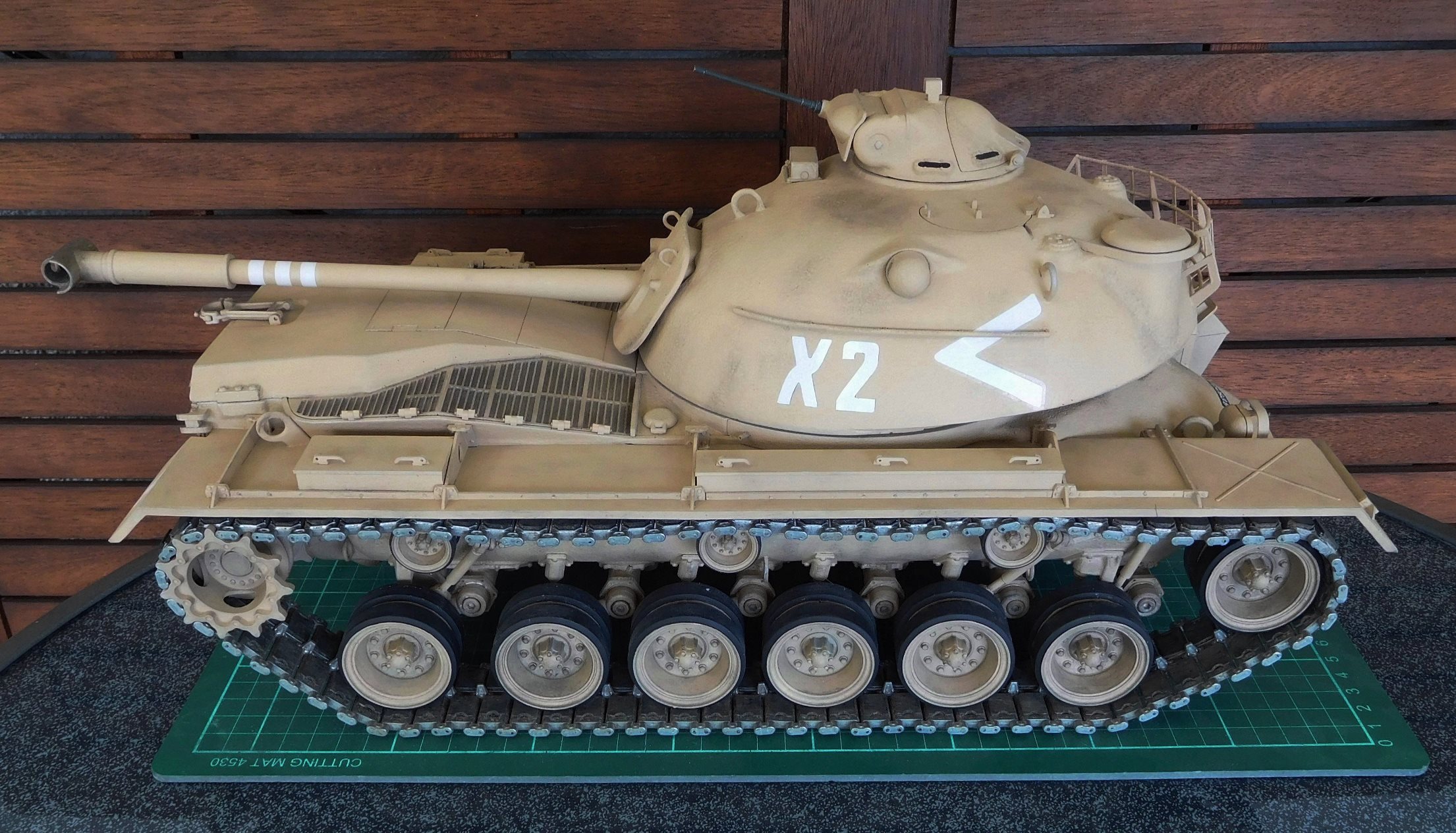

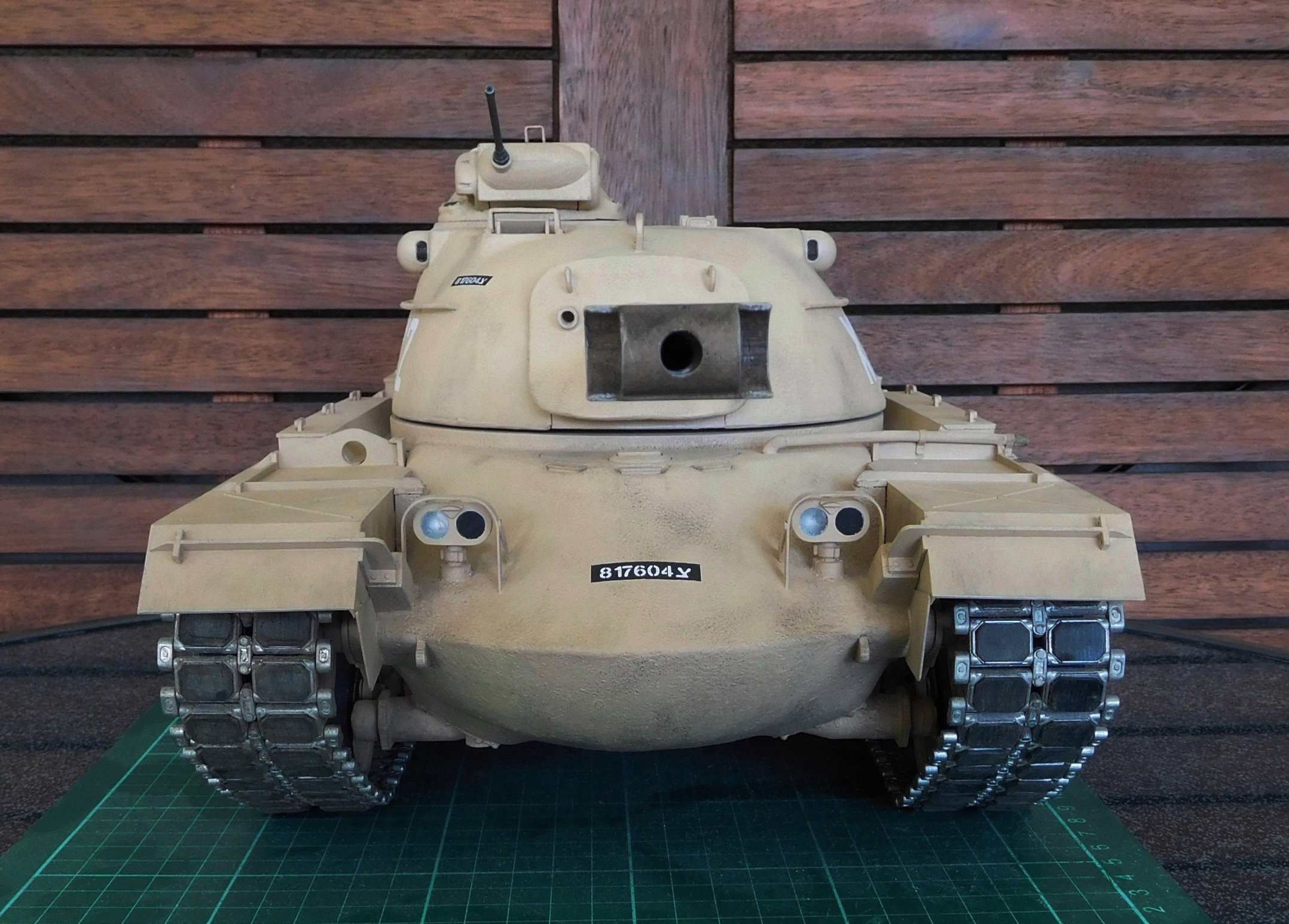

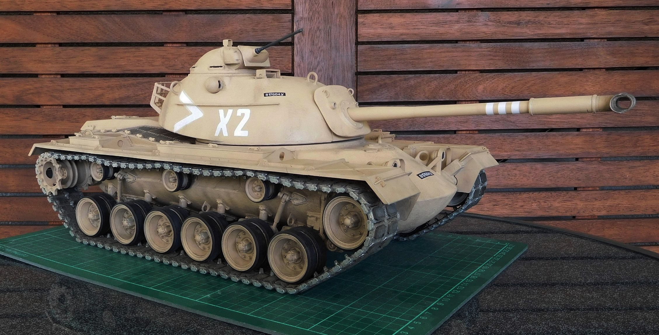

 - Location: West of Austria
Re: M48 MBT – The Cold War Warrior – scratch built report

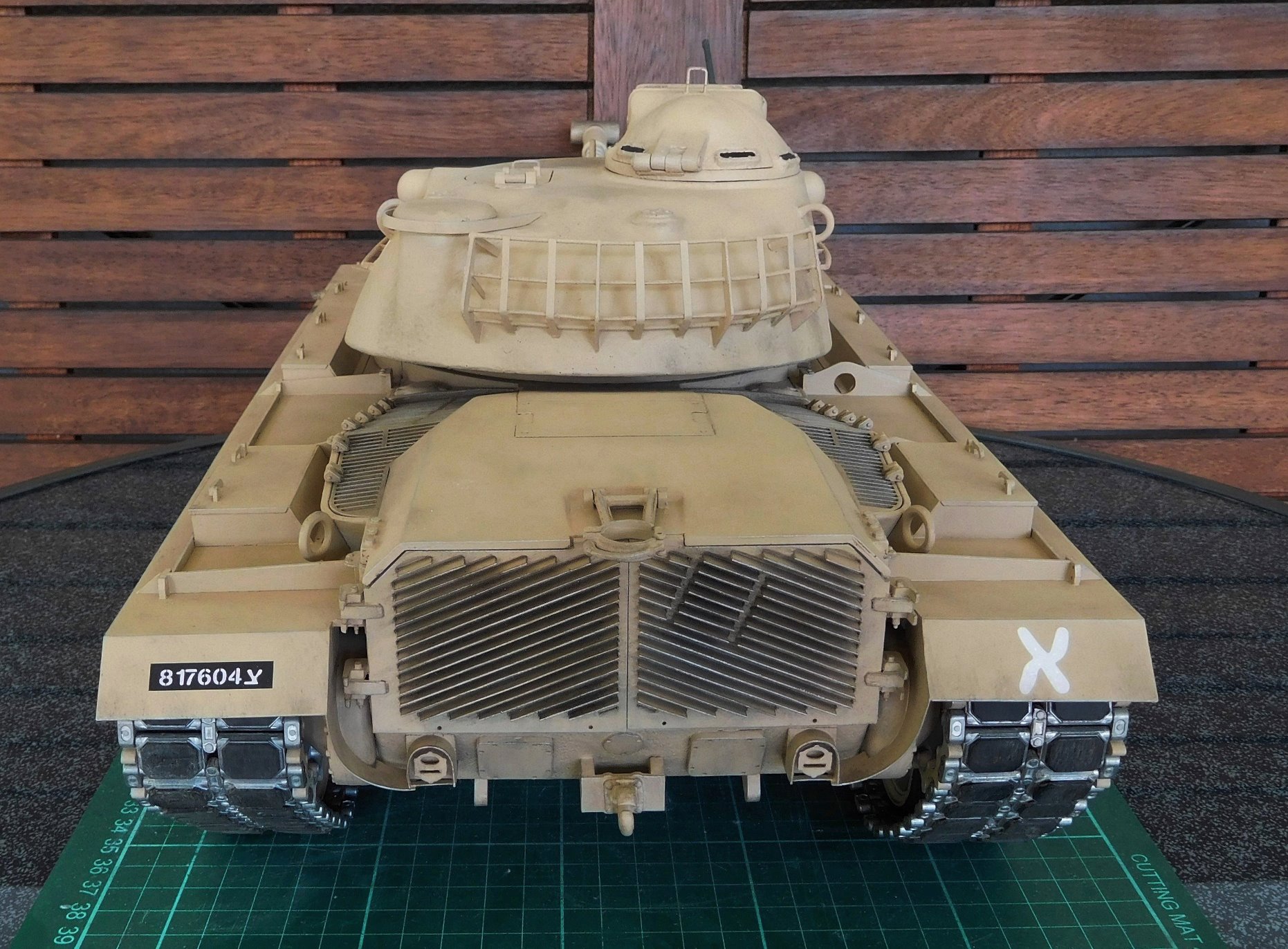

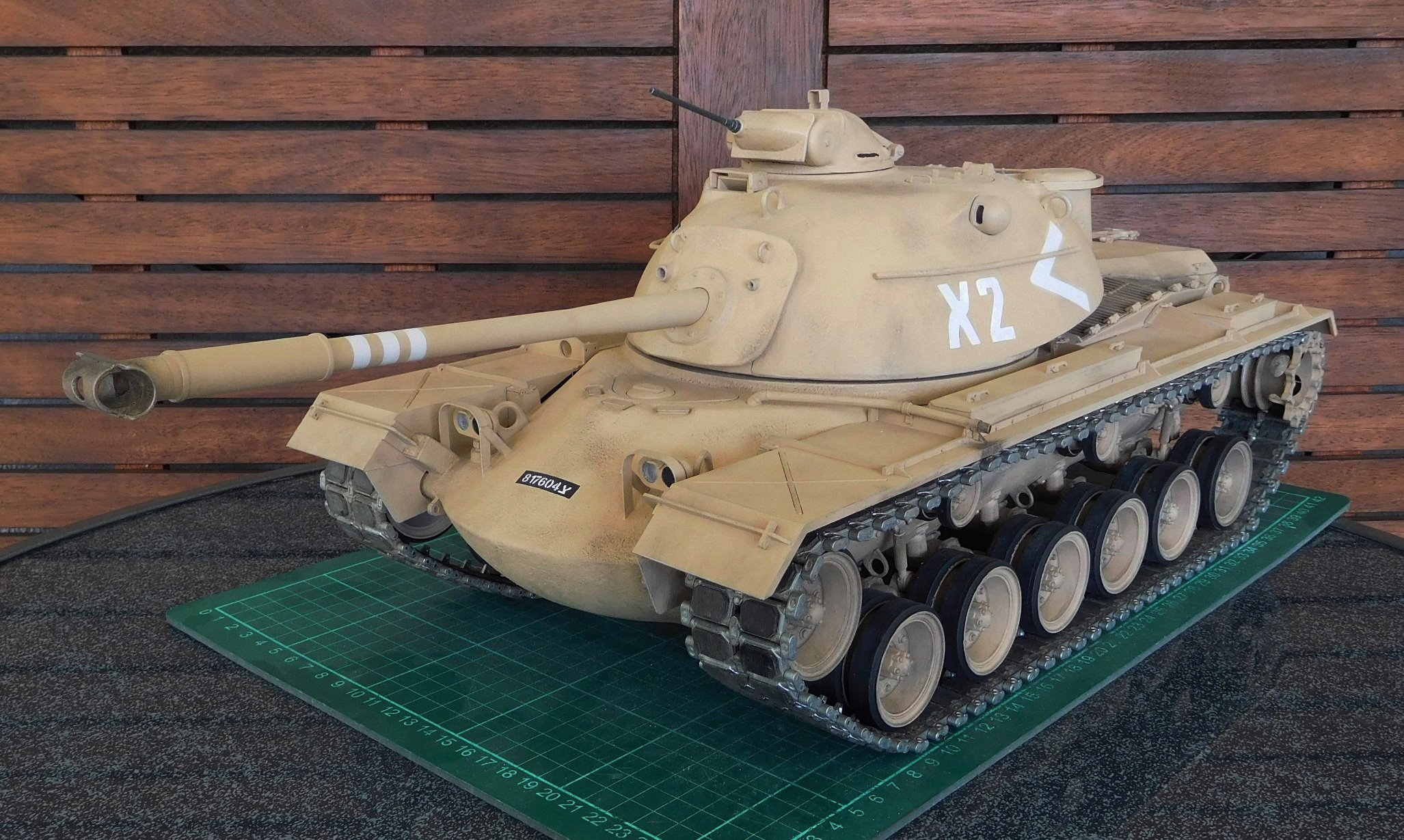

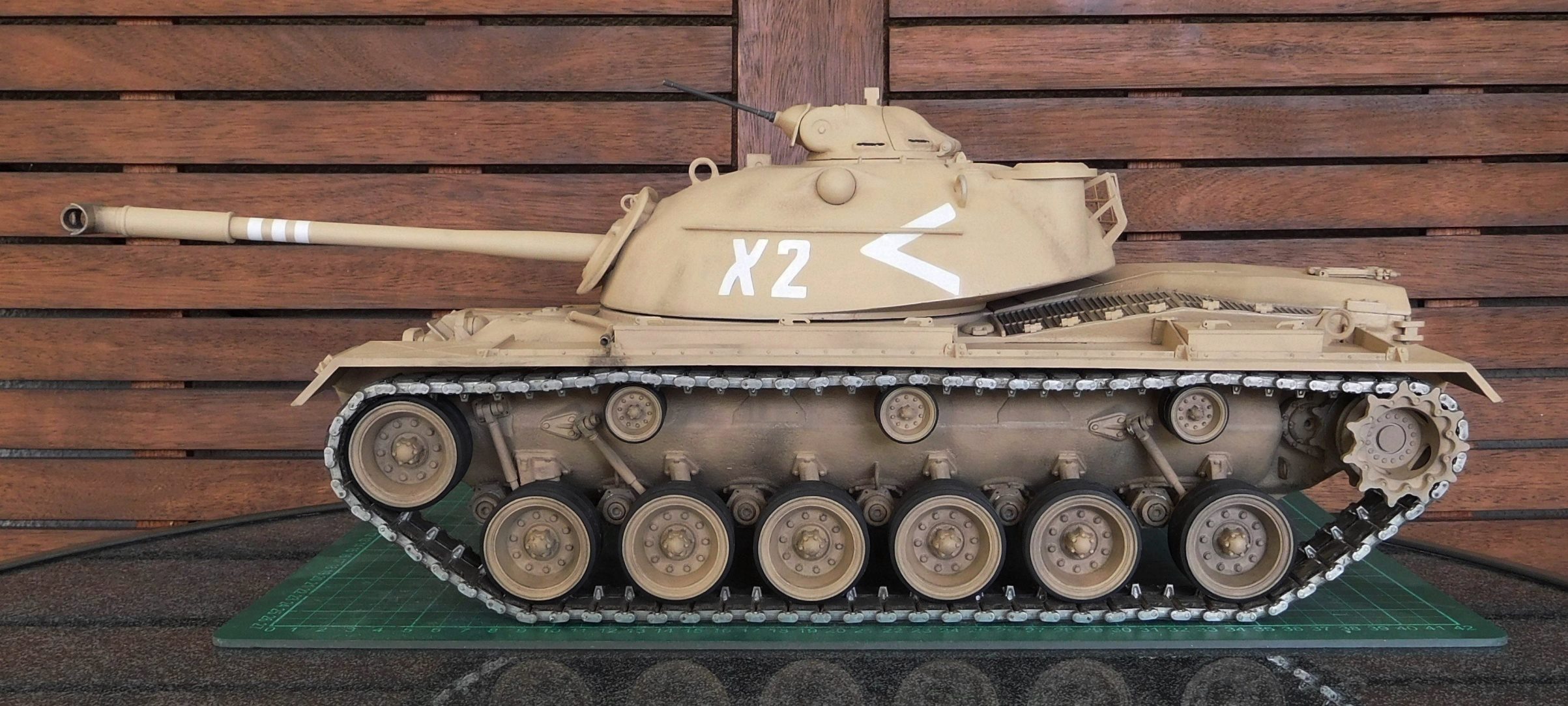

a little progress is done...
Since a long time I´ve wanted to build an IDF tank and after my Centurion Mk.III became a Korean fighter, this M48A2C will be a fighter while 6-Day-War in 1967.
Without any major changes the IDF (Israel Defence Force) took over M48A2C and renamed them Magach 2.
Meaning of the markings:
3rd Battalion (3 strips around gun barrel)
2nd Company (chevron heading forward)
2nd Platoon (number 2)
1st Tank in the Platoon (Hebrew alphabet aleph ?)
of the 7th Armored Division
a lot of personal gear is still missing...
Greets,
Freddy
Greets,
Freddy
