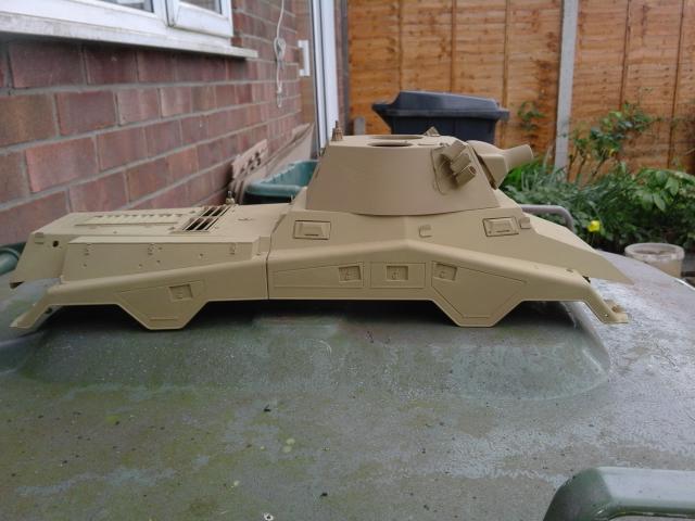

Post by silversurfer1947 »
I do my airbrushing outside and it really is too cold and windy, but I was determined to at least get a base coat on the whole vehicle. I also did not like the shiny black tyres, so they and the wheels have had a coat of AK Interactive dark dust wash.
