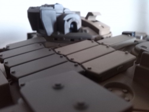

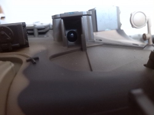

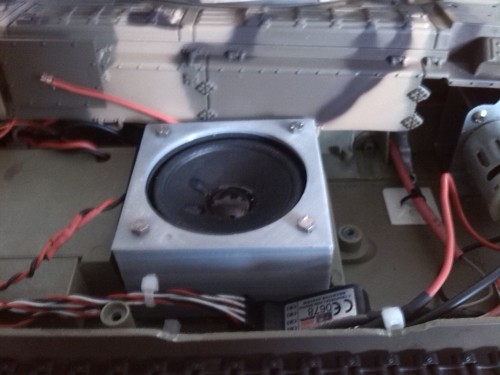

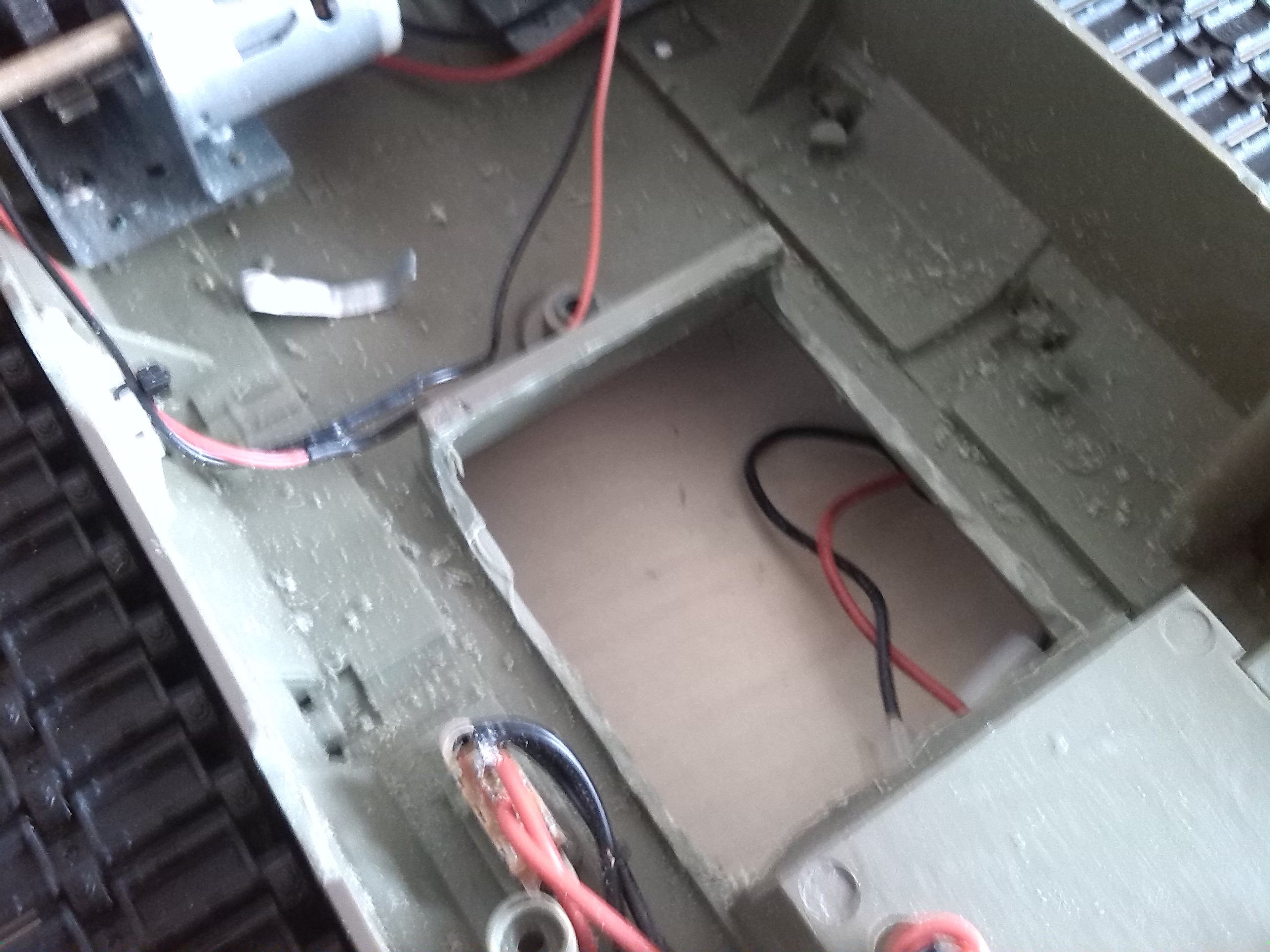

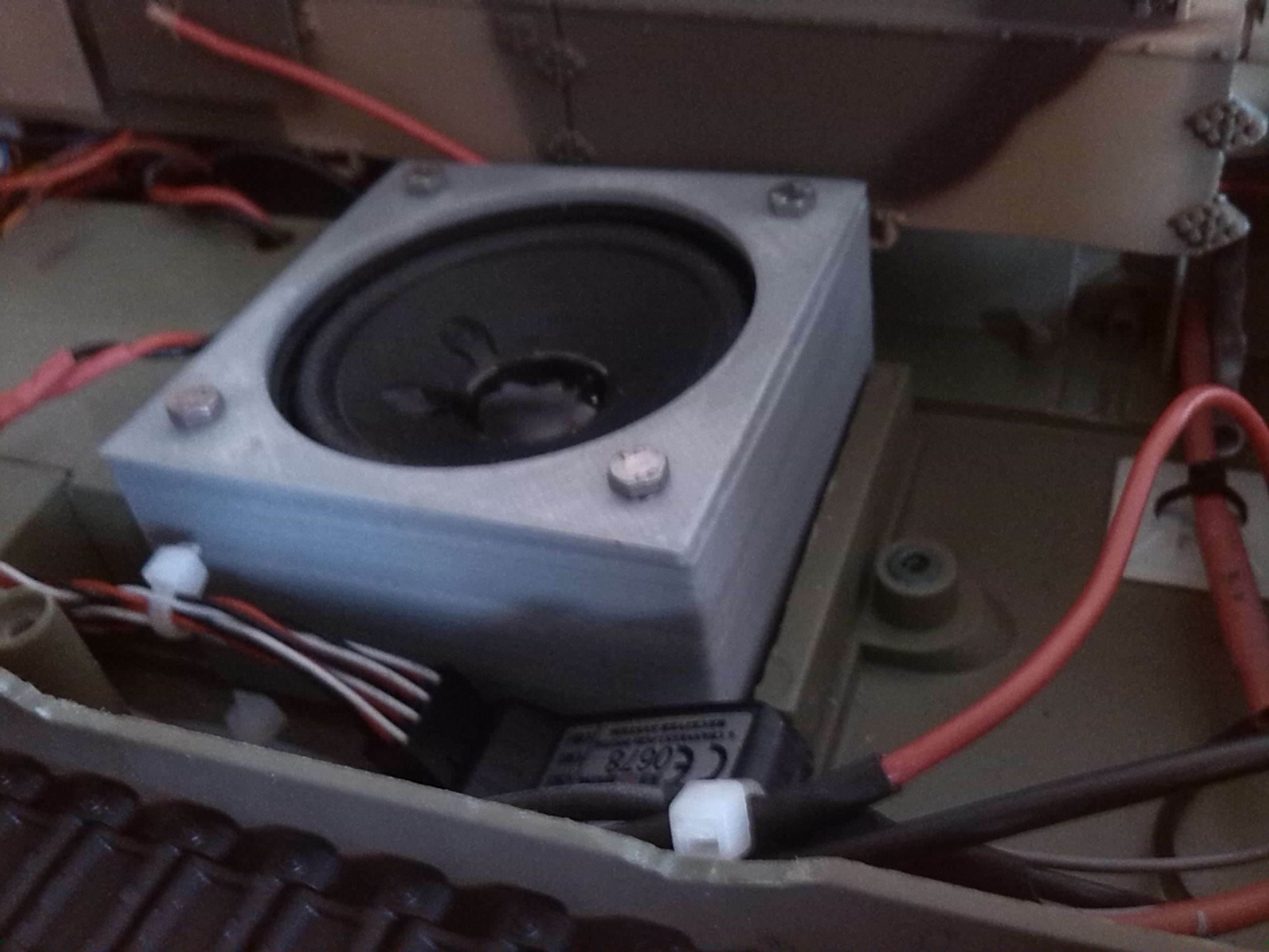

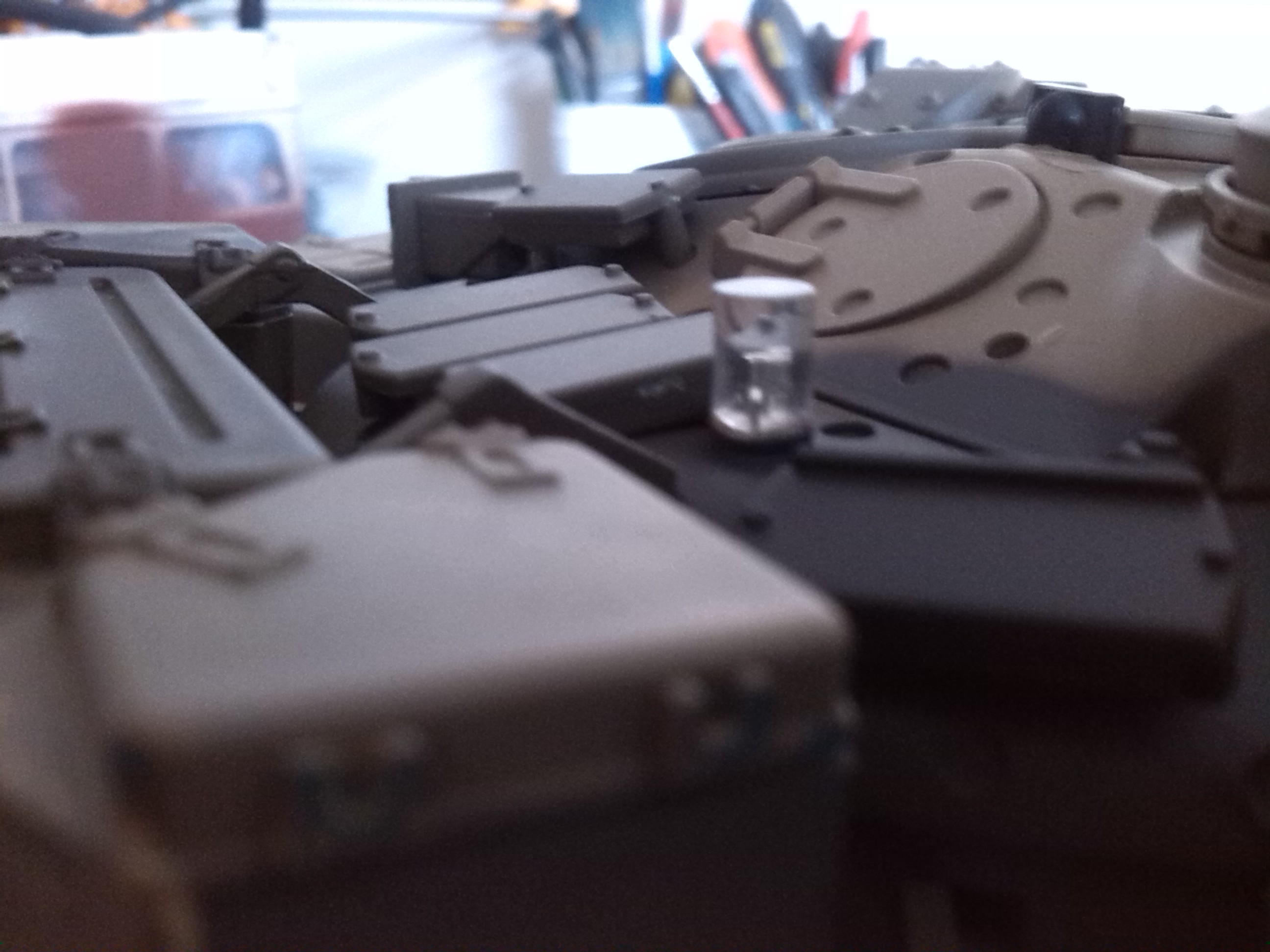

Thought I would post up a few pics showing what I have done by way of mods to this T90. Seeing as it will only get run outdoors about 1% of the time, the emitter may well go in an empty periscope hole. It means it won't move with the barrel elevation, but on a flat surface this won't matter. I'll feed the positive wire through an old airsoft switch so I can switch the elevation off anyway, it saves having the barrel accidentally being raised and lowered when firing the main gun.

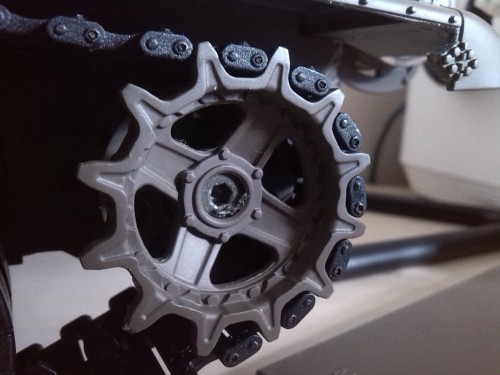

An added bonus of fitting the black steel gearboxes is that the allen bolts are larger diameter. The heads are an exact fit into the sprocket recess, which cleans it all up nicely.
If you are after cheap Visiton FR7 speakers, try here
http://cpc.farnell.com/visaton/fr-7/lou ... dp/LS03713
