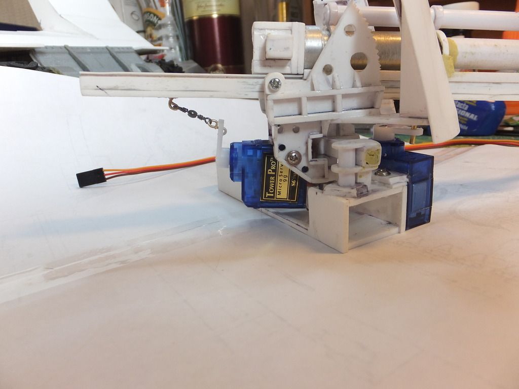

What fun I've had with the servos!!
I bought some micro servos intended for those drone copters and they really are tiny (thankfully). Did the usual gutting out of the electronics and connecting direct to the motor so it's basically a motor and gearbox, plus pruned off the lugs so they can run 360 degrees, then started to fit them. Fitting the elevation servo was fiddly, and then I hit the problem with the elevation servo needing to run in one direction only. Needed to make the connection swivel, so tried all sorts of things with brass rod and got really frustrated. Then came the light bulb moment and after plundering my fishing tackle box I came up with a miniature swivel that was perfect. I couldn't get as much elevation as I wanted but it's still pretty effective so I stopped fiddling, eventually enough is enough.
Gun slew was much easier and with the tiny servo it was easy to hide it where it won't detract from the model detailing.
Now to get the electronics sorted and the lights for gun muzzle flash and front and rear lights built and connected.
