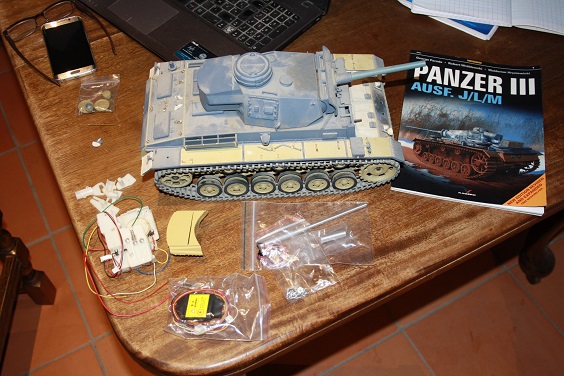

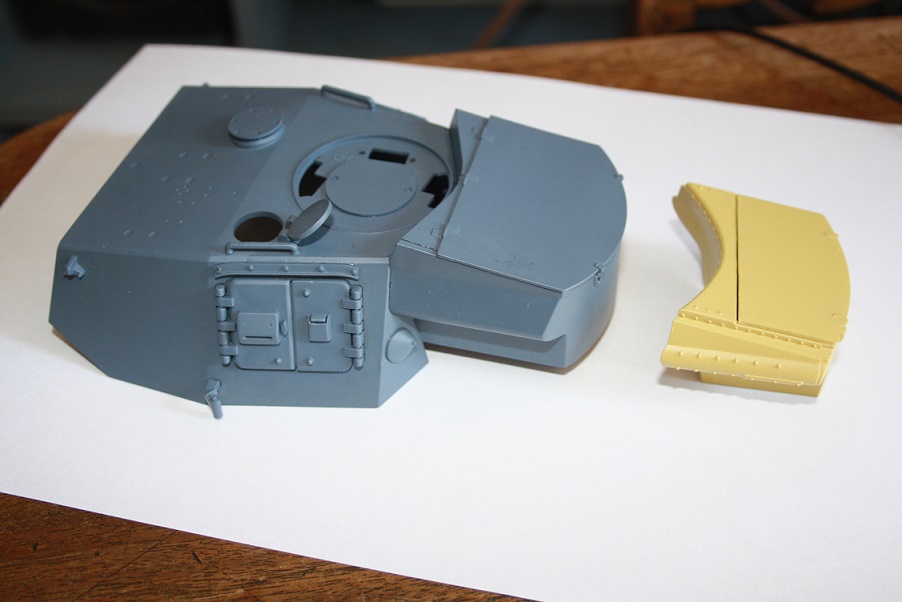

Hi all! Its been while but as I have some time on my hands I thought I would try and finish this project. First job is to remove the stock storage bin and replace it with a proportionally more accurate after market offering.
I've also got the Taigen recoil unit and turned barrel to install.
Electronics are not a strength of mine so hopefully once the cosmetics are done I can get it all working again!
My apologies for all the previous shots of the build as 'Photobucket' have decided they are their property. If anyone knows how I can fix this I would be interested.

I tried to fit aftermarket turret bins on my Panzer 4s, but in the end I gave up,
The problem is that both Heng Long and Taigen did not have enough space in the turret for the motor driving the elevation of the main gun,
The only space for it was in the turret bin hence the inaccurate hump,
Taigen have now seen sense and they have remodeled the turret and instead of a motor they have fitted a much more compact servo which fits snugly in the turret meaning that the bin on the latest Tanks are both empty and accurate,
This is what Taigen have done to the Panzer 4, :thumbup:
I do not know if the Taigen Panzer 111 has been modified yet but the total overhaul of the PZ4s turret has produced something that rivals Tamiya's own PZ4 in detail and accuracy and I never thought I would say that :crazy:

Hi Jarndice! And thanks. I'm installing the recoil unit in my Panzer III. The over sized storage was to allow for the elevation motor. I hope i'm right in saying the recoil unit has the elevation mechanism incorporated. If this isn't the case, honestly, as long as the turret turns and the gun recoils i'm not really bothered. I guess i'm looking to build a model that looks right even if all the functions don't work.

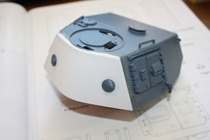

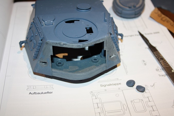

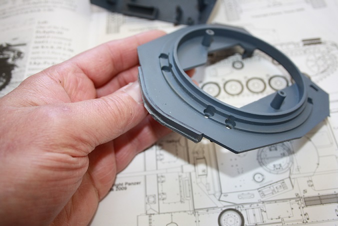

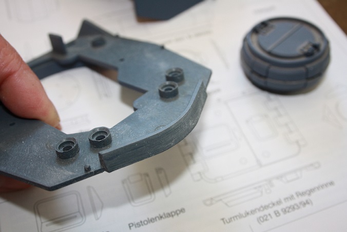

Back to the action. Some shots start to finish of removing and repairing the rear of the turret with plasticard. Cut off the storage bin from the top and bottom half of the turret.
I left the tab on the bottom half to act as a former for the plasticard repair.
Cleaned up.
With plasticard attached. The tab isn't bonded so the two halves of the turret remain separate.
Pistol ports reattached.
