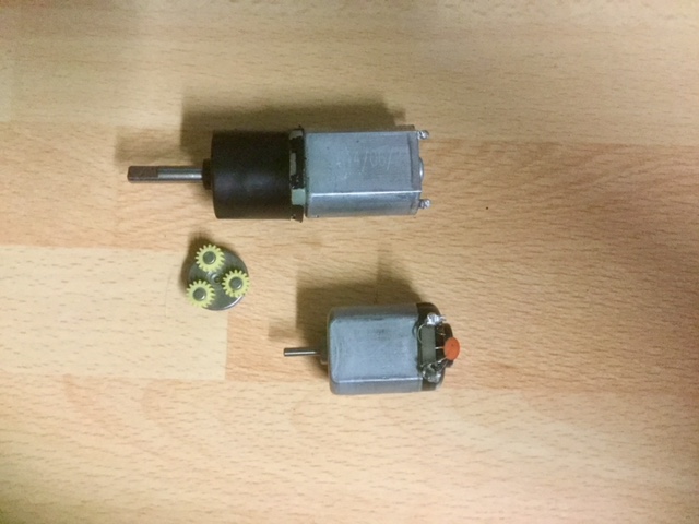

Re: HL Truck Mods
Found these 130 motors with sun gear in china.
They were for to slow at 20 rpm/min, but when i took out one sungear from the gearbox they turned into approx 120 rpm/min.
I have not tried them in my HL truck yet, but with dual motors i think i will have slow speed and lots of torque.
Original motor shown also
- BF56DA75-E875-418B-B669-B773DBF3BAA6.jpeg (98.36 KiB) Viewed 2248 times

Those 130 gears from China look pretty good, but they will require a major overhaul of the Dual motor mounting box
