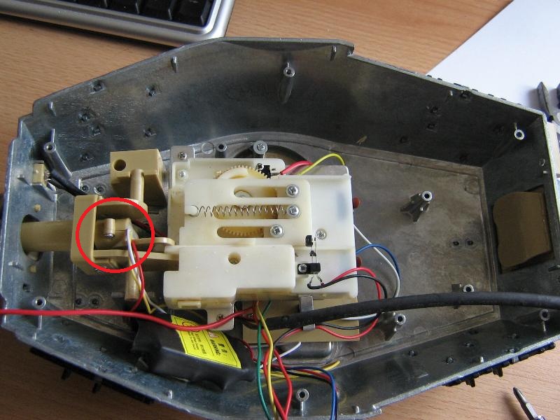

Hi Jussek,
normally you can't turn the gun barrel (like a screw), but it's still not impossible.
In the pic I've circled the gun barrel holder in the turret, how you can see, is it only srewed with two screws. If they are not right tightened, then you can turn the barrel.
To repair this you must take upper hull from lower hull and disconnect turret from upper hull. Afterwards take off turret ground plate and your view is shown as well in my pic. I hope for you, that there's no damage. Eventually you must take a drop glue to fix it.
Greeting Hotte

hi Hotte,
i'm to admit that i'v been a bit lazzy (well, busy with another cat), i could have done that for myself... :{ but as i've done nothing yet with my new tank except for test if all functions are working, i preferred to ask, hopping it was a direct reply... ;D
I forgot to say that my tank is a BB shooter, so our guns guts are different, and it shoots anyway, so nothing is lost yet ;-)
