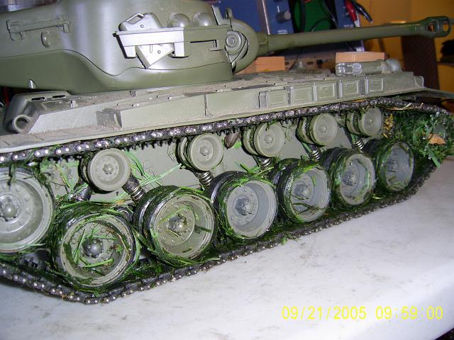

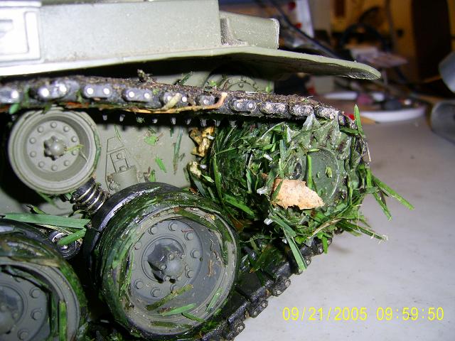

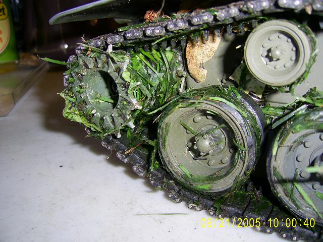

I installed my taigen 2.4 Ghz in my H.L. Pershing last week ; and took it for a " stress" test this morning ...
50 minutes of driving in wet grass in the park ....
