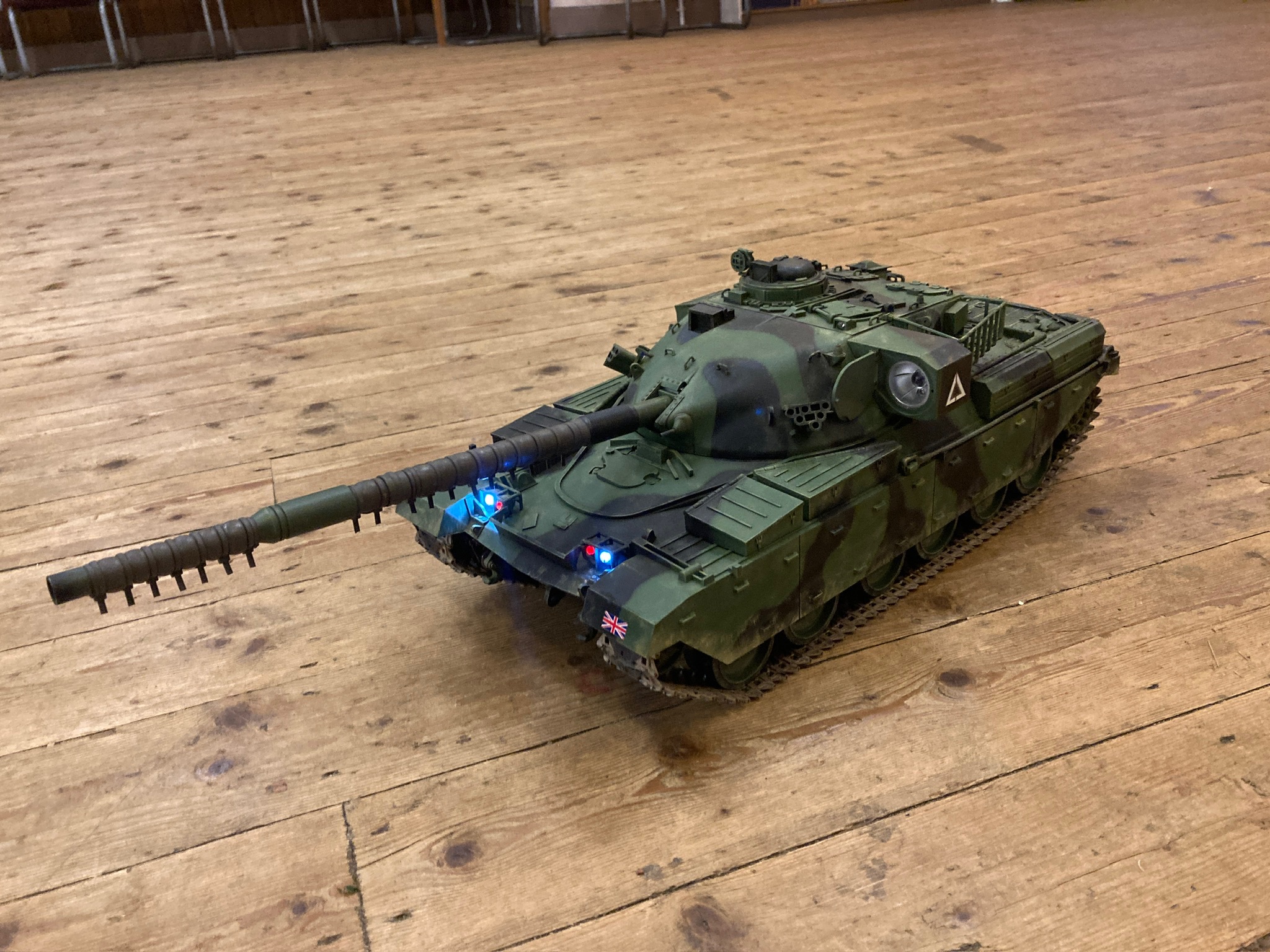

Re: HAYA Chieftain Mk3. "Stand-off" Scale Thermal Sleeve.
I have just completed changing the loose cloth barrel covers that came on the HAYA Chieftain for something that looks "a little more" like the thermal barrel shelves when it is viewed as a "stand-off" model.
My simple "bodge" used some thin foam sheet and some small cable ties. The above picture shows it at its very worst angle as the tank will seldom be viewed from underneath and it looks better when viewed from a more normal angle above the tank, but the straps need to be refined to make it a little more convincing although the basic idea has some merit.
The cable tie "clasp" looks a bit like a buckle or a clamp (as long as you are not stood too close and squint a little bit), and leaving the ends a little long when they are cut off can replicate the long strap ends that can usually be seen hanging down from the Chieftains barrel.
I am going to try painting the "thermal sleeve" with a suitable Tamiya acrylic colour (I used Tamiya Khaki Drab ?) to see what it looks like after painting and weathering with the 'straps" picked-out in a suitable brown colour. If this does not look as good as I hope it will, I can remove the cable ties and cover the foam with the thin cloth that I have just removed and fit new cable ties over them both (it will still need painting to a more suitable colour).
There is no suggestion from me that this could be seen as anything like a "true scale" replica of the thermal barrel, but as a "stand-off" scale modification it already looks a lot more realistic than the original HAYA loose cloth covers did when viewed from a few paces away, and if the foam takes the Tamiya paint OK it will be a good "bodge" that is easy to achieve with just a few minutes work and at almost no cost.
If I can find some thinner cable ties that are less than the 2mm wide ones that I used, I will change them as the ones that I used may be a little wider than I would have liked - but they were laying around in the workshop (shed) and I had itchy fingers and wanted to see if my "quick-fix" idea would work.
In the longer term it would be possible to make a much better and more accurate representation of the Chieftains barrel sleeve, but for what I wanted as a 'stand-off" look I am happier with the appearance than I was with the original loose covers and as long as the foam takes the Tamiya paints OK it could be all that I need to improve the appearance of my HAYA Chieftain for my own "stand-off" scale use.........but I do want to find some thinner cable ties that have smaller clasps.....

Mr tanks a lot did an excellent tutorial on the thermal sleeve
