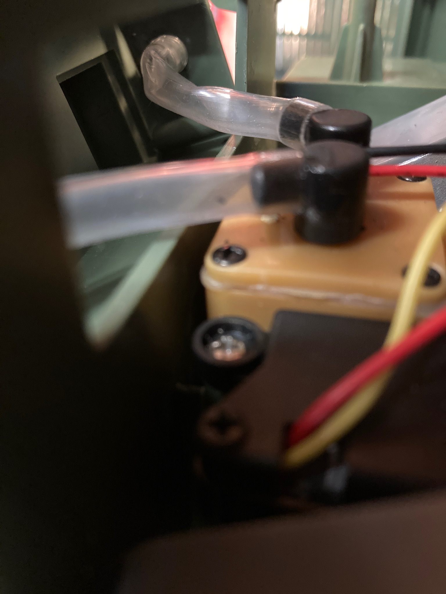

kinked smoke tube stopped one side working
one tube working - one tube blocked.
Tygon tube replacements.

The exhaust smoke on my example is not very impressive and the smoke only came out of one of the two exhaust outlets. On inspection I found that one exhaust outlet was blocked due to a couple of kinks in the thin walled clear tubing on that side. The only tubing that I had to hand was some translucent yellow Tygon petrol tube. This tube has much thicker walls and is impossible to kink so I removed the back panel of the tank to gain access so that I could remove the original tubes from both sides and replaced them with the Tygon tubing and refitted the rear panel. This solves the problem with smoke now coming equally out of both exhaust outlets - but only just as my tank was still not generating very much smoke.
After I figured out how to switch on the main gun smoke I was surprised at the amount of smoke that came out of the barrel with every shot. Very impressive - and it puts the pathetic dribble of smoke that comes out of the exhaust tubes to shame. I was thinking that maybe I could find some better smoke fluid, but with the main gun smoke being so impressive there is obviously nothing wrong with the fluid provided with the tank. Compared to the clouds of exhaust smoke I see on other peoples videos coming from the same smoke unit I need to take a look at mine to see if I can adjust it in some way......or at worst .....replace it with another unit that works better.
