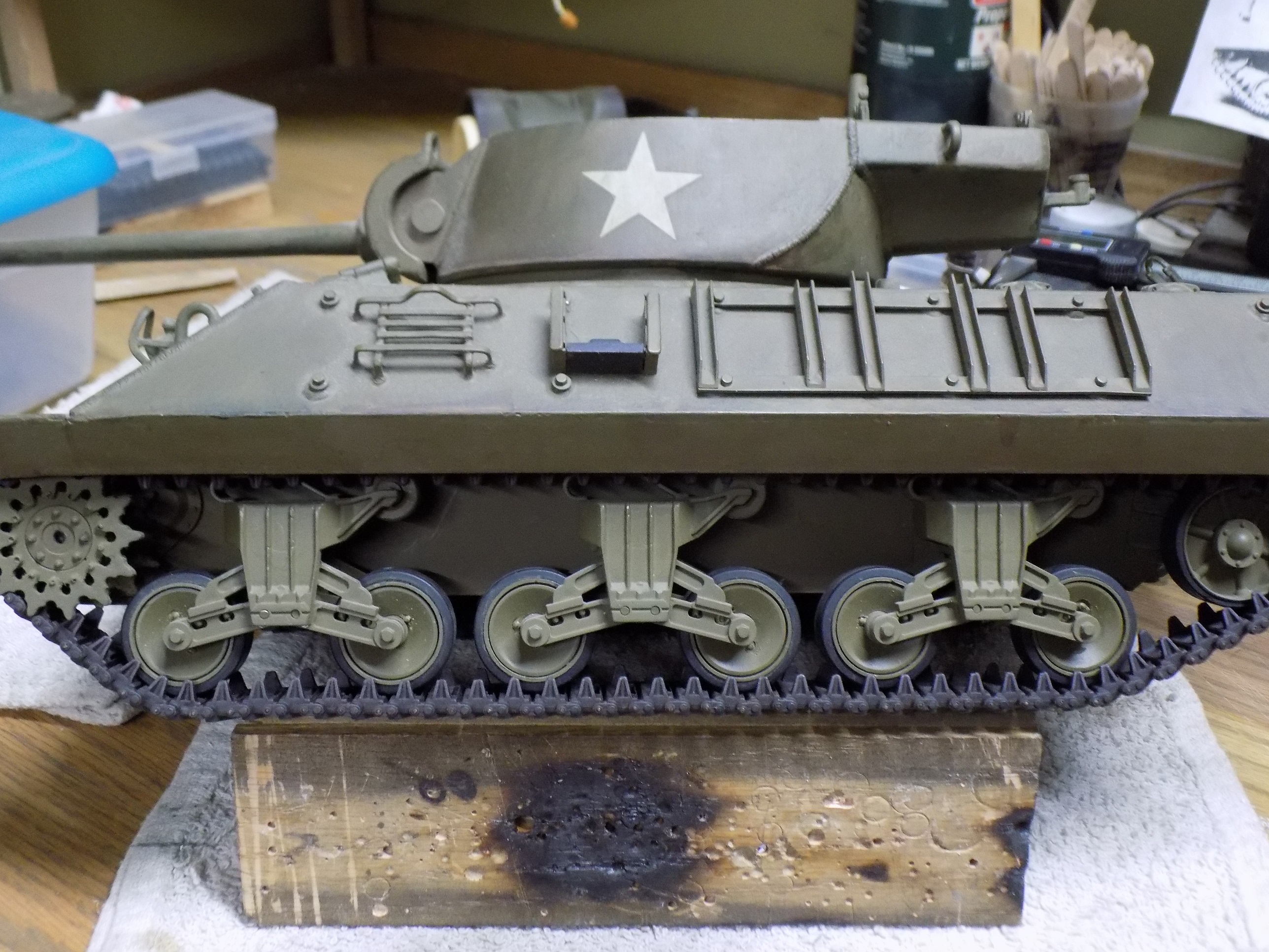

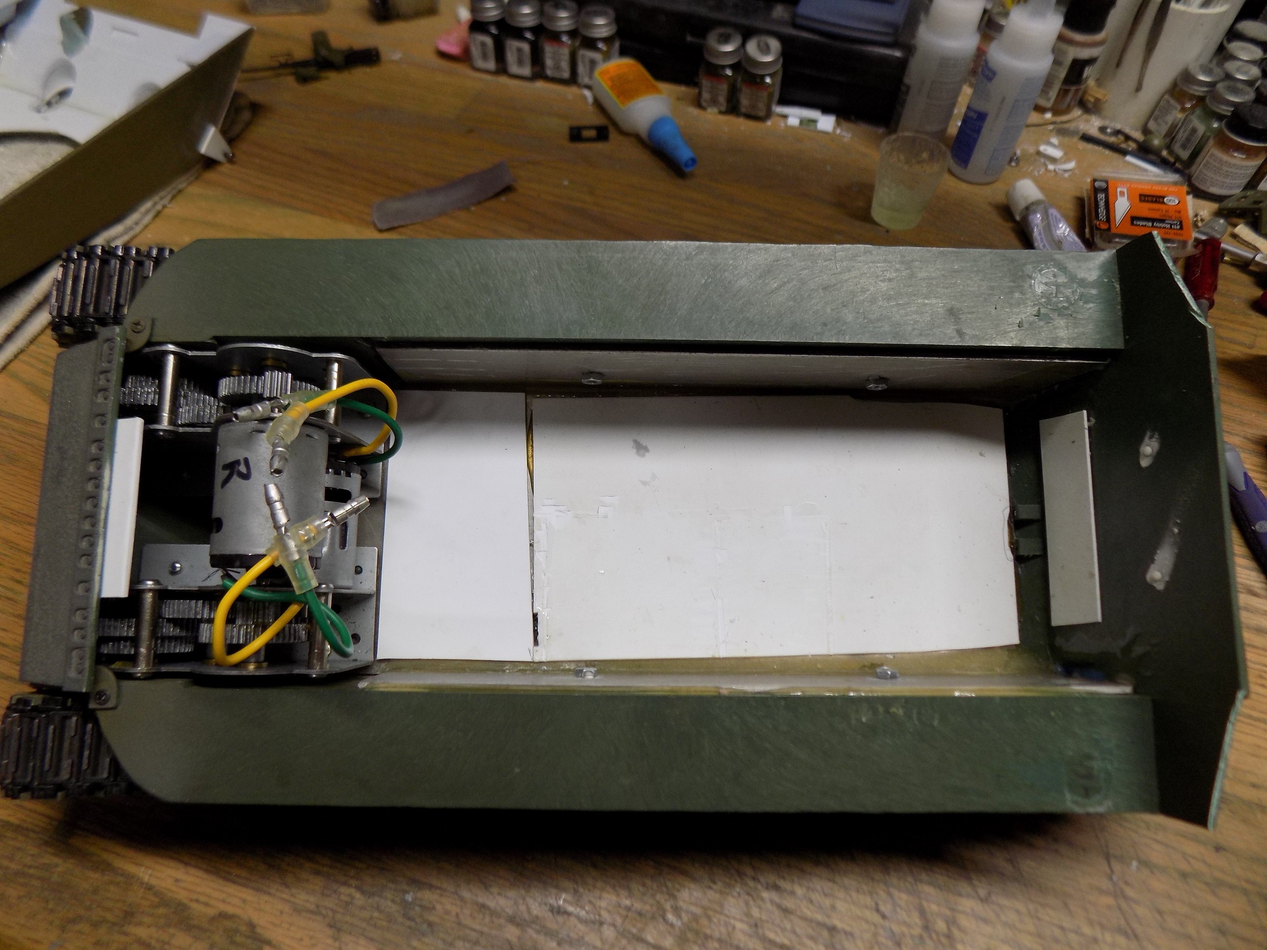

Slight change of plans. Obviously need to order a HL M4A3 for the build (have been borrowing the M10's lower). Would like an upgraded trans, reinforced hull and then modify it to fit the Tamiya hull. Well then it dawned on me, my M4 composite has those features and metal drive sprockets, tracks (steel bar cleat) and idlers and the hybrid hull was a Tamiya. So eventually I'll get a replacement for the composite but now I can continue on with the build.
I did have to swap bogies with the M36 because Sassgrunt's awesome dished wheels weren't available in time for D-Day (the bogies are slightly modified, Mike's wheels have bearings).

The modified hull has aluminum on the floor and walls. I always top the floor with styrene for a glue surface.
M32 42.JPG (1.15 MiB) Viewed 103 times

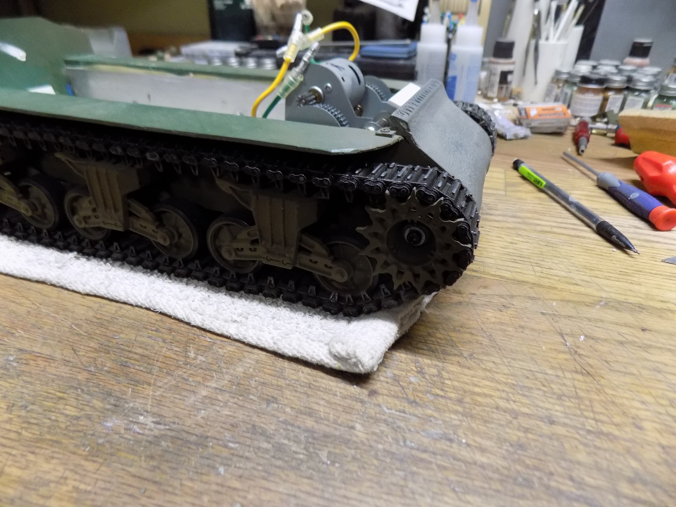

There will be a drum on the right side drive sprocket for hoisting the crane, not sure if the plastic sprocket one would be strong enough. The T-49 steel cleat track was installed on nearly all of the pilots and early builds (the ones in time for D-Day).
M32 43.JPG (1.34 MiB) Viewed 103 times

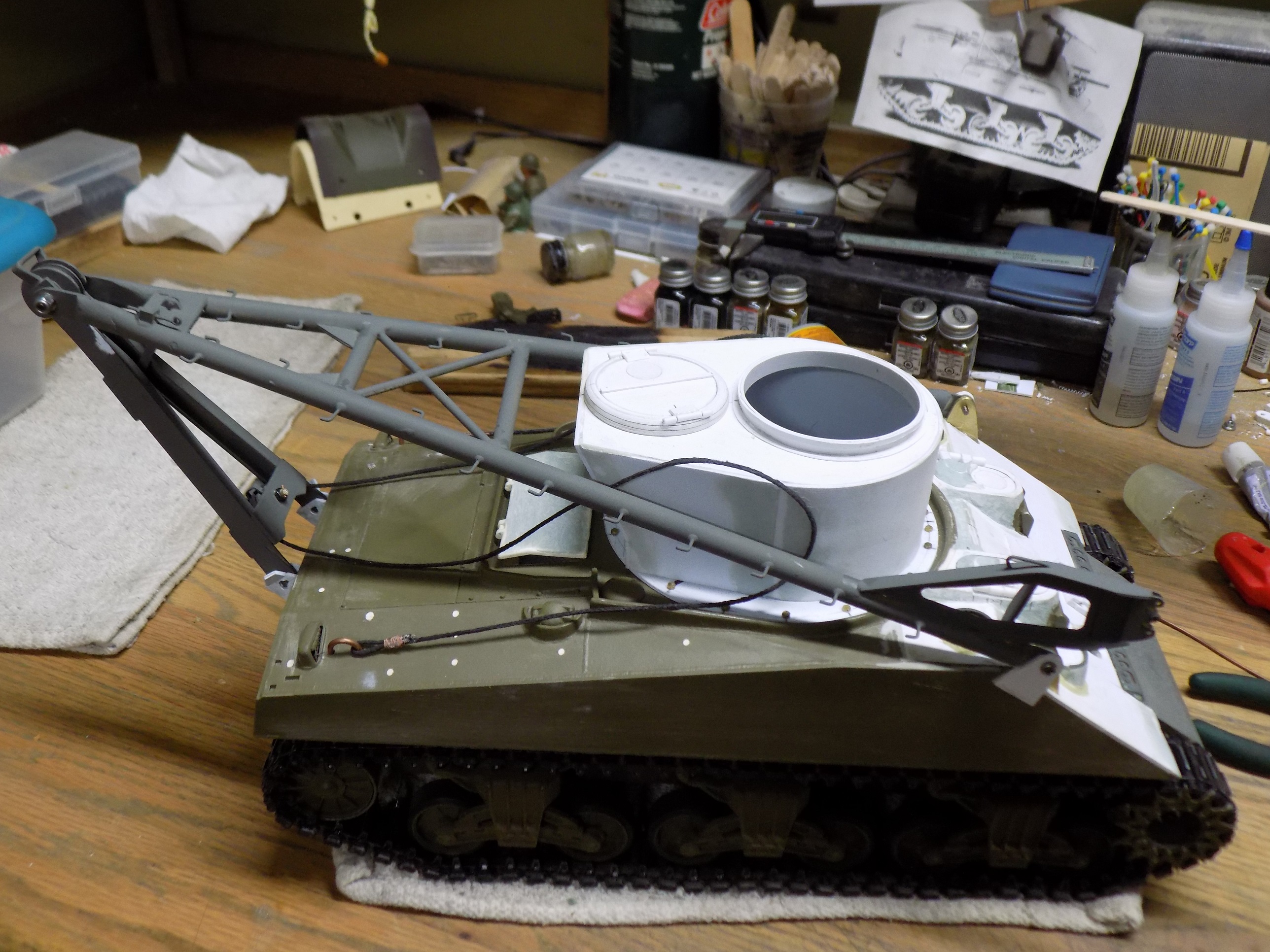

And finally, I finished the ladder rungs on the boom. Low man on the crew was probably elected high man on the crane...
M32 44.JPG (1.21 MiB) Viewed 103 times
Perhaps elected is the wrong word...

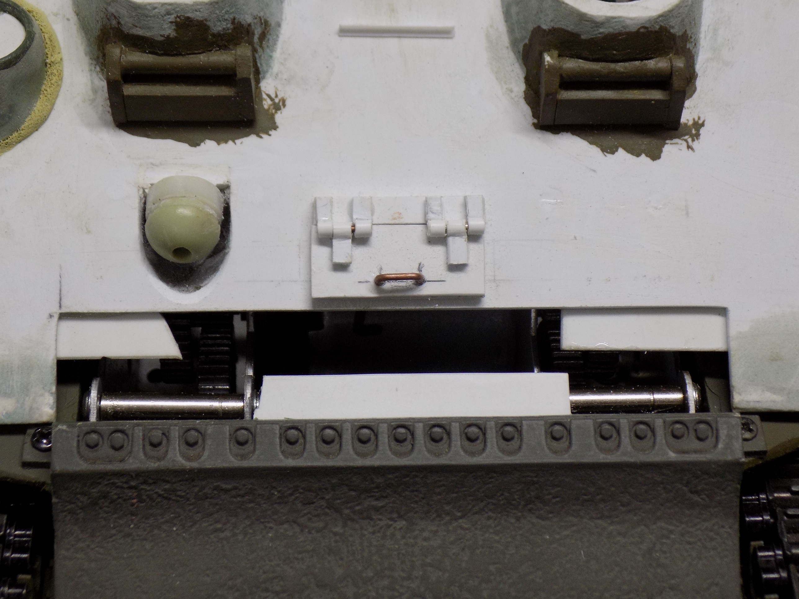

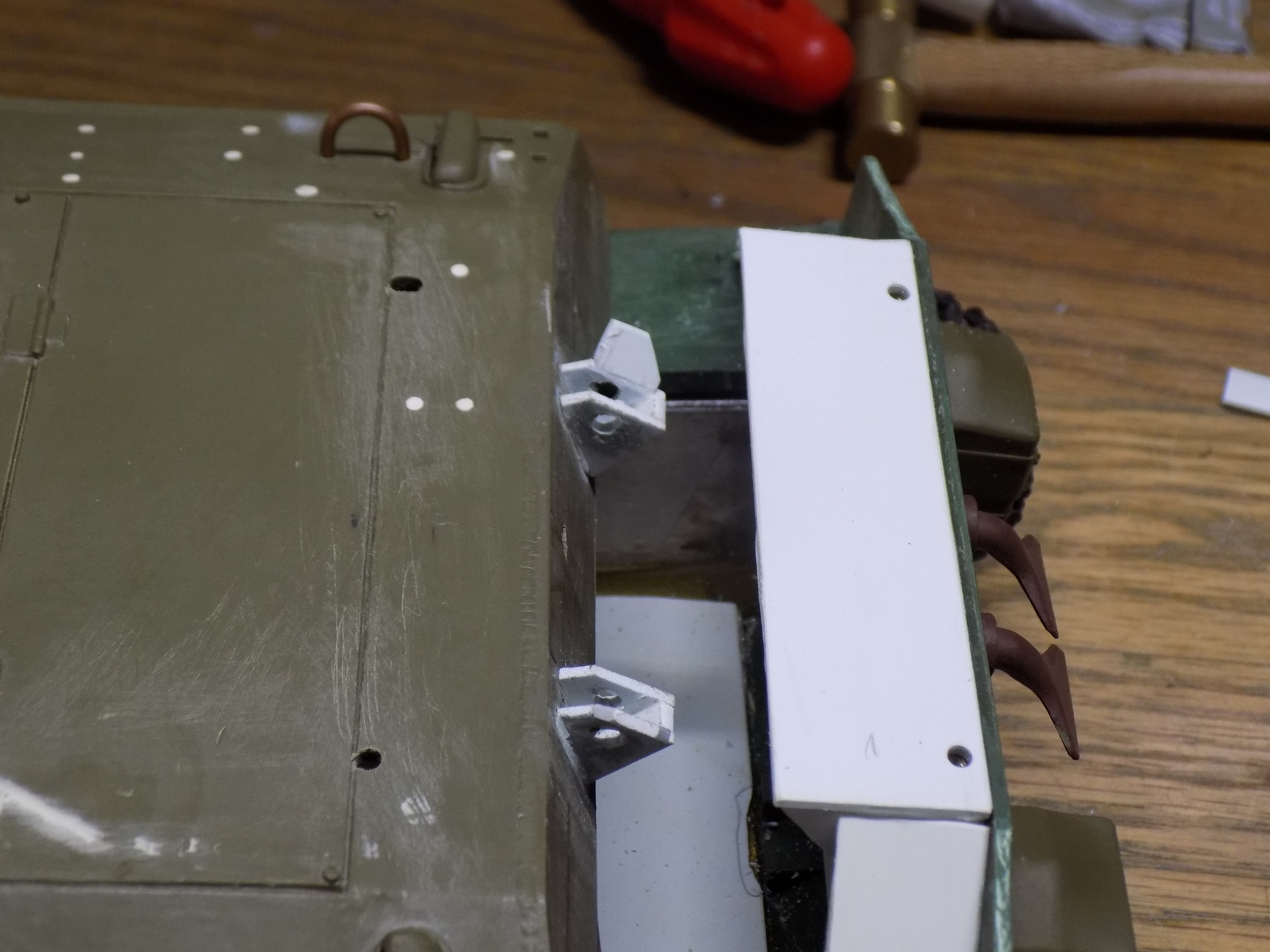

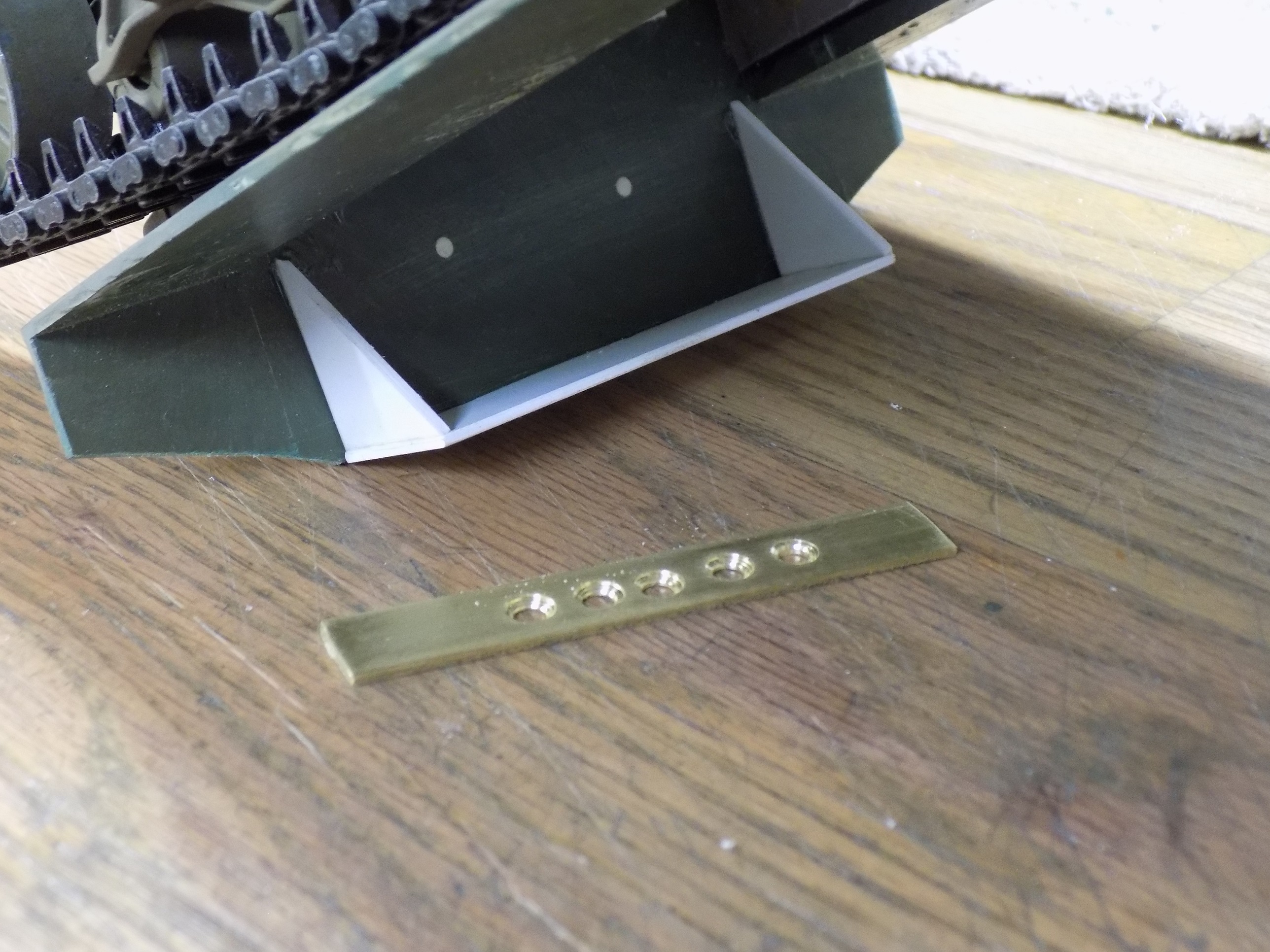

I figured magnets are not going to cut it for mounting the upper to lower with the crane thing. The front of the hull nest in the trans mount. I made a mount for the rear that will be bolted. Great thing on this build is the rear deck will be covered with three boxes and a variety of pulleys, stop blocks and what nots, will be no issue hiding the screw heads. Yes it will take extra time for battery changes, but I think it is worth the effort. If needed there might be some mounts under the ventilators, but we'll wait on that for now.
