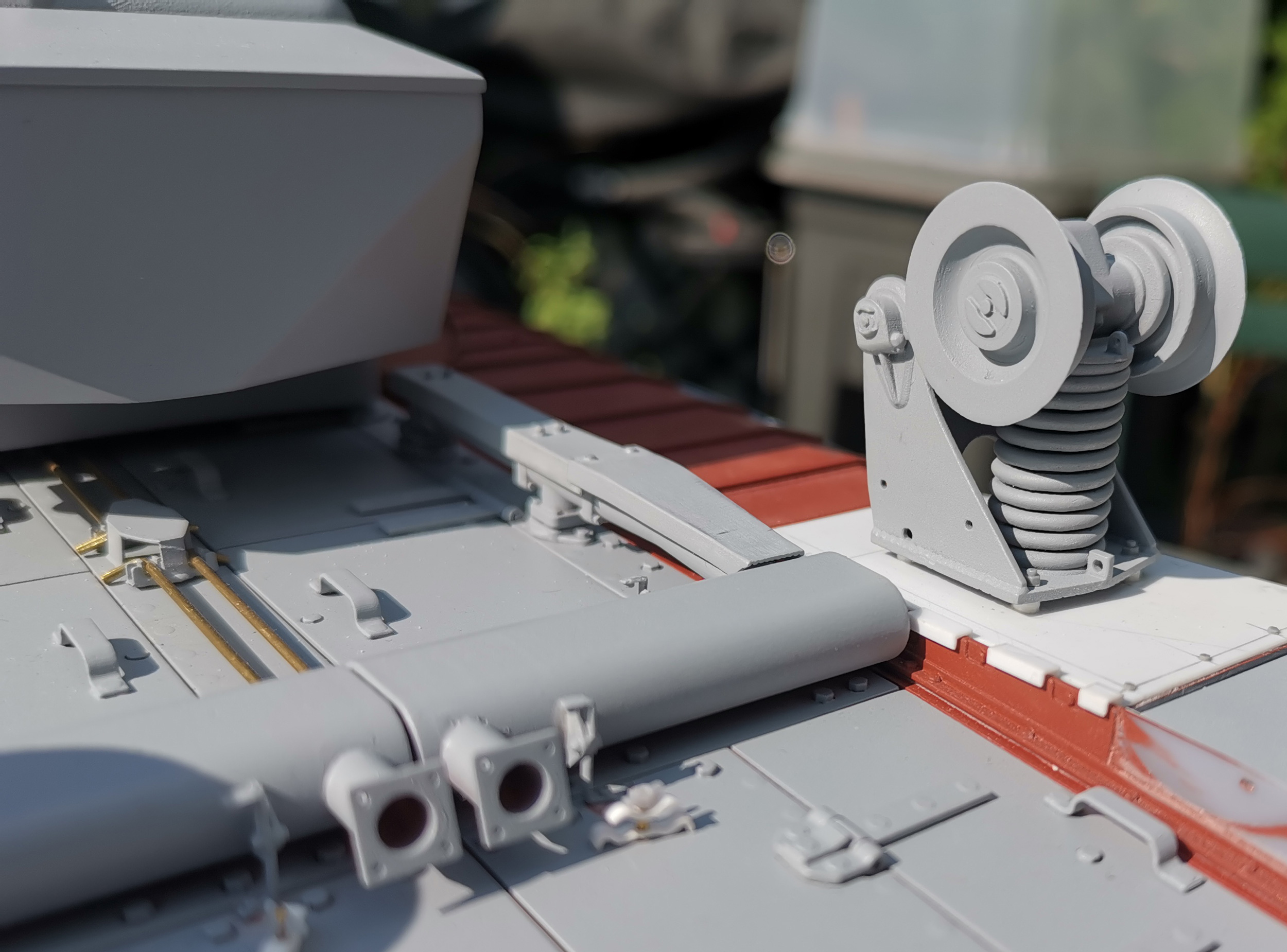

I made the tool suuports that go on the rear engine deck. I 3D modeled as accurately as possible the wing nut.

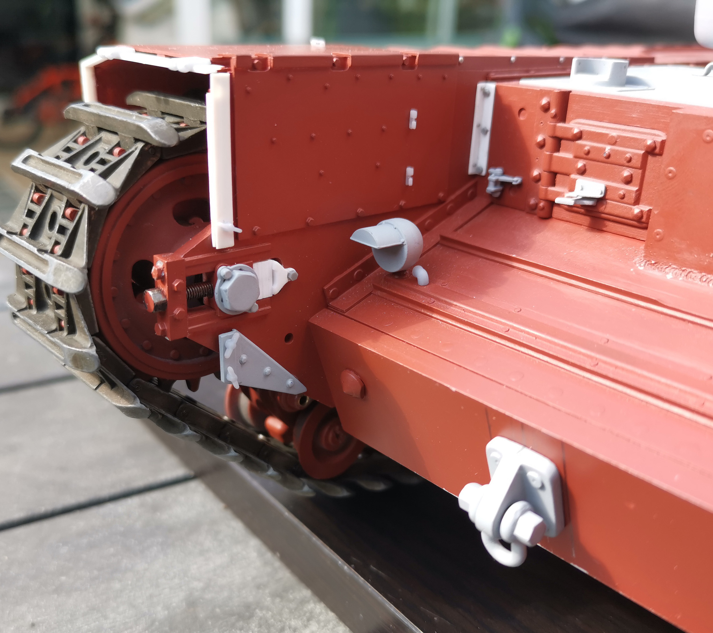

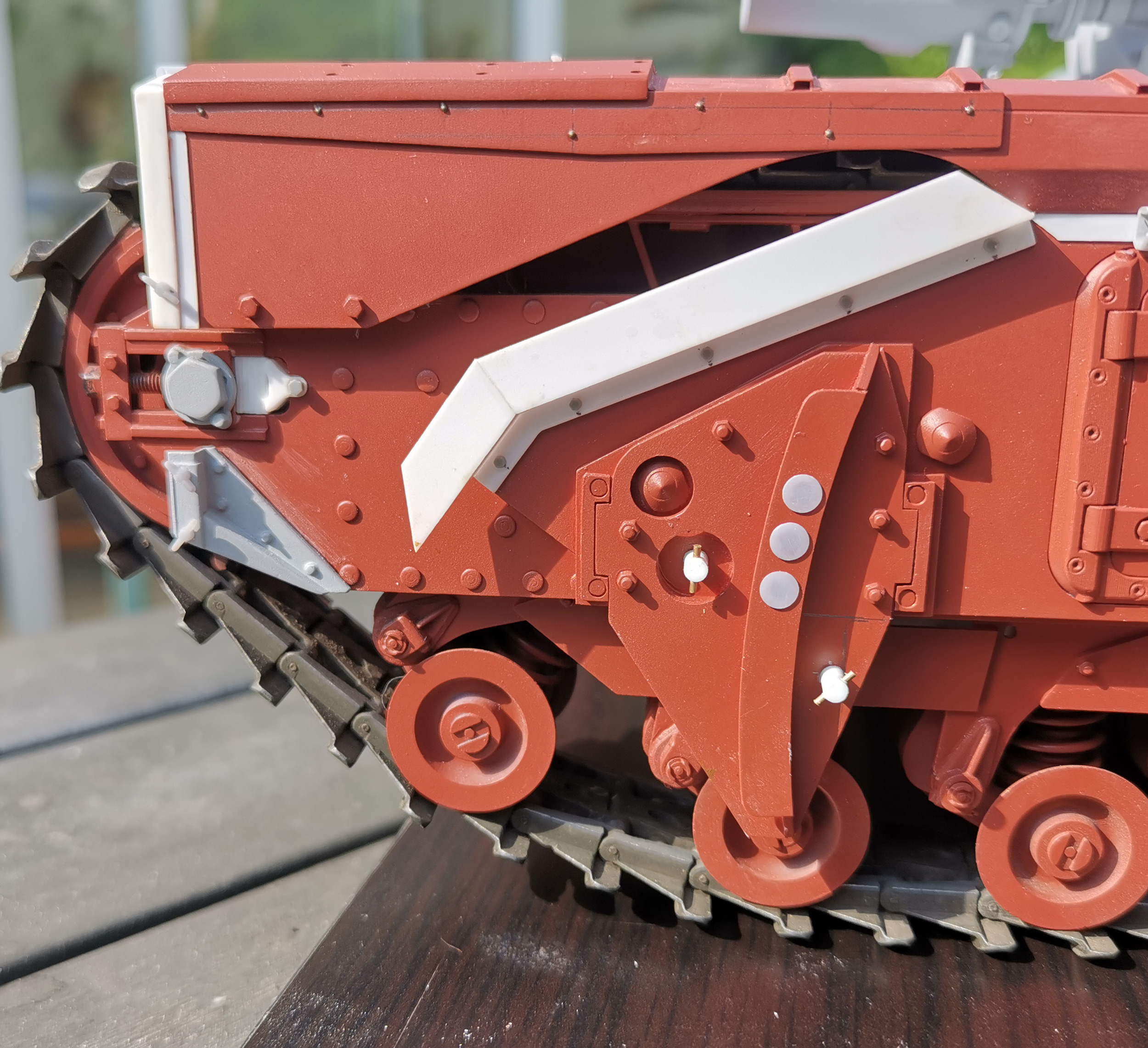

I have added all the details on the track tensioner parts.
You can notice the attachment supports for the front fenders (which won't be installed), the wing nuts are of a different style than the ones used on the rear engine deck.
My parts for 3D printing :

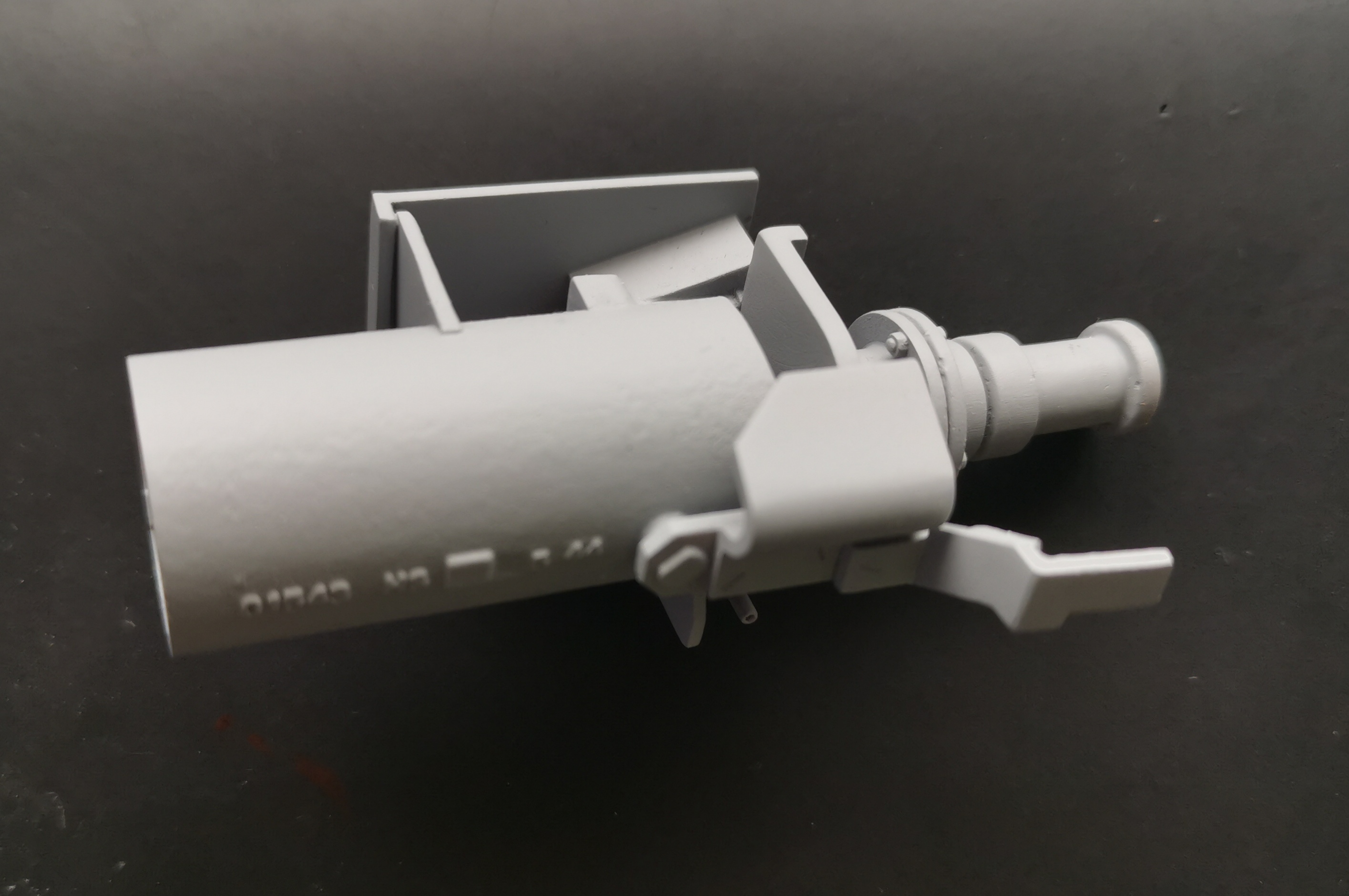

I made new side air filters. They are fully 3d printed, it's been quite hard to get good parts are they had tendency to warp.
I have accurately reproduced the grill mesh, not pictured here, I'll take a pic of it when I got time.

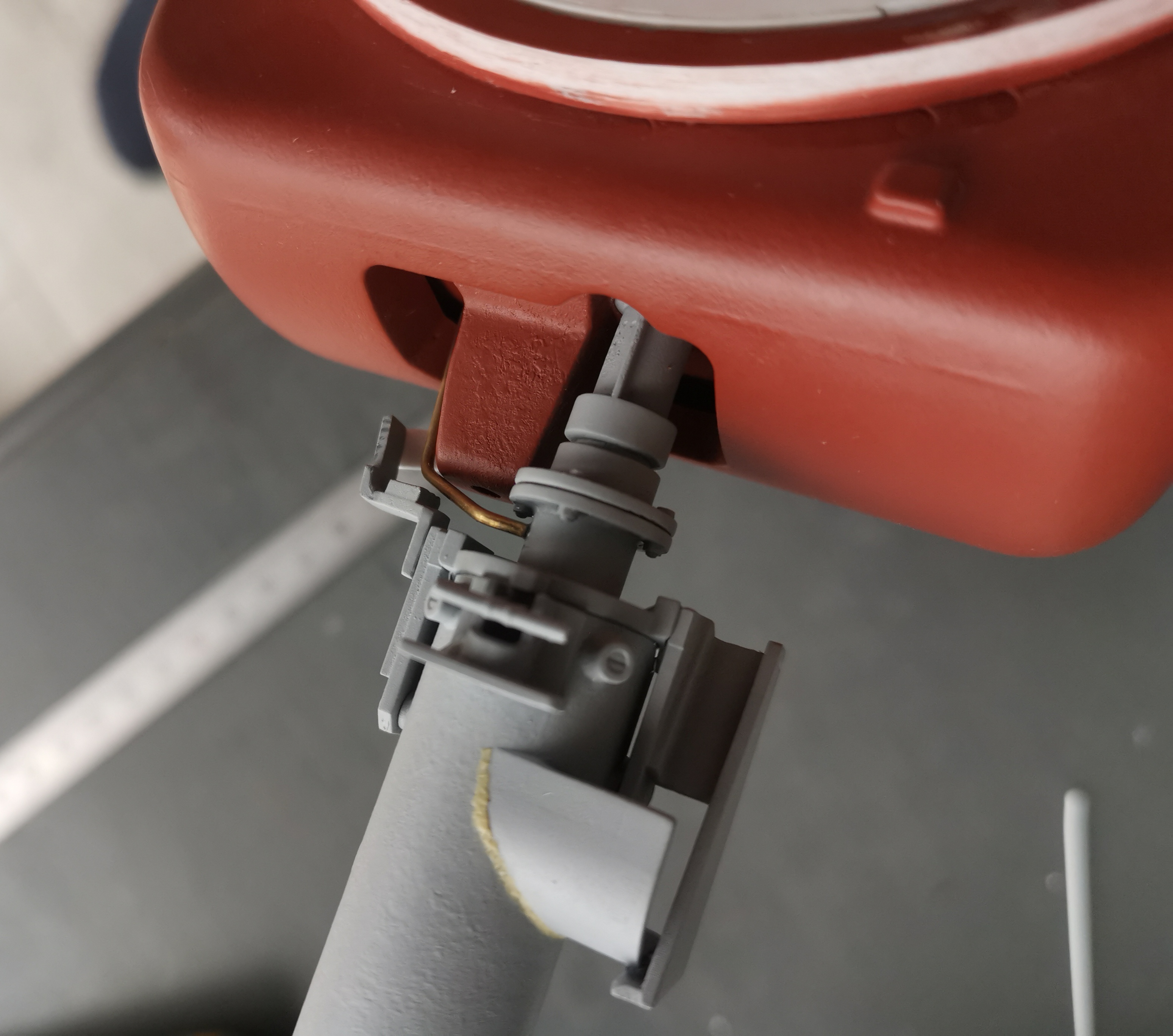

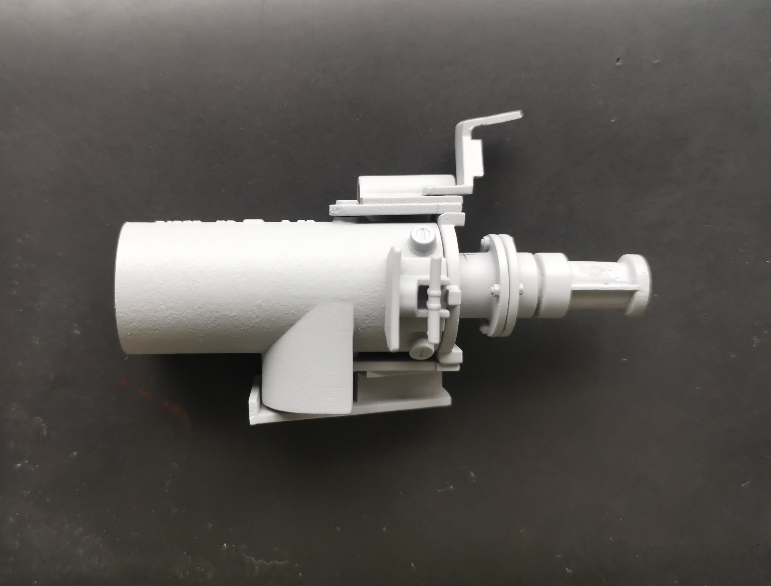

The AVRE spigot mortar is a kit in a kit :)
I have added the wire that goes from the inside of the turret to the mortar to fire.

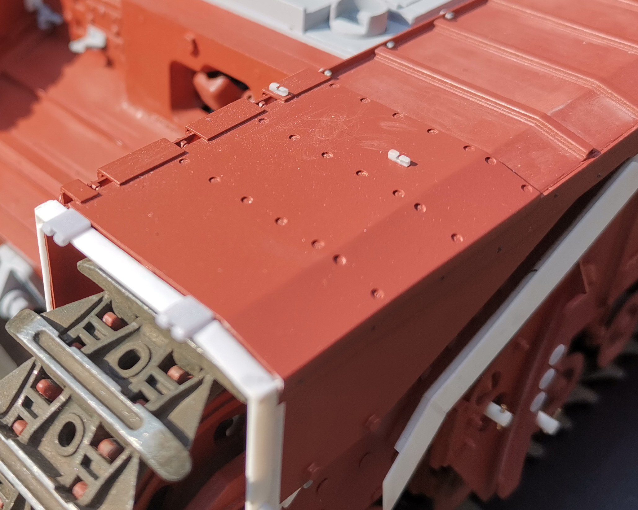

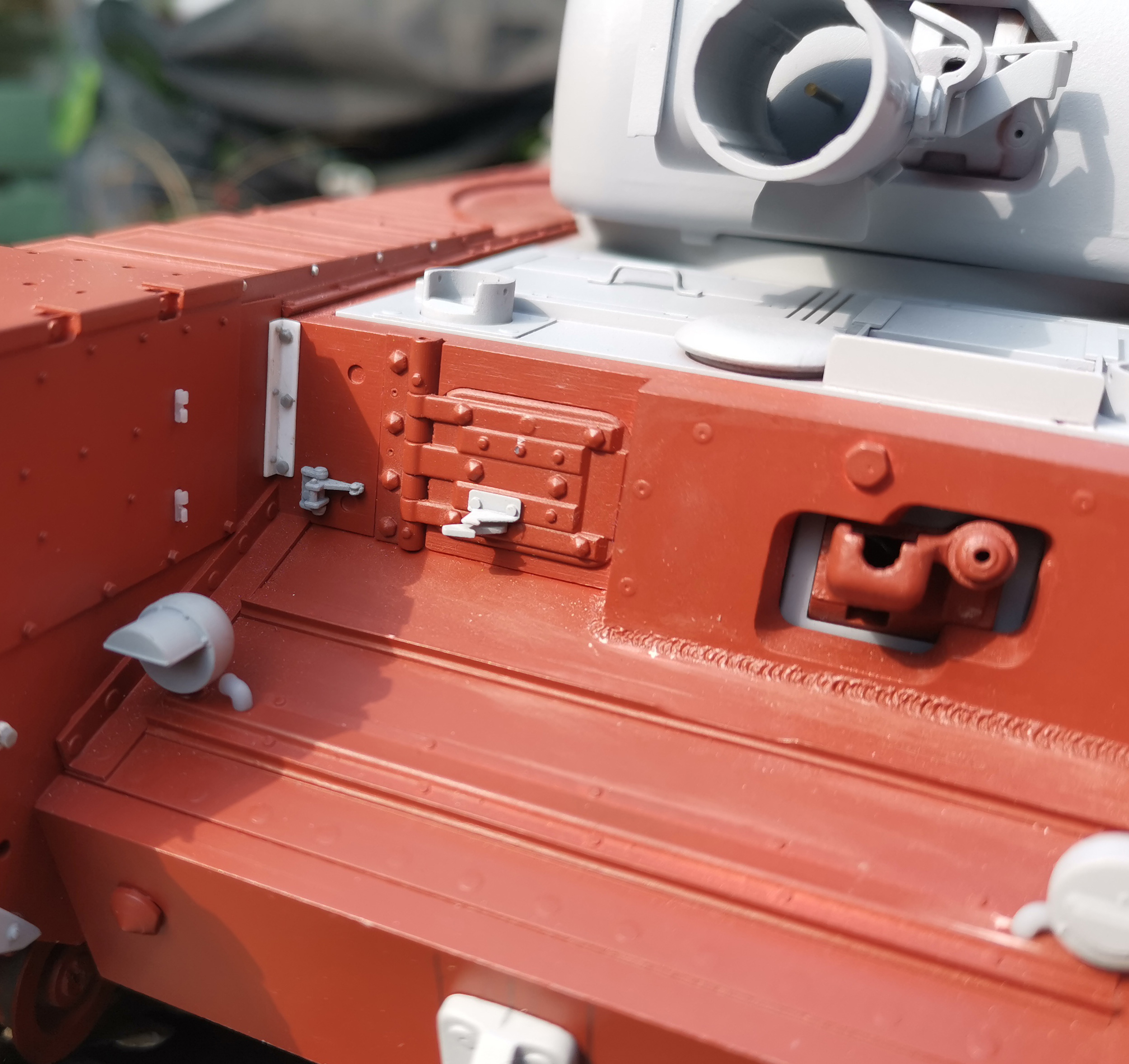

I made the small screws on the hatches using styrene rod. I used a saw to make the notch, was not easy to be dead center on a 1mm rod!
I've also made the hatches brackets allowing the hatches to be locked in 2 positions.

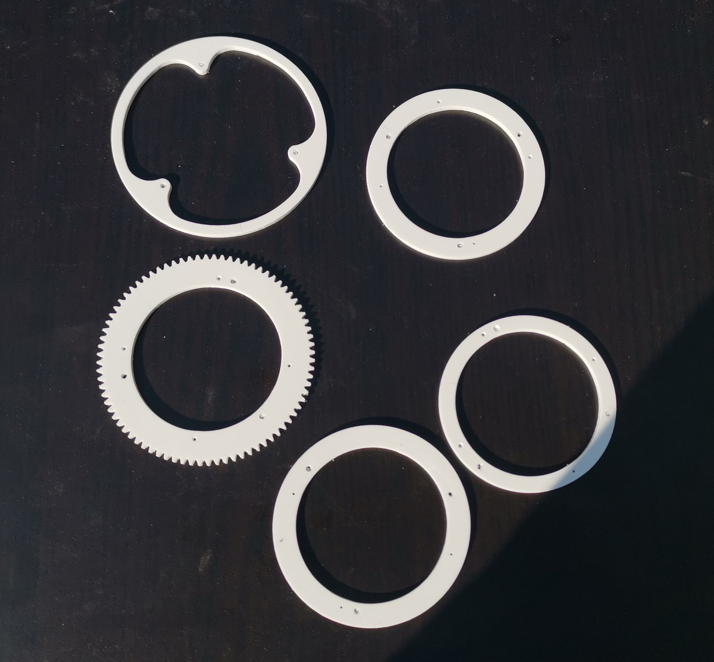

I milled in styrene all the parts for the turret rotation. The gear is a custom one to work with the HL turret rotation unit. The narrow chassis required a small custom gear.

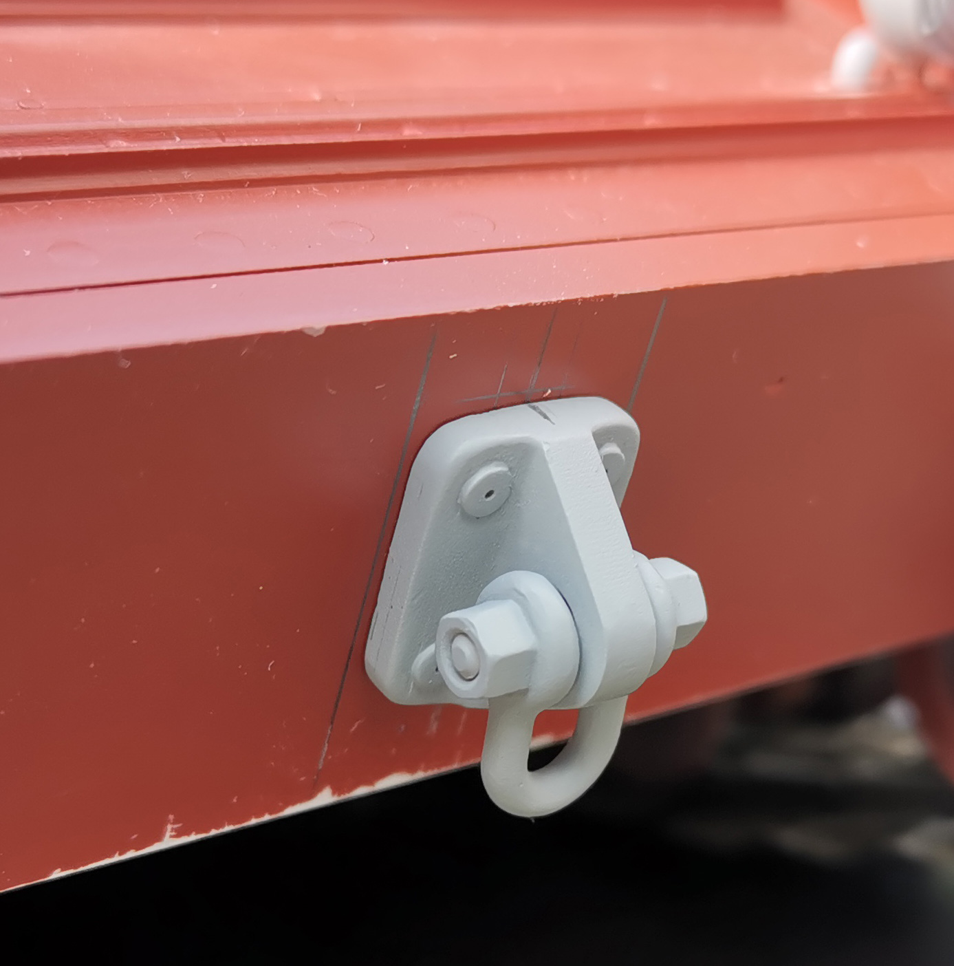

I turned on the lathe the small tow cable attachment tubes. I made a jig to drill a centered and perpendicular hole to all of them. Diameter of the hole is 0.8mm.

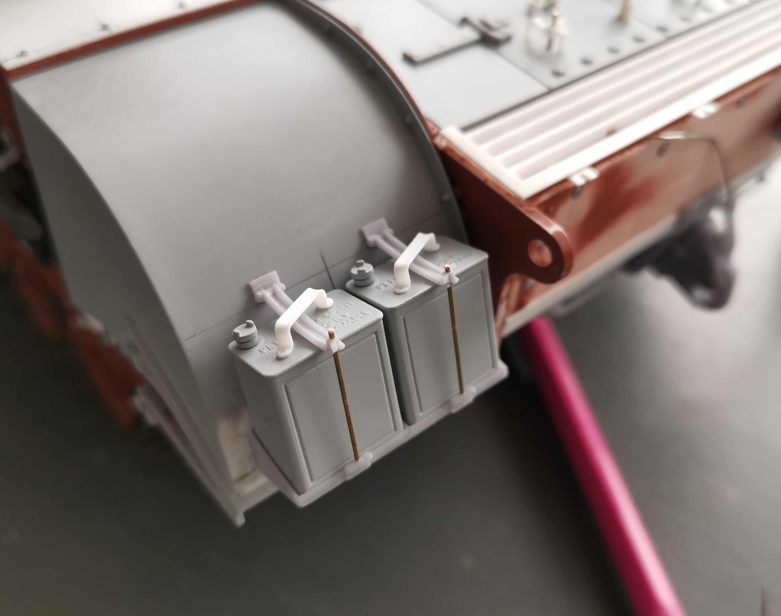

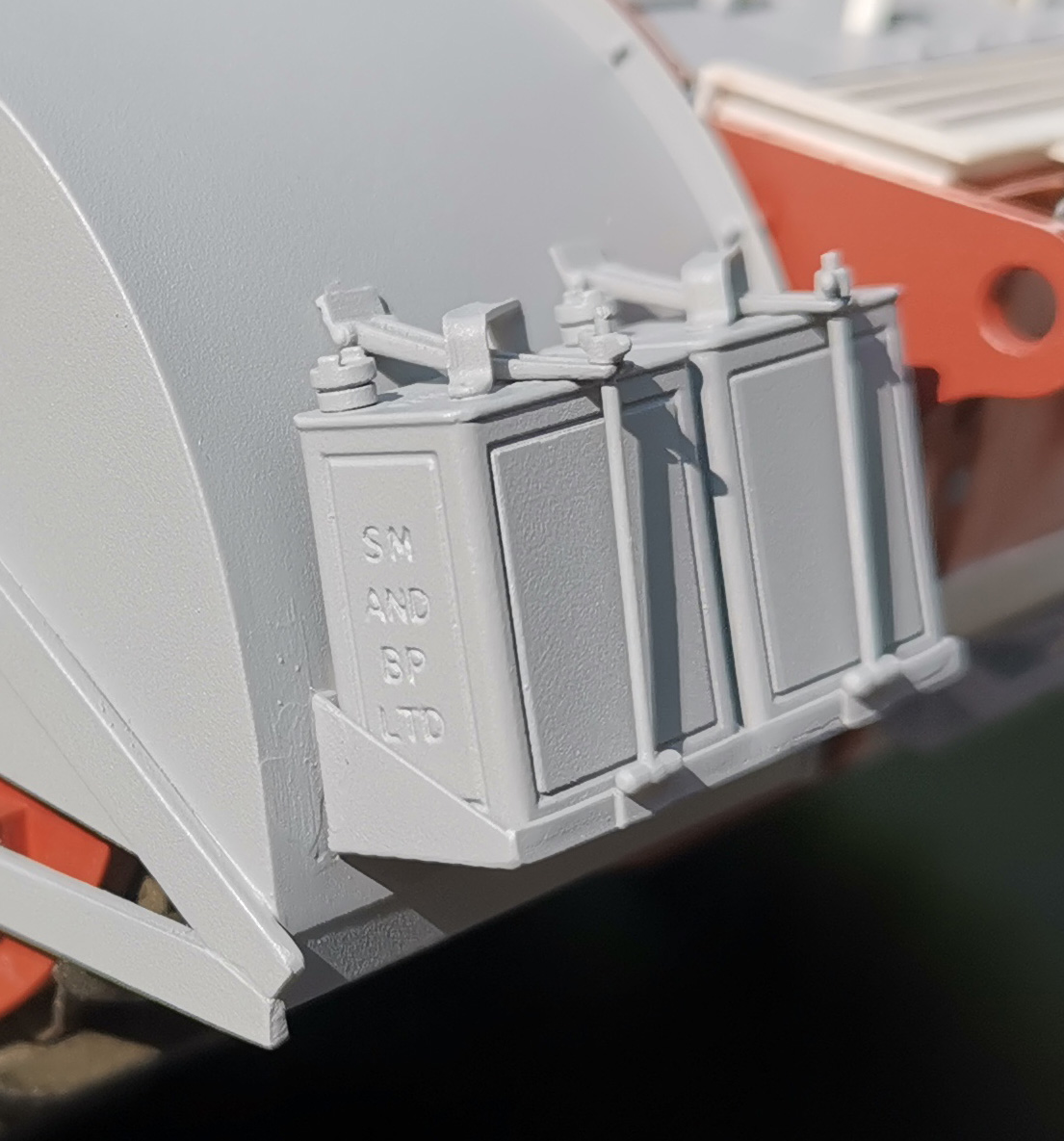

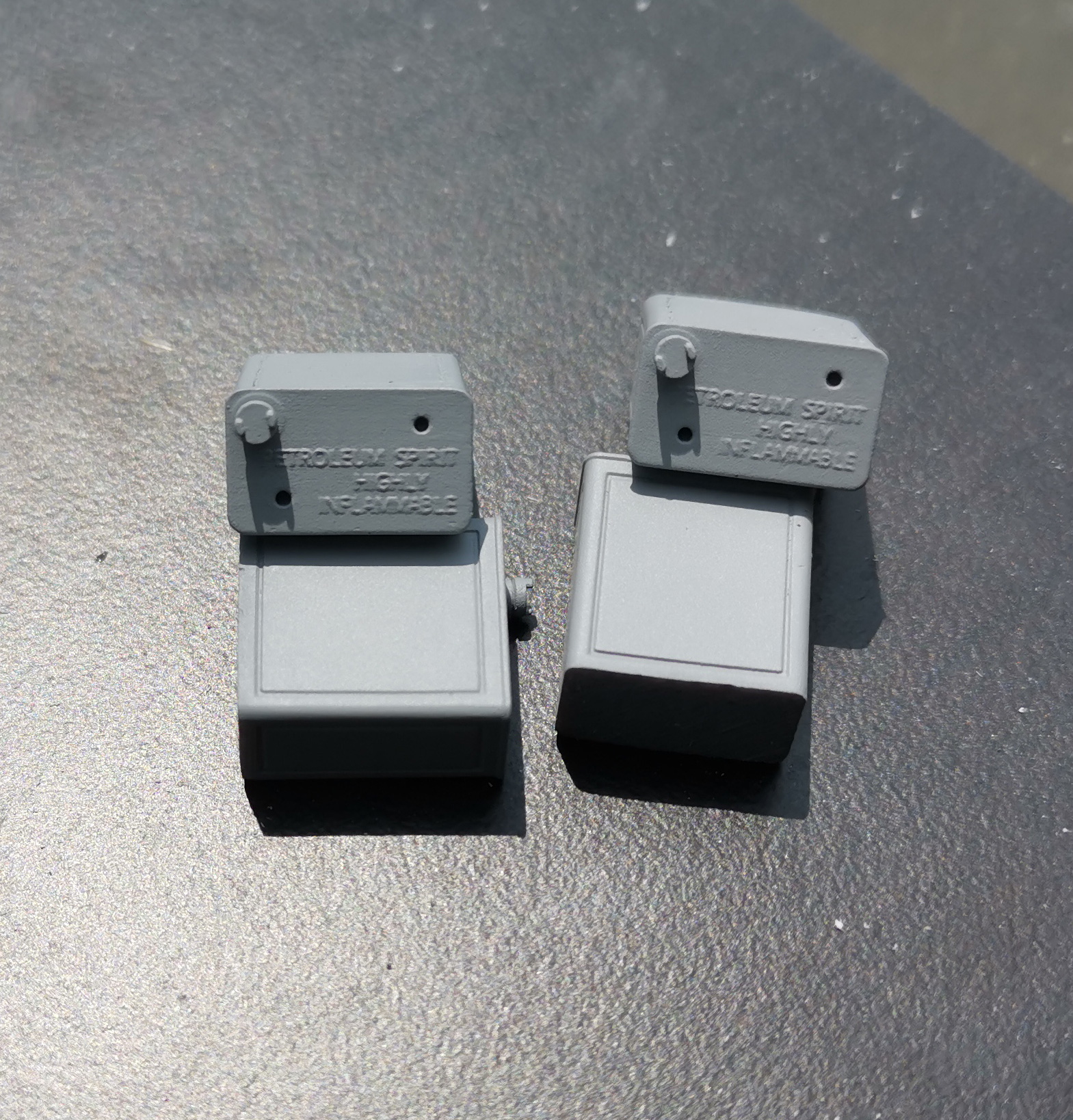

I did some research on the 2 gallons fuel cans that can be seen on the rear Churchill fenders. I 3D modeled them, 3D printed them, I molded and cast the handles in PU resin, they are 0.17 mm thick. The 3D printed were too thin to be removed from the supports, I was breaking them every time when removing supports or cleaning the surface...
They look rough because of the close up, they look good in person, actually you can't see the texture of the primer in person. I should stop taking so close pics :/ ;D

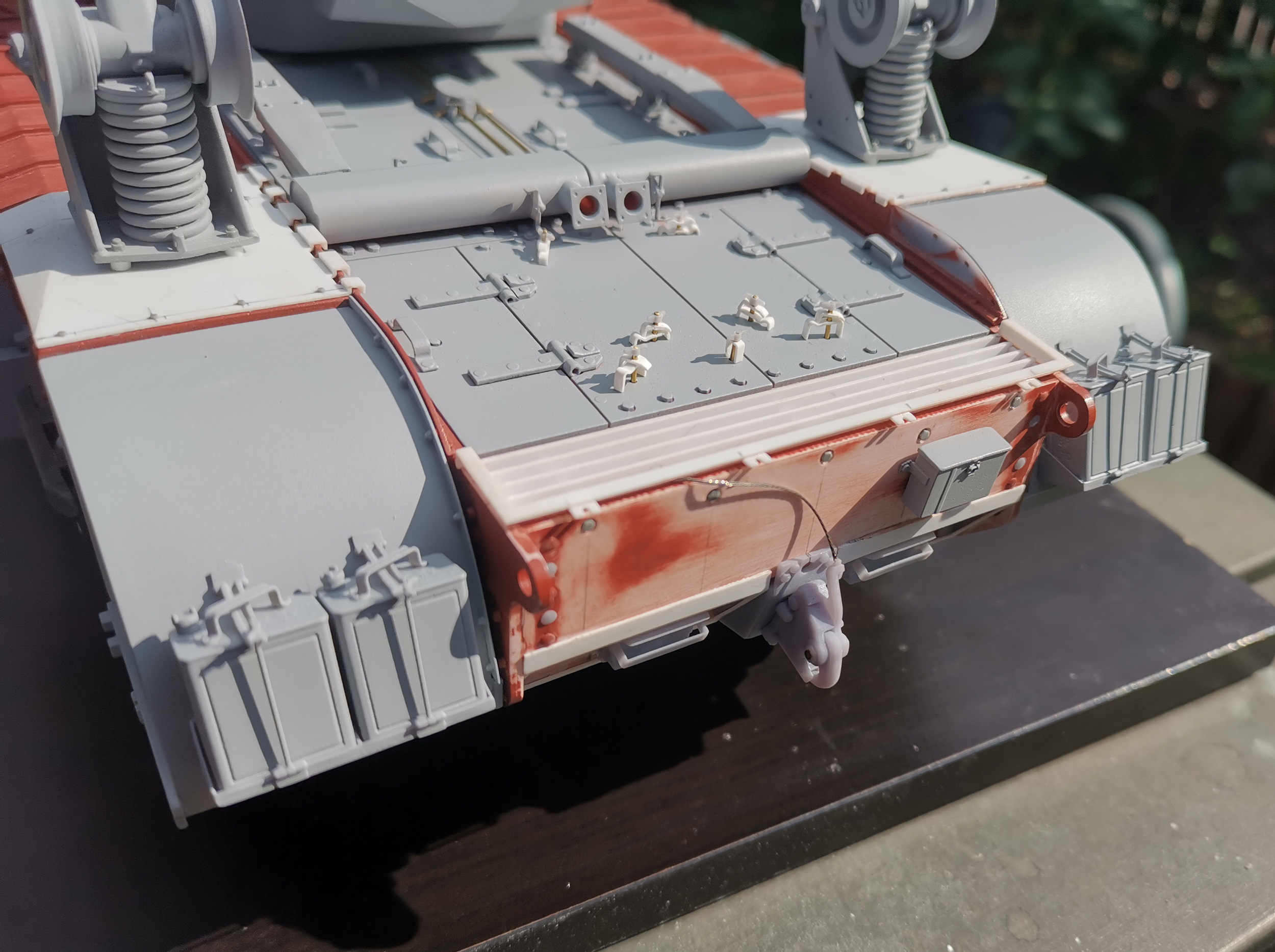

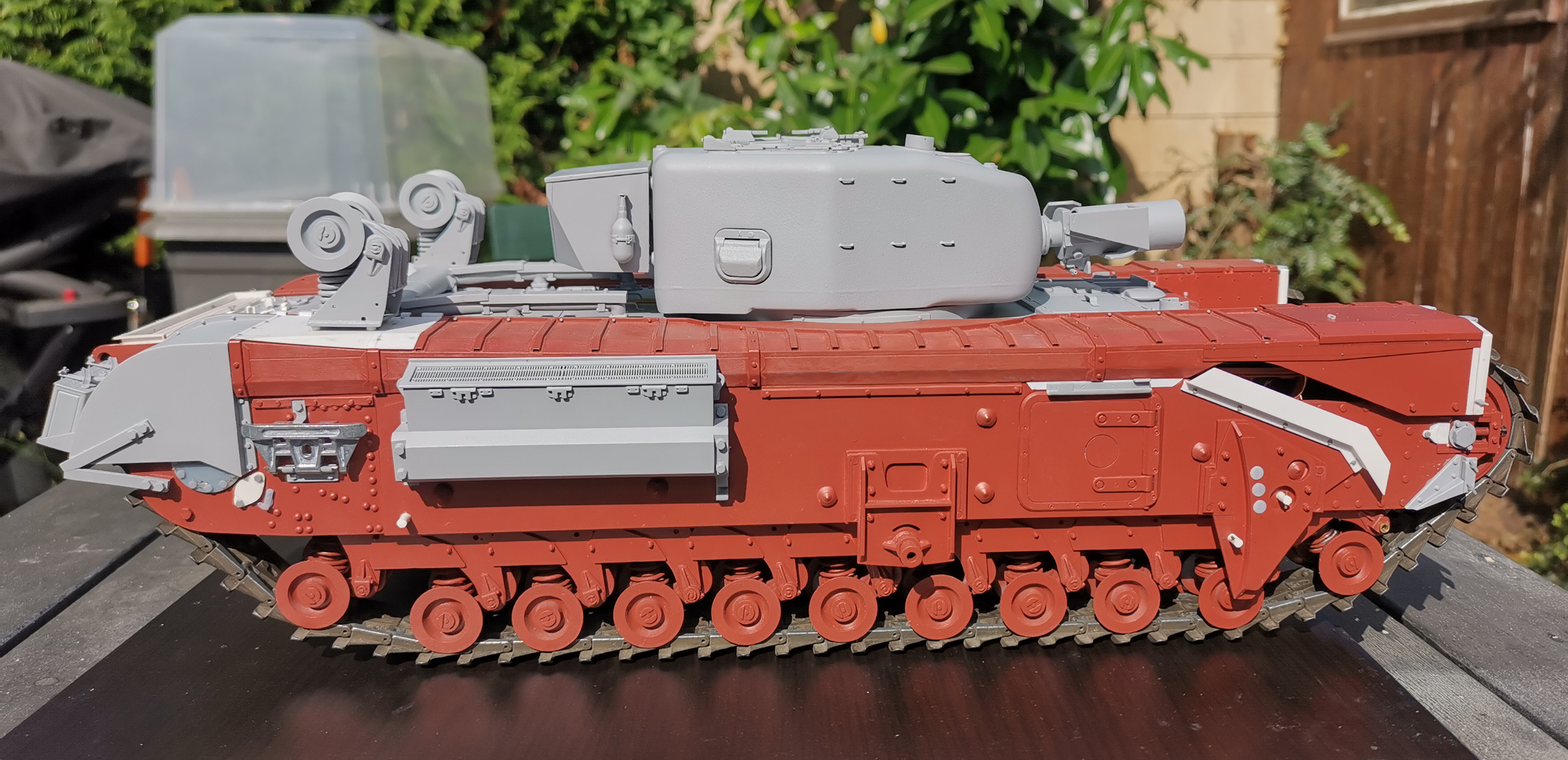

Overall view :
You can notice I mad ethe stowage attachment points on the turret side, they are made with a guitar string.
The new air filter can be seen, the spare boggies, the british extinguisher on the turret bin etc...

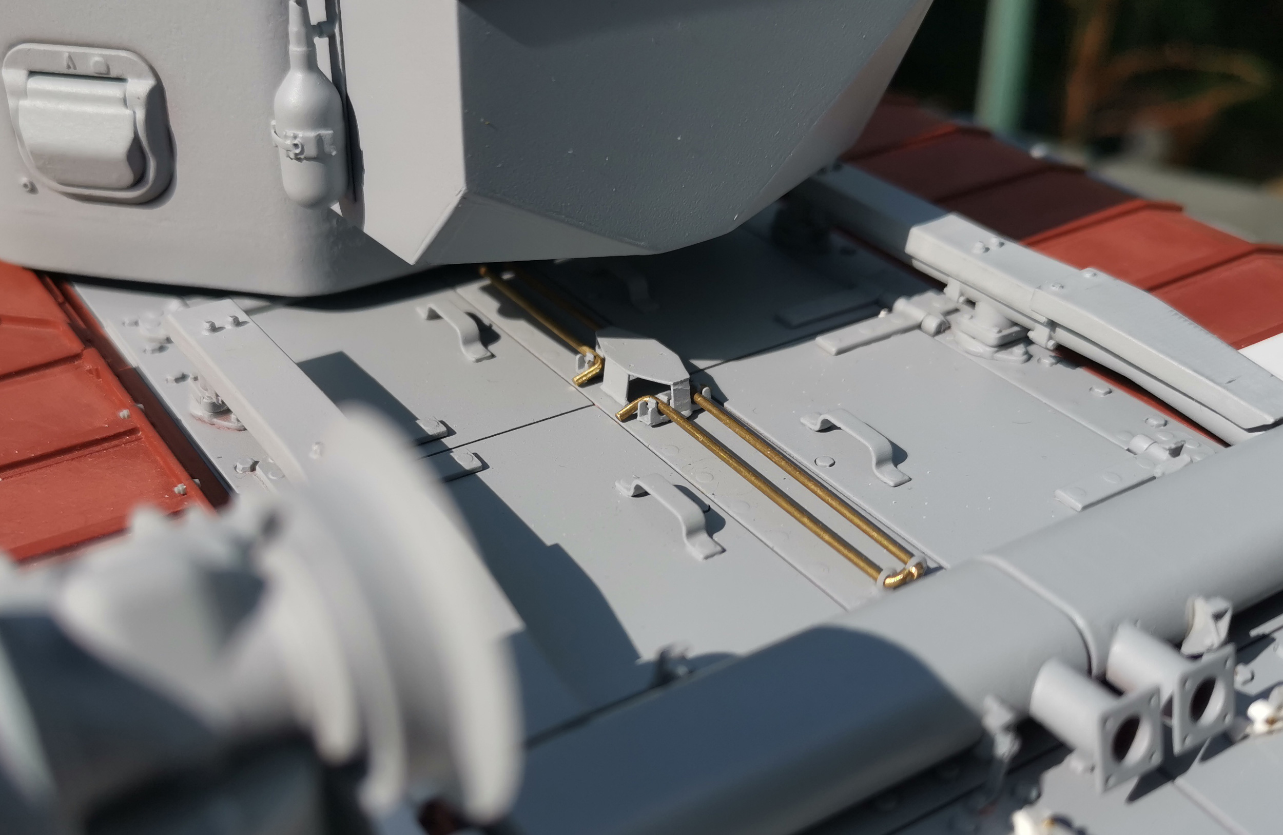

Rear deck, you can see the previously shown tool brackets, they're now in place :
2 gallons fuel cans :
Spare boggie :
3/4 rear view :
Methyl bromide fire extinguisher close-up, it was fun to 3D model !

More 2 gallons fuel cans :
