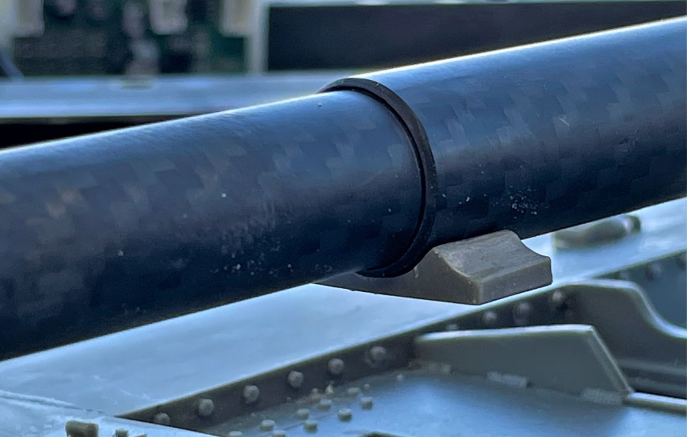

Ecam wrote: Love those graphite tubes, I would never have thought they could be cut that cleanly with a hand saw and sanded. I would have figured they would fray.
Yes, it needs a fine metal saw blade, its pretty fast and clean. I did a test first with a large tube cutter i had for metal tubes, oh what a mess it did.

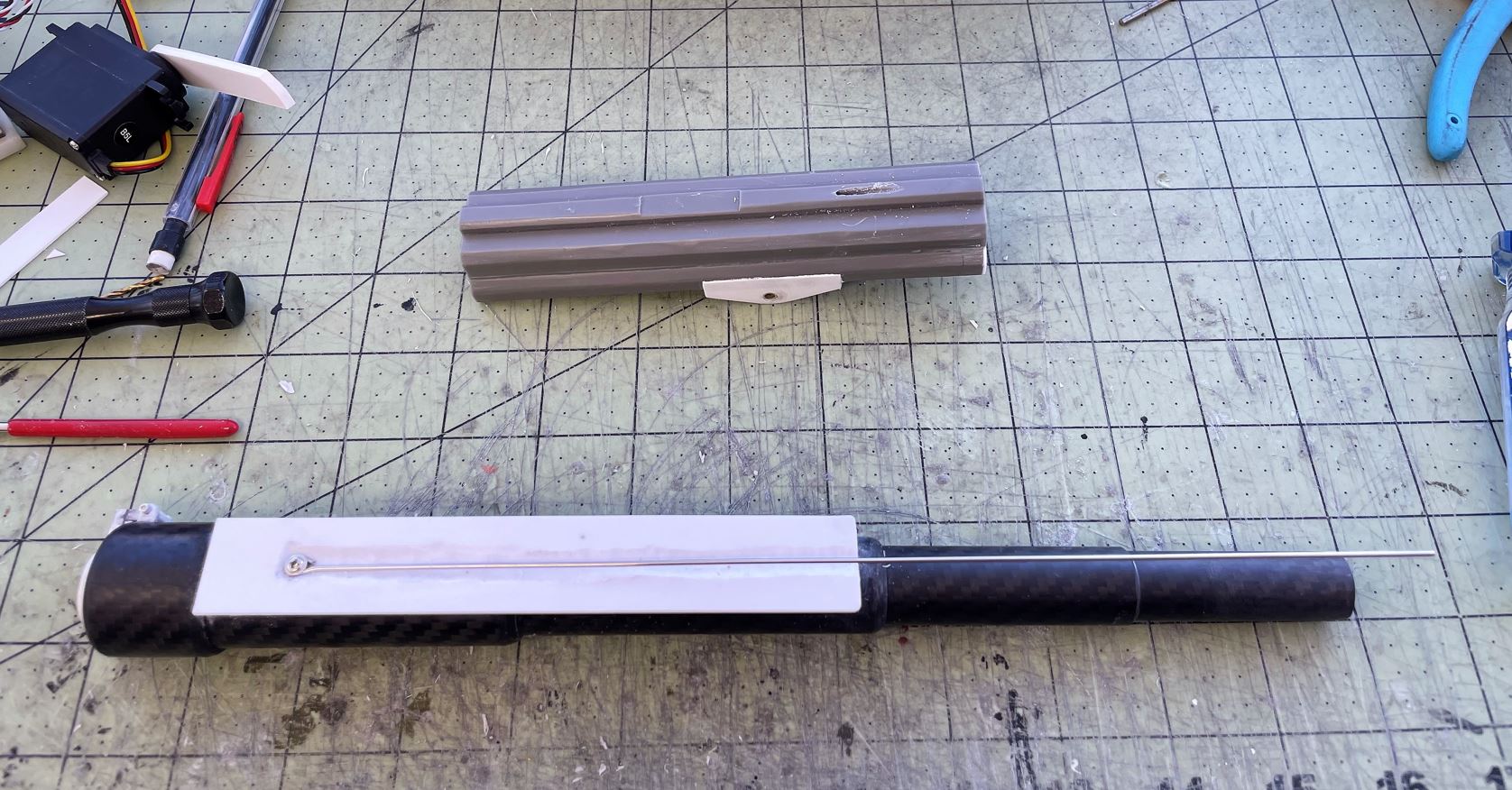

Now, the sliding breech... Here's the report and a short Youtube video of the howitzer in action at the end of the post.

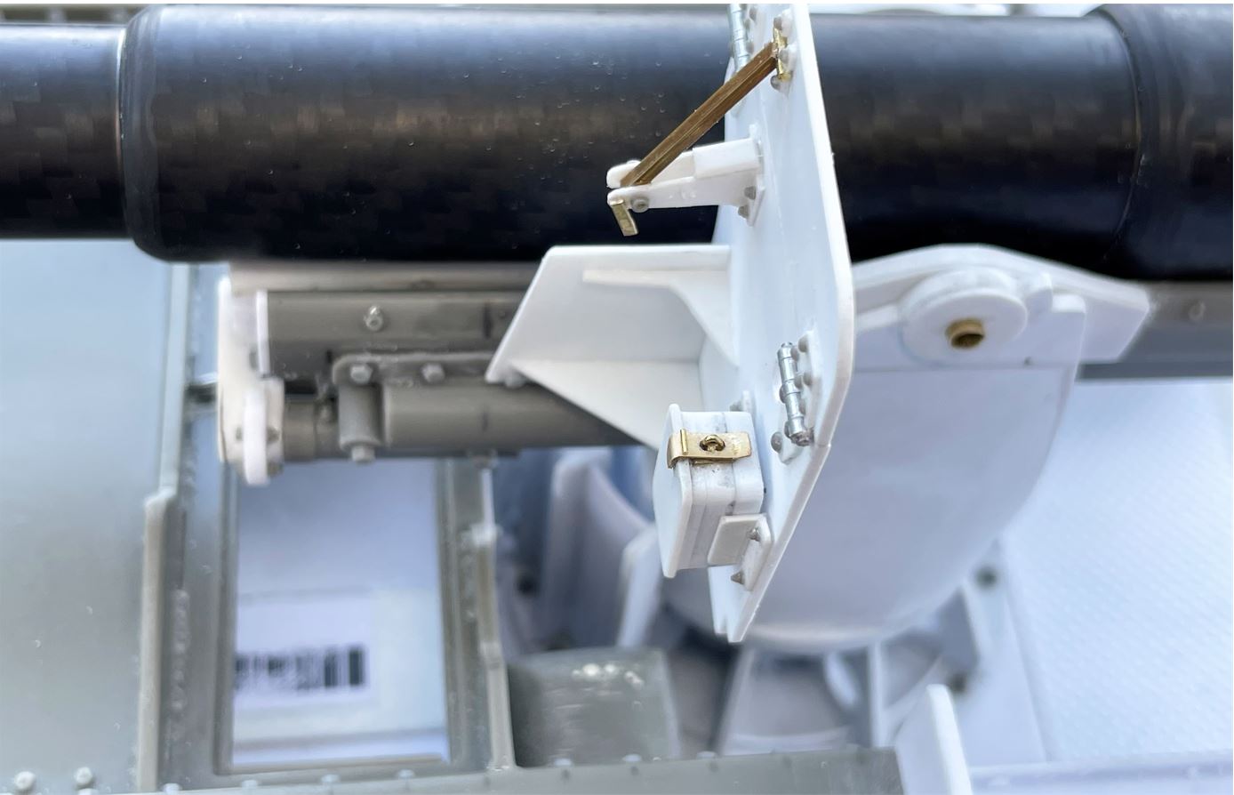

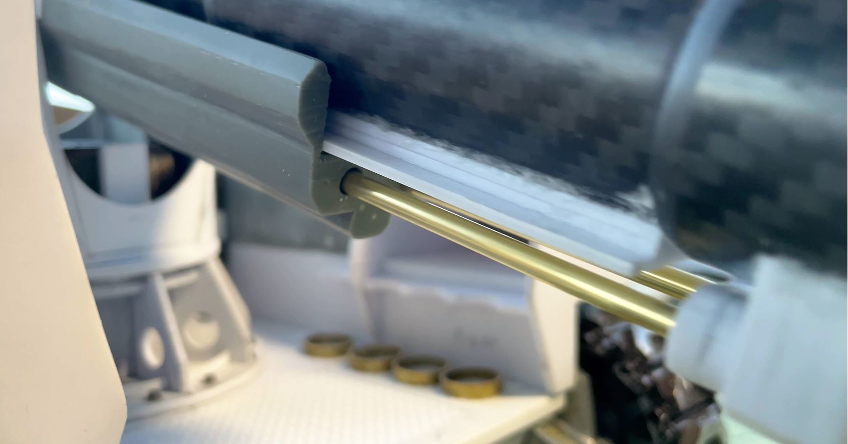

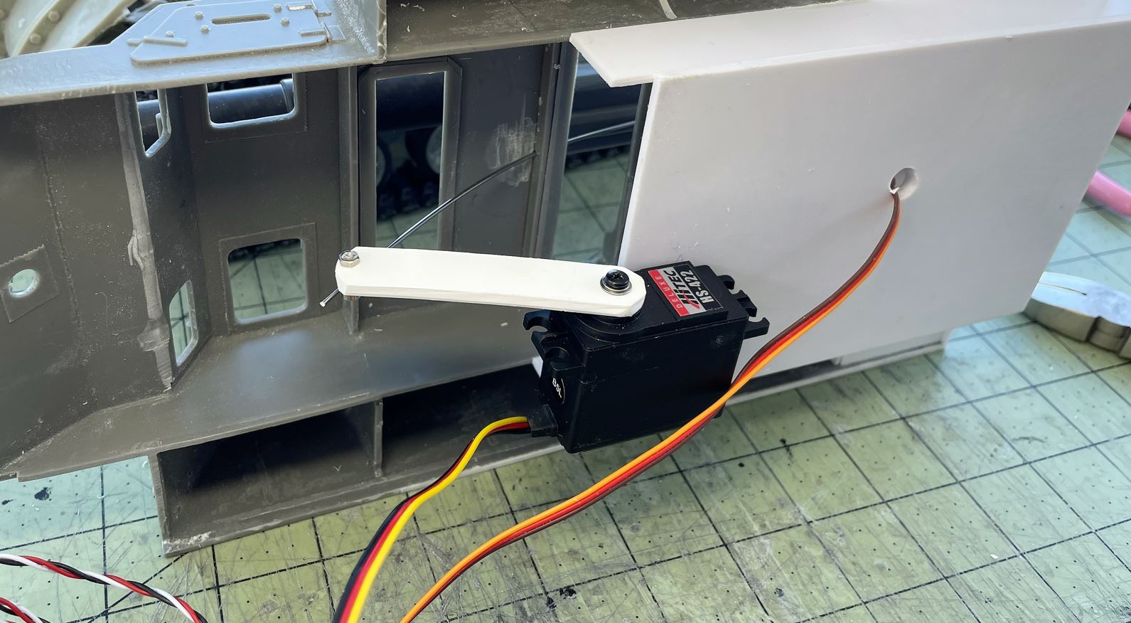

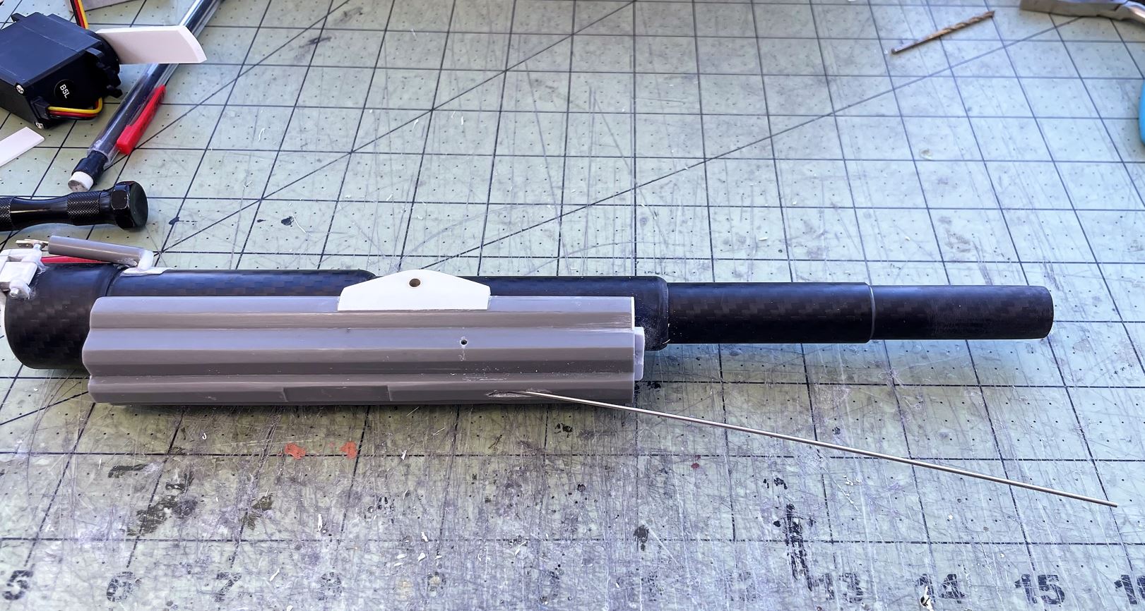

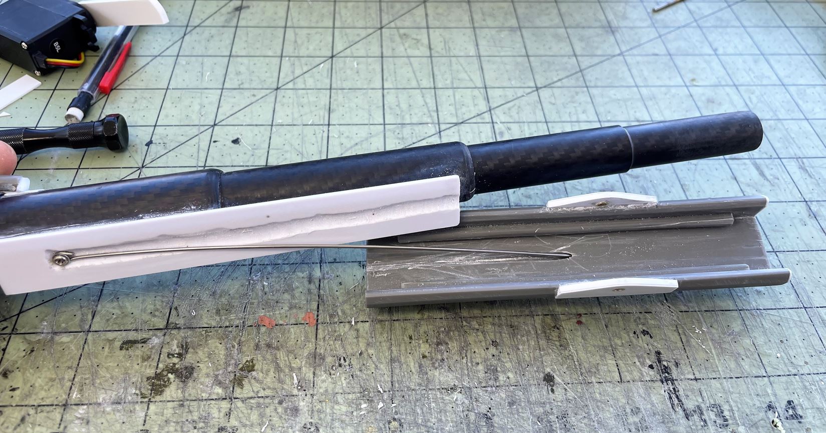

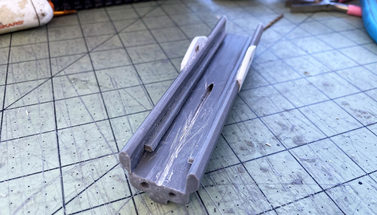

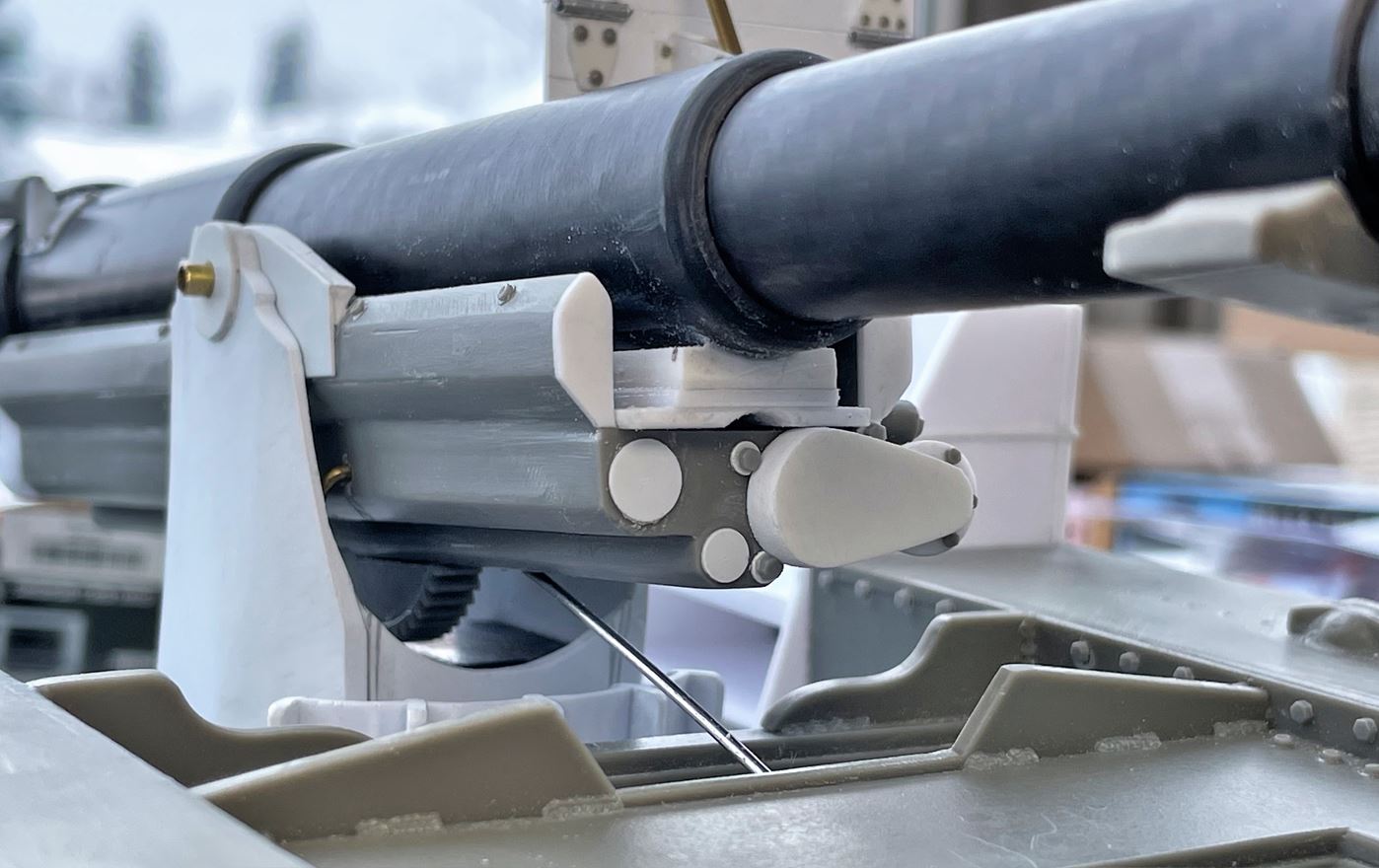

The push rod is installed under the barrel embedded in the sliding component.
1/16 RC US 155mm Gun Motor Carriage M12 - Build
After some calculations, i made the hole in the cradle right there at a specific angle, aligned with where the push rod is coming out of the chassis at the front.

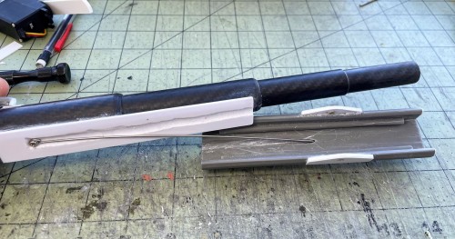

View of the mating process...
The howitzer was made to slide absolutely freely even with the rod attached to it. With some finetuning of the above steps, it is possible to remove almost all resistance.

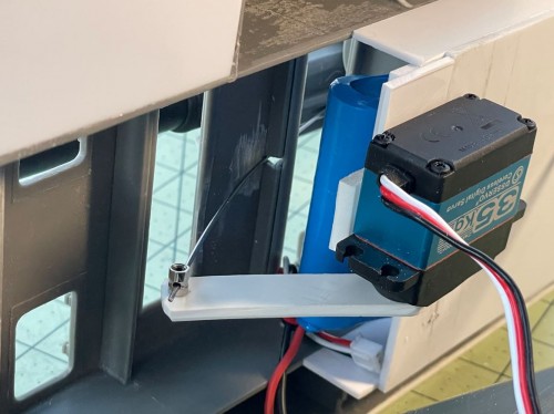

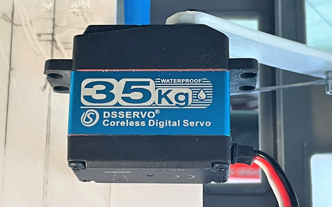

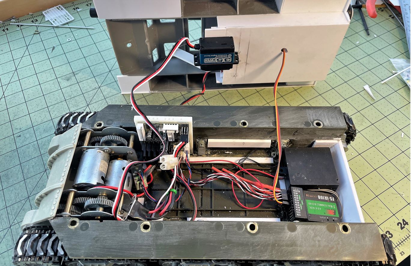

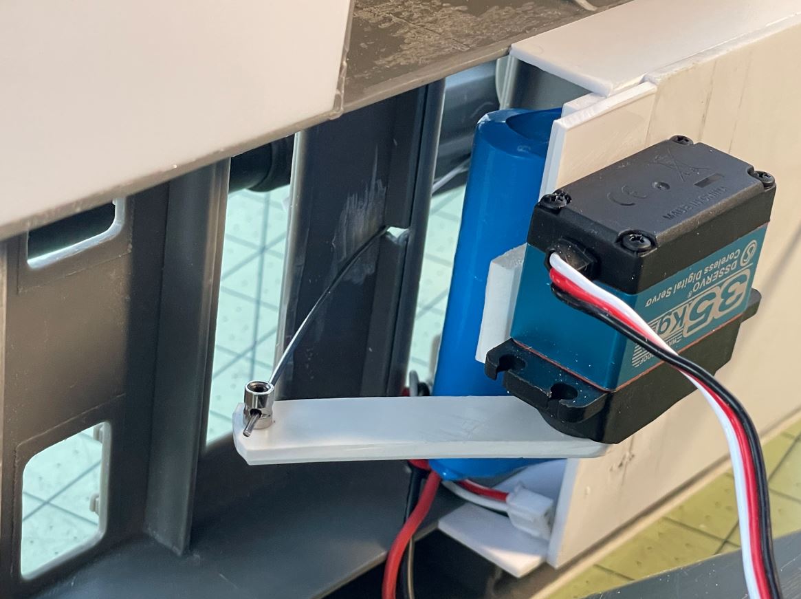

First, i tried a regular size 20kg servo. The recoil was working well but the tension of the push rod on the servo was giving it a hard time. I could see that the 20kg servo was at the limit, was having some issues pulling back the barrel in the last 5mm. I decided to go with a stronger servo.
I had to use my beautiful and expensive 35kg servo that i had on inventory. I was saving it for the upcoming 234/3 Stummel build. I will have to get another one for the Stummel steering. Notice the battery in the compartment above the recoil servo. Every free space need to be used. Good thing i was able to put the elevation servo inside the mount, i would have been difficult to make it fit under the deck.
View of the electronics showing how i was able to fit it. The wiring is still loose. Very simple;
- Heng Long gearbox
- Clark TK-22 on the side
- Speaker and receiver at the back
- 35kg recoil servo with scratch built arm with an adjustable push rod
- Battery above the recoil servo
- Elevation micro servo inside the gun mount and connected directly to an available channel on the receiver, assigned to vrB knob.

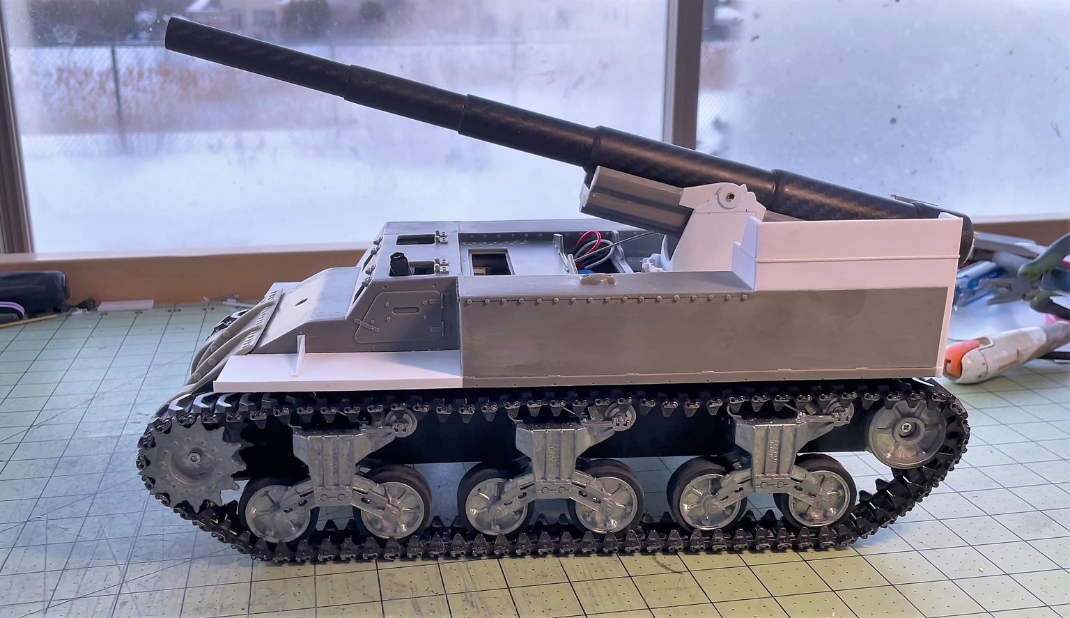

The model as it stands today. I gave it the fenders at the front, no mud guards yet. The upper hull fits in place, every mm counted.

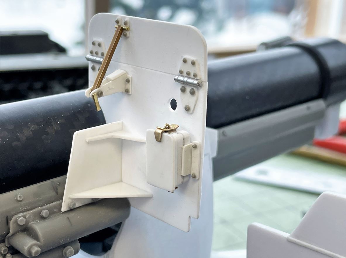

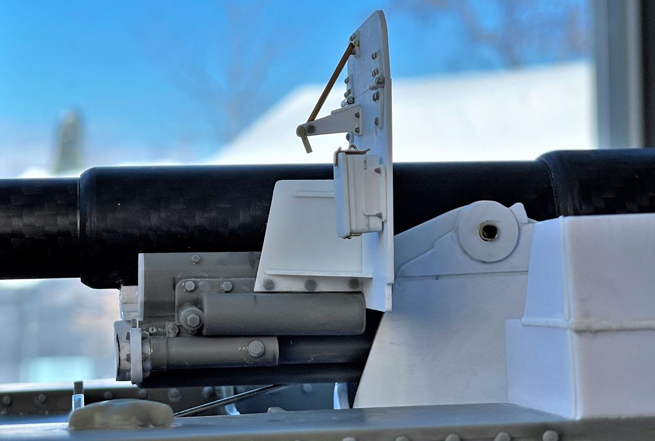

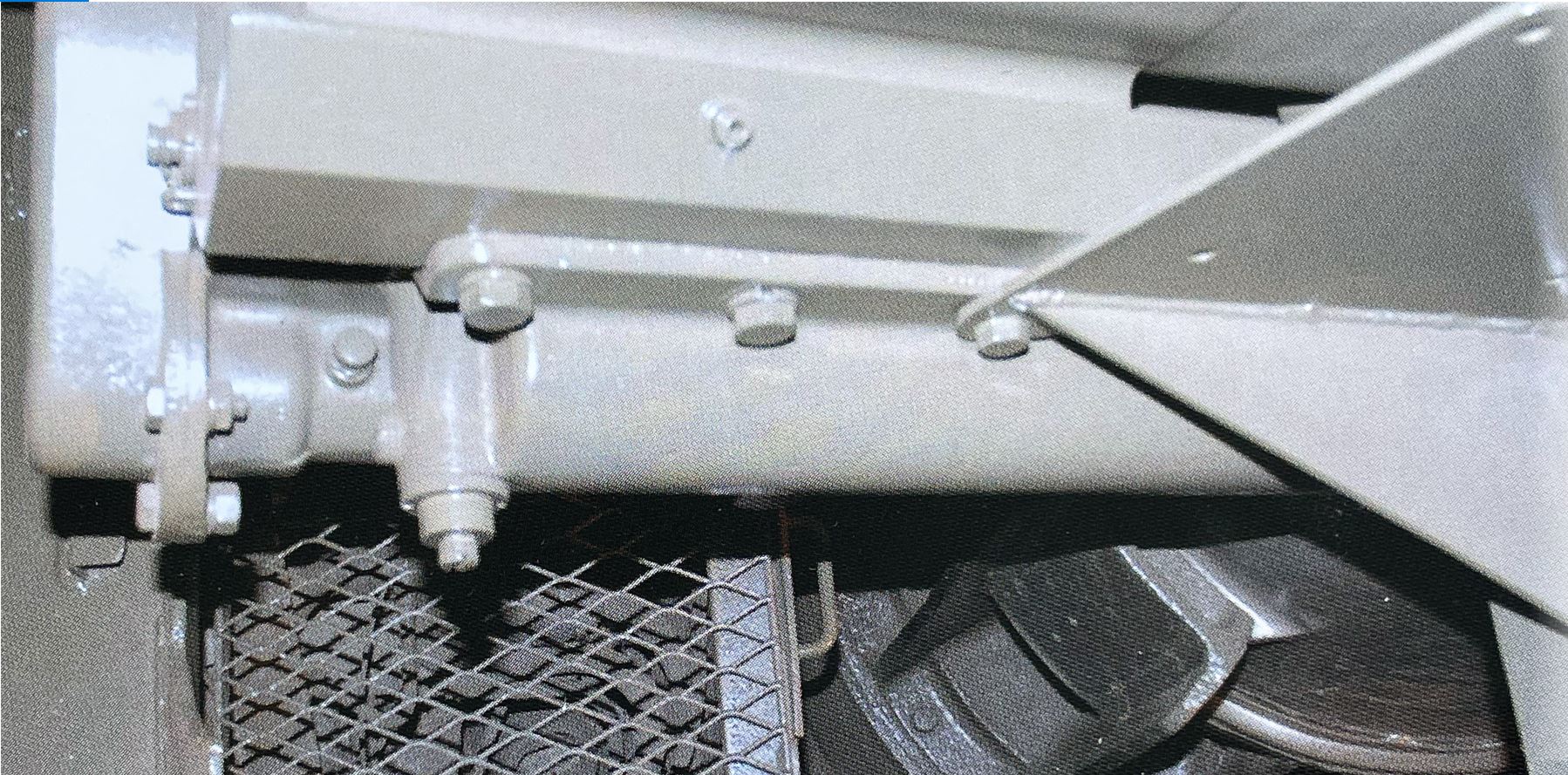

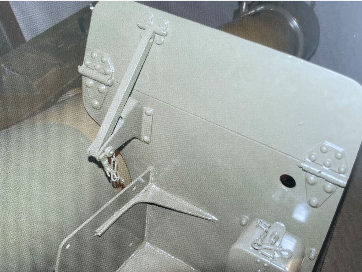

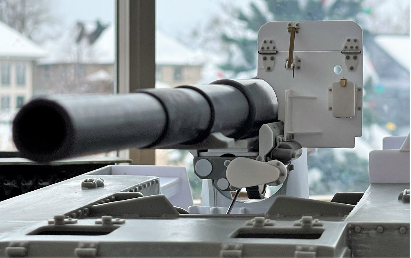

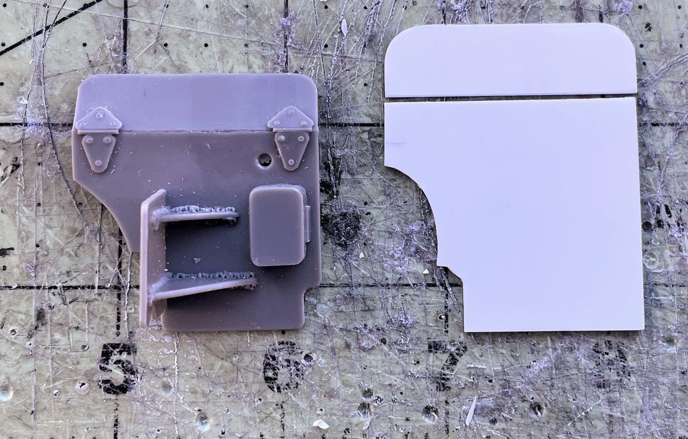

View of the 1/35 kit cradle and shield for the sighting instruments. Looking good but compared to reference pictures, some of the detailing is wrong or simplified. Everything needs to be double checked against reference pictures.
Frontal shield pictures are rare. The M12 book is essential for the details on this build and highly recommended.
View of the Vandra shield on the left, it is undersized and needed to be redone mainly because the curve around the main no longer fit the new barrel. All the Vandra details around the cradle needed to be removed and redone.
Overview of the new frontal area of the cradle and shield.

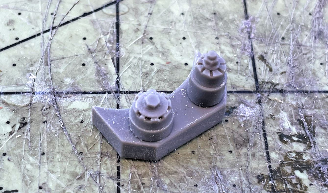

The Vandra piping on the lower left side of the cradle was reused, but they need to be shortened because they were too long. As seen earlier, Vandra did not position the cradle correctly on the gun mount, they centered it instead of positioning it more towards the rear. They had to compensate by adding extra length to the piping, which is no longer needed. Now, it is as per reference.

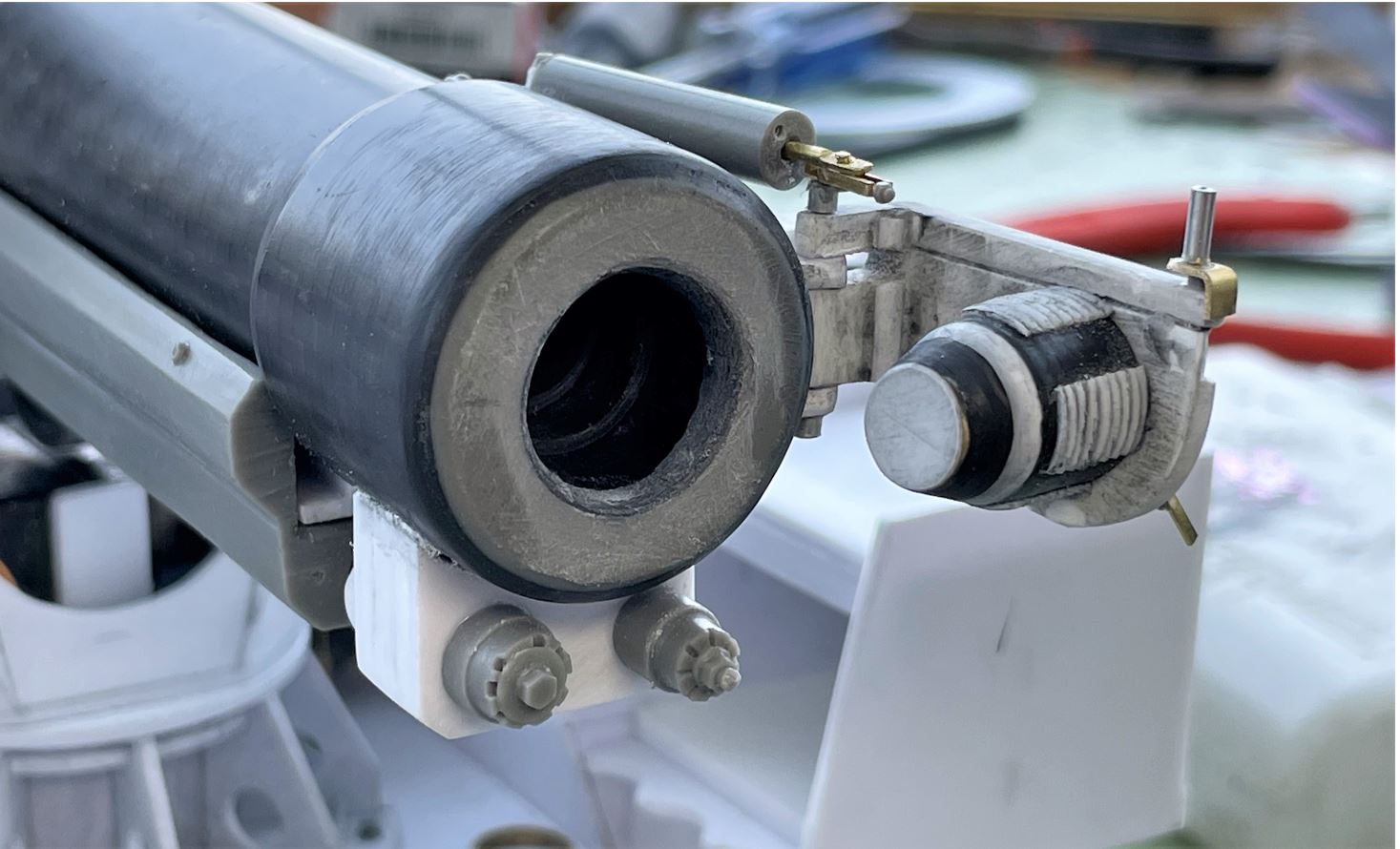

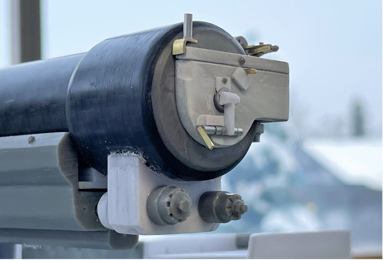

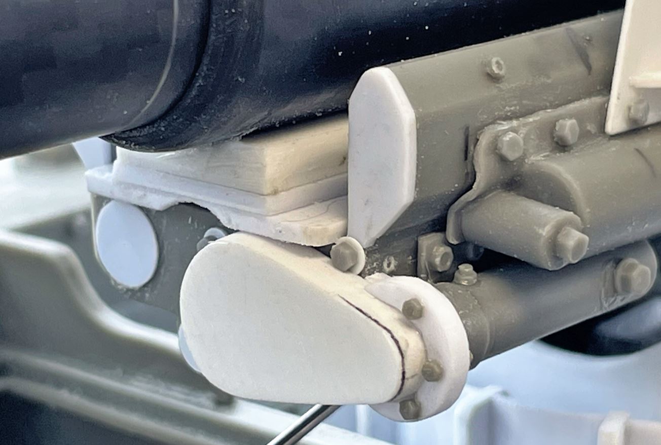

This Vandra resin part under the barrel at the front would normally enter the cradle when it recoils, but has been modified for accuracy and just for the look. It was positioned so that it does not enter the cradle for the sake of the RC recoil.

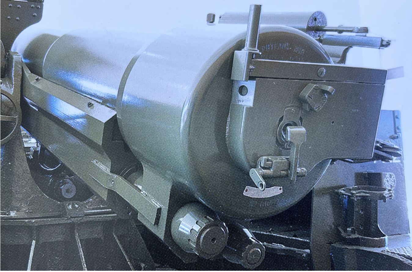

View from above, reference and model.

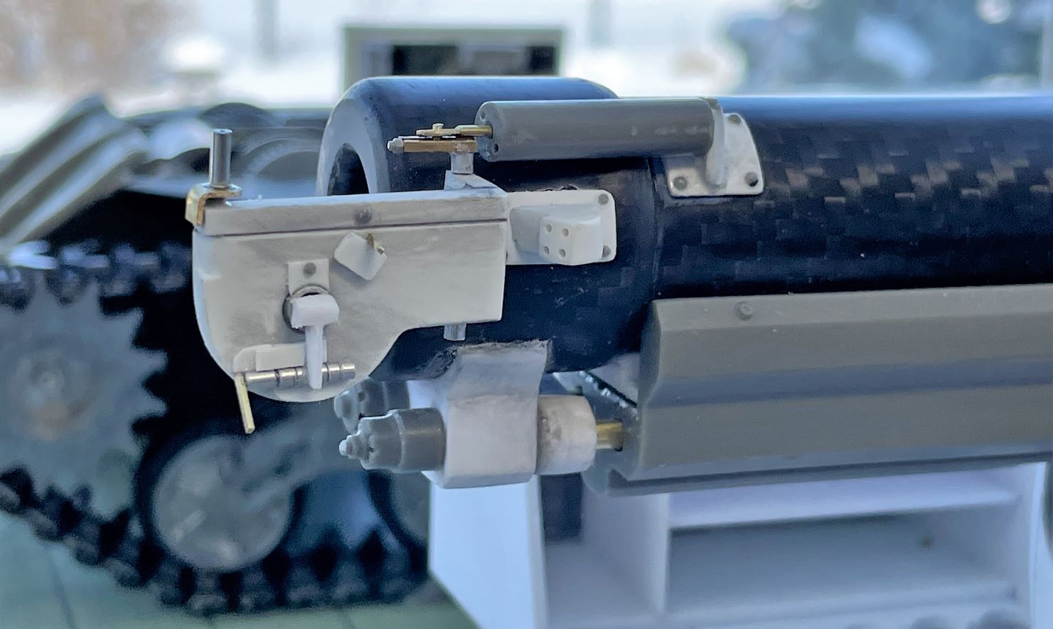

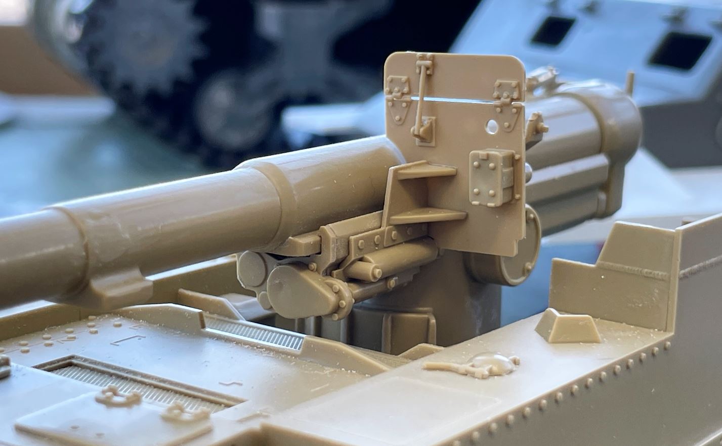

Of the breechblock, only the pins on the lower part were cut and reused. Not perfect but not too bad either. These are the kind of parts that are difficult to repro.
Reference picture of the breechblock.
The breechblock as it stands today. Not perfect but improved a lot compared to the Vandra kit.
Having a moving breechblock was important to me. It adds a lot of value to the model.
