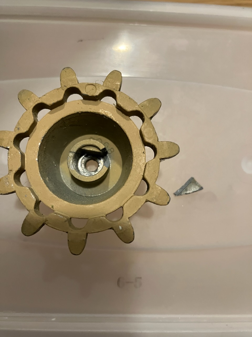

And its latest breakage.
A broke drive sprocket. Fix one problem and create another. Another broken bit has been temporarily placed back in place. This model is definitely a workshop Queen.

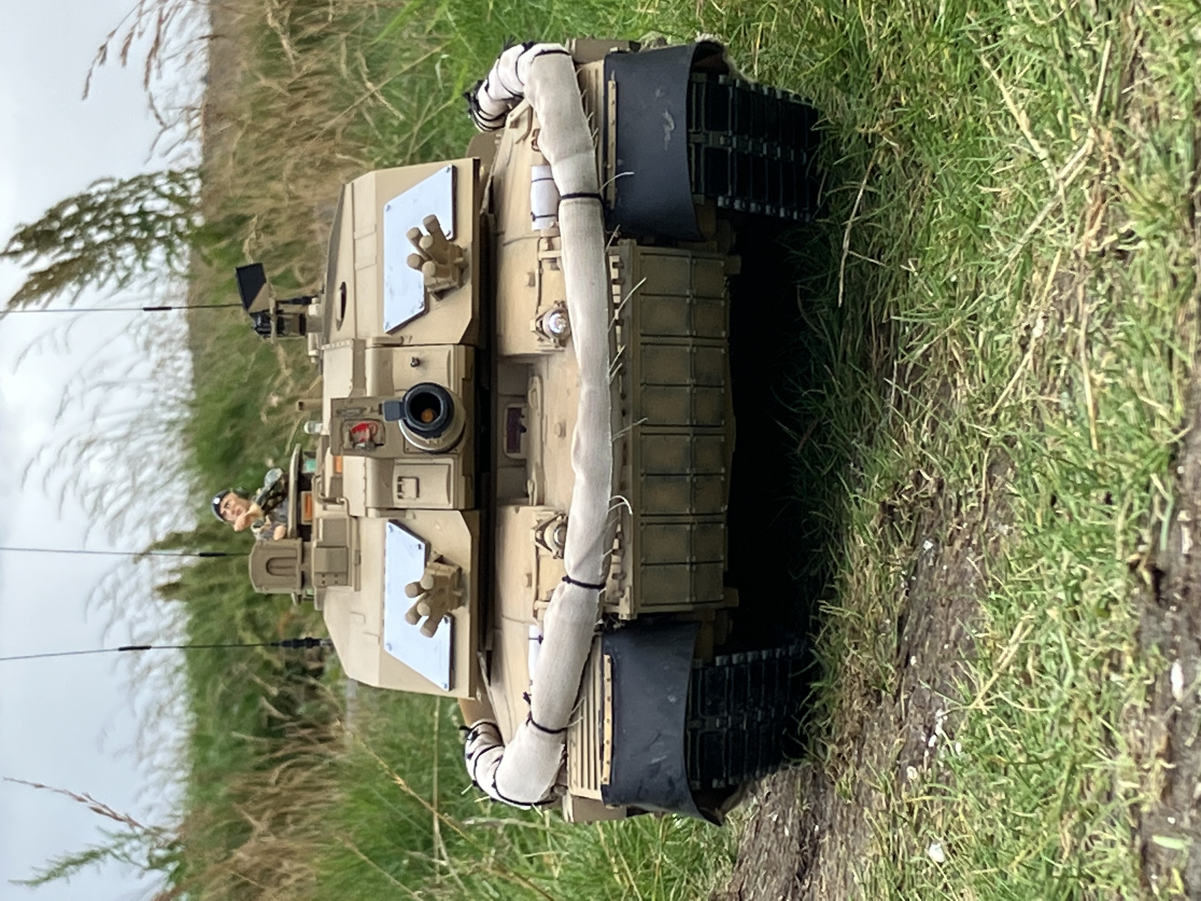

Took out the Challenger over some difficult terrain this afternoon. Only started throwing the left track after an hour. It was run over sand, grass, mud, stones, and water. Now in for track tightening. I may have a faulty connection somewhere, possibly the main switch, as it exhibited a tendency to turn off in some instances on starting up.
No breakages, just some tightening of the tracks, as the left side was starting to come off towards the end of the run.

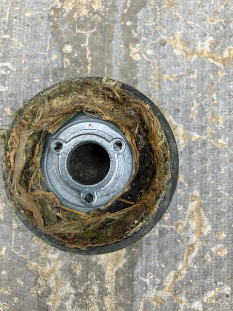

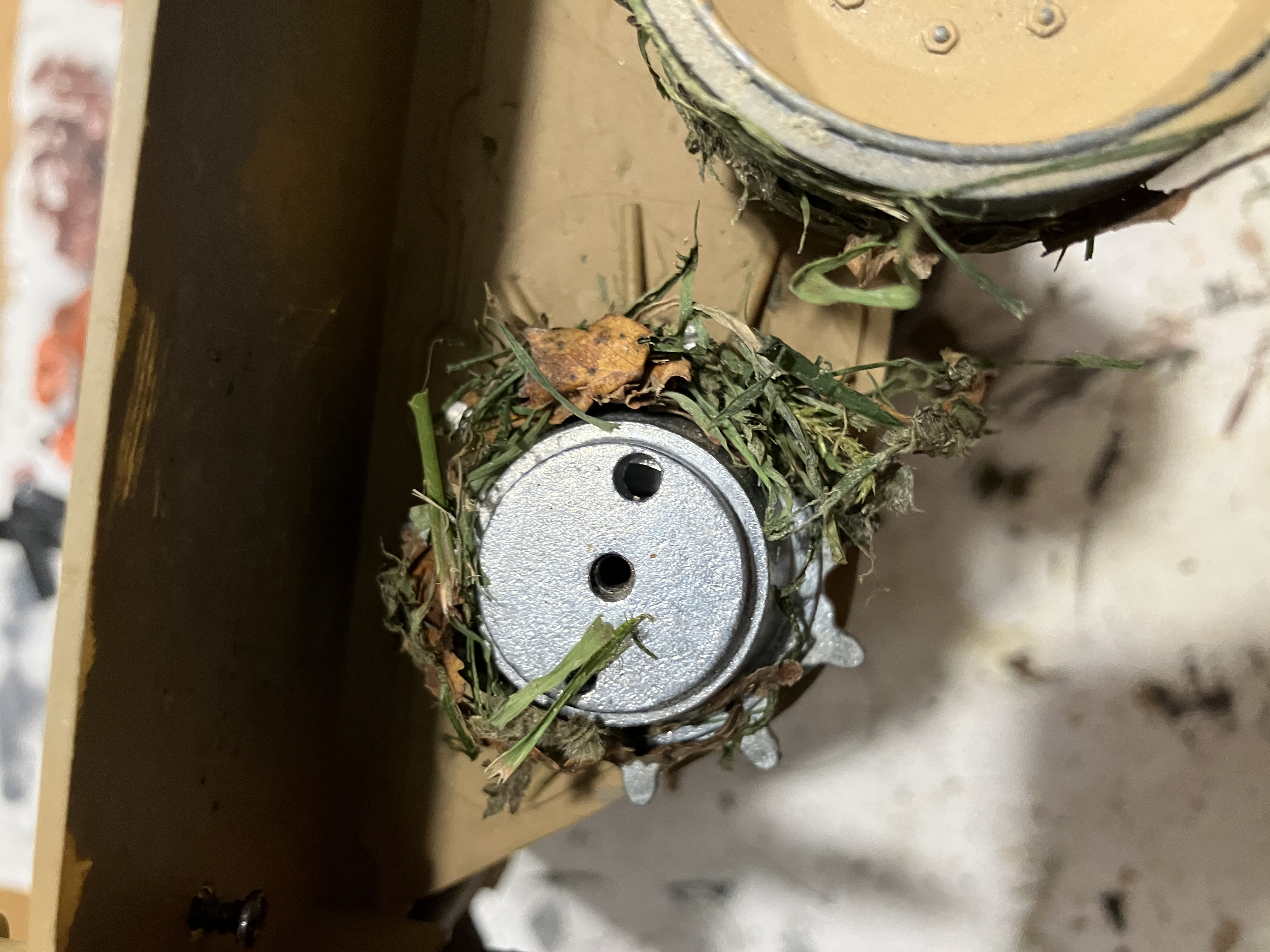

The ongoing saga continues. After breaking the other rear drive sprocket, a pair of Abrams were fitted temporarily but tracks coming off was still a major problem. A complete strip down was required. That’s what I did. I found, half the lawn, and sand, compressed into the wheels and sprockets.
Neat little grass donut.

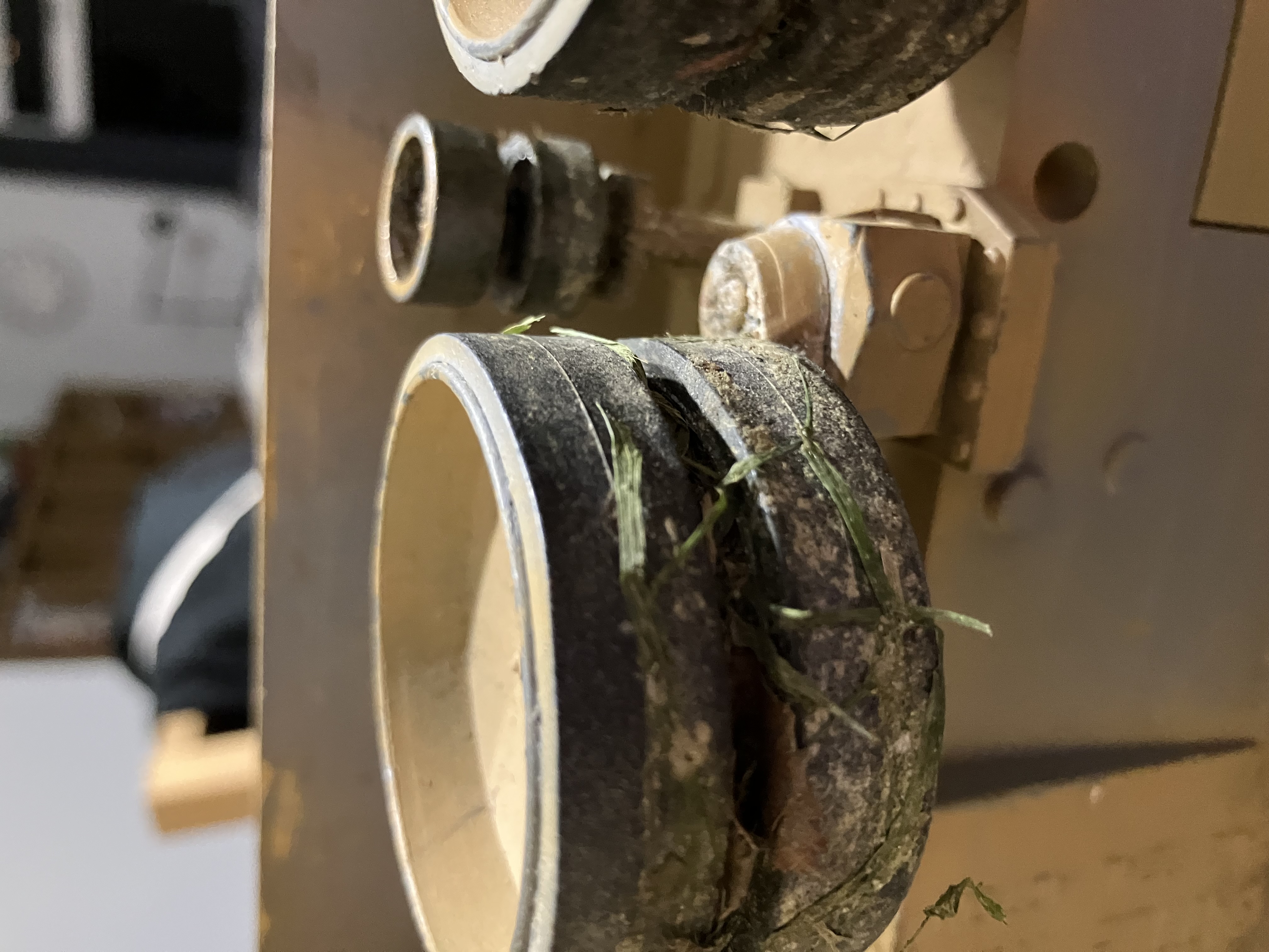

Also found were seized track adjusters and bearings.
This required some serious removal etiquette using junior hacksaws and drill to remove the bolt head.
Pondering over a glass of red wine. I decided to replace as much as I could with 4mm stainless steel bolts. So every thing was drilled out to 4mm.

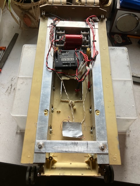

A frame was made to stop the chassis from flexing, and new bearing were installed, where required, and new rear sprockets fitted. These were filled with resin to stop a repeat of the failure of the previous sprockets.
New red motors were also installed, and the track reinstated. Previously the tracks were tight, but now they would not go on. Links two had been removed from each track to get the correct tension. Now I needed to add two links back in. A first I thought the sprockets might be bigger, they certainly looked it. But comparing them with old one the were the same size.
I can only assume that the chassis was flexing, before the tension was being put on the idlers, and by adding the frame it has stopped this.
A quick test in the garden last night seems to show an improvement and our rather steep piece of long grass was take at a fair lick, where as before it would struggle to get up. It also turned without shedding the track. It still managed to build up a fair amount of grass , which it seems to rip out, so 20 minutes was spent cleaning it. Hopefully I will get to test it properly over the weekend.
