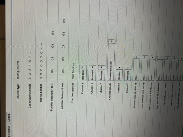

Orizzontal left stick work ( cannon up/down)
- 23AFF4E3-51BC-40CC-86A8-C46F881B695F.jpeg (85.61 KiB) Viewed 2698 times

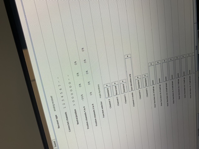

Re: Help connecting elmod pro on torro tank...
Vertical left stick up (it work)
- 5D46EC78-4329-4F22-8E85-401F76DEEEF4.jpeg (72.53 KiB) Viewed 2697 times

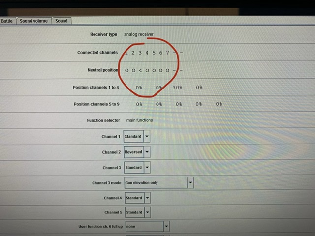

Vertical right stick work
- 1A5DE688-3CCC-4144-80C6-43DC8EA368DF.jpeg (69.82 KiB) Viewed 2696 times

For me it is complicated to give assistence with that radio because I dont owe it, neither one running Open TX. I use another open source software caller erskytx which is about 90% the same.Andreabert wrote:Rad
please let me know what i have to do and i will do.
i think i plugged the board correctly follow instuctions...
but enlgish is not my Language.... so.. hard for me to understood all
no problem to use the left stick to drive the tank......the problem is to connect all correctly and have to stick working....
But I guess first of all you have to go to radio setup and select the mode you want to have, is what our french friend told you.
Then create a new model, and in model setup/mixer select the channel and the stick that controlls that channel. As I said is really easy and fast, once you know how to do it.
Then you need to program the rest of the channels in the switches and potentiometers for the rest of the functions.
If after a while you cannot make it work and you are desperated, you can send it to me so I can make it for you in one day. I am in Austria so shipping is affordable and fast.

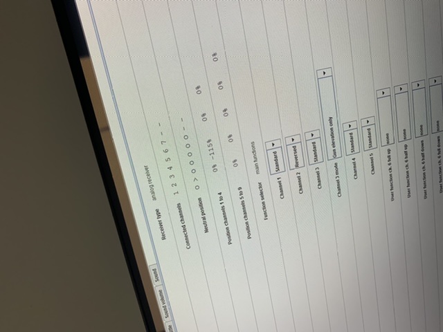

Orizzontal right stick NOting work
- B4997062-BA67-43D0-8CEA-3DE77D2B4836.jpeg (88.43 KiB) Viewed 2693 times
That is wrong. Black and wire goes to VCC.all the channels are wrong. You started connecting them in the channel 2.Andreabert wrote:Here the receiver
I disconnected the red/black to take a pic
And the white wire is upside down.
Time to sleep for me.
Rad_Schuhart wrote:That is wrong. Black and wire goes to VCC.all the channels are wrong. You started connecting them in the channel 2.Andreabert wrote:Here the receiver
ohhh shit... im a fucking jerk........
now it work...........shit...
thanks a lot....
