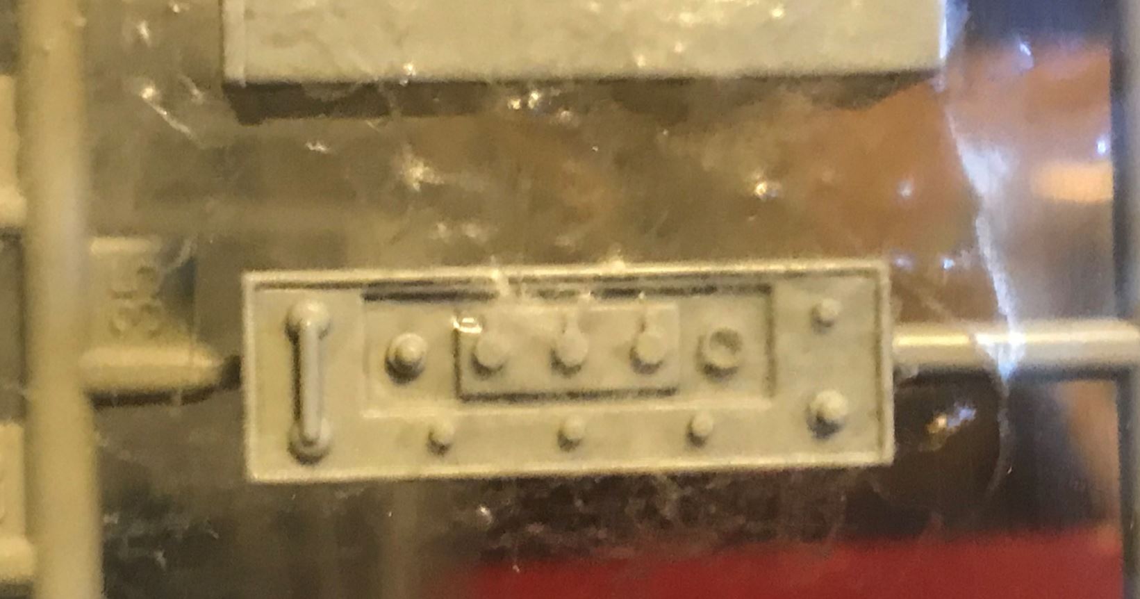

Same fake radio and platform as WSN is provided without any resemblance to the SCR-528.
1/16 RC M16 Half Track MGMC Meat Chopper Korea build

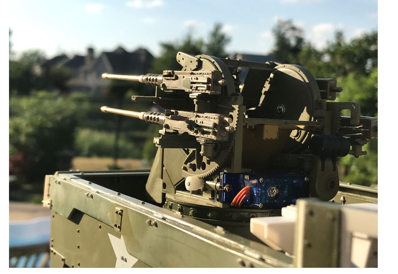

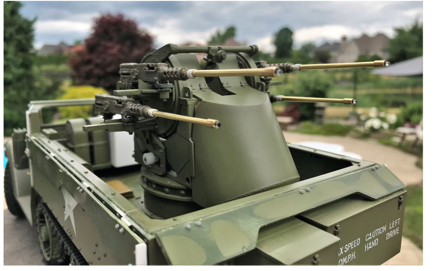

The following posts are for an area I was anxious to see if it would work; the machine guns and the M45 quad gun mount. There is a video attached at the end of the third post for the gun mount in action with the 35RCTANK ACU unit gun flash and sound.
First, following the building of the prototype last week, I needed to complete three other M2 machine guns exactly like it. An assembly chain with a standardize process is required, with checking and testing at every step to avoid mistakes.
The barrels are made.
The Tamiya M2 plastic sleeves and barrels attachment are used, just need to drill the hole centrally... It easier to do this on a Tamiya plastic barrel than an Aber solid metal barrel. Although the Aber brass sleeve would have really looked good, it would have been more work and a lot more expensive.
The body of the M2 is made to accept the new metal barrel, going inside by about 10mm, but also need to make way for the 1.5mm fiber optic and the 3mm yellow LED.
This is the time to feel like a gun maker.
The fiber optic and LED are connected and thoroughly tested before enclosing them in the body of each M2.
Cut away overview of the 1/16 scale M2 machine gun armed with its own embedded 3mm yellow LED.
There are some finer and fragile details left to install on the M2s (better keep these for the end or they will be destroyed during the build) but the core are ready to installation on the M45 quad gun mount.
The interior of both gun elevation wheels are cleaned of all features to make way for the electrical connections, resistor, wires and to facilitate movement. As all the individual exterior M2 mount points were factory glued on my model, there are no purposes in screws holding them as well. Even if they had been loose, I would have glued them and do the same.
The top machine gun can have its wires going strait into the gun mount elevation wheel interior. However, the lower machine gun is more distanced from the elevation wheel so connections to the LED need to be prepared and extended before placing and gluing the machine gun. Extensive trial and error process is used to align all machine guns at that point so that they all shoot horizontally and vertically in the same direction. It can easily be achieve by sanding the back anchor point and glue the machine gun to it once perfection is achieved, keeping the front point loose until the end. It makes a big difference in the look and feel of the model. The old WSN machine guns were all misaligned and shooting in all directions, not funny and it made it look like a cheap toy, not a $200 RC model.
Amazon has many cheap LED kits of 3mm and 5mm LEDs of all color coming with 200 ohm resistors. These need to be connected to the longer + wire of the LED. Without resistors, the LEDs will burn. Resistors have no polarity and can be installed either way.
Continuing on following post.

I gave each M2 machine gun LEDs its own resistor, then connected + and - wires to a single wire on each side, and then to a single wire going down into the hull.
Both elevation wheels are installed on the M45 mount. All machine guns are pointing in the same direction and looking smart.
After removal of all the WSN electronic, I was left with plastic components to reused for a simpler gun mount rotation system, in my case, one that works. Modifications are required to let wires loose inside the mount base so that a minimum rotation of 180 degrees on both sides can be achieved.
I found rotation works better when the wires that are loose inside this "rotation drum" are glued to the plastic when they enter and when after they exit the drum. It took about 30 minutes of fine tuning to get it to work. Guys that want to achieve 360 rotation and more must reuse the WSN 360 connector wheel and try to make it work. If I had to redo things, I would at least try to salvage it instead of throwing it in the garbage like I did in a moment of frustration over having bought something that did not work.
The M45 gun mount is assembled for installation and testing, minus the ammo boxes and any details that are not required at this time.
Rotation unit is inserted.
The continuous servo used for elevation is connected to independent channel 6 assigned to the VRa knob on the emitter. I found that it allows for better control than left stick. The servo makes its own elevation sound... Rotation unit and gun flash wires are connector to the 35RCTANK ACU unit.
The basic M45 gun mount minus its accessories is installed and ready for testing.

Next step is to finish the gun mount.
Regards, Louis

Hi, from the pictures I have seen of the M16 in wartime, the crew kept the rear side armor free of stowage, surely so that the flaps could be lowered and be ready for action.
The crew were putting the stowage attached to the rear bins at the back, on top of the armored windshield, on the front sides and on the winch platform.
I recently purchased a Tamiya 1/16 Sherman restauration project and the previous owner had included in the package two Ultimate Soldier 1/18 M16 front side tarps. They are a perfect fit for the 1/16 model.
Regards, Louis
