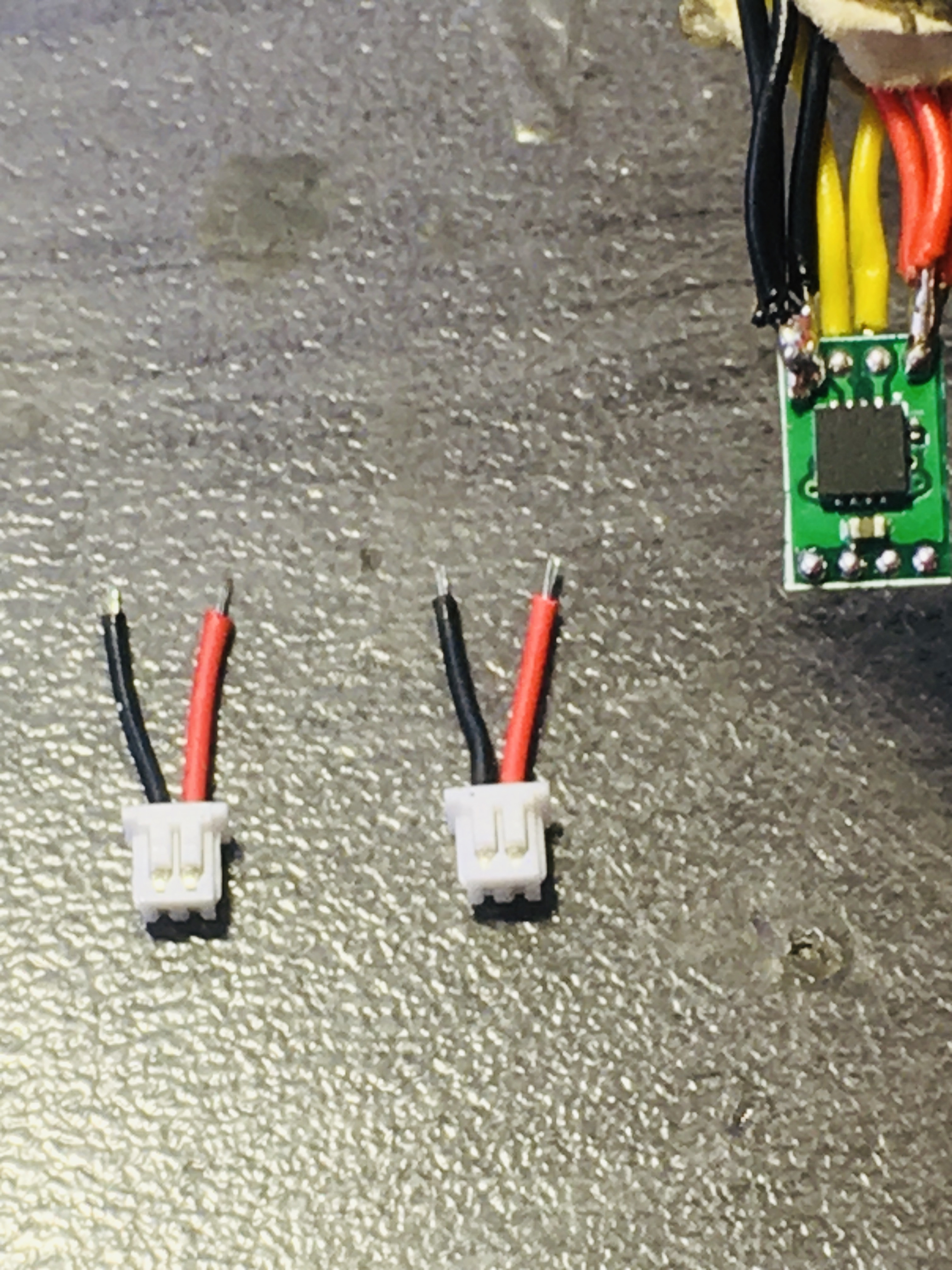

Ecam wrote: Wed Dec 20, 2023 3:25 pm I know those are micro connectors, but they look absolutely huge compared to the ESC! Fascinating work on such a miniscule scale. I struggle with room on 16th from time to time.
It was a challenge to solder the wires to the ESC. The pads are very close together. The soldering kit I use has changeable tips and for this job I used the smallest tip and a steady hand. The wires on the connectors shown here are high quality and keep their shape after being moulded to a final position through careful and slow positioning. That is the last step. This being two circuit boards wired together allows positioning the CB's independently to fit the limited space available. Best soldering practices are required for all connections. Also the connections are "shrink wrapped" with a high dielectric strength insulation material for electrical isolation using a special technique I developed in my electronics lab.
After Testing the Panther, I serious problem with the Tank was discovered. The rubber tracks have aged and are slipping in forward as the sprockets don't have "drive teeth" and are smooth so the aged track has lost enough tension for the tracks to slip. The panther is now in standby until I can figure out how to resolve that problem. Meanwhile, I have a Leopard II of the same scale that I have switched to for this thread topic. Even though it is a little longer length than the panther, It is narrower and has less radio bay room to work with, so it will be tight! :O
input\output of the new Ultra micro dual ESC.

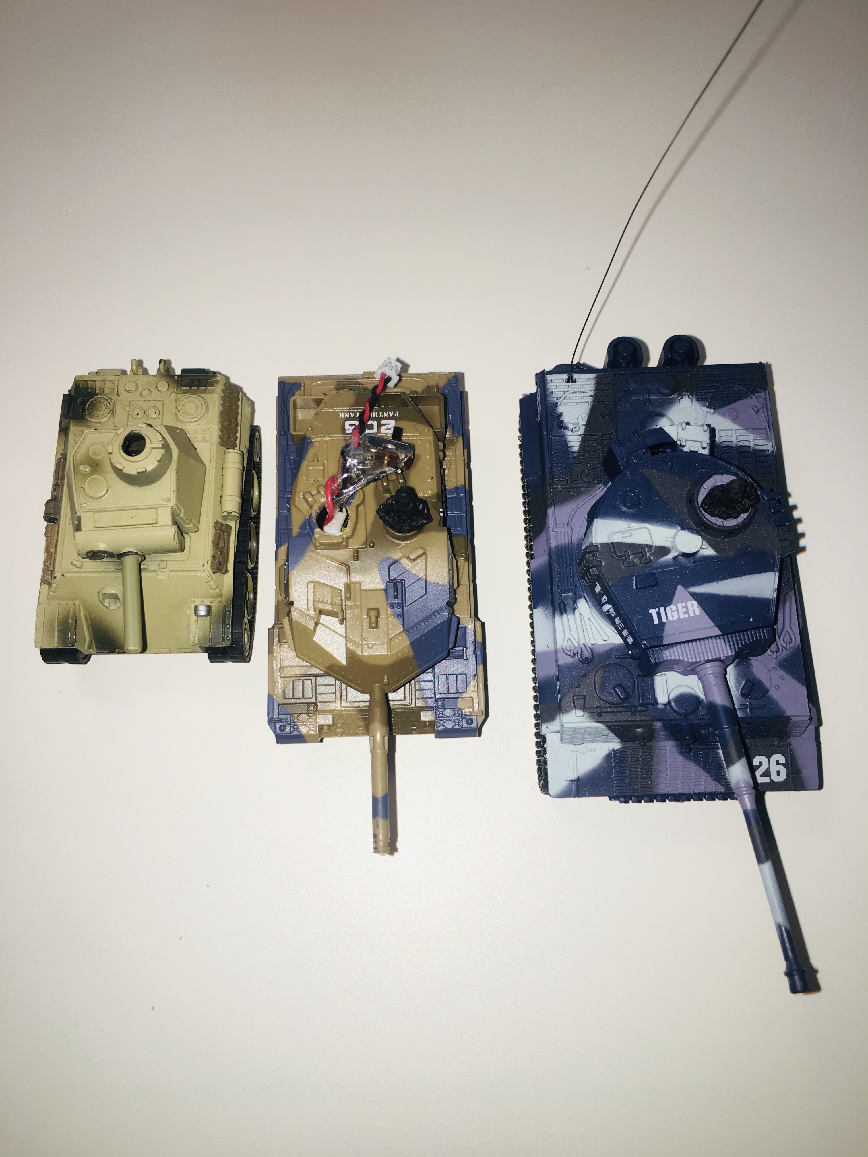

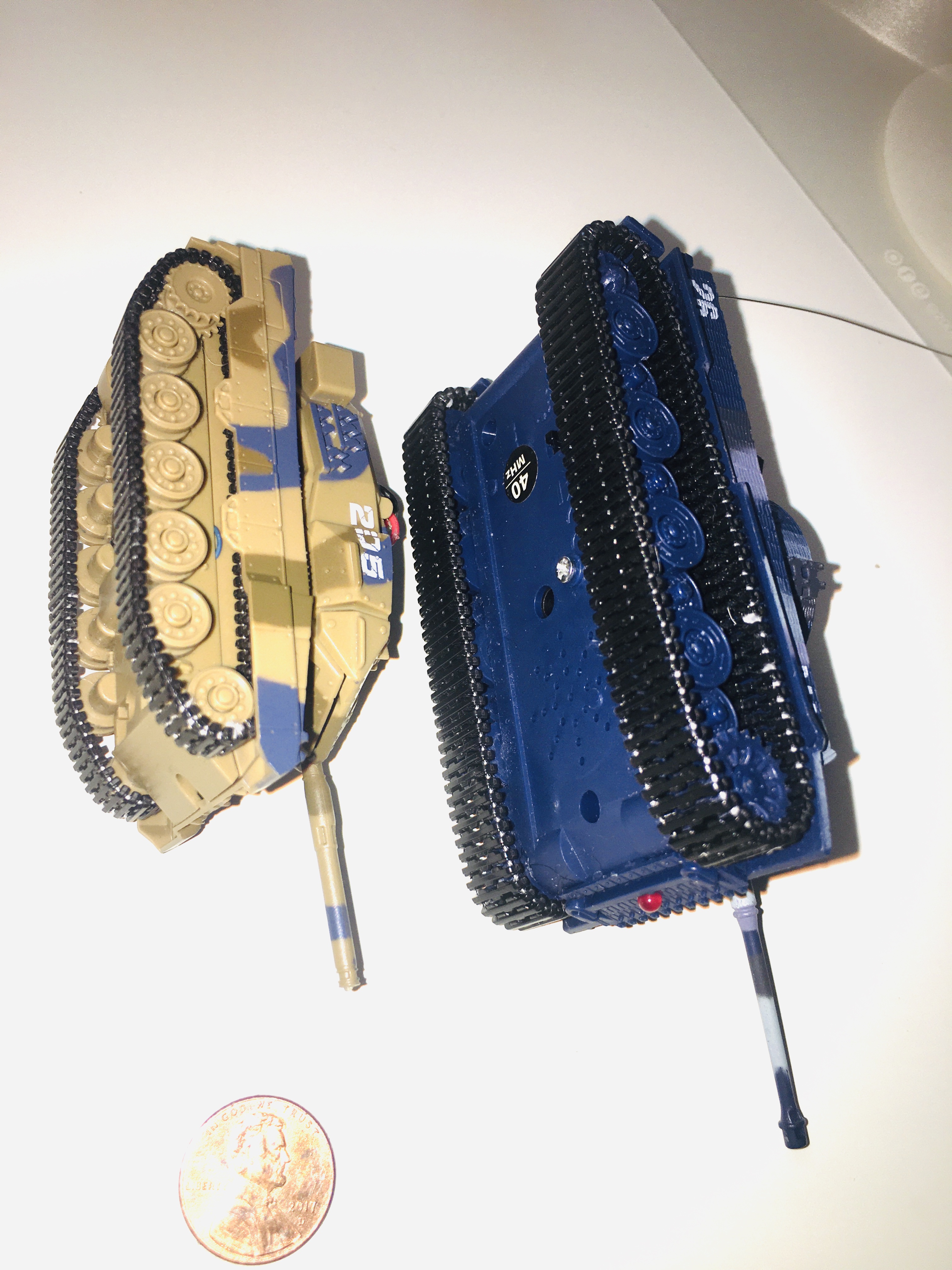

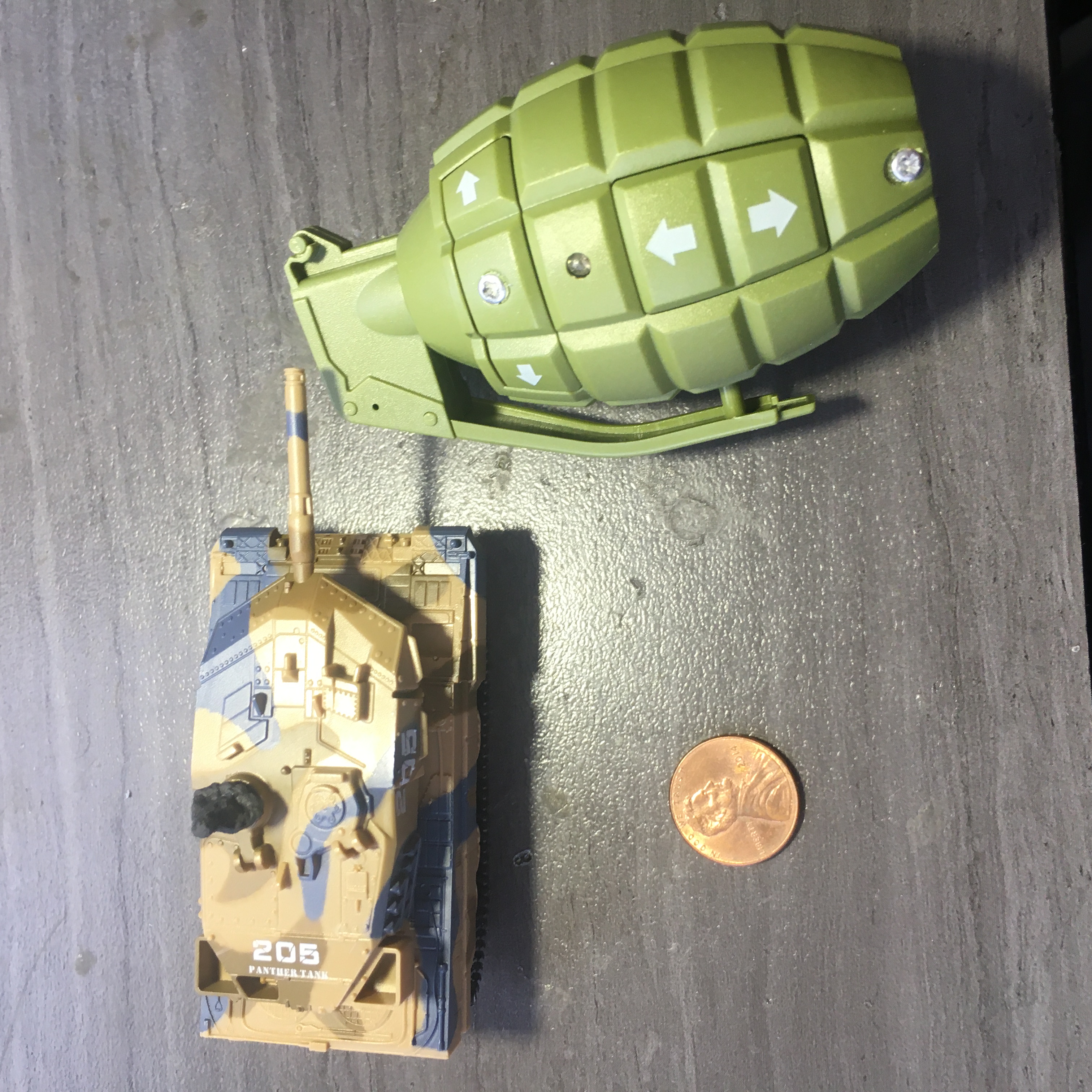

The Tiger 1 on the right is 1:72 scale for reference. Both Tanks on the Left are 1:77 scale.
Both are 1:77 scale. I am switching to the Leopard II as it has superior ITL Tracks with sprocket teeth drive to the track. The plastic ITL track design requires less power to run than a low tech 1 piece rubber Track. The 100mAh lipo is mounted in the Leopard II Turret. A wiring harness with LVC added with on\off switch and lipo charging plug is now visible on the Leppard II Turret.

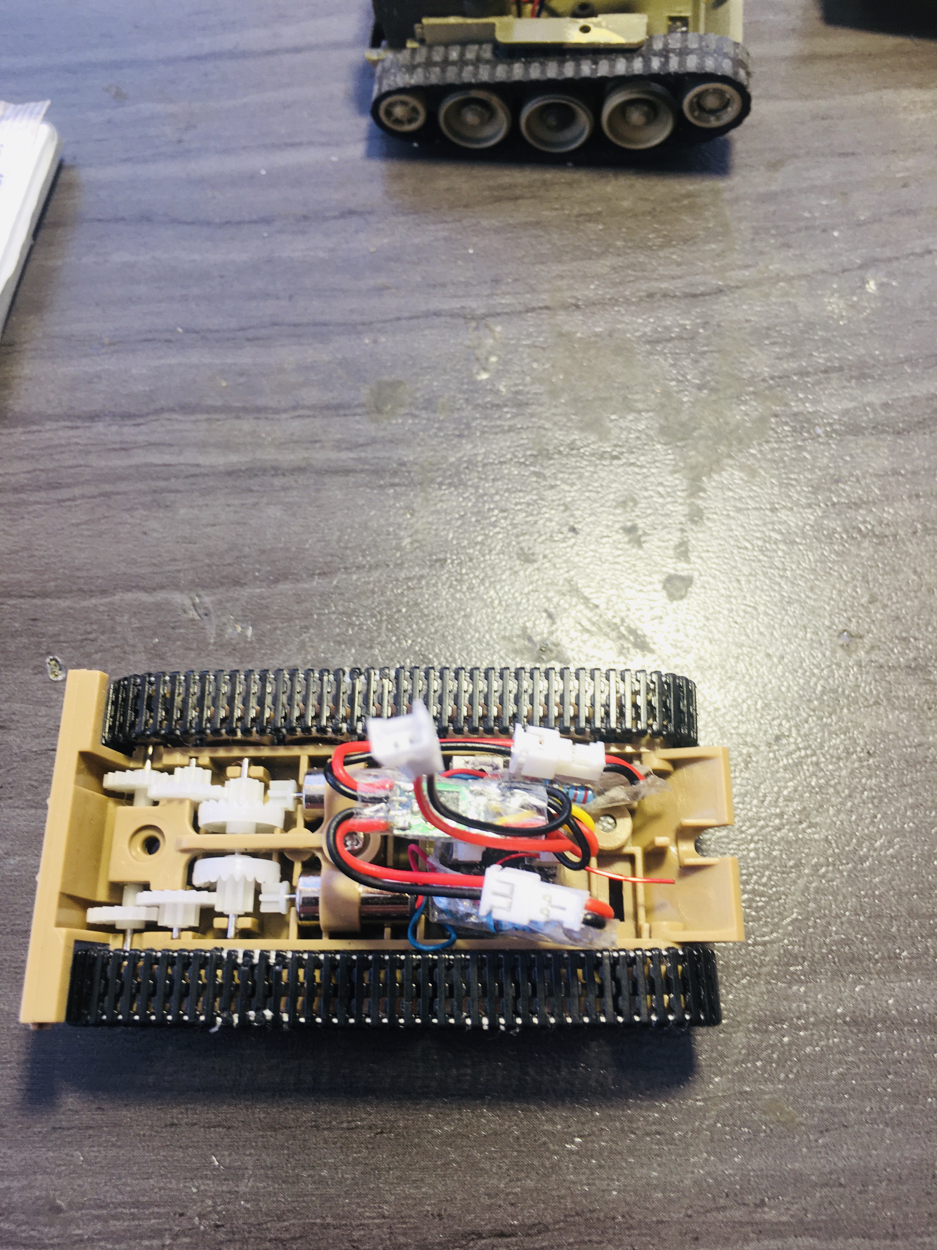

This Tank is the same scale (1:77) as the Panther but has much better tracks and sprockets. It is ready for final circuit board positioning. The Leopard II looks way better with it 5 road wheels as opposed to the Panther with 3 road wheels.
The receiver just fits in the lower hull sideways. The ESC is slowly twisted CCW and moved aft at the same time to its new position over the drive motors and gears....UPDATE this did not work as wiring was too close to the drive gears after upper hull was installed. See img_0464 for final position of ESC.
Some manipulation of the connectors and wires away from the drive gears resulting in position that works with upper hull installed.

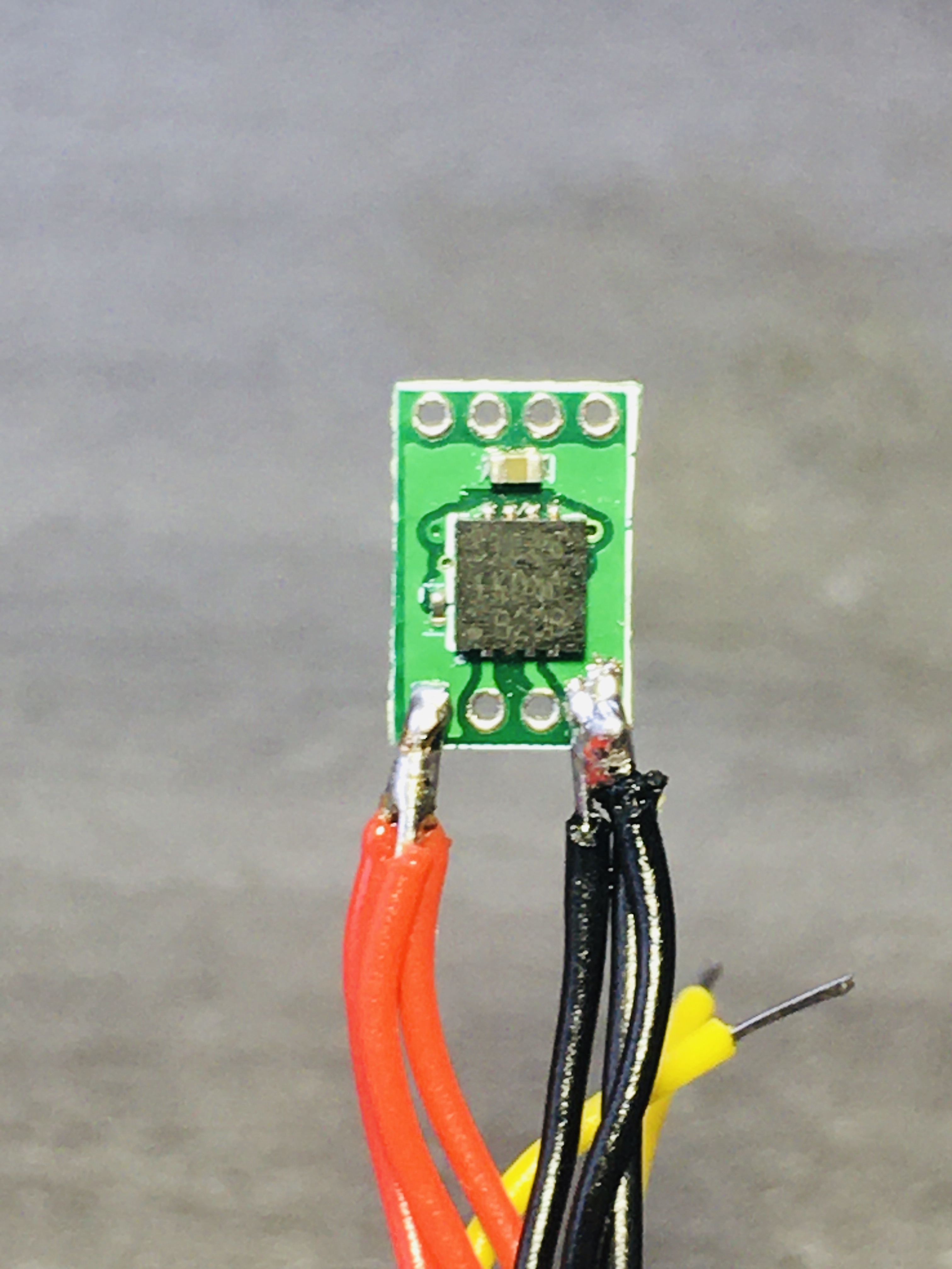

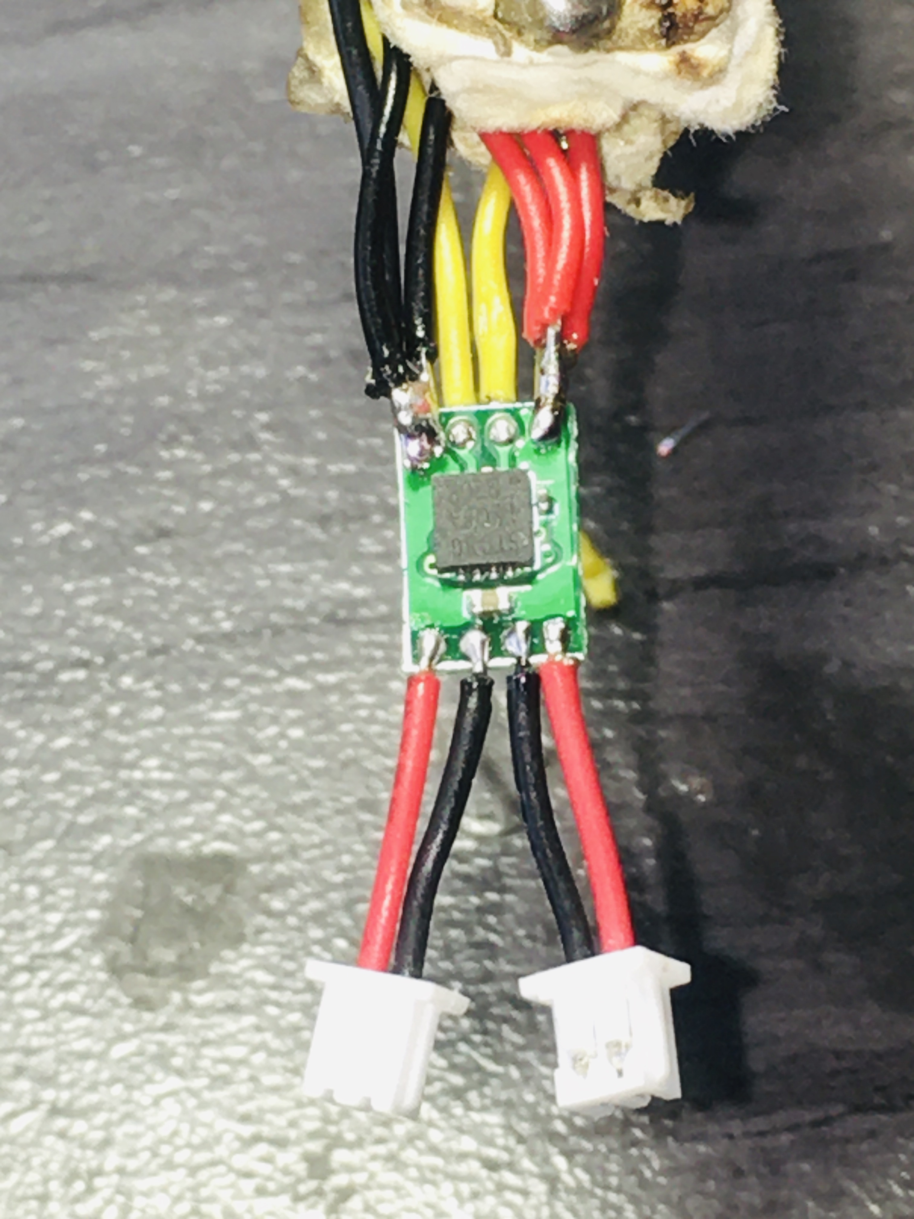

I use to solder using techniques that meet mil spec standards in aerospace\military applications. I incorporate those skills in my hobby work these days. You can get good results with the right tools and some patience. The ESC work being shown here is challenging but with a few tricks can be done without too much effort.
Soldering on this one looks good.
Another UM dual ESC comes off the line and ready for testing. This one has a track mixer.
Todays work 1.5 hours, is ready for next phase. Testing.

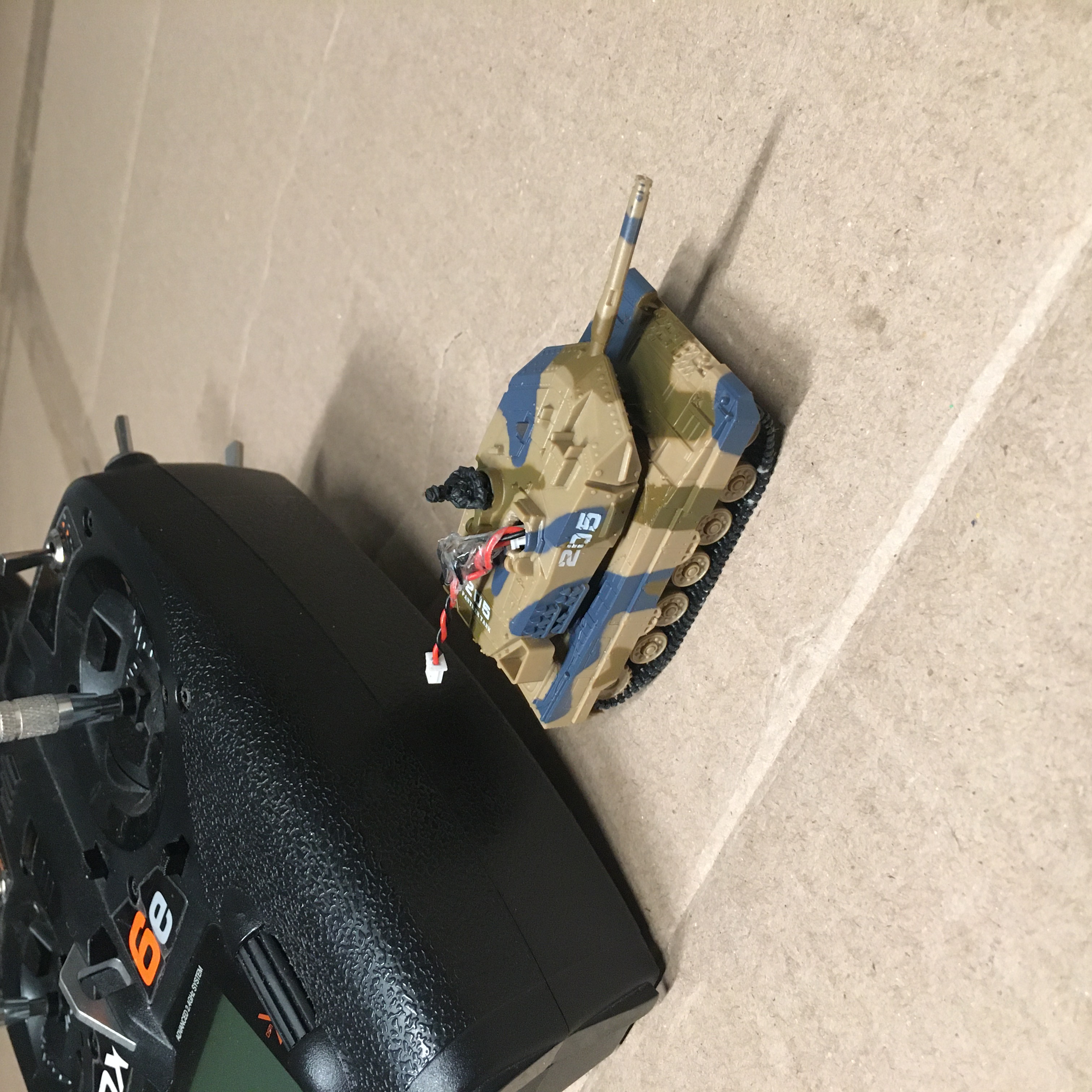

I had a little time available and used it to make video of the 1/77 Leopard.
https://www.youtube.com/watch?v=KerBh0QAL6k
Hobby Grade 1:77 Leopard II with its upgraded TX.

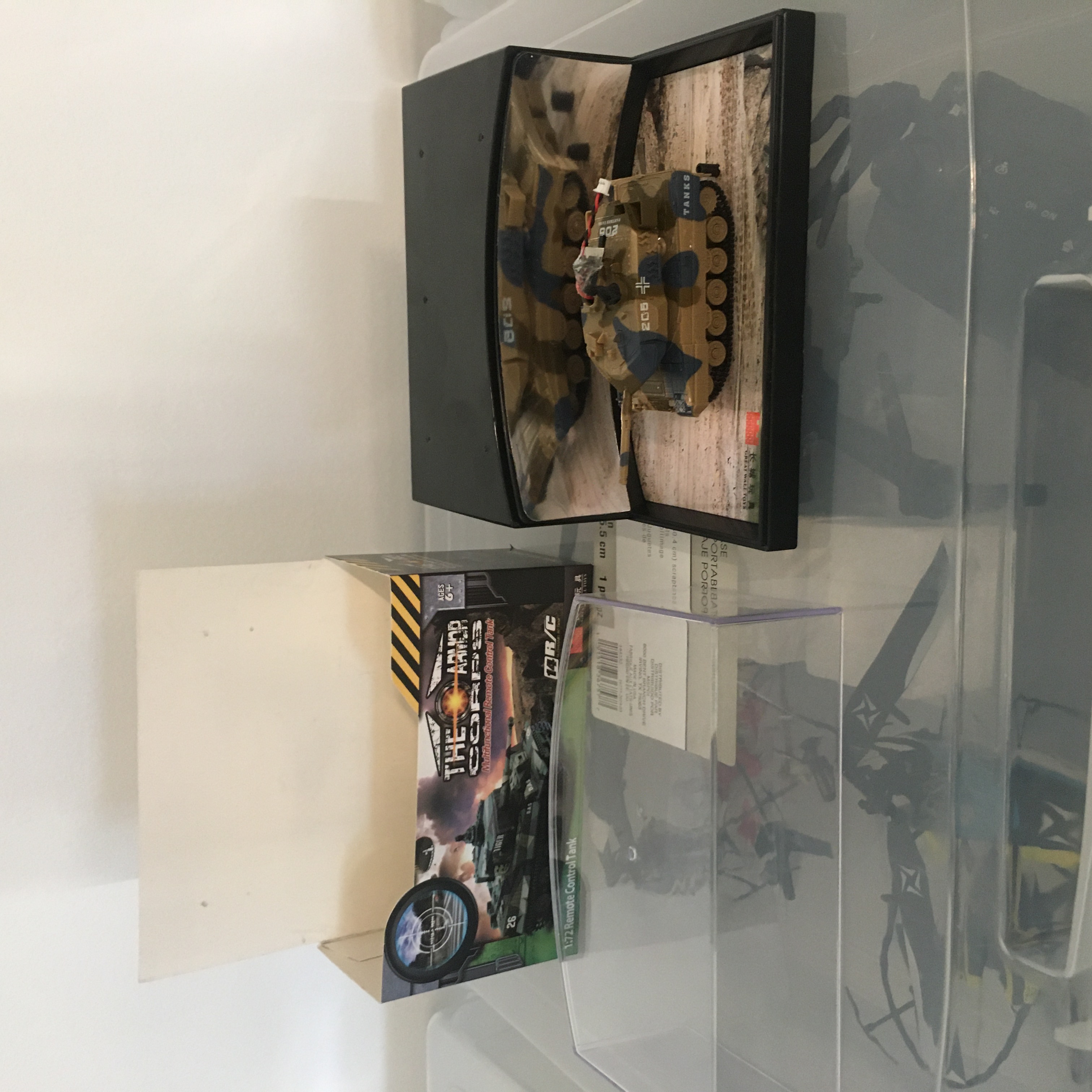

The stock version as it comes has a nice display case that also stores the TX all in one place Portable 2.4G micro Tank good for travel.

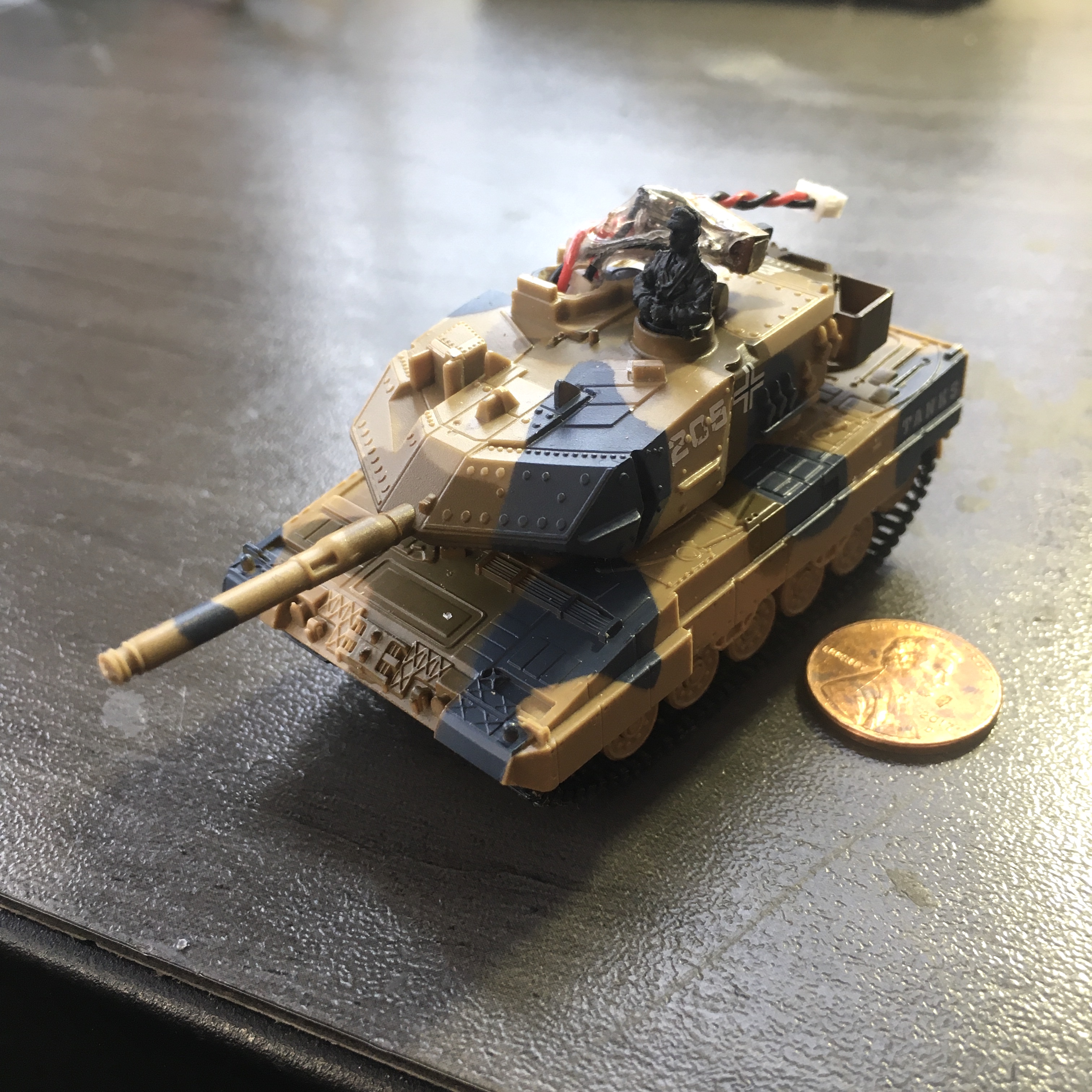

Here it is,  WORLDS SMALLEST (1:77) HOBBY GRADE RADIO CONTROL TANK.  A 100mAh lipo sits in the Turret. external on\off switch with charge plug is visible here.
1/77 Leopard on the left, 1/72 Tiger on the right just for reference scale comparison. Both of these Tanks have hitech plastic ITL tracks that have sprocket gear drive making all others with "1 piece rubber track" obsolete. Both also are 2.4G and work very well. The 2.4G radios are Toy Grade but are quite excellent in their operation.

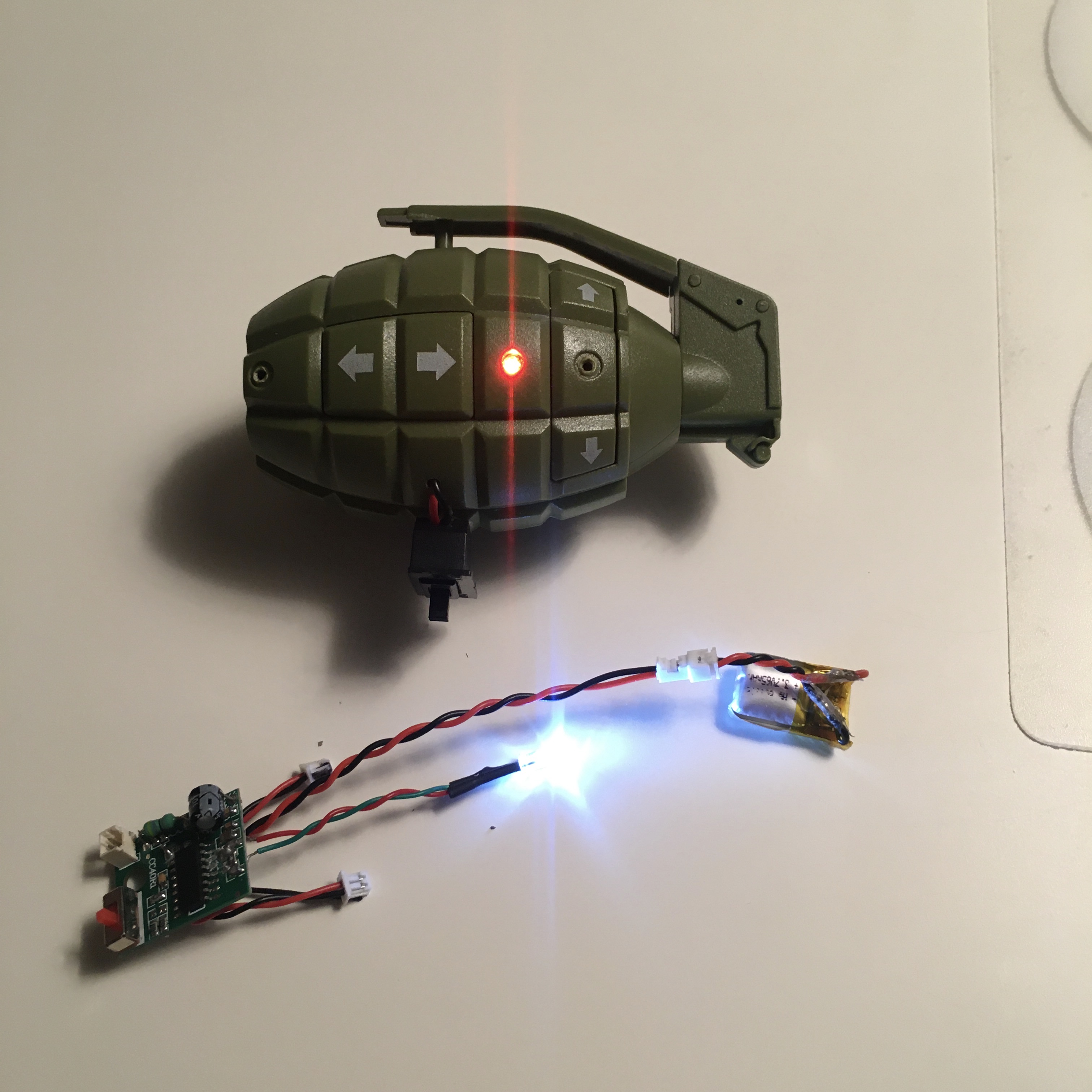

Here are the elements that make up this Tank in its Toy Grade form before the upgrade. The 1.25 mm connectors were added so that this TG 2.4 G radio system can be used in other models. The TX has been modified with a "cruise" switch.

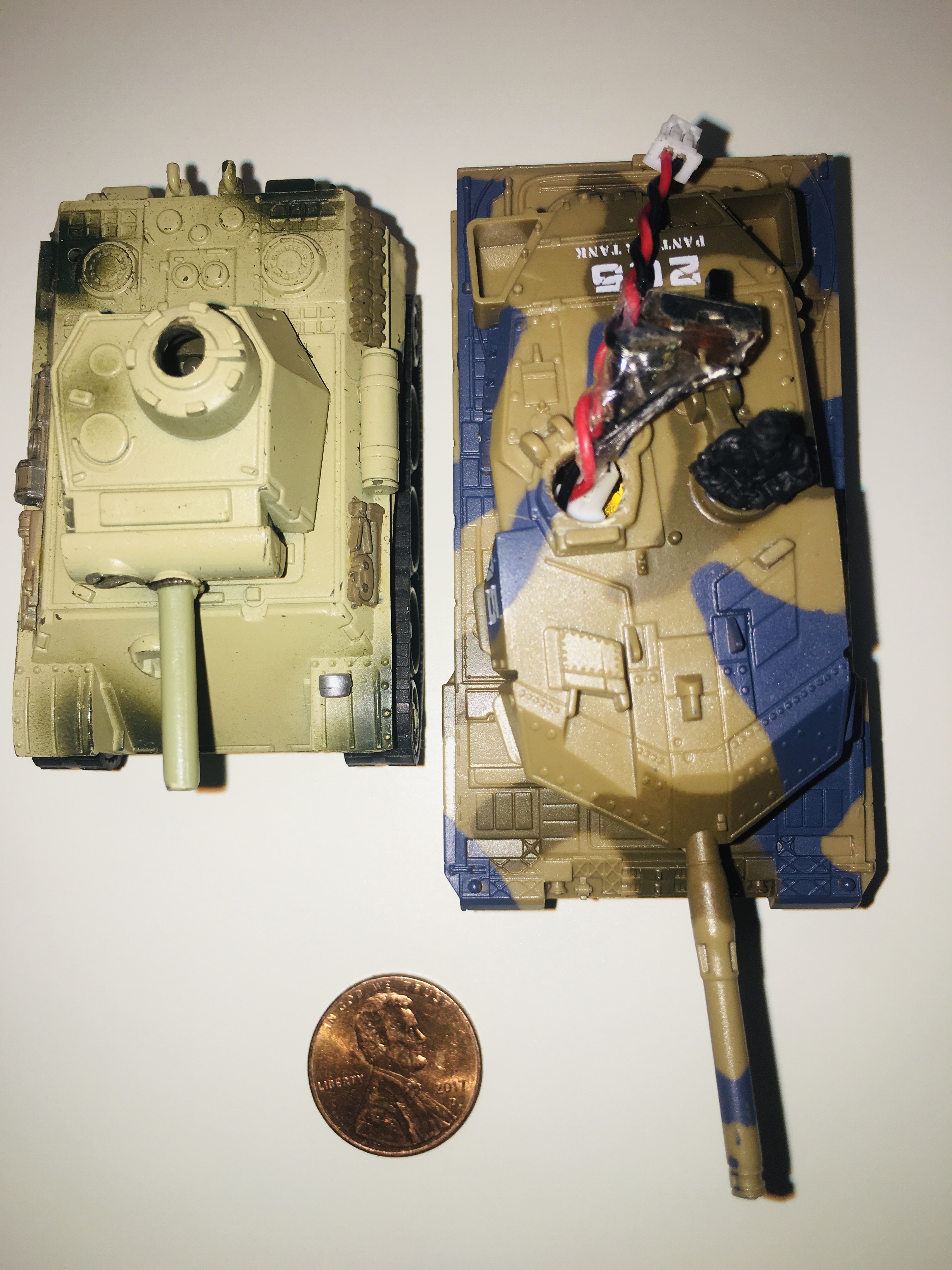

Left to right, 1/77 Panther, 1/77 Leopard II, 1/72 Tiger 1. This is the extent of micro 1/77-1.72 RRC Tanks on ebay that I know of. The 1/77 Panther has 1 piece rubber tracks with smooth (no teeth) drive sprocket and tends to slip as it ages as the rubber starts to degrade. These are inferior in my mind and I will be retiring this and 2 others like it.

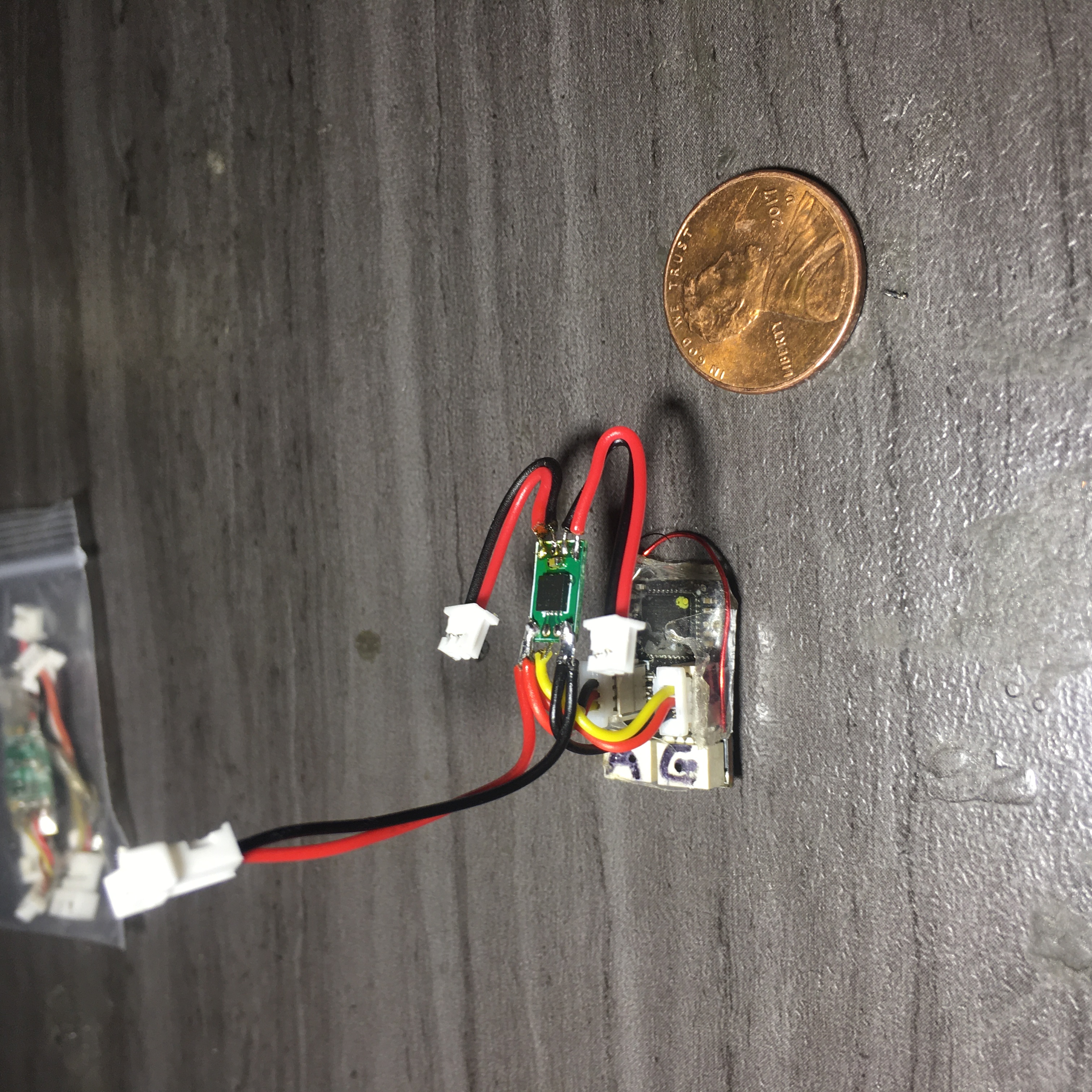

This is as tight as it gets!  5 channel Rx-42 D+ with dual ESC's.

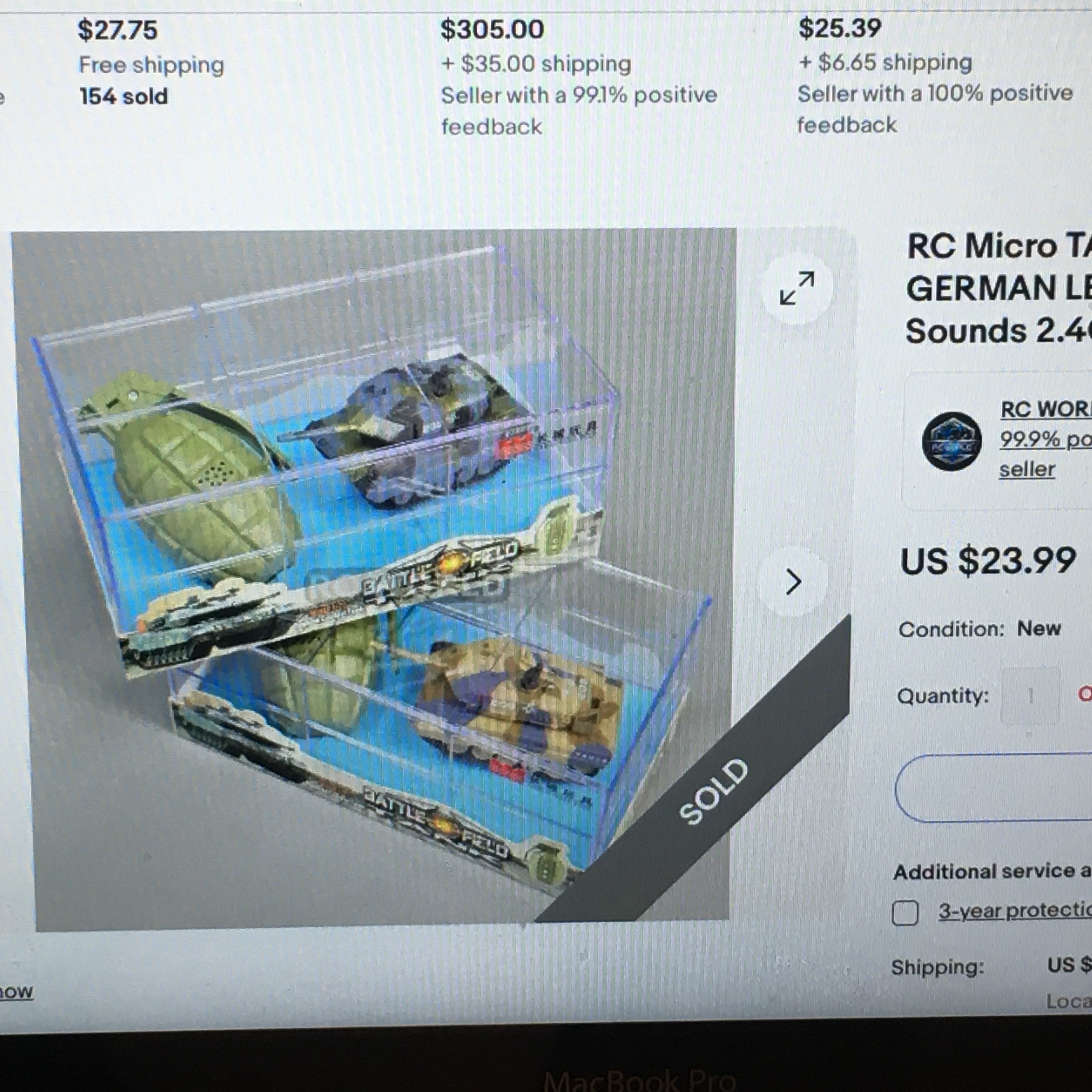

Just for kicks, I looked at EvilBay. No grenade transmitters, but this might interest you or someone in need of little tankers: https://www.ebay.com/itm/285575947999?h ... R8CI9aKdYw
