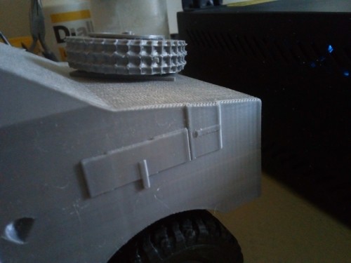

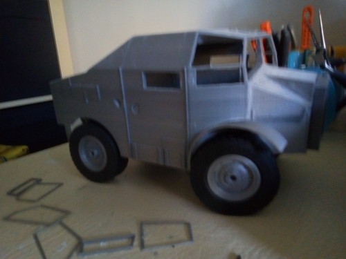

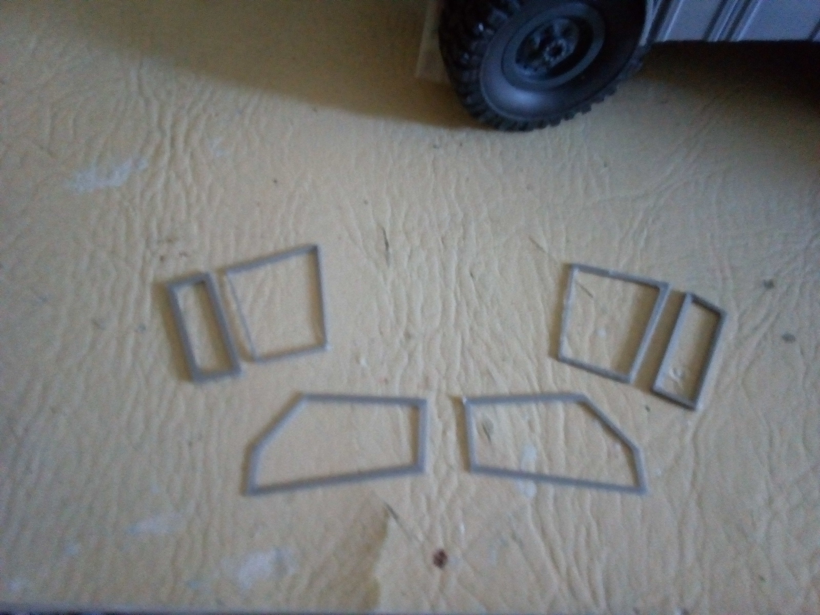

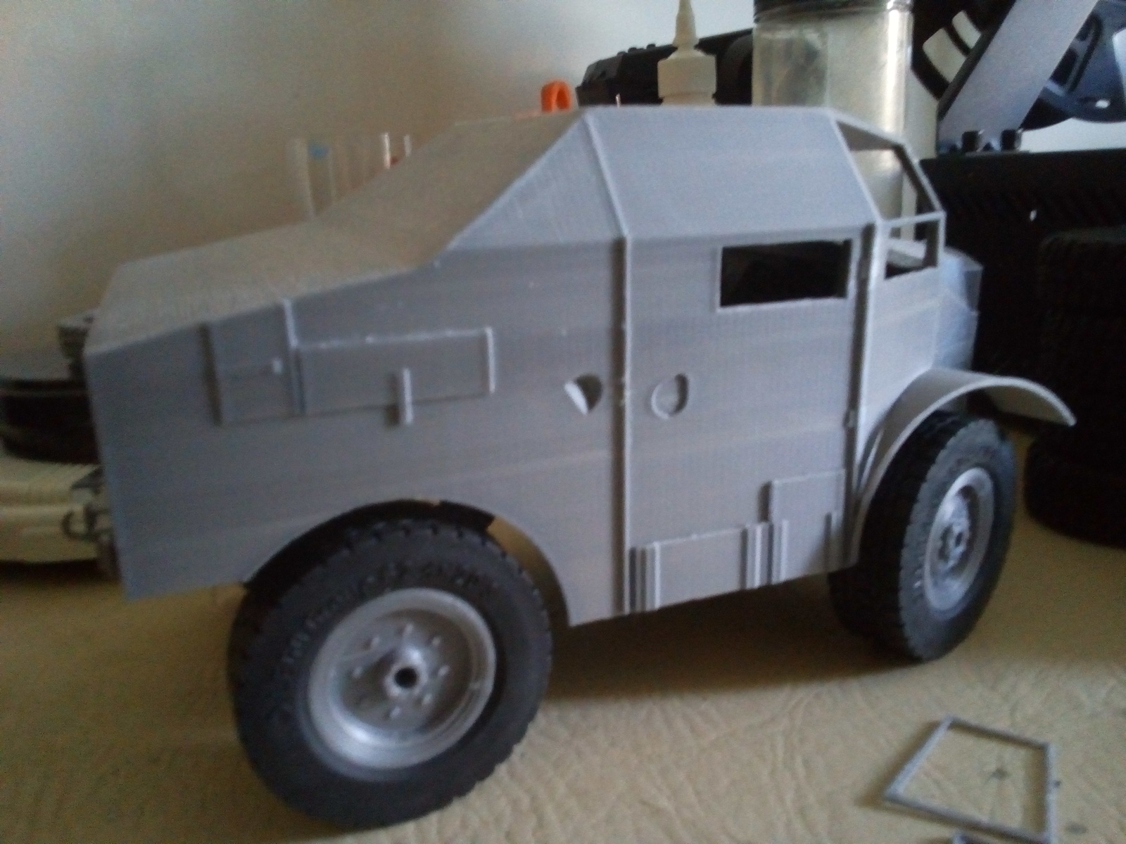

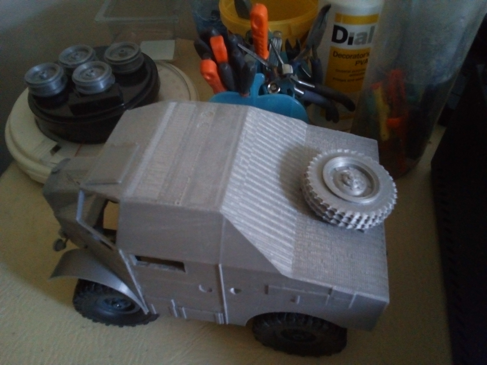

Tyres arrived, so fitted those. Did some window frames, and will use a supermarket salad container for the glass, the frames have a recess to take the panes.
Spare wheel and mount done.

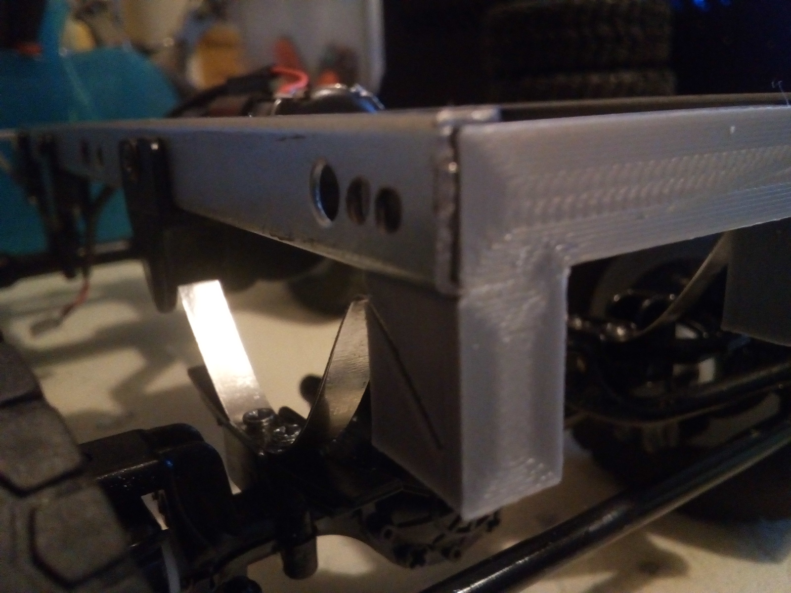

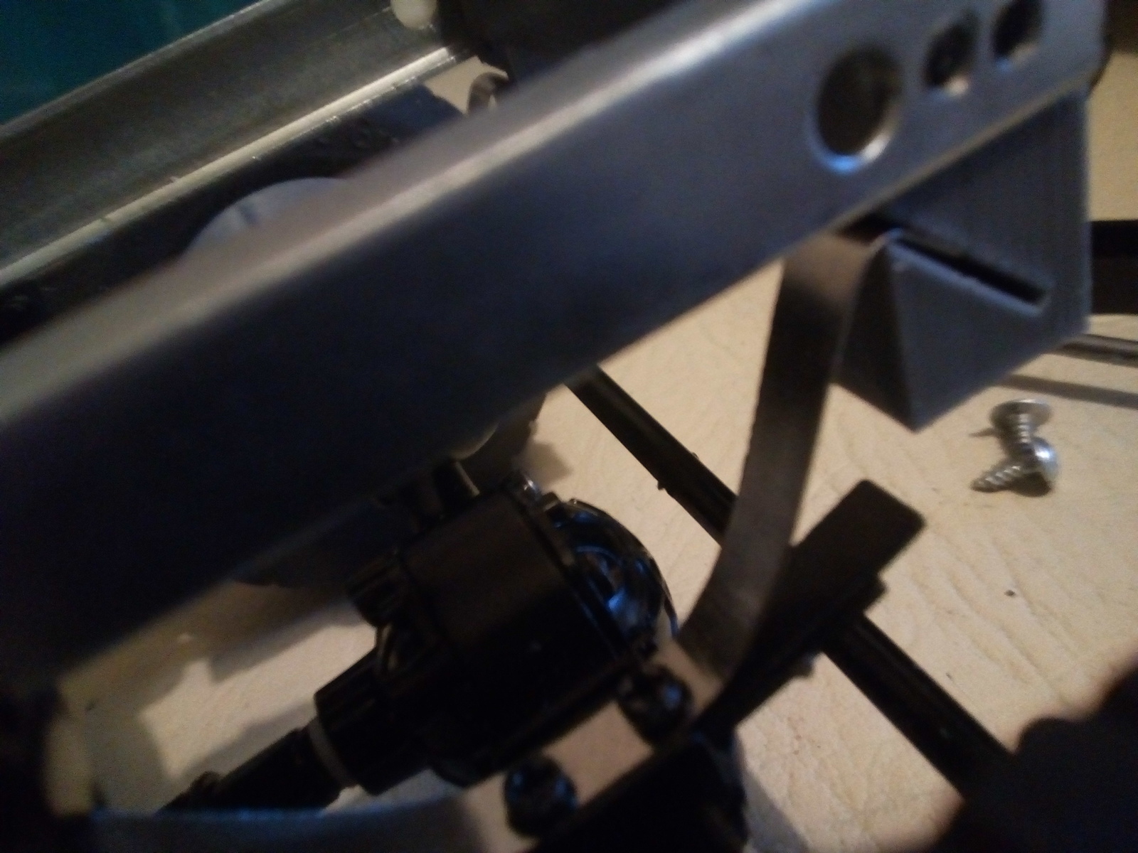

Problem to solve? The nose of the Quad is narrower than the chassis rails. I also have an issue with the HL suspension mounts, they are right on the limit of the rails and foul the bottom of the radiator. Will see what I can do to redesign the chassis and suspension mounts, so that it all fits. The front axle really needs to go forward a few mm just to add to what needs to be done.

After a bit of sitting and staring this new cross member was the simplest and most effective solution. The member slides between the chassis rails, and the front edges of the springs slot into the cross member. I had to remove the leaf springs and swap them over, as well as rotate them 180 degrees.
I might redo it so that they slot into the cross member a bit further forward but as a fix, at least I know it works.

Good thinking Batman
Wayne
