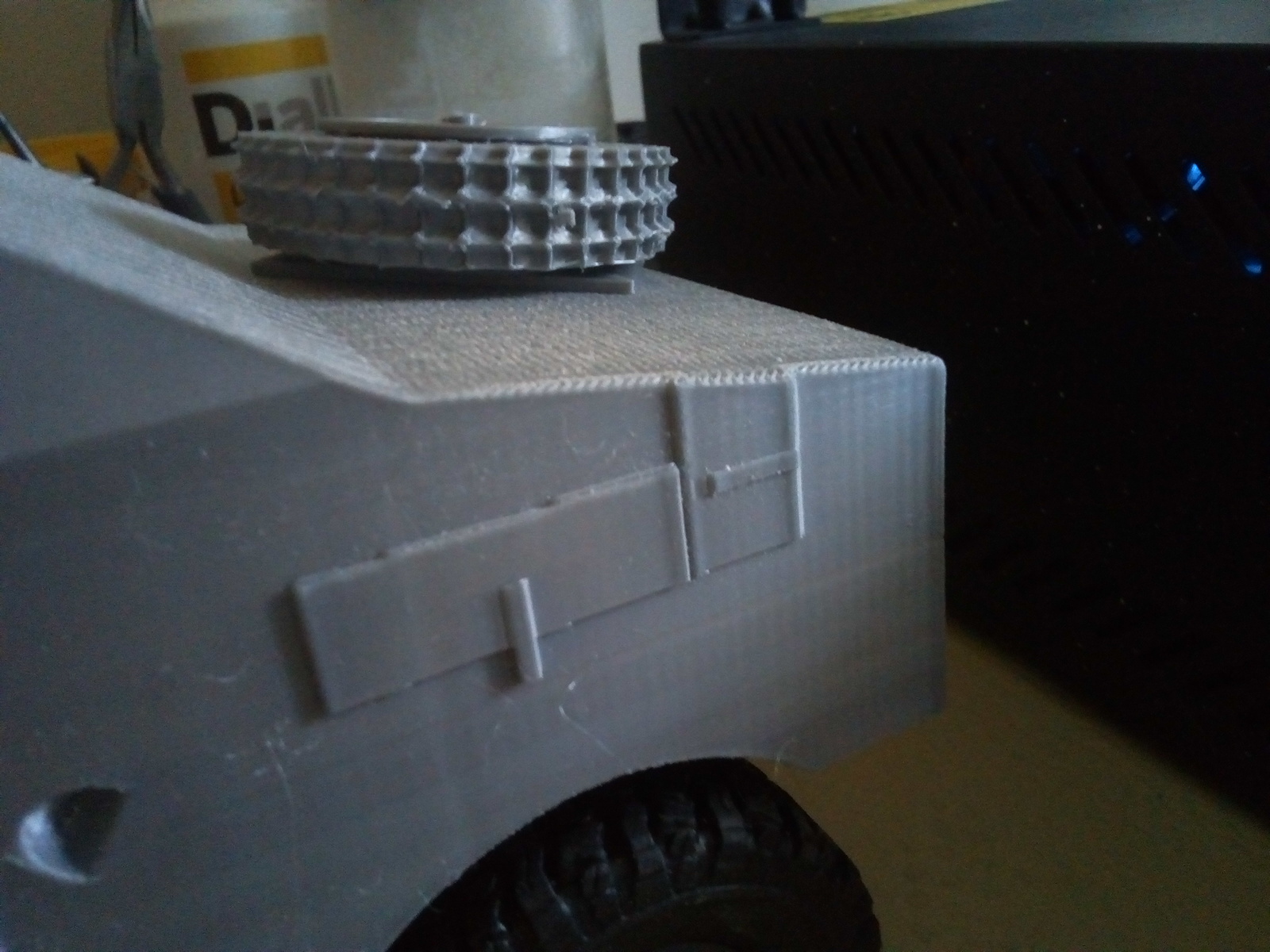

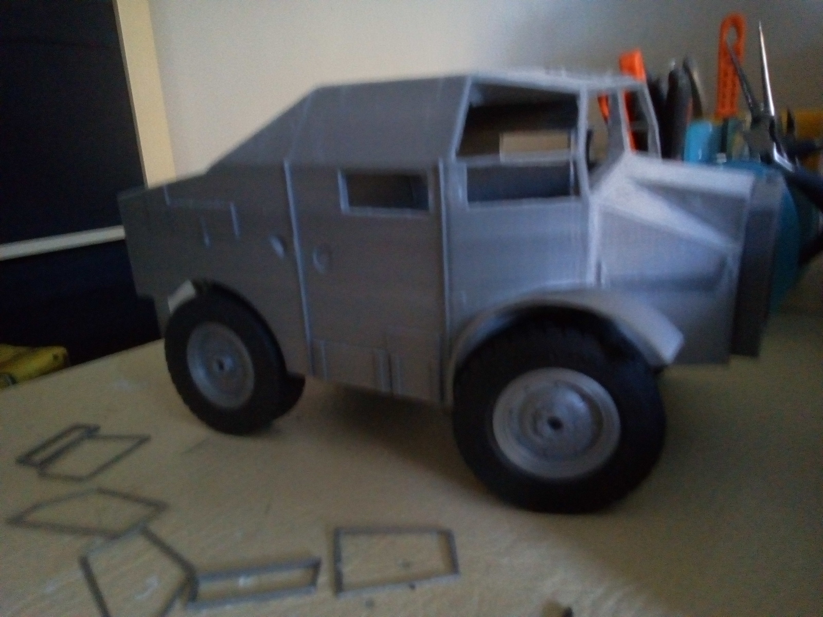

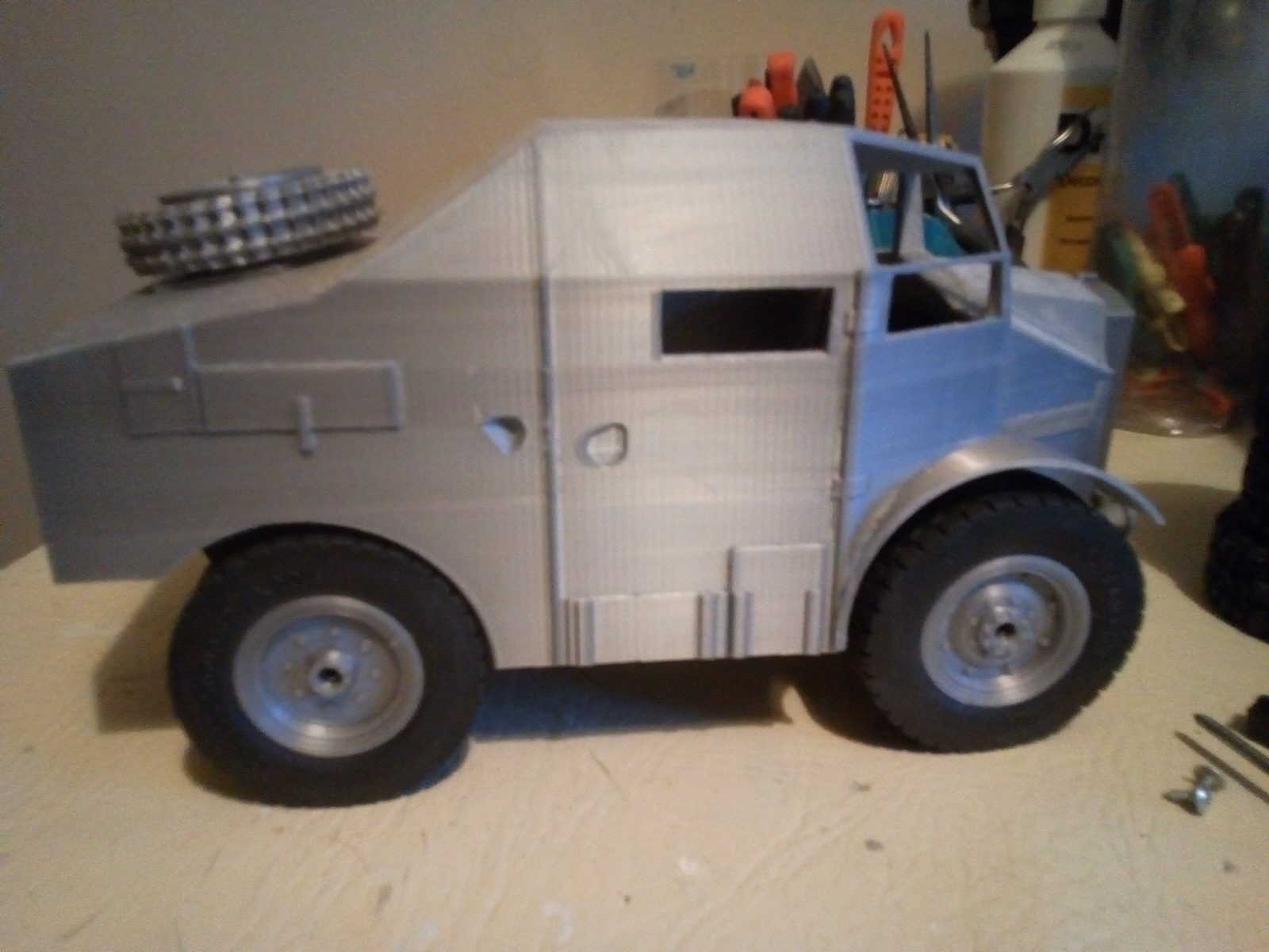

Tyres arrived, so fitted those. Did some window frames, and will use a supermarket salad container for the glass, the frames have a recess to take the panes.
Spare wheel and mount done.
Problem to solve? The nose of the Quad is narrower than the chassis rails. I also have an issue with the HL suspension mounts, they are right on the limit of the rails and foul the bottom of the radiator. Will see what I can do to redesign the chassis and suspension mounts, so that it all fits. The front axle really needs to go forward a few mm just to add to what needs to be done.
