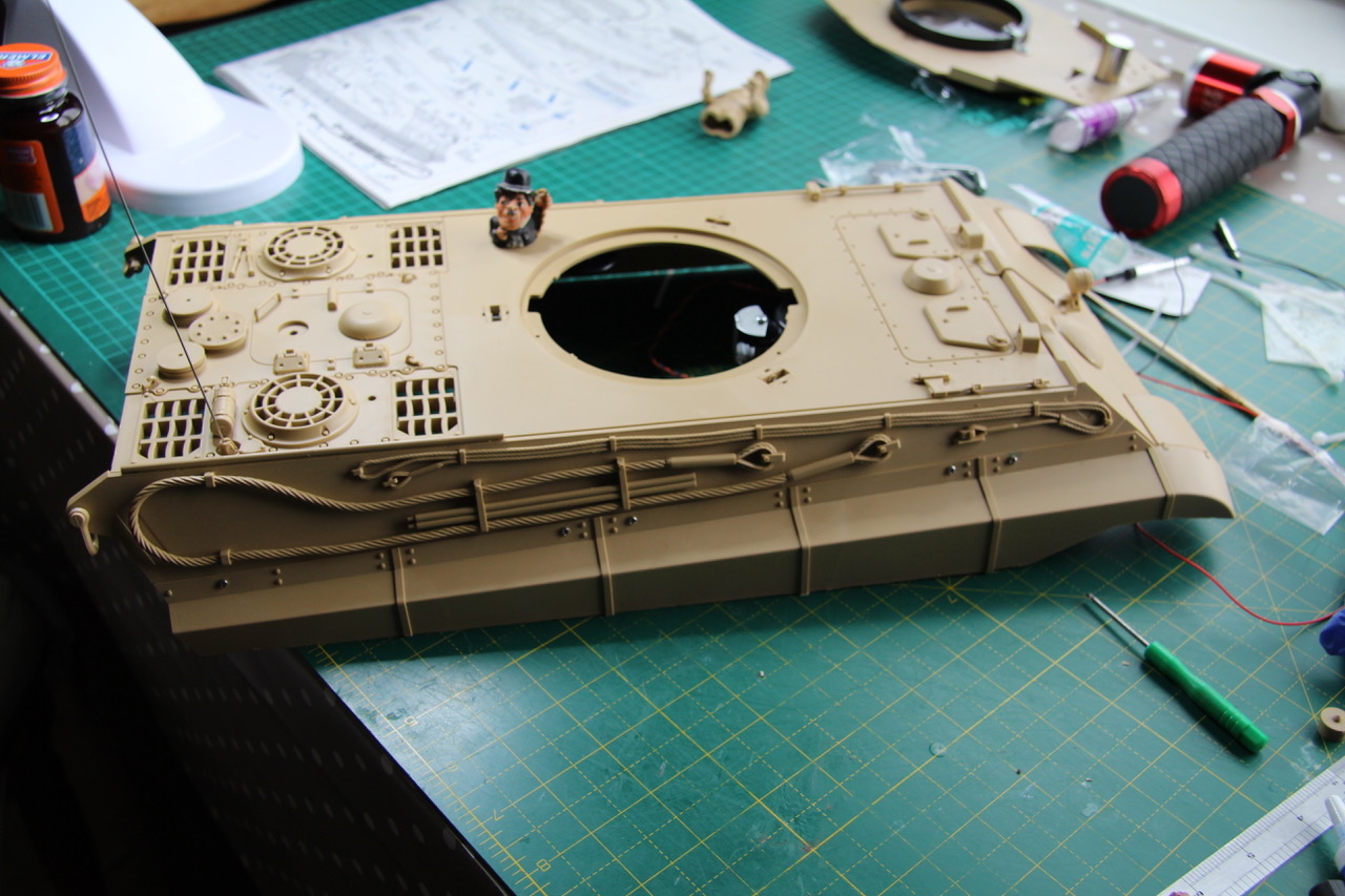

Right. here's what the upper hull looks like with the various extras attached. There's not much point describing in detail how it's done, as it's fairly self explanatory. However, it's as well to minimise the amount of glue used fitting bits, as excess glue-bulges can ruin the appearance of the model, and require judicious use of a Tamiya cutting tool later to trim the 'fat' off, so to speak....prior to painting. While Tamiya recommend pre-painting some of the extras before fitting them, i decided to complete the assembly with them, and then prime the whole unit at the same time. After spraying the hull, i'll paint the individual add ons (Hammer, cables etc.,) later.
Here is where the Needle delivery system of the Revell Contacta Pro cement come into it's own (No, they didn't pay me to say that.. :D ). It can put the tiniest amount of cement in the trickiest of locations without overspill. The brush in the Tamiya Cement bottle I have (as with the one in the ABS bottle) is pretty impractical here.

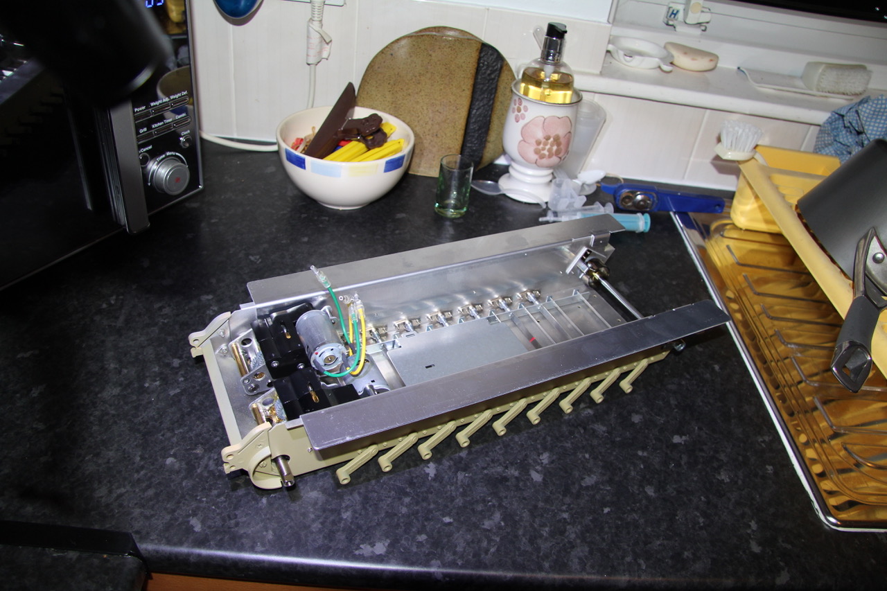

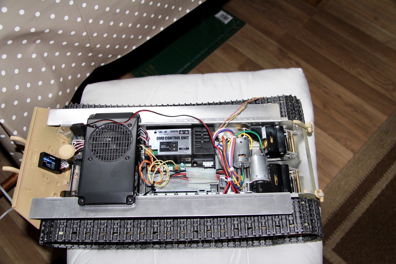

This is what the lower hull looks like with the gearboxes and motors fitted. The Tamiya units really do look well made. I did add a blast of PTFE dry lubricant to the gears before installing them. The Boxes sit on computer style standoffs. I imagine that if the same size (or slightly modded) standoffs were used, Taigen boxes could probably be shoehorned in here. I don't think you'd need an engineering degree to achieve that. :thumbup:

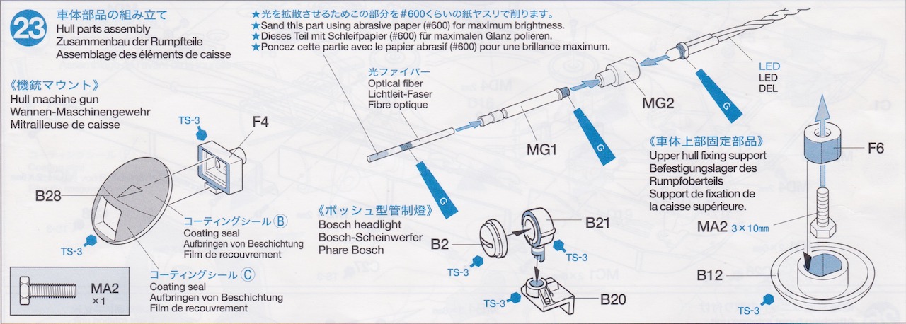

The Upper Hull will be ready for a coat of paint, after the MG is fitted and the Turret too. The MG 3-part arrangement is bonded with 'Rubber Cement'; a product that has an enduring mystery attached to it on many model forums ('Fora-- for public squares..). In the event, I used 'Elmer's' rubber cement to bond the bits. It's a contact adhesive (apply, leave to dry for a few mins, and then press parts to be bonded together). It emerges though, from a query I posted on a thread here, that Tamiya may actually intend the employment of something like this (a CA super glue):
Tamiya product for 'rubber cement' components
It's used in this location and elsewhere on the model indicated by the symbol of a blue tube sporting a letter 'G'. Tamiya are quite specific in stipulating its use instead of other cements; but they don't ever explain why. I'm guessing it's for parts that may need to be replaced, or moved, in future:

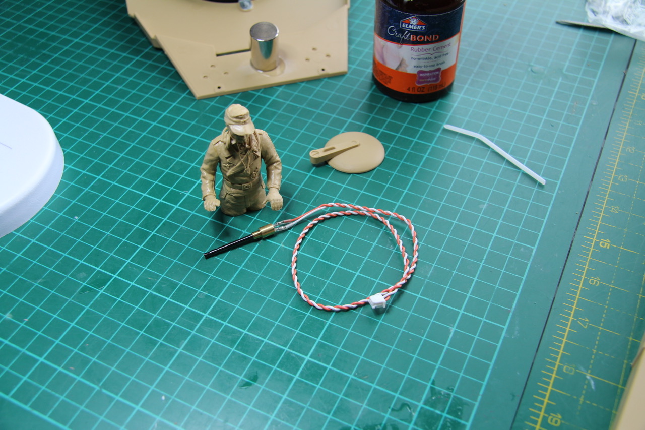

Parts of MG rewiring 'rubber cement'
I actually lost the piece of fibre optic cable supplied with the model; the bit that goes down the barrel. Luckily, I'd bought 2 metres of 1mm finer optic cable for my Cromwell project, and I cut a piece of to fit the barrel :thumbup:
Here's what it all looks like when fixed together with Elmer's:

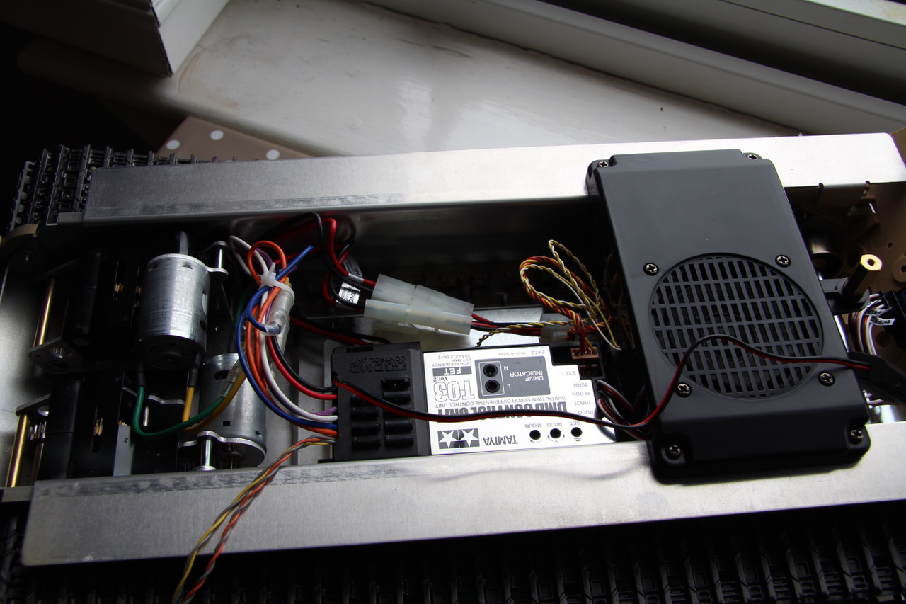

Time now to fit the electronics package. The Multi-Function unit is bonded to the mechanism deck with a strip of double-sided tape, and then in turn the DMD control unit is bonded to the MF unit with tape. The key process here was to route the cables ergonomically, using ties where appropriate. Then I was able to fit the speaker enclosure.
Routing cables and fitting Control units..
This is all a fairly straightforward operation.
Re: Tamiya Königstiger- a blitz build
Then fitting the Future receiver on the rear plate, whilst arranging cables so that they're tucked away safely from the gears, and won't hinder the turret in any way when its fitted. This was a problem I encountered with my Cromwell build.
Electronics fitted- easy peasy pleasy
I'm so used to having smoke units in my tanks, that I kept looking at the Tamiya's interior with the uncomfortable feeling that I'd missed something out... :S
Looking again, even though the speaker enclosure (which also serves as a mounting point for the Upper Hull..) is massive, and resembles a WW2 coastal bunker. It also takes up a lot of real estate in the interior, but I think there's still room for a Tarr unit in there :problem: .. :think:
The loose wires- one the main power switch- are meant to be connected to the turret. The Power switch is meant to be bonded into an aperture in the back of the Turret floor. I'll go with that for the moment. At a later date, I might find a more convenient location for it.

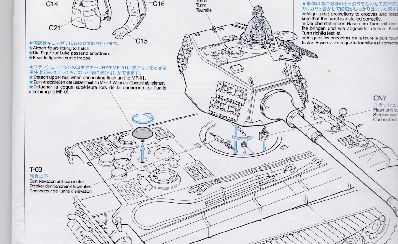

Connecting the wiring between the Turret and the Upper Hull. Note that the turret ring is in the correct position here :D

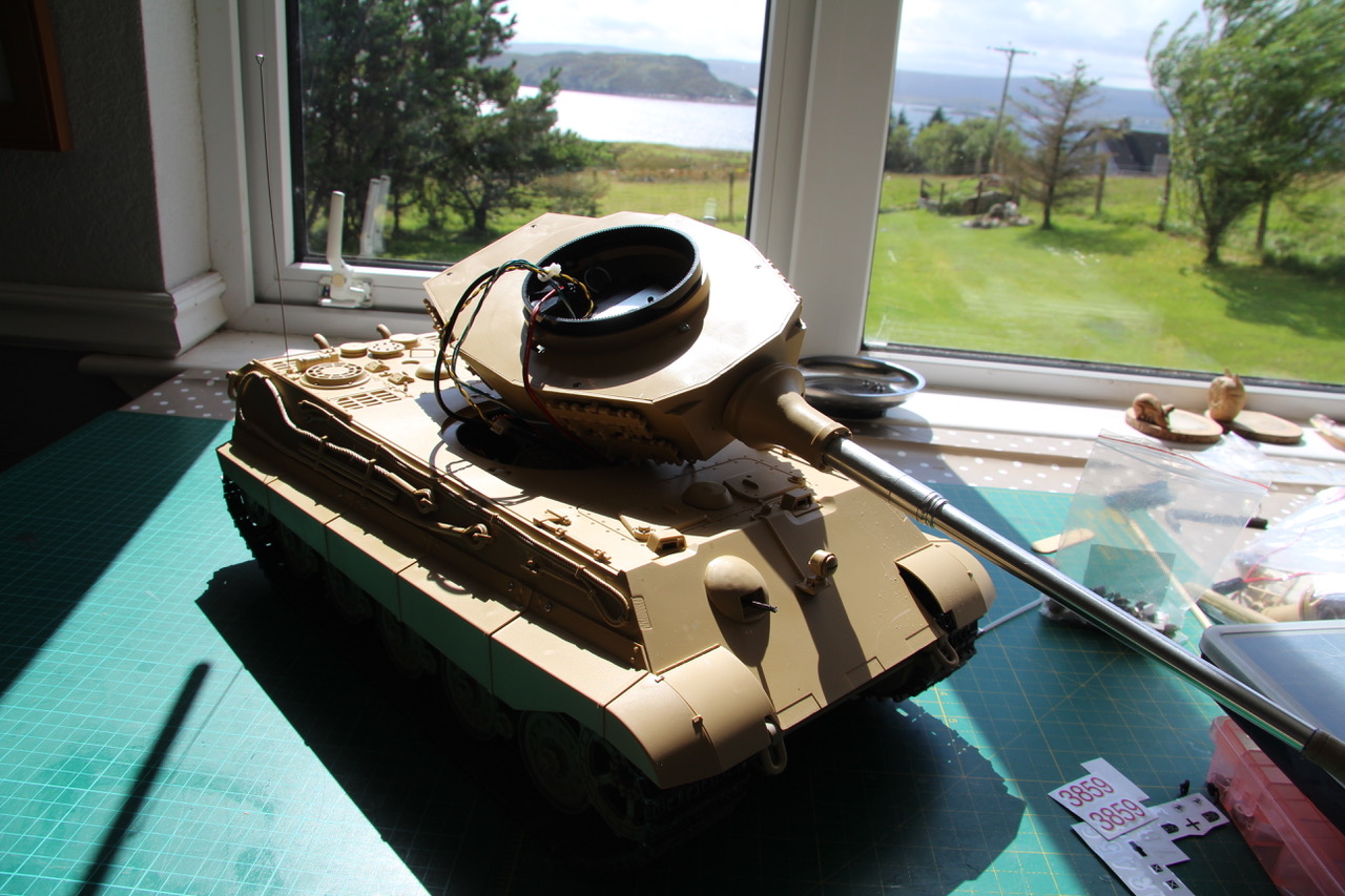

The Turret is inserted into the upper hull at the 3 o'clock position, where two lugs on the turret pass through matching cutouts in the hull, allowing the Turret to engage with it, after a small twist. This arrangement effectively rules out any possibility of a 360 deg turn arrangement. In fact (no doubt I'll be corrected rapidly if I'm in error.. :lolno: )..it looks as if any turn past 3 o'clock (90 deg.) from 12 (0 deg.), and towards 9 o'clock anticlockwise, could have the effect of allowing the turret to detach, and drop off. :problem: Hmm. This requires testing later.. surely can't be right, can it? :eh:
Fitting turret
Fitting turret

I'd have to assume that the weight of the turret would guide it past the notches.
