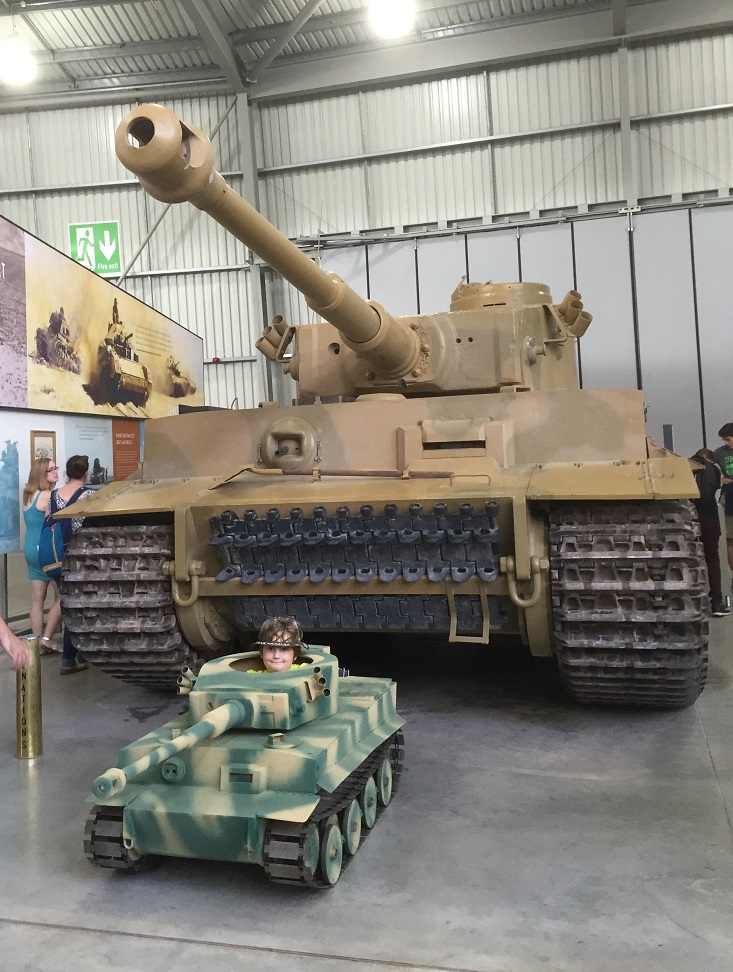

Some pictures for a recent visit to the tank museum.

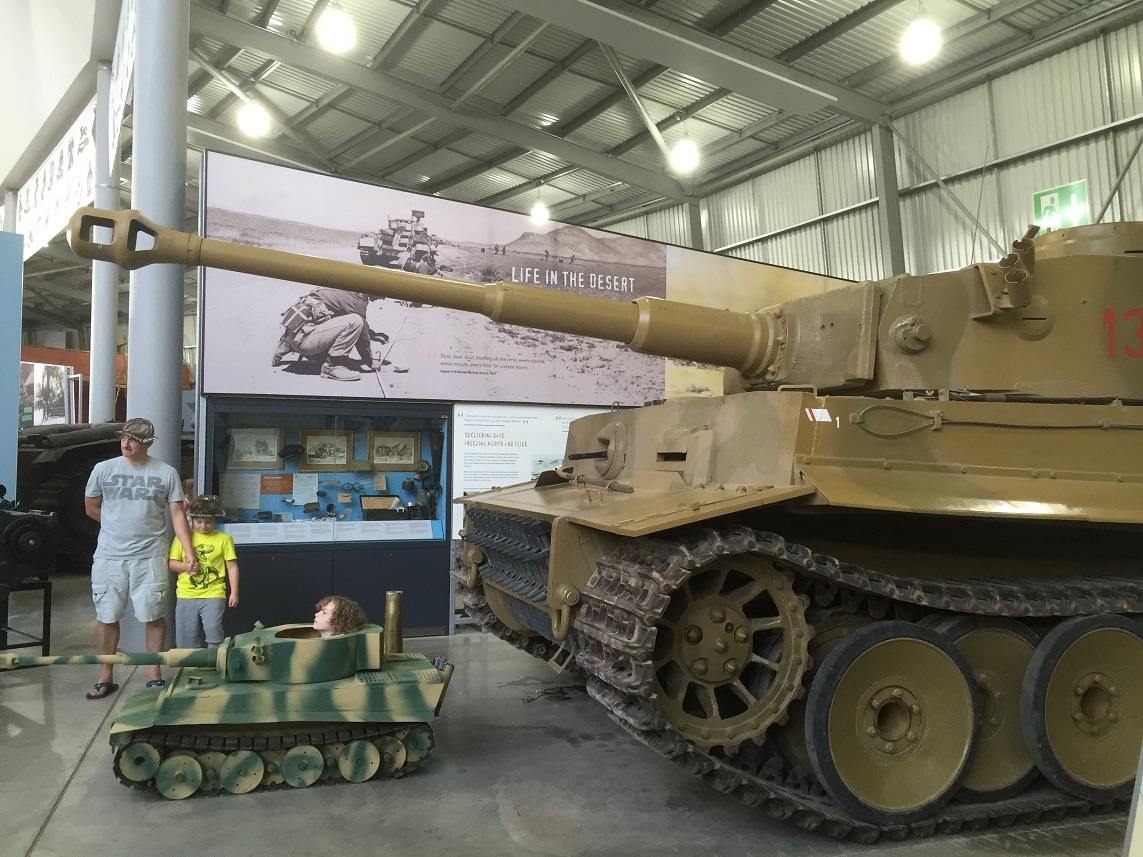

Post by Firebird »
