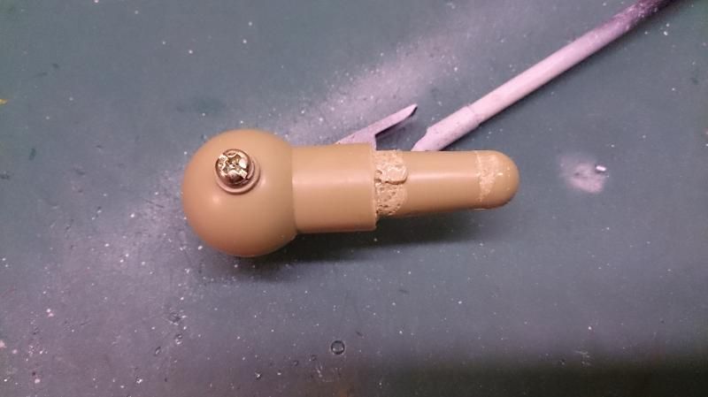

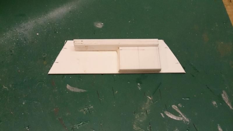

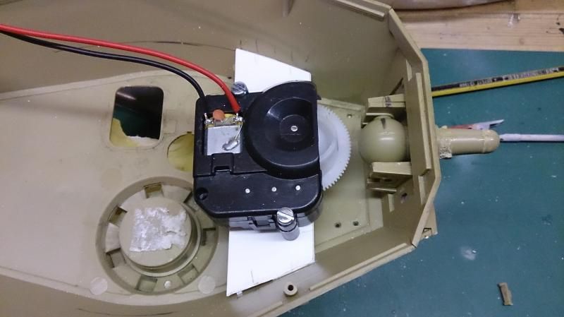

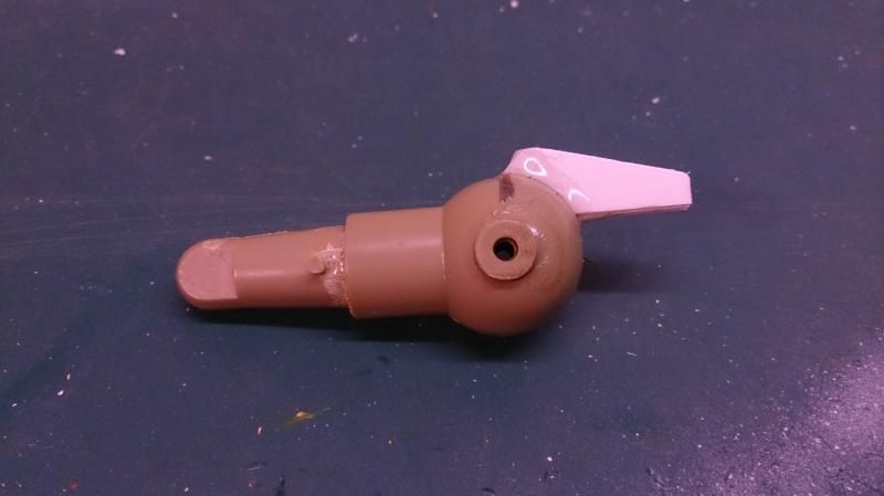

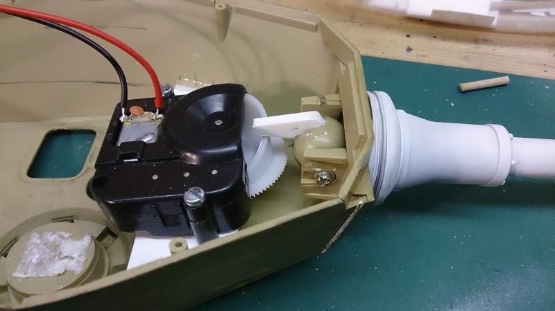

First step was to make a platform to support and fit a gun elevation motor purchased rather cheaply from E-Bay. Two mounting holes drilled out and tapped to recieve 3mm bolts.
Next, fit the motor and measure the distance required where the elevation tab will require fitting to the ball socket to give the gun barrel slightly upward elevation (Elevation motor set at 50% of its travel).
Next, epoxy the elevation tab to the gun 'ball socket'
fitted
and finally (Not something I would have wanted pointing at me)

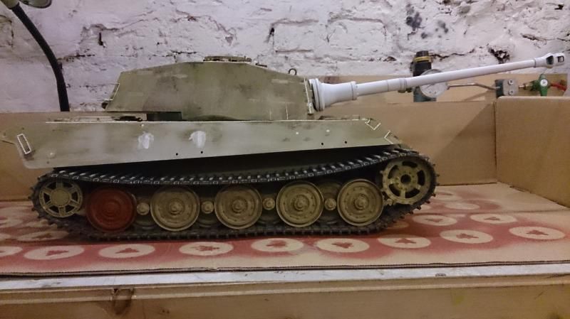

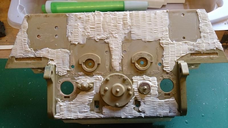

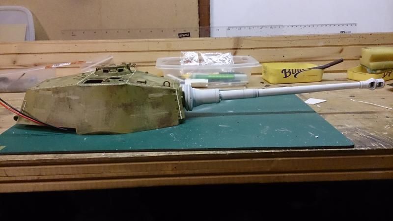

Quick update, after lots of searching about on the net for the electronic brains for this thing, I have finally decided on the IBU2 ---- being in touch with Ian, and one ordered and its on its way 8) .
First attempt at applying zimmerit on the back end, all I did was spread some 'Mr White Putty', on with a piece of scrap thin plastic card, and used a old screwdriver to press into the paste to give the ripple effect, going for the well worn look, and I am quite chuffed how it turned out.
Just needs painting and weathering now.
Could'nt resist putting the bits together, just to see whats she is gonna look like.
I can't remember it being this bloody big, ah well, more later.

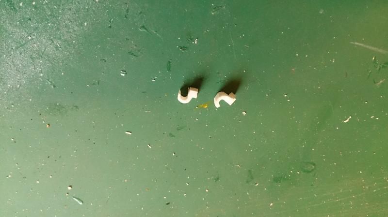

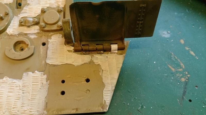

Bit more progress, more repair work done, again during my ham fisted dismantling at the start of this rebuild, I broke the clamps on the rear mud flaps. New ones made from some stock plastic sheet.
and fitted

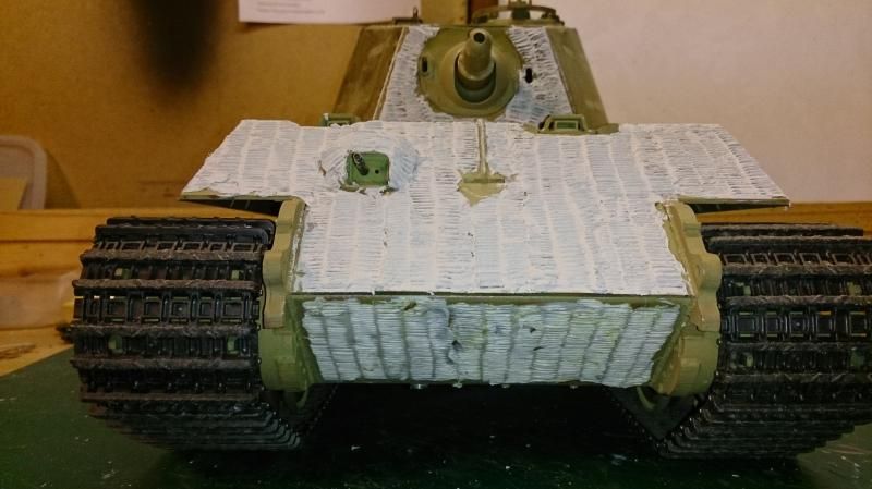

Front end now covered in 'zimmerit' (taking longer than I expected) and still got the sides to do ------------- hey ho ------- :wtf:

Sterling work with the Zimm, took me ages when I did it, I mean ages, milliput and a screwdriver but it just gives the non uniform look better than the kits. Loving the ingenuity on show here.
