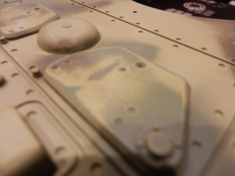

Herman...no need for special tools...use your airbrush...the circles are easy
tomhugill
Posts: 4948
Re: "PRODUCTION" TURRET KING TIGER
Post by tomhugill »
Stencils quicker easier and probably gives a better finish though.
Posts: 10960
Post by ALPHA »
tomhugill wrote:Stencils quicker easier and probably gives a better finish though.
NAH.... I shaded mine Herman doesn't have to ...super easy and less trouble than stencils.... plus you can vary the size ...but it's not up to me..it's up to Herman...Stencils take too long to place ...don't know ...too much trouble for me ...if I want a super perfect circle ...I'd just use my flow pencil :D

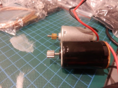

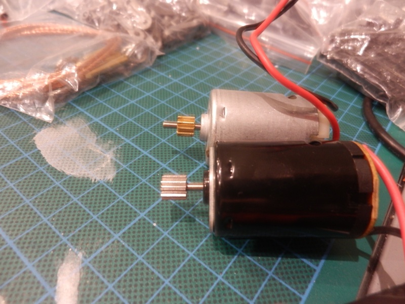

Got some apparent yee-ha hi-torque motors for the big fella, pinions in the wrong place out of the bag so will need to sort them out. Black one is the hi-torque, silver is the ones that came with the 4:1 reduction boxes.

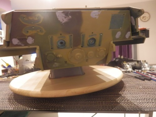

Also got a new turn table from Ikea for $12 bucks thats bigger and made of wood so I can return the expensive glass one back to the kitchen (if its not all munted from paint & glue that is.)

Well I just wanted to see how the suckers would go with an airbrush lol.... used my worst gun :haha: ....still pretty easy process... shoot the white..then chase the center with the darker color...;) made sure to have plenty of practice newsprint on the side to check where my flow had to be :D
The paint on this one doesn't matter... it's going to go to GUP when I have more time to scrap out the internals ;)

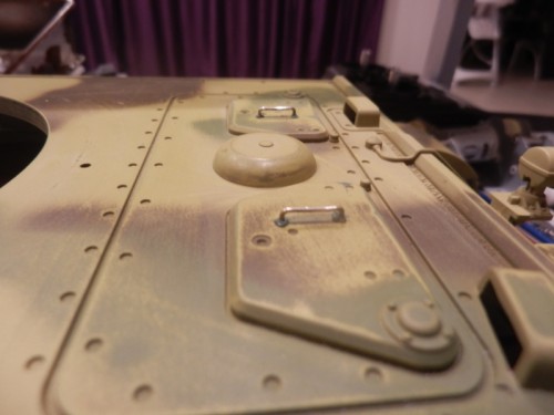

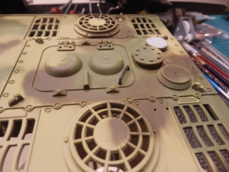

This mother is huge compared to the PzIII schlepper. Ive just been sanding the OEM penetrations flat after filling, removed the forward hatch moulded handles & replaced them with paper clip bent ones melted through & superglued.

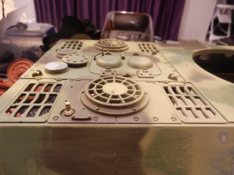

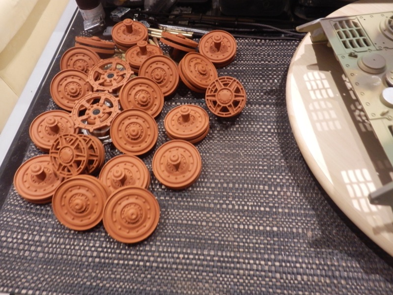

Oriented the engine hatch lifting hooks, cleaned & red oxide primed the roadwheels, and mounted the metal suspension arms.
Repositioned the aerial to its right place but had to lose the moulded base which was a shame.
On the weekend the guards will be victimised by my Ryobi 'dremel' tool & the hull sides smoothed off ready for some texture material.

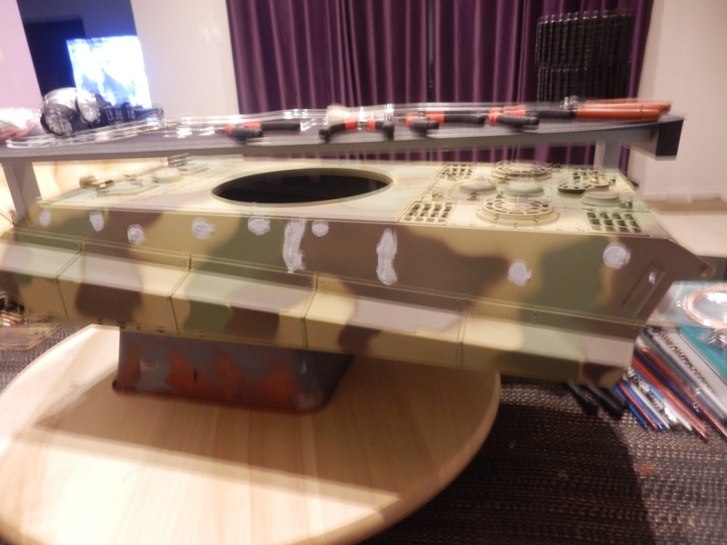

During the rest of this week I will burn in the weld on all the hull plates, which will also be a mind numbing event :/
I can reinstate the smoker tubes onto the metal exhaust hardware & close the big fella up ready for primer.
