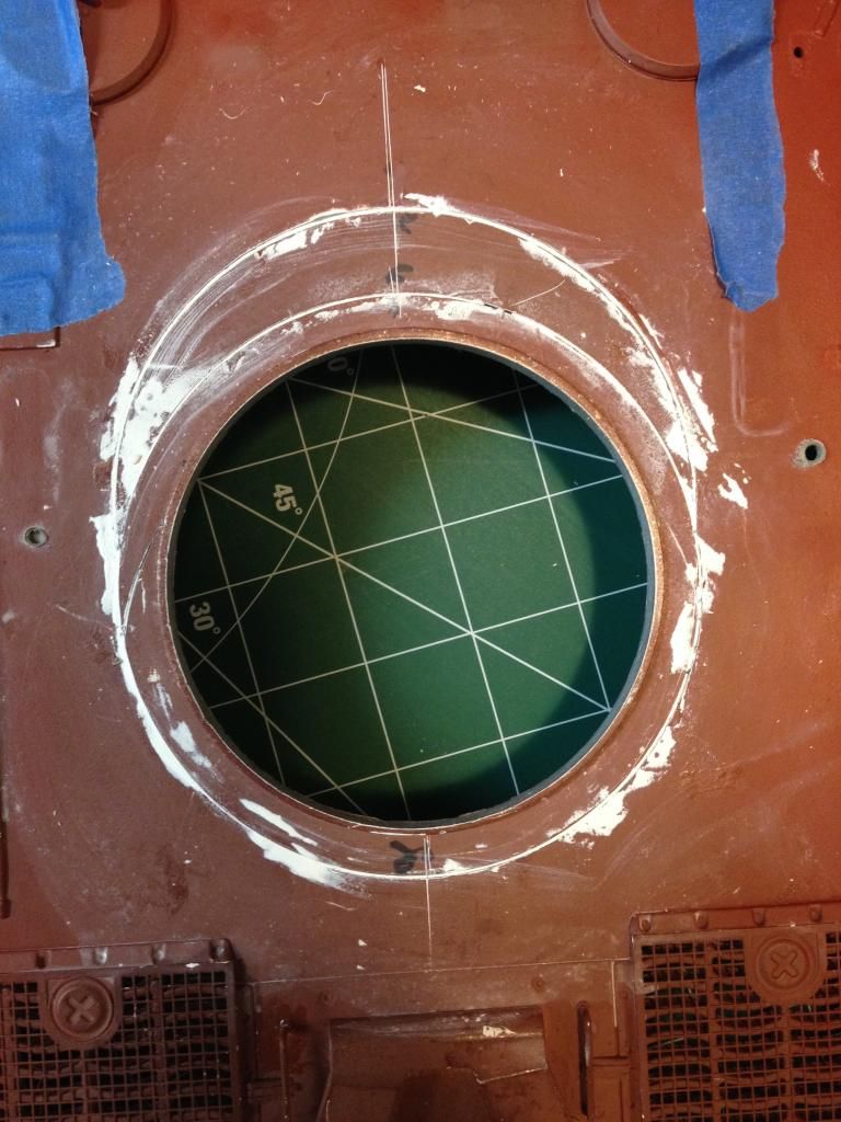

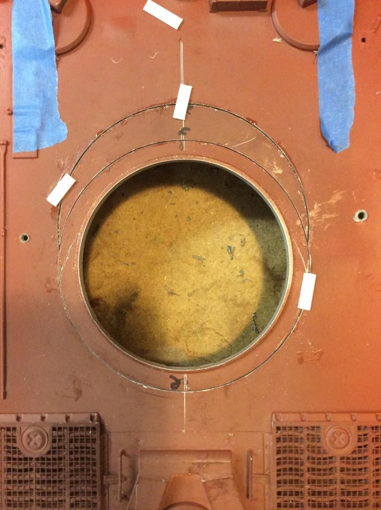

Turret gate complete. The lower half was much easier to cut than the turret,
Here are a few pics.
Just some cleaning up to do now.
I will measure my Taigen tank later as far as I know it doesn't need te turret mod?

Nice cutting Mark... really clean...should be easy to finish up
...I'd say you did that perfectly

Thanks Alpha
I am happy with how it came out. It was nerve wracking at first but the directions I followed were spot on

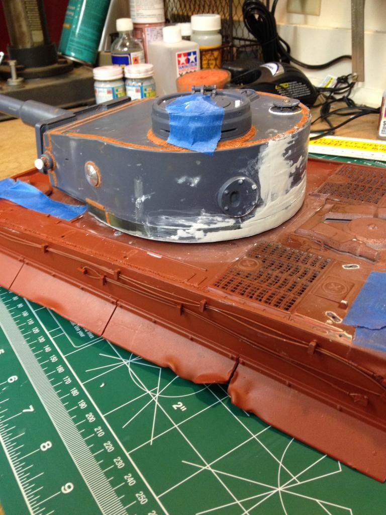

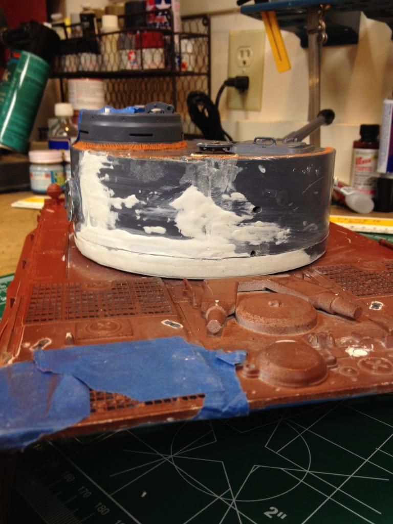

Filled in the back of the turret and the gaps on the upper deck
The back
Of the turret is going to require some sanding to smooth it all out and then I will fit the Tamiya Rommel bin I don't like the seam between the top and bottom of the turret , but not sure if I want to goto the trouble of fixing that
will see how the sanding goes first.

Hey Mark... here's a trick I use... instead of putty... I use Plastic Dust... I collect all the residual stuff that comes from sanding... put it in a bottle.... you put a bead of super glue then chase it with the dust.... sand ..keep the dust.. and repeat if needed... the stuff becomes harder than concrete.... but still relatively easy to sand... whatever comes off during the sanding process get's put back in the bottle.... the cool thing is it takes only seconds to fill fine gaps holes and such... and never shrinks ...another for hiding those pesky upper lower seams is to sand it ... put a coat of paint by brush... sand that then put your final coats...works pretty well... the only drawback is you have to repeat the steps if you service your turret and break the seam again

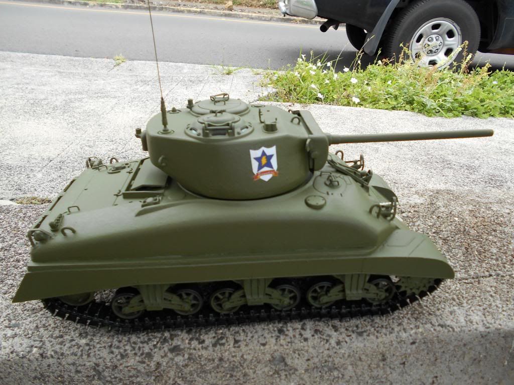

The Mato Sherman had a really bad seam on the turret... that is how I got rid of it
Happy Tanking Mark

Cool thanks Alpha, that is a good tip , I will start saving the dustALPHA wrote:Hey Mark... here's a trick I use... instead of putty... I use Plastic Dust... I collect all the residual stuff that comes from sanding... put it in a bottle.... you put a bead of super glue then chase it with the dust.... sand ..keep the dust.. and repeat if needed... the stuff becomes harder than concrete.... but still relatively easy to sand... whatever comes off during the sanding process get's put back in the bottle.... the cool thing is it takes only seconds to fill fine gaps holes and such... and never shrinks ...another for hiding those pesky upper lower seams is to sand it ... put a coat of paint by brush... sand that then put your final coats...works pretty well... the only drawback is you have to repeat the steps if you service your turret and break the seam again![]()
The Mato Sherman had a really bad seam on the turret... that is how I got rid of it![]()
Happy Tanking Mark
That Sherman is sharp looking

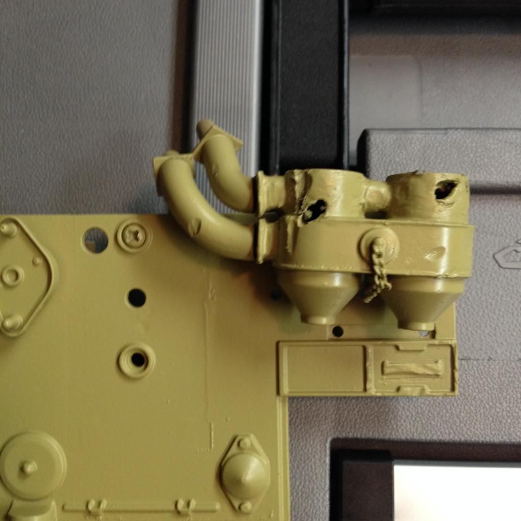

Photographed a friends wedding today so didn't have much time for the tank
I attached and battle damaged the Tamiya Rommel bin and added battle damage and painted
The air cleaners to resemble 131.
Lots and lots more to do. But I am leaving Wed for Hawaii to get married
She is a keeper 8+ years and never complains about my hobbies
Cheers Mark
