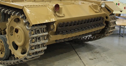

Spent this week getting the lower hull ready for some paint. Still undecided what colour to paint the model, grey, dark yellow, winter camo, mixed colour camo, my heads spinning! :crazy: Any thoughts or images welcome. ;)
Started by reworking the towing eyes. The hole is too small and a little low. Plastic strip was added to the top to bring it flush with the sloping frontal armour.
I filled the holes with some suitable plastic and sanded it smooth prior to drilling.
A 4mm HSS bit was used having first drilled a pilot hole.
Finally the corners were rounded with a sanding block.

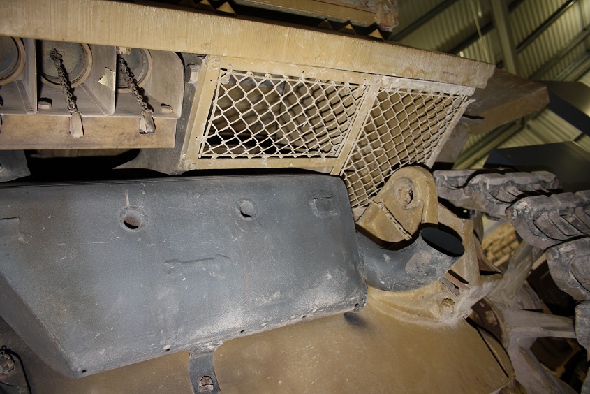

Some of the detail like the spare tracks and exhaust has been picked out by brush. Painting my models is always a tense time as i find it tends to make or break them. I intend to paint the whole model without any weathering, texturing etc and then go from there. Part of me quite likes the factory finish but the fun is definitely in weathering!
