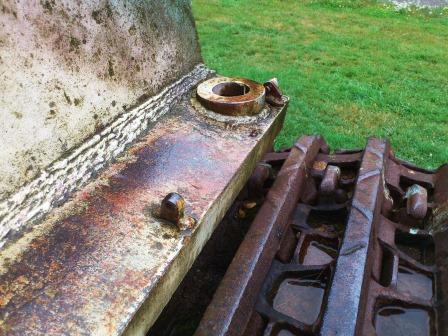

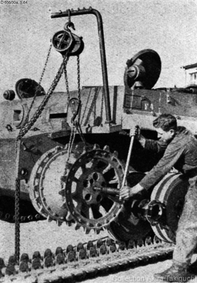

The large rings at each corner of the hull puzzled many of us for years. One suggestion was that they were brackets for holding poles for some sort of camouflage rig. However, the photo below shows their real purpose - to mount a small crane used to replace the sprockets (a little like a larger version of the Pilsen crane mounts which appeared on the turrets of late Tigers and other tanks).
As you can see from the photo below the hole should go all the way through.
Front hull corner on the Saumur Tiger.jpg (30.8 KiB) Viewed 6354 times

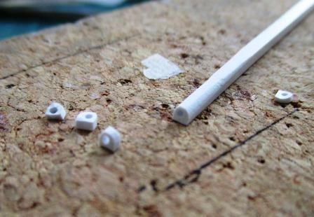

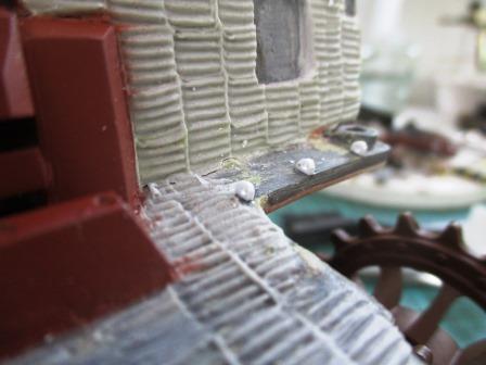

Even though I was going to do without the front fenders themselves I still needed to add the hinge attachment points - four in all on each side. These I made from solid square-section plastic rod which I drilled and then sanded to to a rough inverted 'U' shape. The brackets were then cut sausage-style using a sharp knife and glued in place. I left one off because it seems from photographs that they would often come away when the fender was ripped off.
Front hull corner on the Vimoutiers Tiger 1 showing the fender attachment points.jpg
Front hull corner on the Vimoutiers Tiger 1 showing the fender attachment points.jpg (46.84 KiB) Viewed 6354 times
Fender mounting points were cut sausage-like from a length of square plastic tube drilled and sanded to shape.jpg

The fender hinge brackets weere then glued in place - the furthest was left off as 'battle damage'.jpg
The fender hinge brackets weere then glued in place - the furthest was left off as 'battle damage'.jpg (33.22 KiB) Viewed 6354 times
The front fender attachment brackets after a coat of Mr Surfacer Primer.jpg (33.21 KiB) Viewed 6354 times

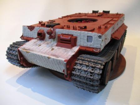

Final detailing of the upper hull and another coat of primer
With the wheels and tracks back on my Tiger is starting to look more business-like and - I hope - more like the real thing.jpg
With the wheels and tracks back on my Tiger is starting to look more business-like and - I hope - more like the real thing.jpg (33.76 KiB) Viewed 6361 times

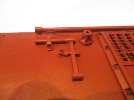

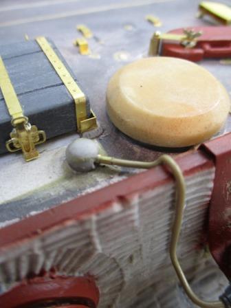

There were just a few more details that I needed to finish before I could add the next layer of primer to the top of the upper hull.
The headlight finished with cable conduit attached using a plug shaved off a Tamiya headlight bracket.jpg
The headlight finished with cable conduit attached using a plug shaved off a Tamiya headlight bracket.jpg (36.86 KiB) Viewed 6361 times
The other end of the headlight cable was attached to the armoured plug with two different sizes of brass tube.jpg
The other end of the headlight cable was attached to the armoured plug with two different sizes of brass tube.jpg (34 KiB) Viewed 6361 times
The crank handle and aerial mount.jpg (27.37 KiB) Viewed 6361 times

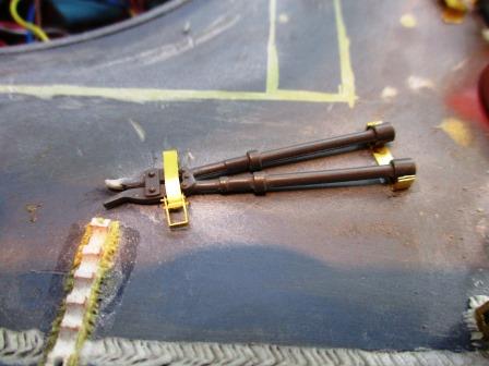

The beautifully moulded wire cutters from the Tamiya Tiger were mounted using clamps from the Voyager photo etch set.jpg
The beautifully moulded wire cutters from the Tamiya Tiger were mounted using clamps from the Voyager photo etch set.jpg (34.98 KiB) Viewed 6361 times

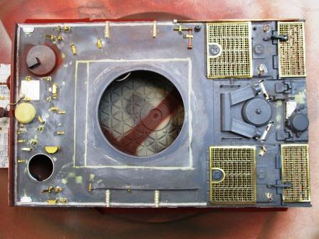

A plan view of the upper hull just before the primer coat goes on shows just how much detail can be added.jpg
A plan view of the upper hull just before the primer coat goes on shows just how much detail can be added.jpg (45.4 KiB) Viewed 6361 times

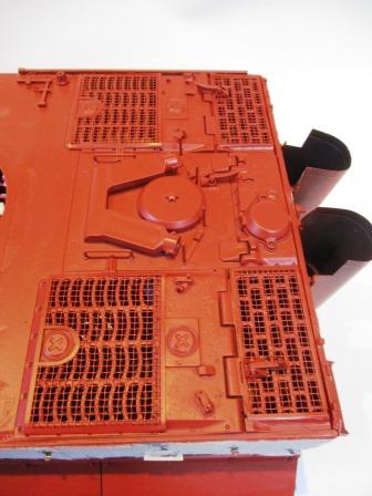

Now you see it... now you don't. It almost seems a shame to hide the evidence of all that hard work - but I cannot tell you how satisfying it is to see it all starting to look unified beneath a coat of paint!.jpg
Now you see it... now you don't. It almost seems a shame to hide the evidence of all that hard work - but I cannot tell you how satisfying it is to see it all starting to look unified beneath a coat of paint!.jpg (35.41 KiB) Viewed 6361 times

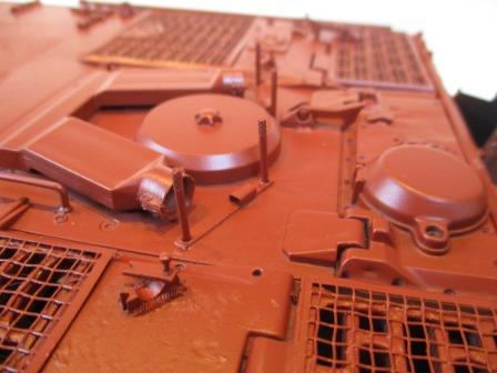

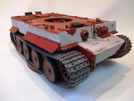

Close-up of the engine deck after a coat of primer.jpg (35.86 KiB) Viewed 6361 times
Another three-quarter view.jpg (34.23 KiB) Viewed 6361 times

Very beautiful work on this Tiger. The details are impressive.
But be careful, because I don' t remember than this air filter system was on a mid prod!!! There is no the double pipe. Maybe I am wrong, but when I see this part on your Tiger rear deck, I was "shocked".
For the voyager clamps, it is easier to made compared with Aber?
