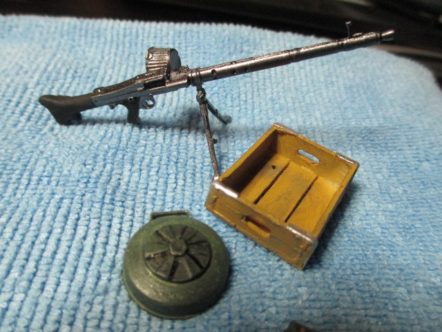

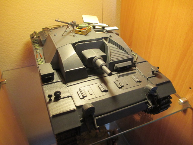

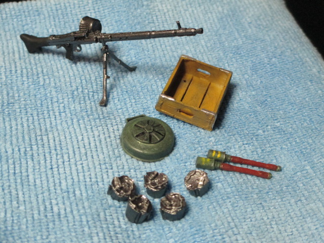

One detail set painted and weathered. I should be able to get it mounted on the StuG this weekend. Next up, the radios. ( and bucket ;o) Pictures:

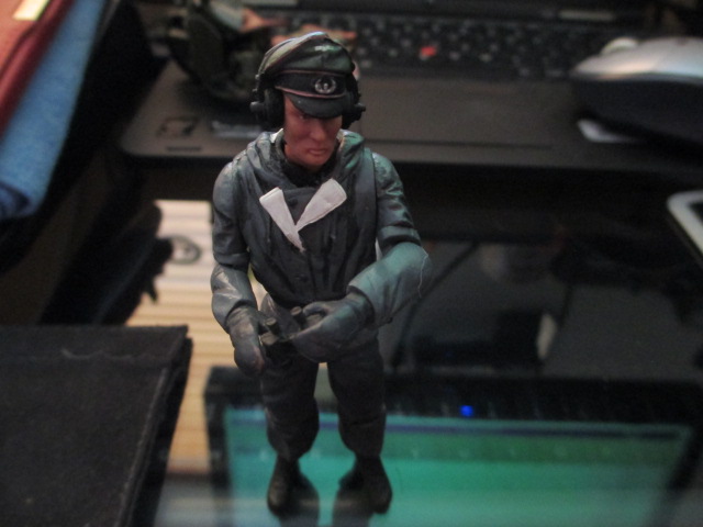

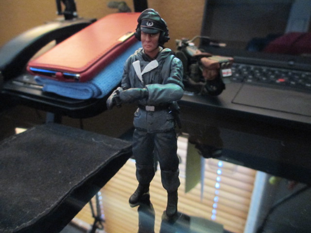

Was out meandering around a favorite flea market yesterday before a local meetup and found this fellow. He should work on the StuG as a crewman as soon as I change his piping from pink to orange. Pictures:
A closer view
A closer view
A closer view.JPG (84 KiB) Viewed 3572 times
Binocs and a Walther.  Just a little touch up needed and I have my second crewman
Not bad for half off - 3.98
Not bad for half off - 3.98.JPG (93.67 KiB) Viewed 3572 times

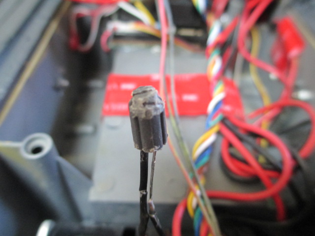

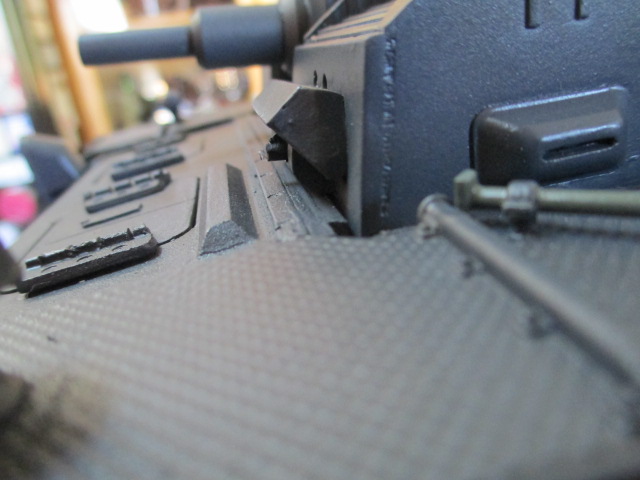

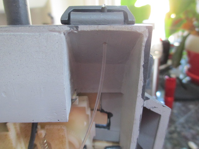

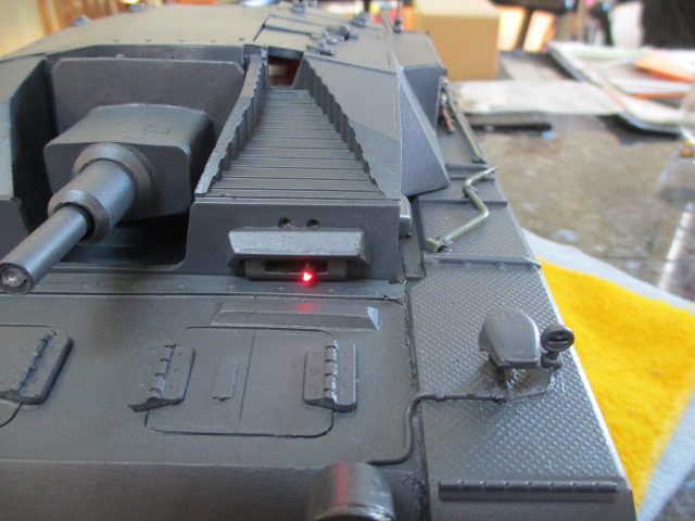

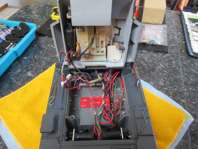

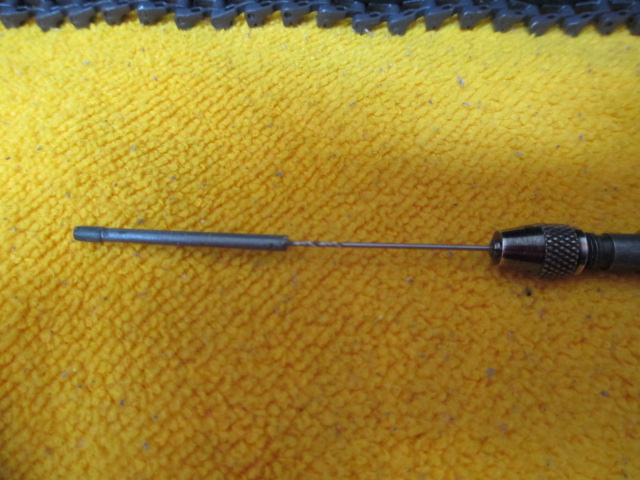

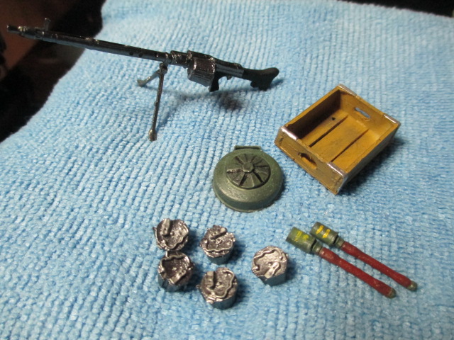

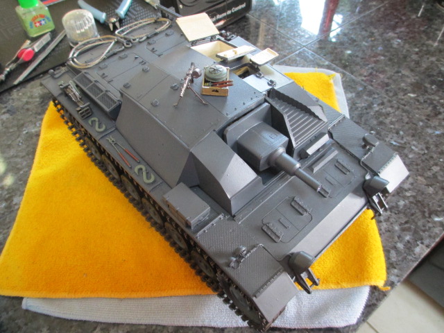

Ad Lav, Definitely, in good time. Today, I wanted to pursue how to make the left over machine gun circuit and led useful. I had originally thought to use the bipod mounted MG34 and the box of ammo and goodies for this but the recoil and flash unit really does take up 90% of the roof. I didn't want to try to drill through the mechanism. There just aren't that many spots to safely bother on it. Looking around the vehicle, I noticed the large view slot and thought that it might be easy for a crewman to stick the business end of an MP40 out of it and say hello to attacking infantry. There were two along with spare magazines and stick grenades stowed right to hand on this version of the StuG (which did not have a factory installed MG like later versions). Pictures:
A little more done.
A little more done.
Another detail added tho' not in the way originally envisioned
Side view showing the muzzle
Side view showing the muzzle.JPG (88.48 KiB) Viewed 3572 times
A working MP40 flash
Muzzle complete with a sight and mounted to the fiber optic and glued into place.
Muzzle complete with a sight and mounted to the fiber optic and glued into place..JPG (86.25 KiB) Viewed 3572 times

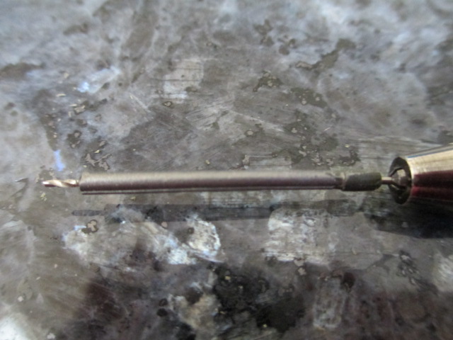

Carefully drilled through with the Yankee drill and a #65
Carefully drilled through with the Yankee drill and a #65.JPG (98.91 KiB) Viewed 3572 times
Making the (slightly outsized) muzzle of an MP40 out of one of the few barrels of a diameter to work...
Glued into place
Glued into place
Glued into place.JPG (90.74 KiB) Viewed 3572 times

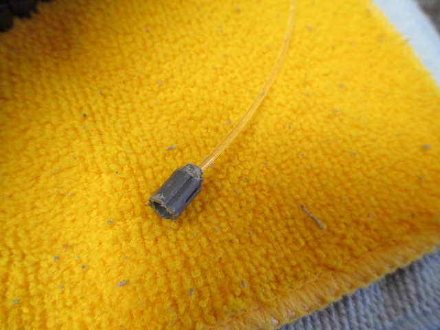

Cap for the MG led made out of a pen part.
Not a lot of space to run a fiber optic cable.
